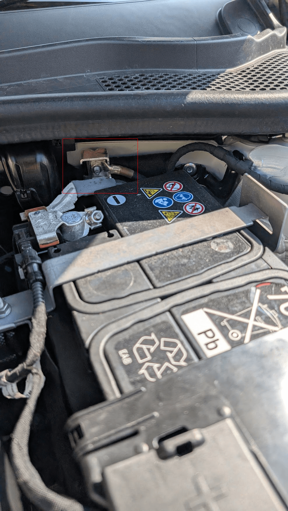

Battery fully charged and drove for the first time today and all seems fine again thankfully.
@Syphon
I’m also having low battery issues ever since collecting the car. Mine is an ex-dealer demonstrator so I put it down to lots of short trips and people playing with the infotainment system etc. Could be wrong though. Could be defective like yours was.
I’m going to try my charger to see if the problem is elevated. Could you tell me where you attach the negative clamp from the charger please?

Sorry for the delay, the tech told me to attach it here. Hope you get it sorted.
Thanks so much for taking the time to help. That negative charge point position is very helpful. Batteries in cars are odd. Some cars say to clip positive and negative in the usual way (positive to red terminal and negative to black terminal). However some batteries won’t charge if you do this. My wife’s Toyota for example. Some cars recommend clipping the negative to metalwork somewhere in the engine bay. However they never specify where. So your picture is dead helpful.
Will let you know how I get on 👍🏻
