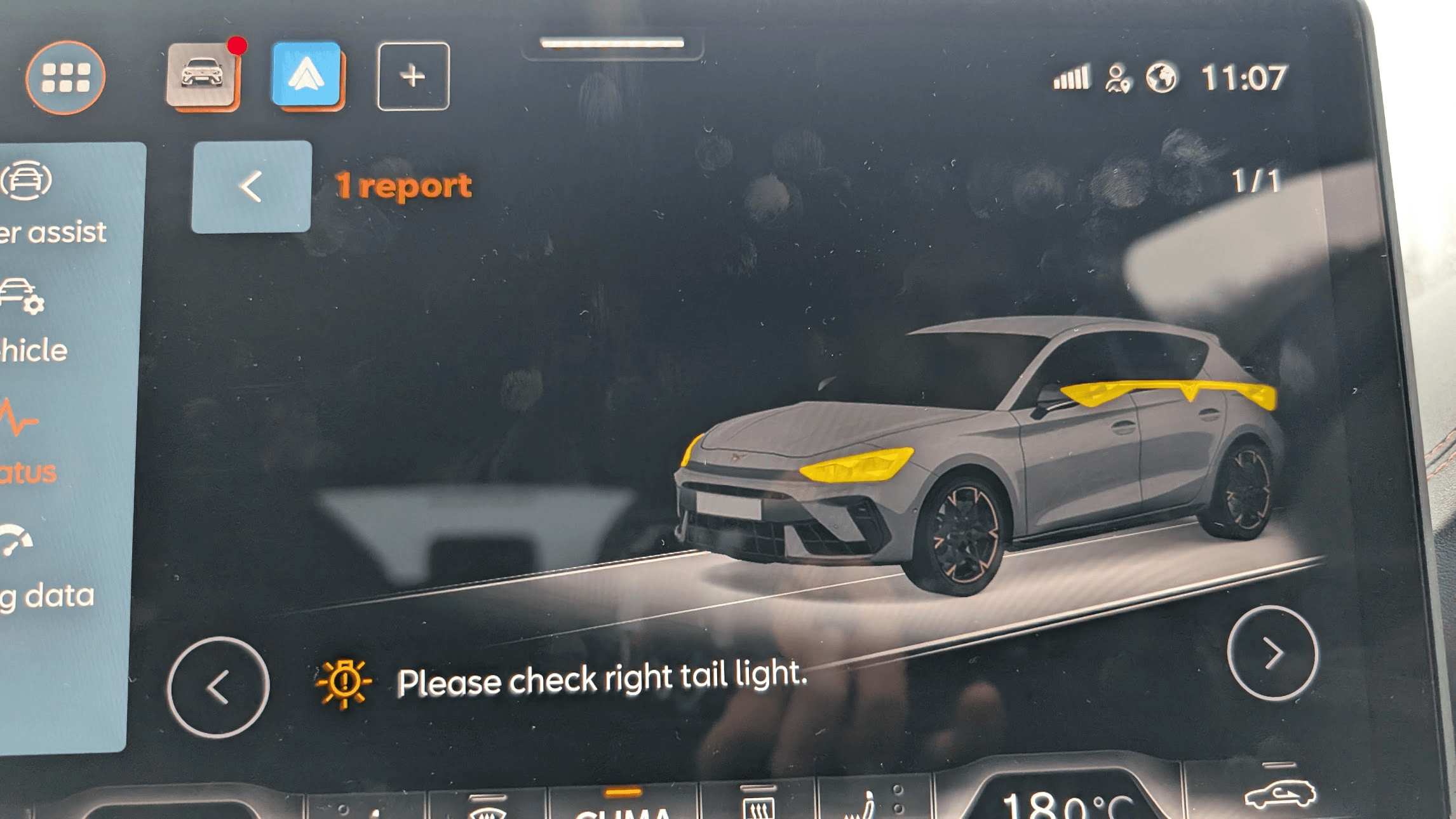

So I now have a completely dead battery.
Bought a charger but it's been running for hours and not made a dent. Car hasn't been left for any significant length of time without being used. I had an early low battery warning not long after taking delivery of the car which I'd dismissed. Have had the odd occasion where it's previously warned about errors like below - not sure if that's linked to a duff battery but the lights are fine.
Now there is nothing, completely dead. Going to have to call CUPRA assist for a new battery as this must be a dud. Really don't want it taken away on a transporter for potential damage so hoping they will be happy to send someone to the house with a new battery to fit there. :-(
Scott
Not good.
I'd expect they could fit the battery at your home though.
They did for an older Leon I had.
Reactions: Tell and Syphon
