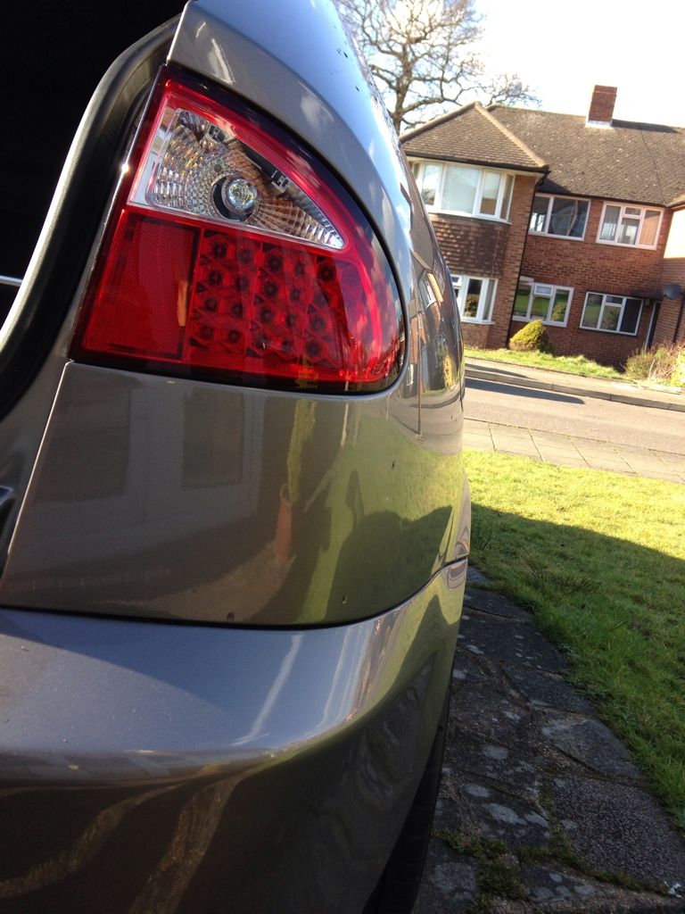

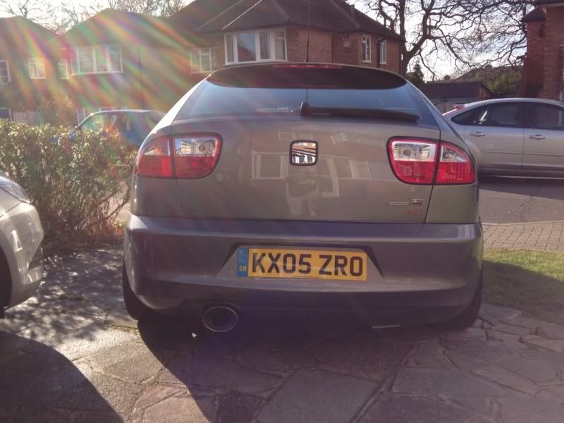

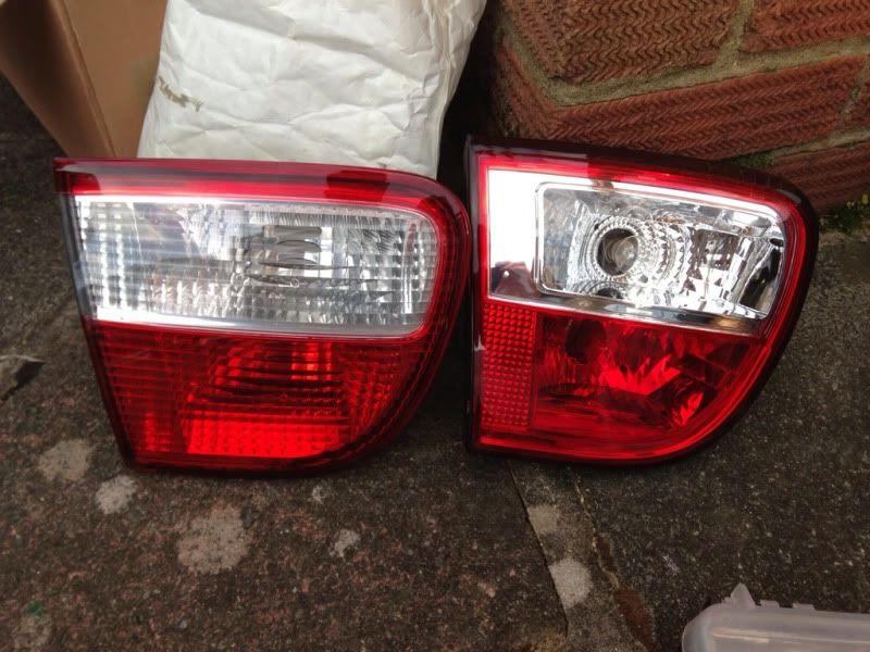

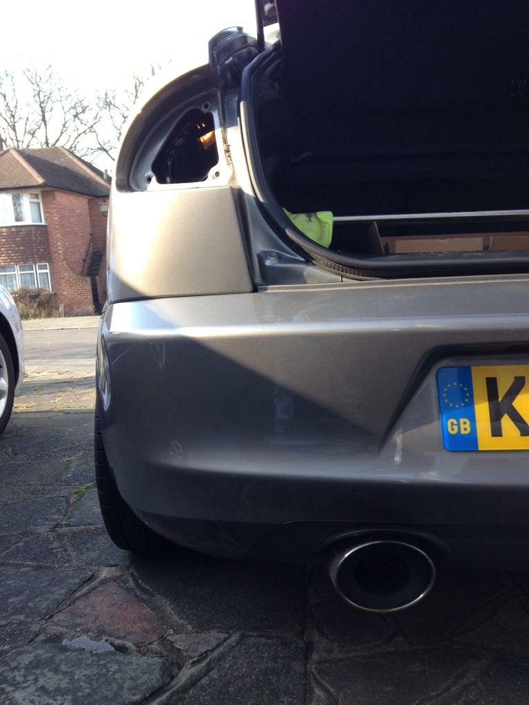

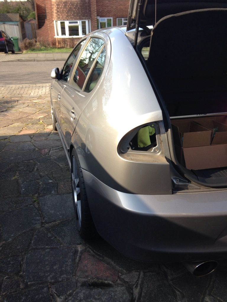

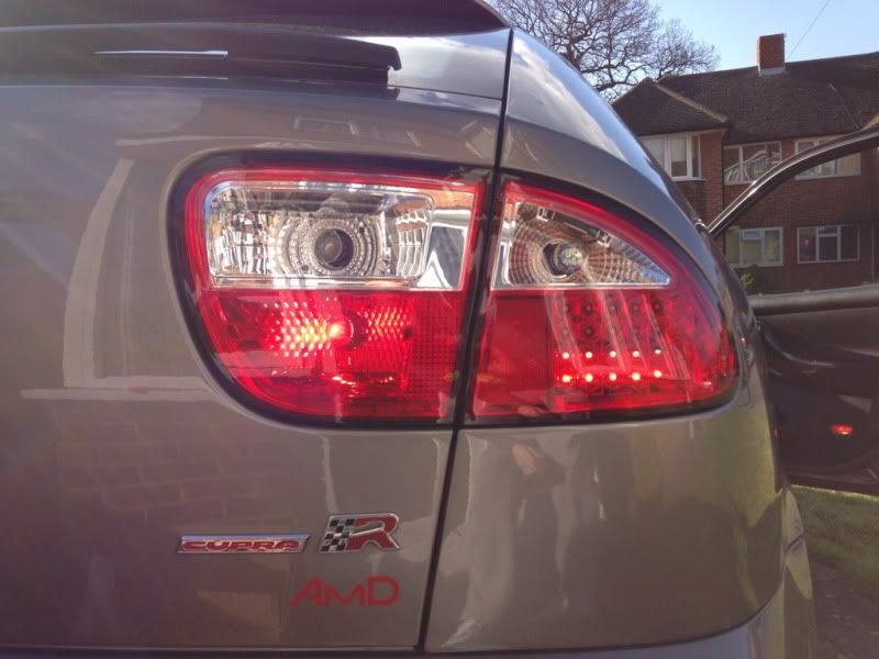

Fitted the LED rear lights today. Really pleased with how they look and light up :D
Old v new
Because race car (briefly)
1st one in
Drivers side done
Nice OEM look but more modern, exactly what I was after after seeing J@mes' LCR and my mates with these a good while ago.

You have sold them to me mate, looks really good. Iv seen smoked ones of these as well which look descent
Cheers mate :) Glad you like. If you're about OEM+ there isn't any better aftermarket off the shelf options than these IMO. I've wanted them for a long long time. It was just getting much bigger more important stuff out the way first so I can 'finish' bits off now :)
Get a set. But buy two 50w 6ohm resistors as you'll need them to stop the center rear brake light from lighting up LOW when you turn the lights on. I didn't fit the resistors today as I'm unsure exactly how to install them and don't want to **** it up. Will be asking my mate for assistance with this soon, but it's no harm running it like this in the meantime.
Check J@mes 'Raid LED rear lights' thread in the MK1 section for more info on the resistors. You basically need them because these LED's run at a lower voltage than the stock setup and it causes the rear center brake to glow very lightly. Resistors installed on each side cancel this out.

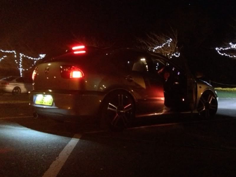

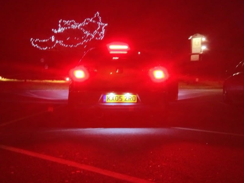

Tailights on with the 'center glowing brake light'
Brakes on
