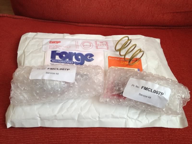

Had a delivery today, kicking off a few recent purchases :)
2 007p service kits and a yellow spring also.
Why 2 you ask? One is mine one is D.K's as he wanted to get his DV serviced too.

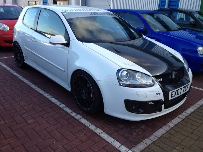

LCR is looking good. That Edition 30 isn't to shabby either, not 100% convinced on the black bonnet strip though.
