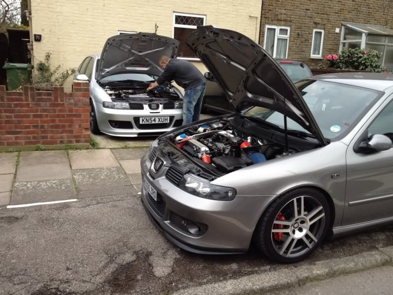

Update..

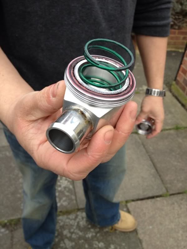

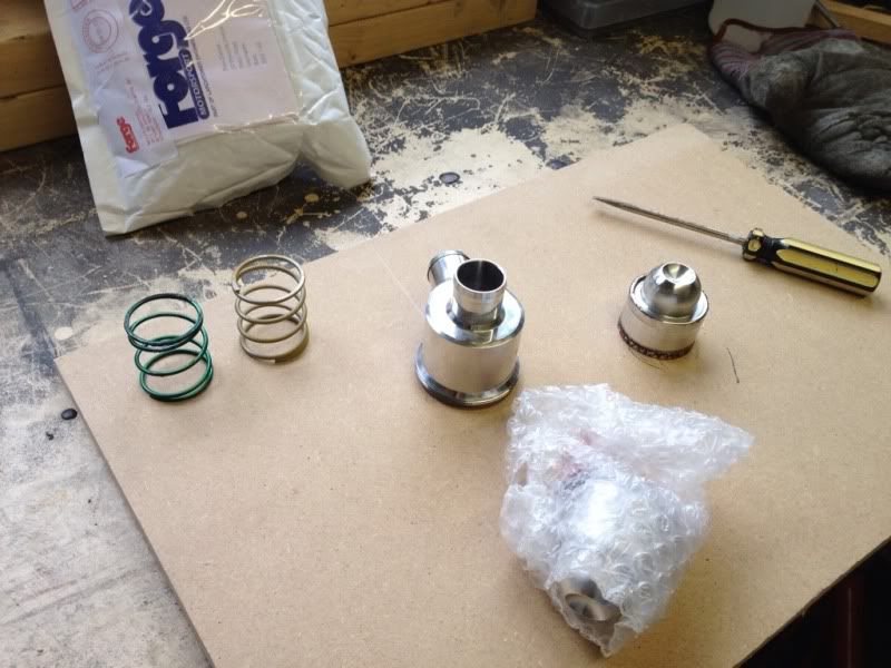

Got to Darren's earlier with 2 007p service kits and a yellow spring for my 007p..
When the DV was opened up, I did guess this might be the case - turns out the green spring has been in there as I had thought lol.. Not ideal for stage 2 and the boost she's kicking out.
So with the DV apart it looked as though it could do with a service, so the new piston went in, new 'O' rings and a full re-grease up. Same was done to Darren's after mine. I noticed a difference almost instantly, boost held better and the car pulled harder/faster as a result :)
Can't believe I had the green spring in there still. The DV had done well though for nearly 2 years without a service. Not bad going IMO.
