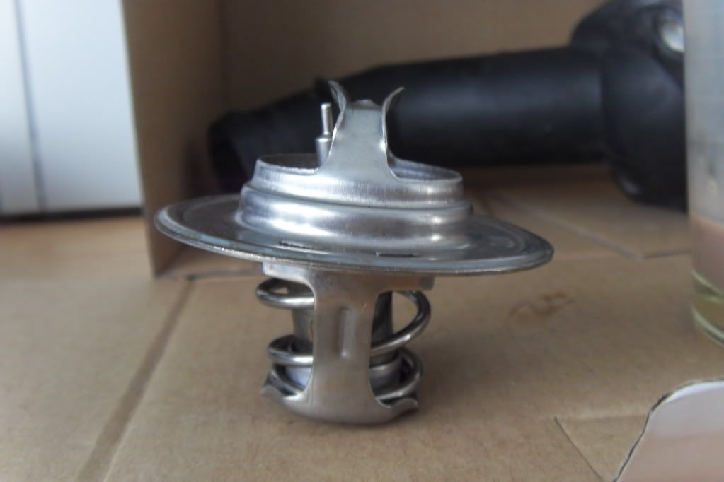

Changed stat yesterday, pretty sure i found the problem
This stat was from euro car parts fitted six months ago
Maybe i've been unlucky but i've replaced with genuine item from sere, will defo think twice about buying cheaper parts
