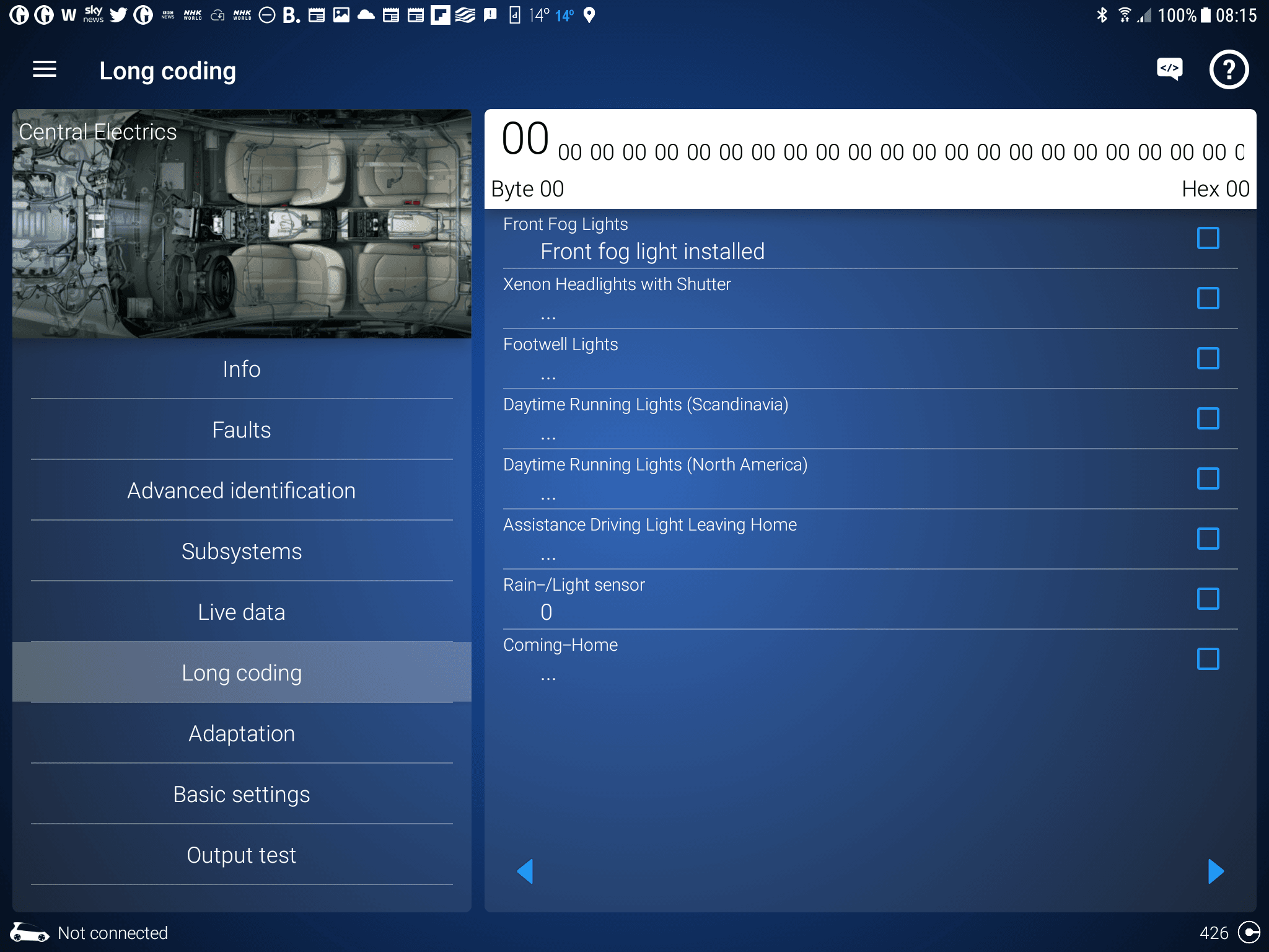

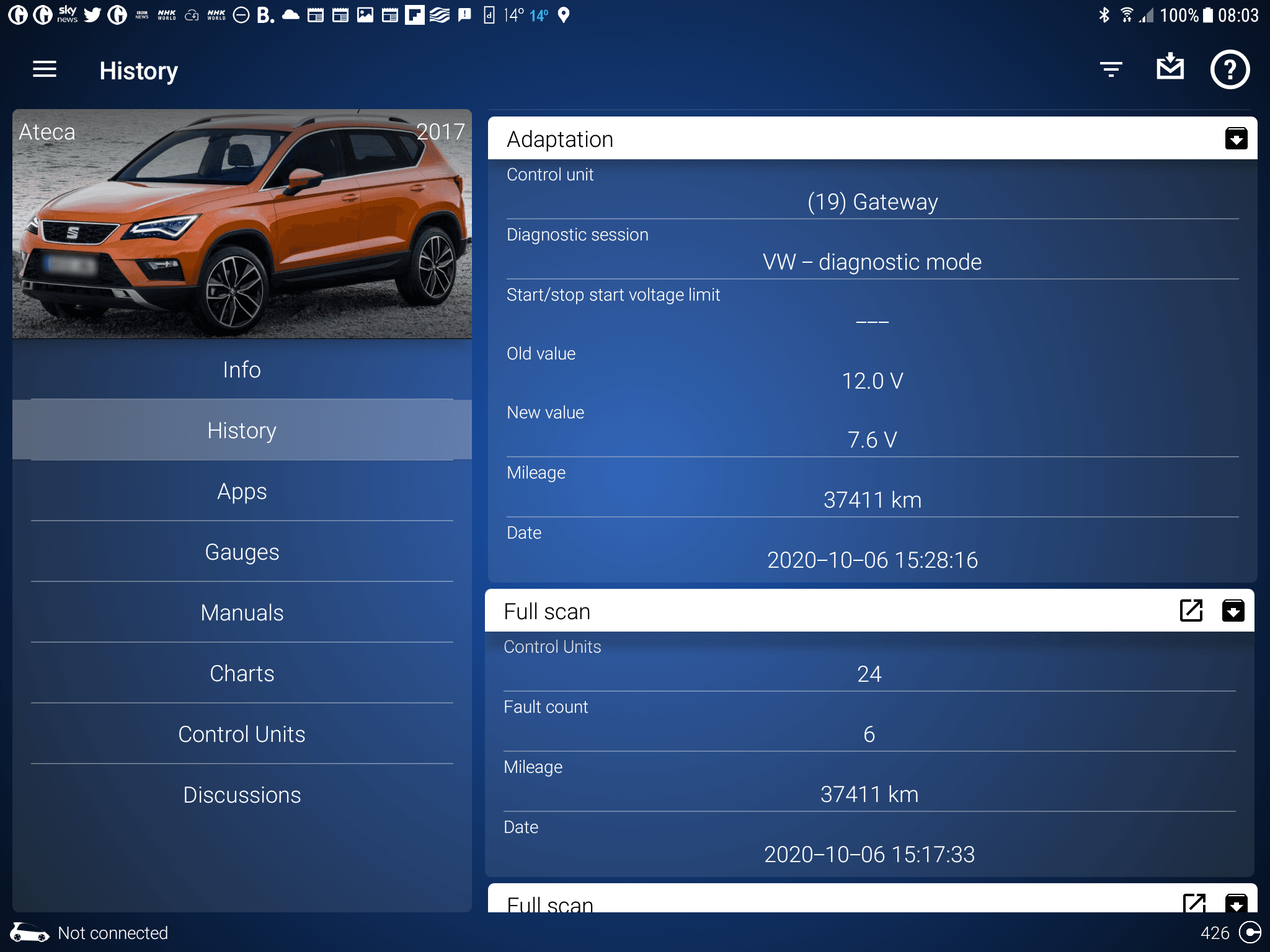

Depends how good you were in the science lab with the bunsen burner. So only make incremental changes, taking screen shots. You can "back up" with Obdeleven Pro but doesn't have a restore. You have to manually restore each change if you want to go backwards. It does keep a log by system of what you have done in history so you can check what you have done. Example:
Fumbling the "long string" is the one that would cause the most issue. Each control unit has one long string and that is it's settings of how the unit works. With the Pro version which you need to get program control rather than the micro payment apps you get direct access to this. The 0-1 toogle in the screen for that swaps between a passed view of the long string which has text around it and you toggle on and off etc to one where you navigate in the string and byte edit it. The latter is the issue.

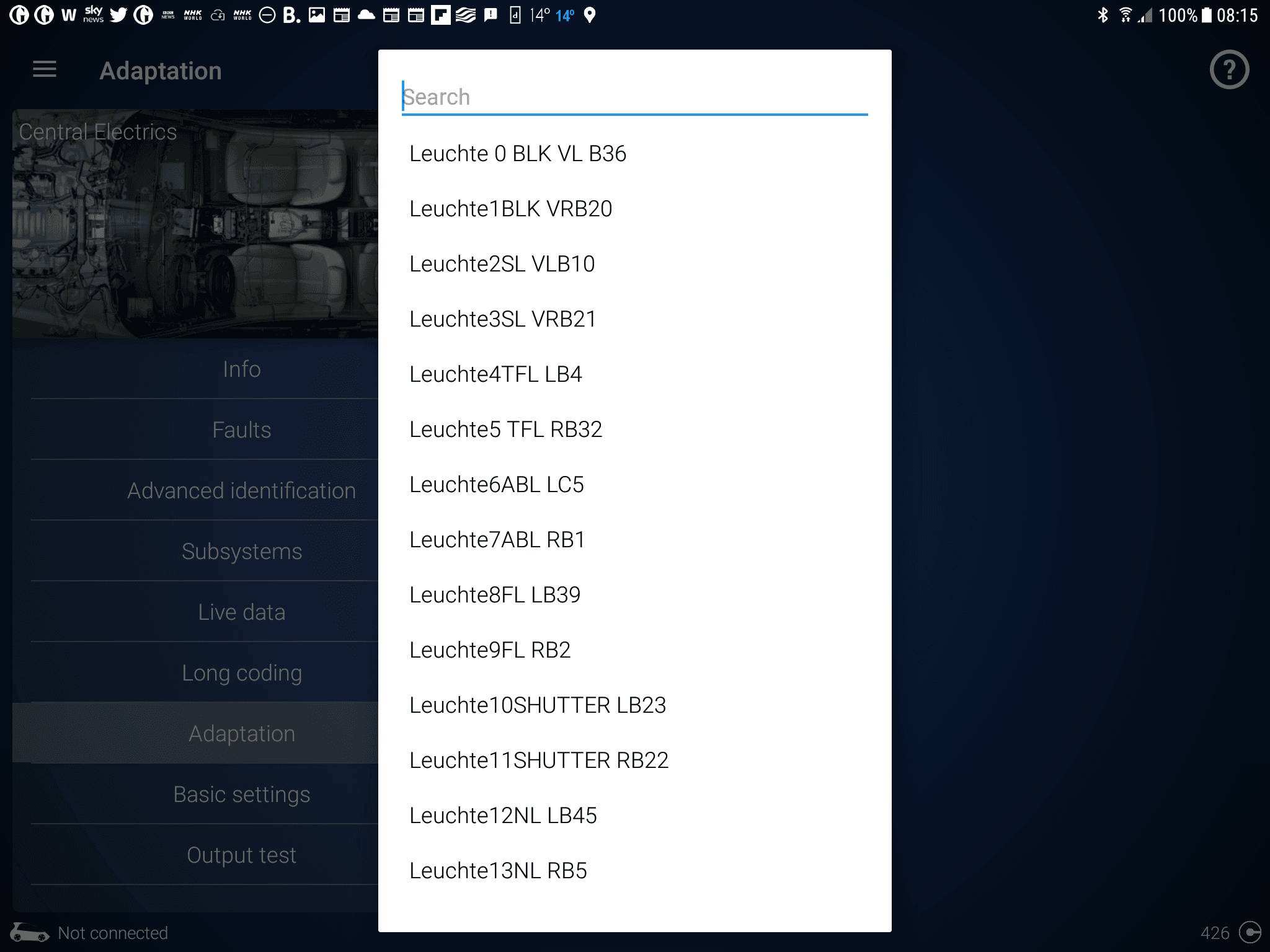

Another screen with adaptions where common one are brought out so you search for that setting.

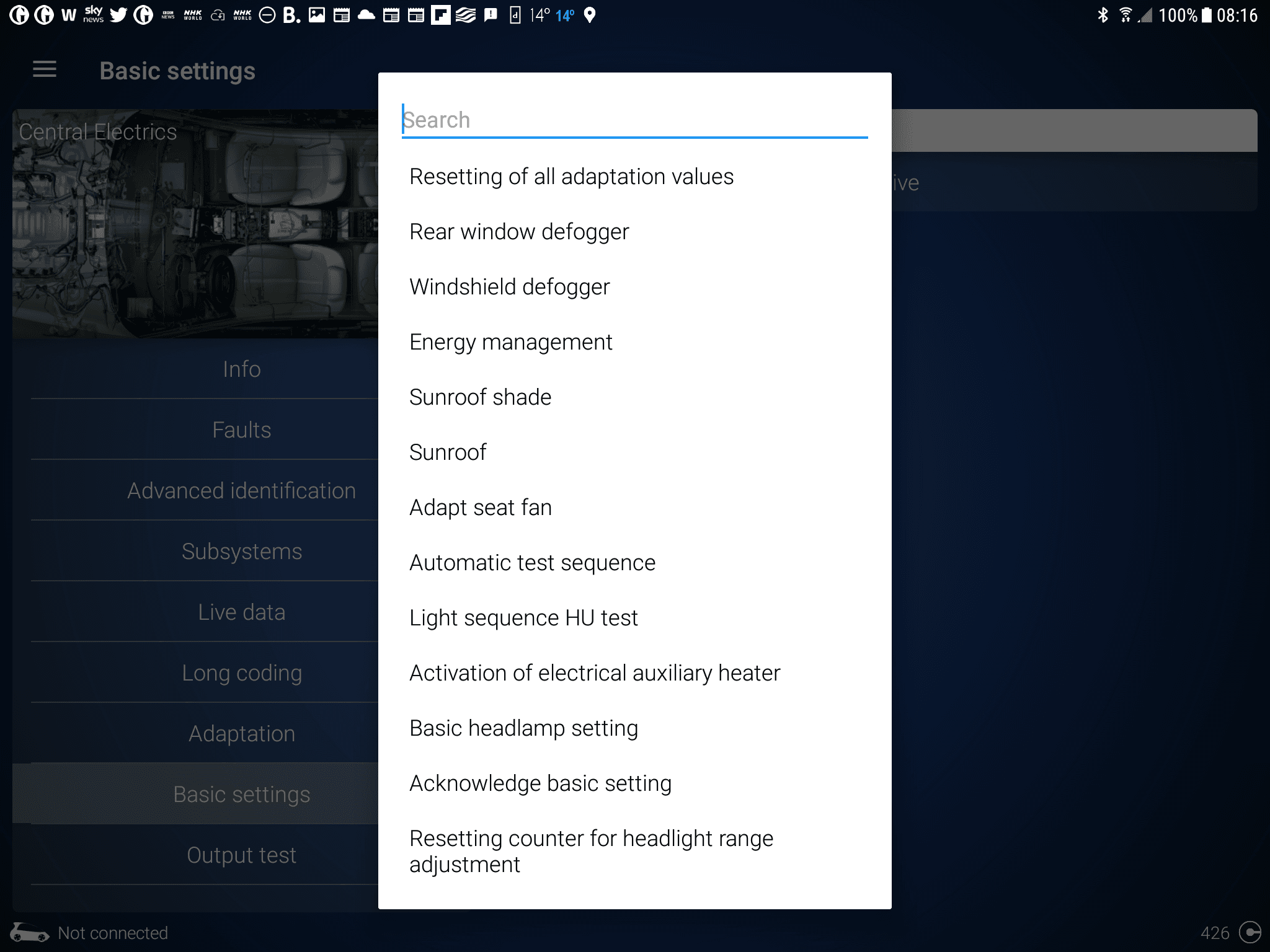

Basic settings hold some:
Examples above for one of the control units in the Ateca.

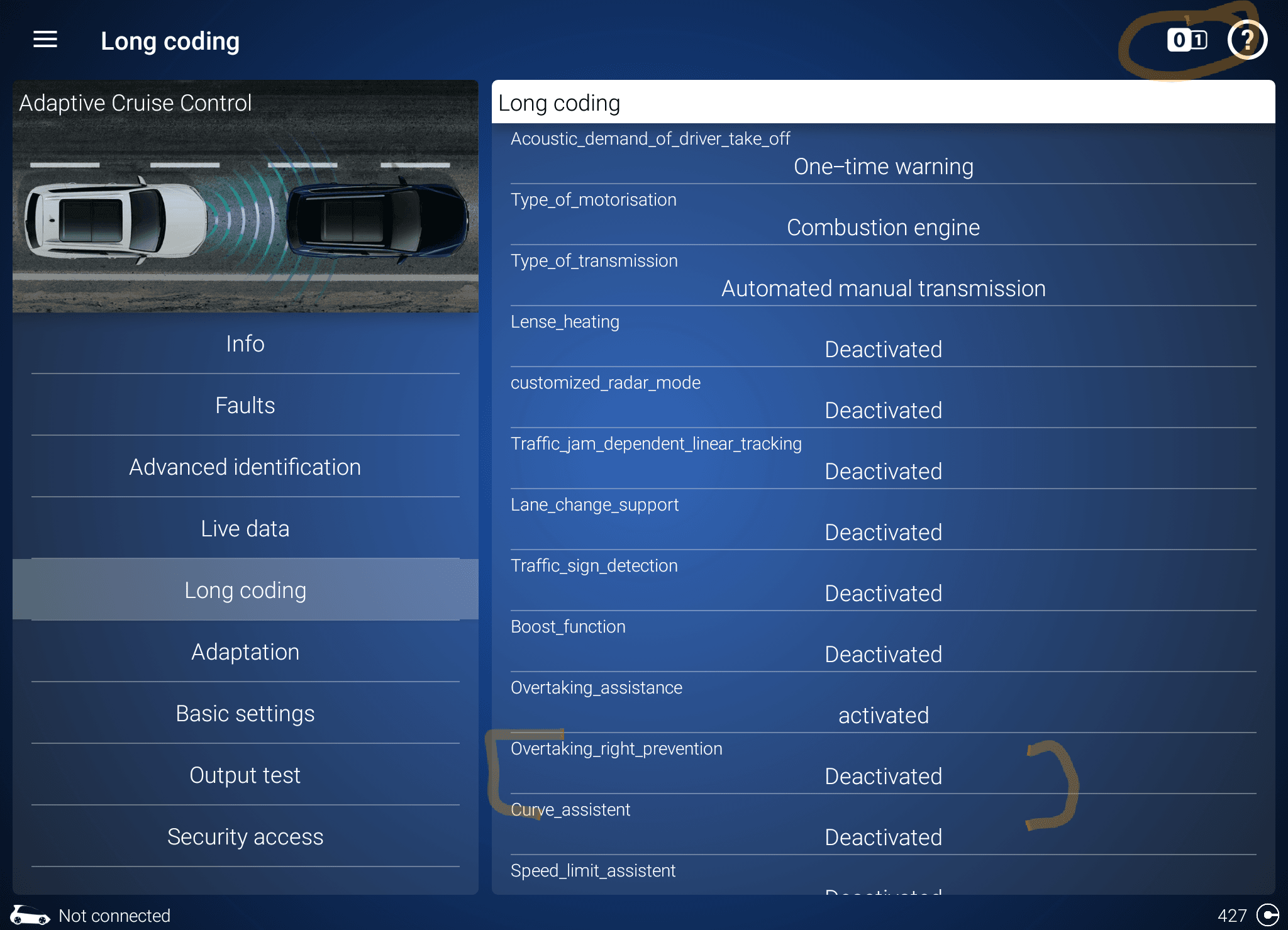

The undertaking one to target, make that deactivate, save with security code 14117:

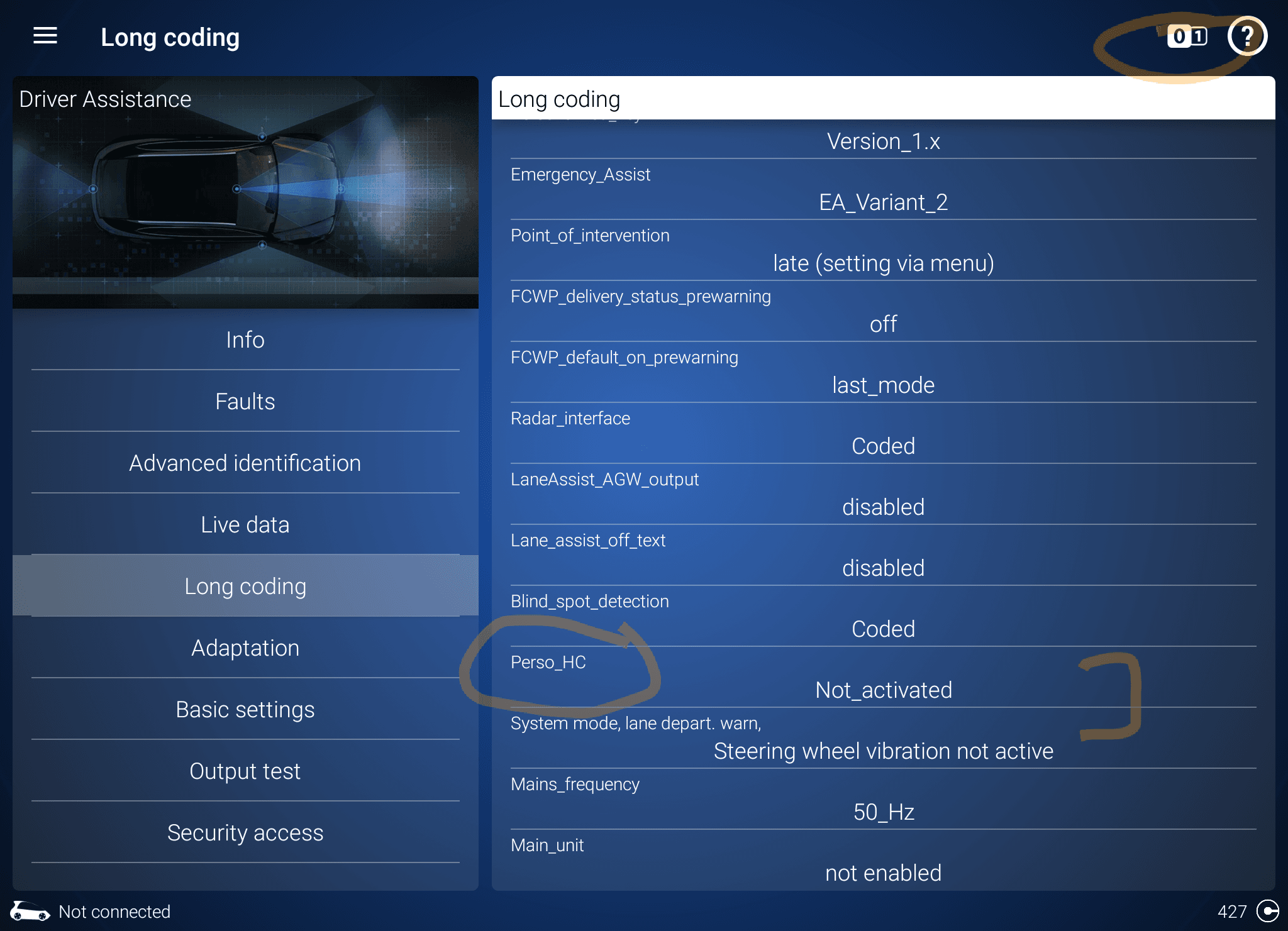

The lane assist assist one that takes off lane assist on auto at ignition, make that Last_setting, save with Security code 20103:
Those are the specific mods above, just the line in question, nothing else, set to the new value and save with the security code, button down the bottom to save before exiting the module in Obdeleven ... must have the bonnet up with 2020 models and above to save changes.
Generally you look in the adaptation first, then the parsed long string. Most of the mods are generally in the adaptations. For 2020 and beyond models you have to save changes with the bonnet up else they won't save and not all control units will accept changes due to SFD but that may change. The control units have published security codes that protect them so they are normally published with the mod.
