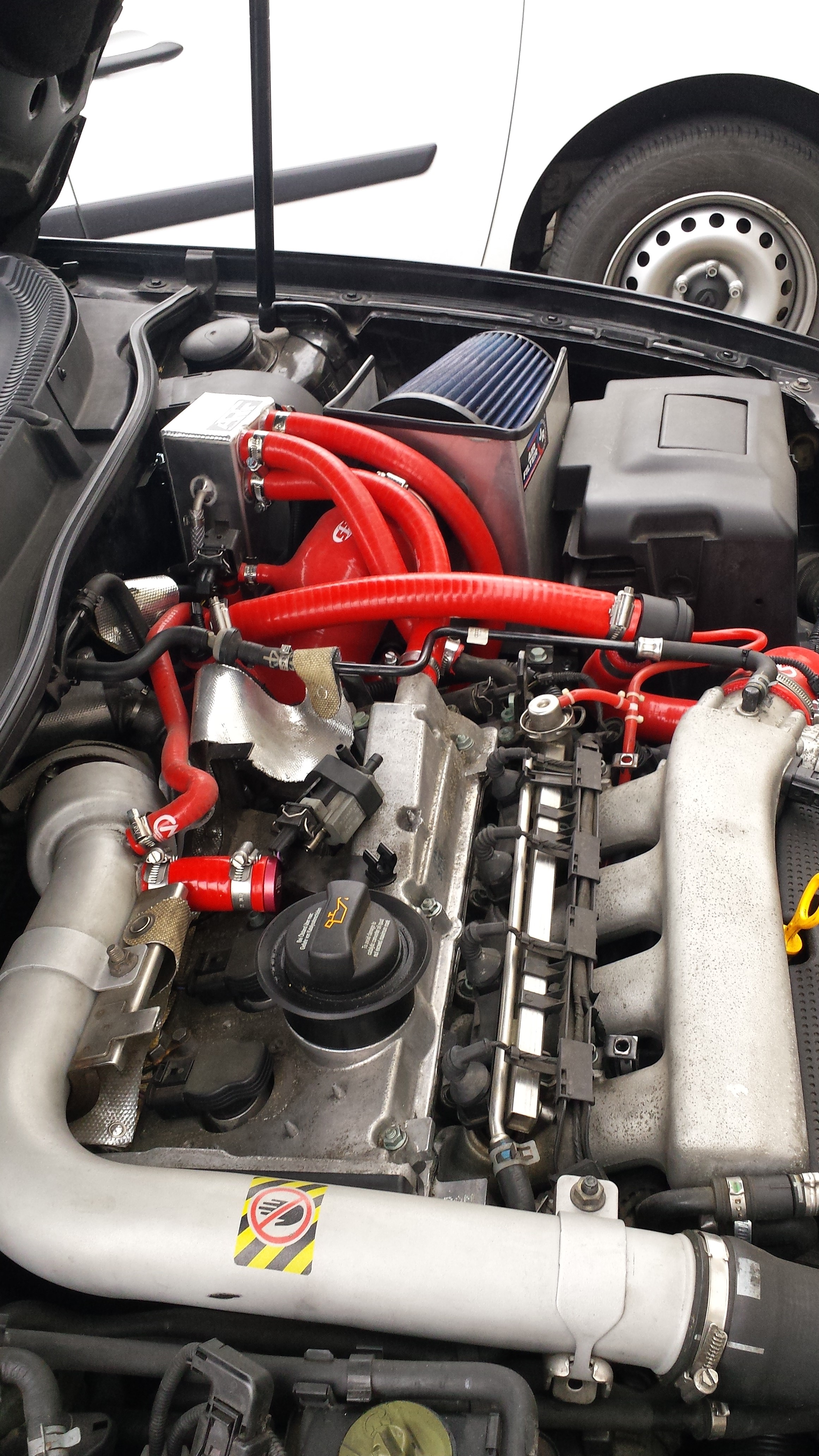

Looks similar to the issues I had with my tip install - https://forums.seatcupra.net/index.php?threads/badger-5-tip-fitting-questions.458492/#post-4912893
I found that when I disconnected the turbo pipe to DV pipe suddenly the TIP fitted nicely for the heat shield and filter. And that made it awkward to connect the DV back up. The CM turbo to DV hose is definitely shorter than the OEM one. unnecessary headaches!! I feel your pain.
Ah so you did, extremely frustrating isn't it especially when these TIPS are regarded as one of the best ones available for these engines.
I see your DV pipe was restricting your TIP, the thing is with mine I'd already cut it down to length when I fitted the CM charge pipe and if anything it's still too long as the angle of the TIP isn't right.
The TIP simply needs to be longer imo and allow the ability to trim if necessary.
After speaking to Bill at Badger5 he reckons to bend then heat shield outwards to suit but it's not possible with my particular one as it has a welded base in it.
I've now ordered a Badger 5 heatshield which should complement the TIP better plus the they come with a larger MAF opening and notch for a strut brace so saves me hacking this current one to pieces.
The only hitch is that it's mill finish so I'll need to grab a can of satin black paint before it arrives.

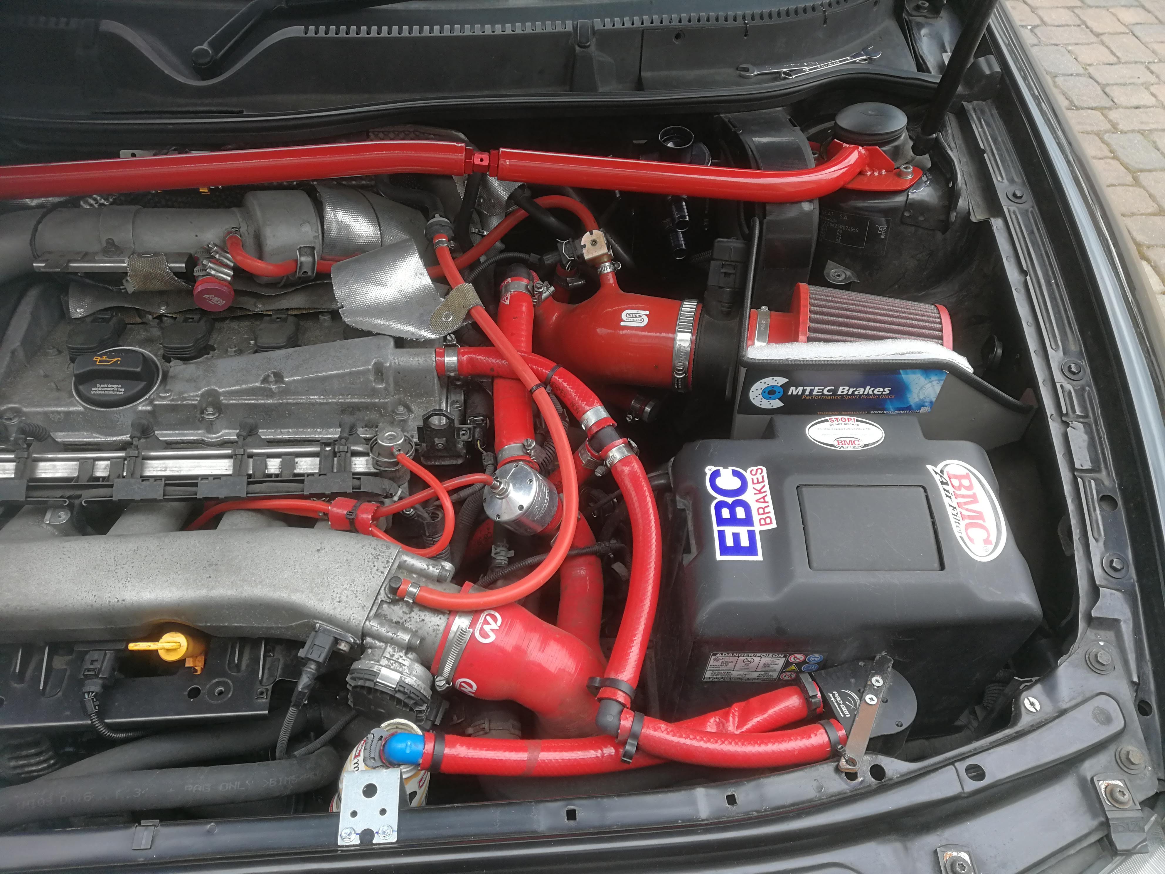

Just a brief visit today as I was itching to test fit the the new MAF housing and heatshield.
I also fitted the Fluidampr pulley wheel and a fresh auxiliary belt now the paint had dried.
Sent from my SM-G960F using Tapatalk
Reactions: Manic172
Spark plugs gapped properly with my new feeler gauges at 0.85mm, going by what I've read this should be bang on the money with the current engine spec.
Oil catch can and breather hoses fitted.
MAF housing chopped down about 30mm as I'd over compensated and the extra length pushed the air filter too far over in the way of the bonnet strut.
Whilst it was off had a play around with 2 old MAF housings and removed the air straighteners...a bit of filing and they pushed in lovely.
I will take it back off again though to run a bead of hot glue round it as I can't be dealing with them getting dislodged resulting in an obstructed air intake.
A piece of cold air intake ducting was dug out and wedged in place - jobs a goodun!
