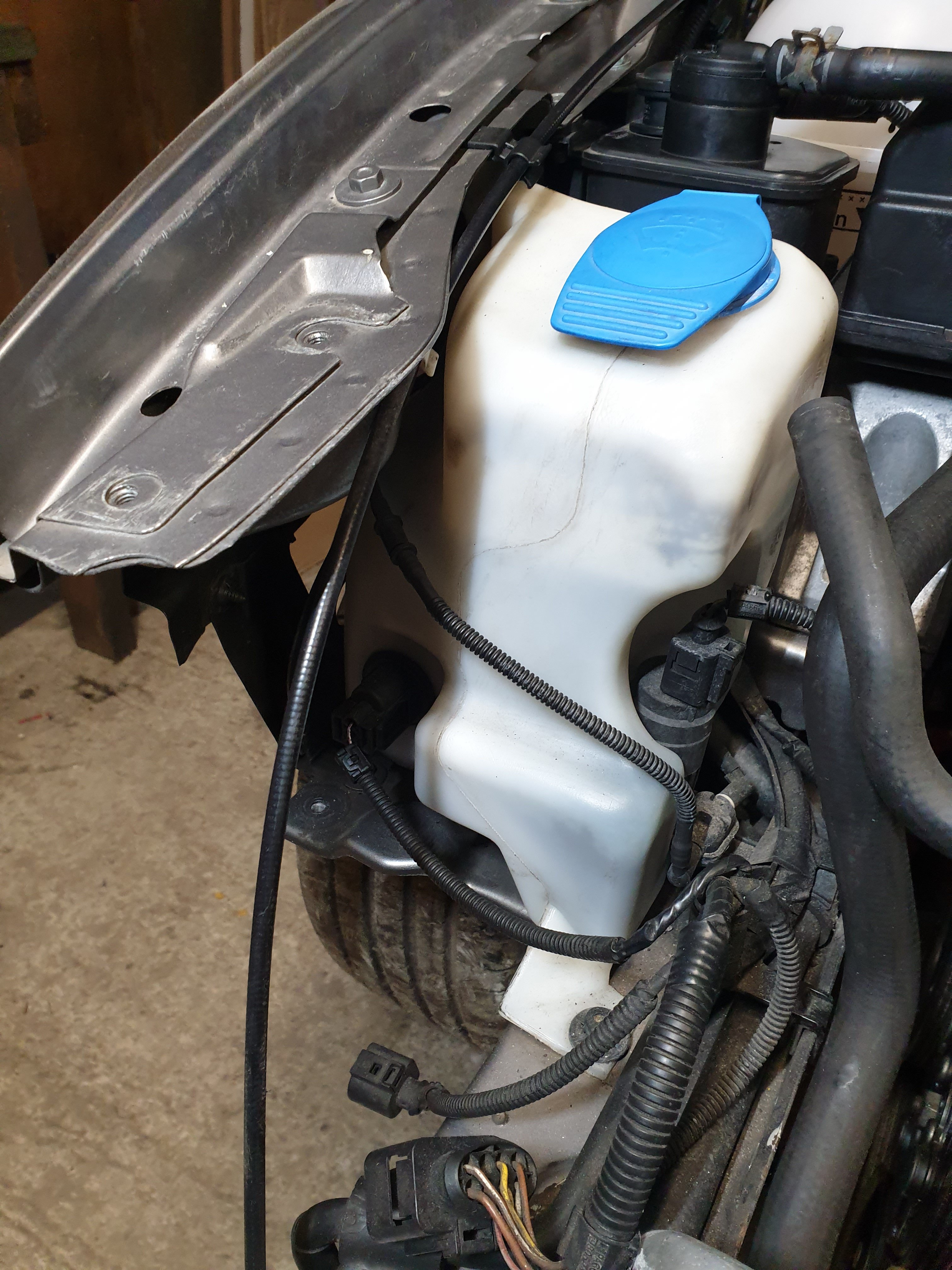

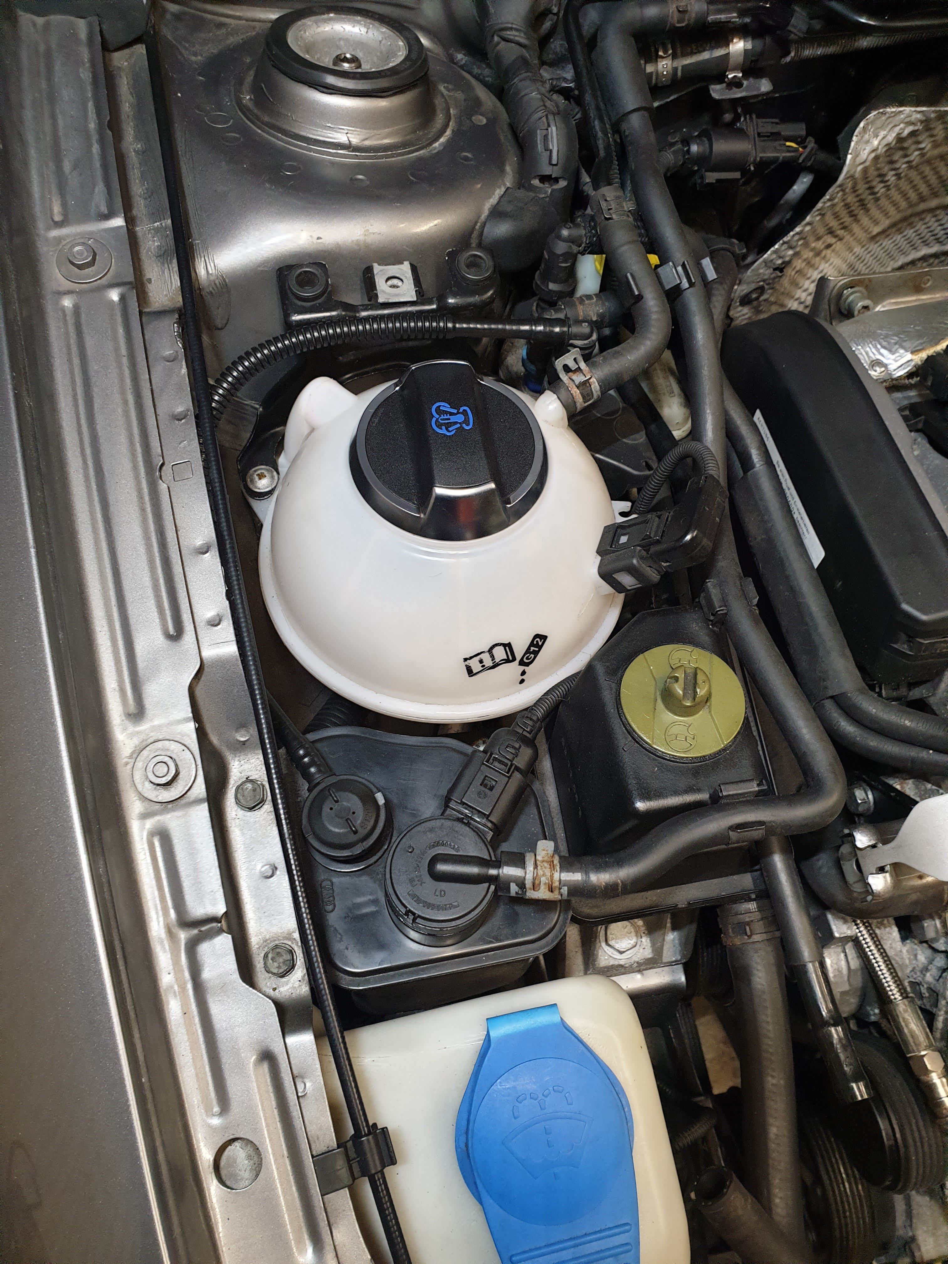

So my current parts fetish has been gathering the bits to install Audi S3 8L coolant and battery covers.
After dealing with an assortment of sellers I have amassed the following bits and the only piece I need now is the battery box mount which I sourced a few hours ago

As you may have noticed I have new genuine Porsche oil and coolant caps.

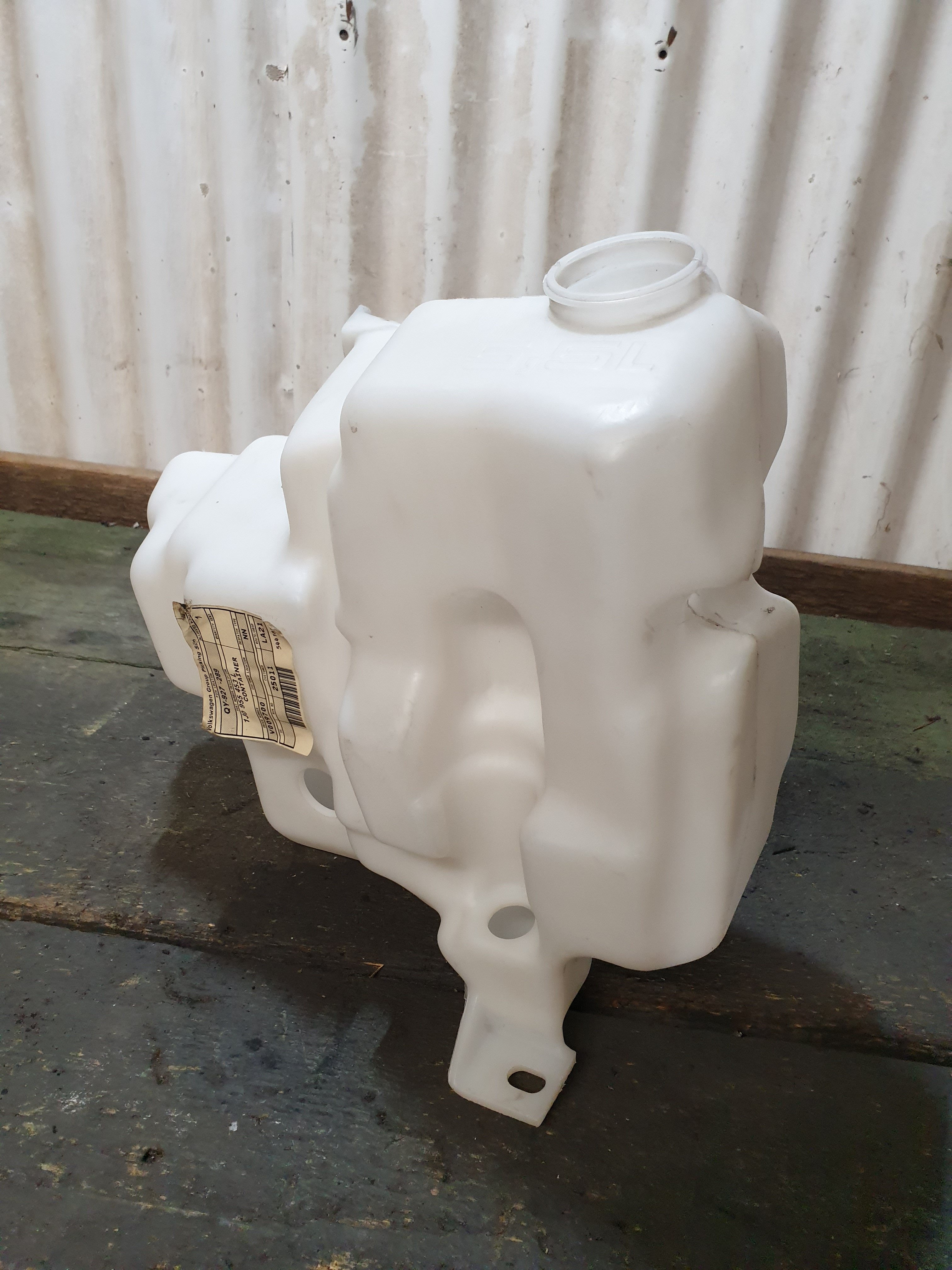

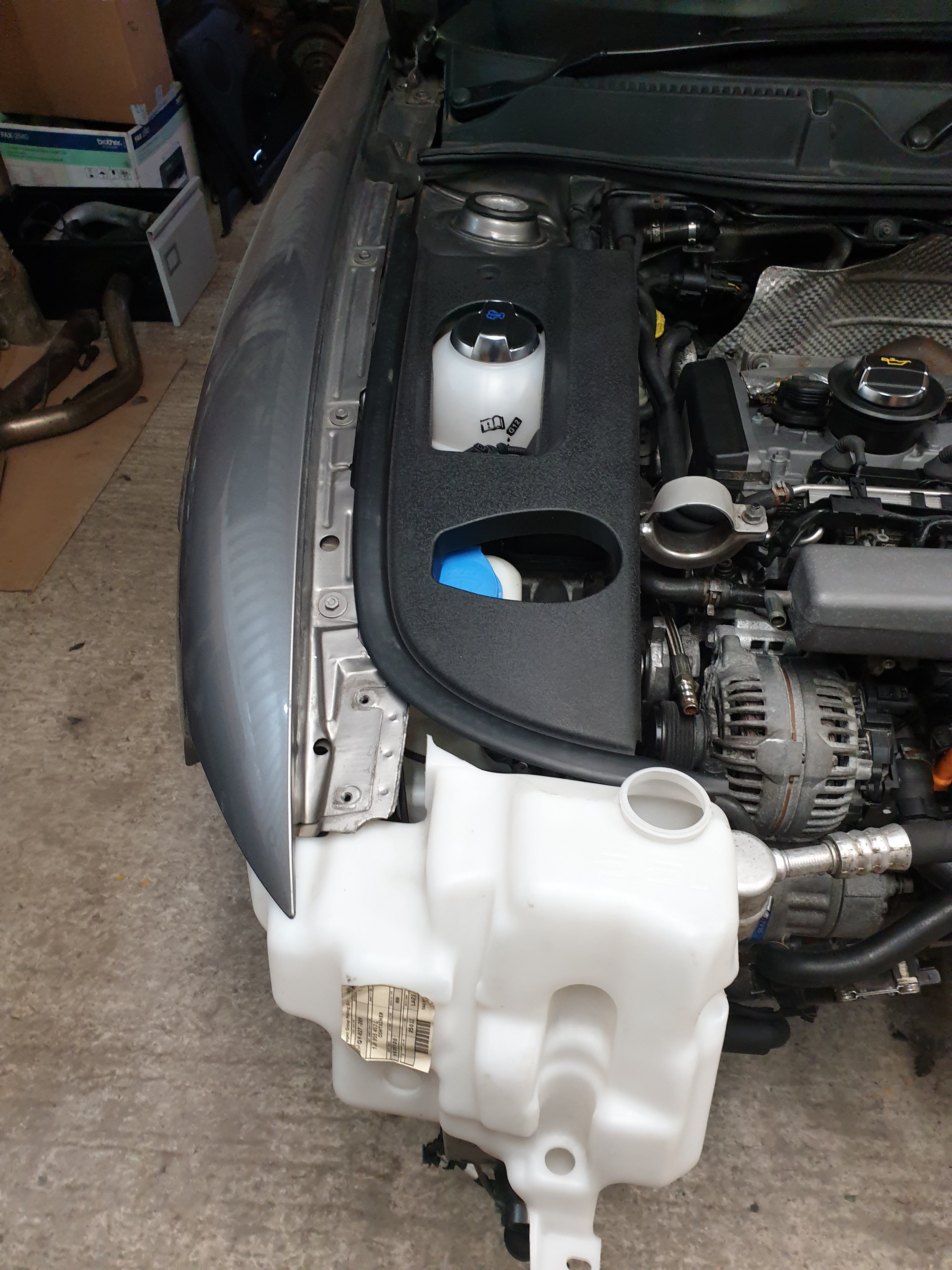

I've also acquired a brand new old stock 5.5L washer bottle from a VW mk4 Golf that would have had been equipped with headlight washers.
I thought I'd take a punt on this one as the Audi S3 5.3L bottle was going to cost almost £50 from TPS where as this one cost me a measly tenner!
From what I can tell the only real difference is the marginal difference in capacity and the second washer pump hole which I plan to bung up as it wont be required.
The larger capacity bottles are needed when installing the cover as the original 3L bottle basically disappears, the filler neck is also offset.

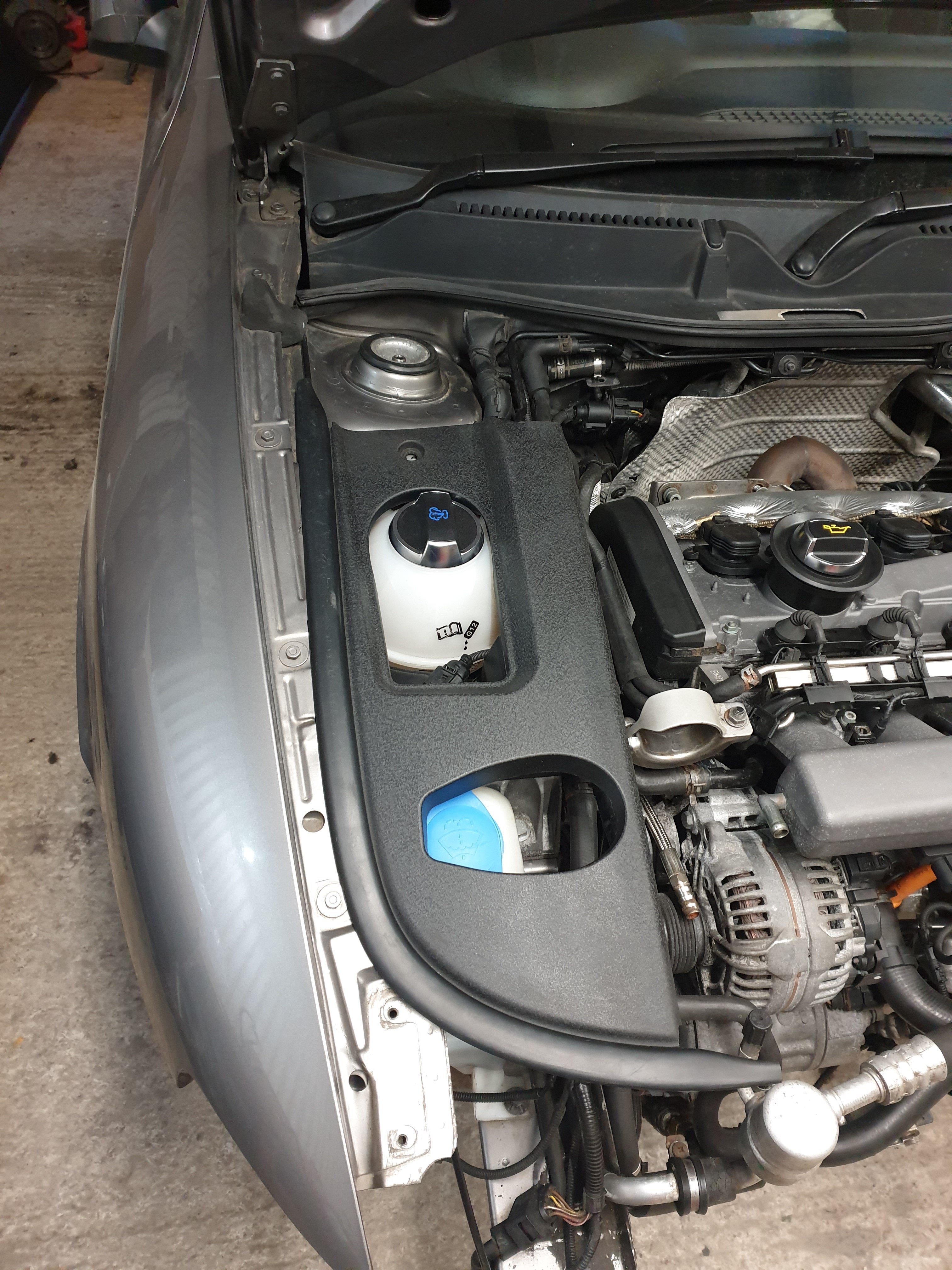

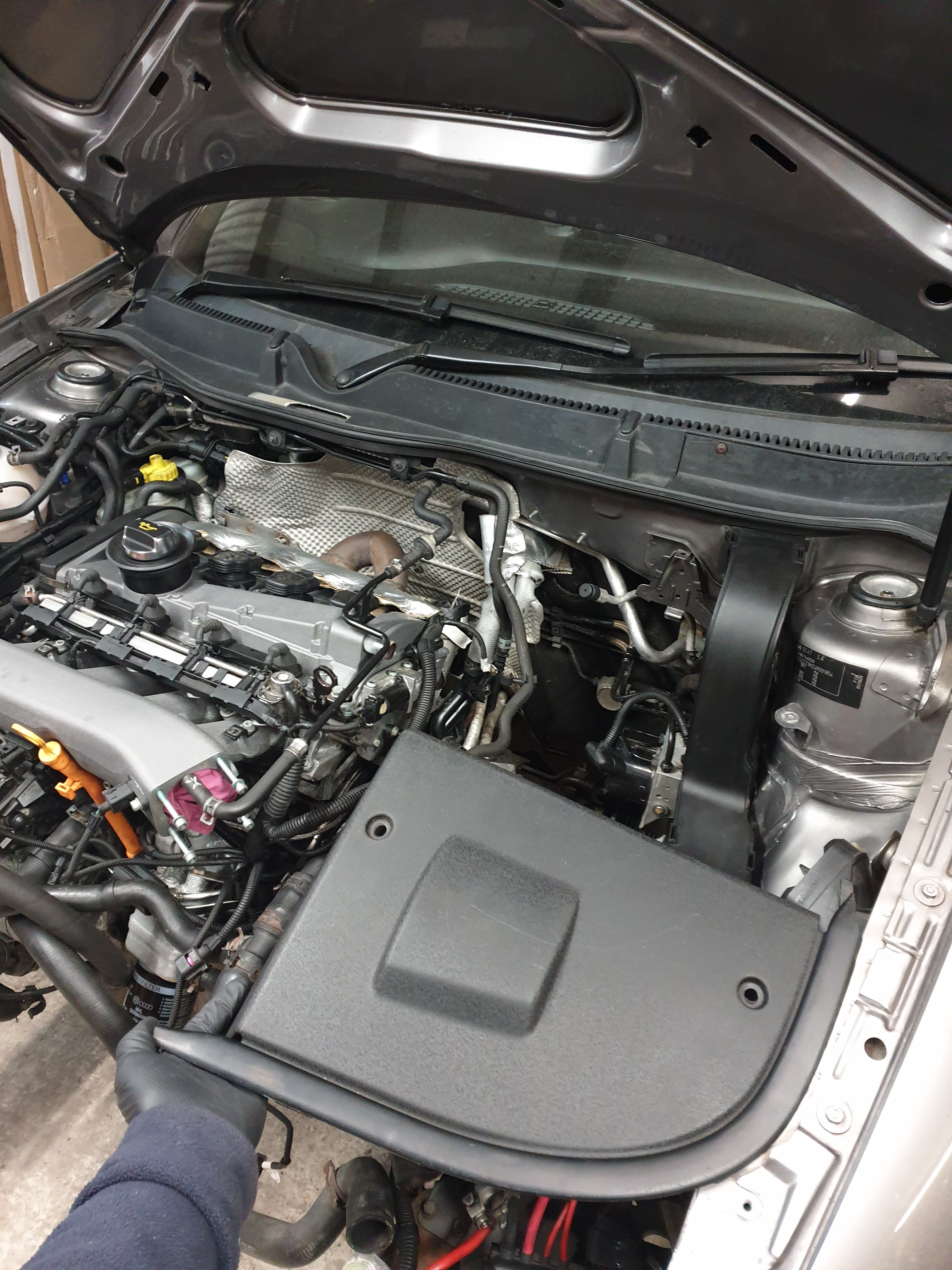

At this point I was itching to start throwing bigger bits at it so go the slam panel and rad pack built up and plumbed in.
I also offered the Audi S3 coolant and battery cover up for a mock up fit which do look good in my opinion but will need to some fettling and shaving to fit properly.
