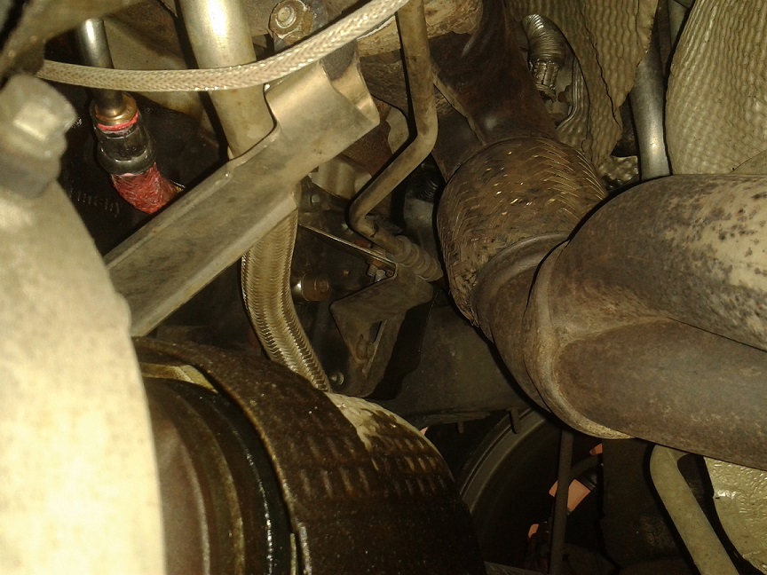

Back when I had my MK3 ibiza cupra 1.8T I was stopped in traffic when it over heated, that turned out to be a blown fuse on top of the battery box, replaced the fuse and topped up with coolant and never had a problem.
With the LCR I'd be changing the temp sender and thermostat to rule out 1st. With mine I checked the water pump and got that replaced too. Other thing to look at are the fans, I noted mine heating up in traffic a few years back and replaced the fans as small fan wouldn't work all the time, purchased them from Euro car parts, never had a problem since.
With regards to loosing coolant check the pipe from turbo to coolant res, mine was leaking due to age.
It doesn't just overheat, it's only after coolant loss which is to be expected on any water cooled vehicle.
All the fuses are good, the fans kick in when needed - with or without air conditioning switched on.
The temperature sensor was replaced about 5 months ago for a genuine one as I had an intermittent gauge flicker.
I'm pretty confident the thermostat is ok as well plus with my colourMFA cluster I'm able to monitor actual coolant temperatures and changes accurately, unlike the user friendly analogue cluster dial on all VAG cars that stick at 90° unless there's a dramatic temp rise or drop.
I will investigate the turbo coolant and oil lines much closer though as these seem like plausible culprits in my troubles.
