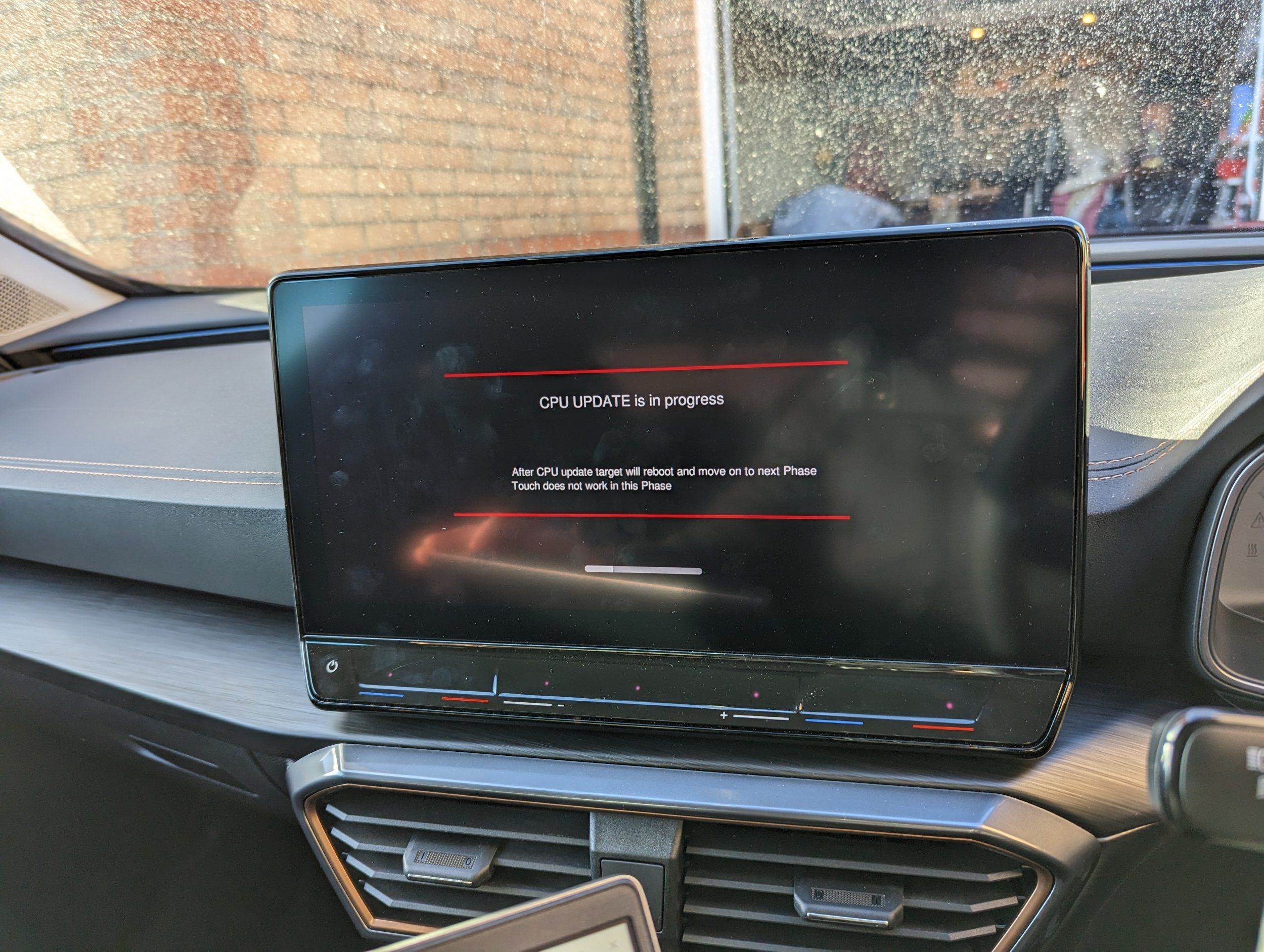

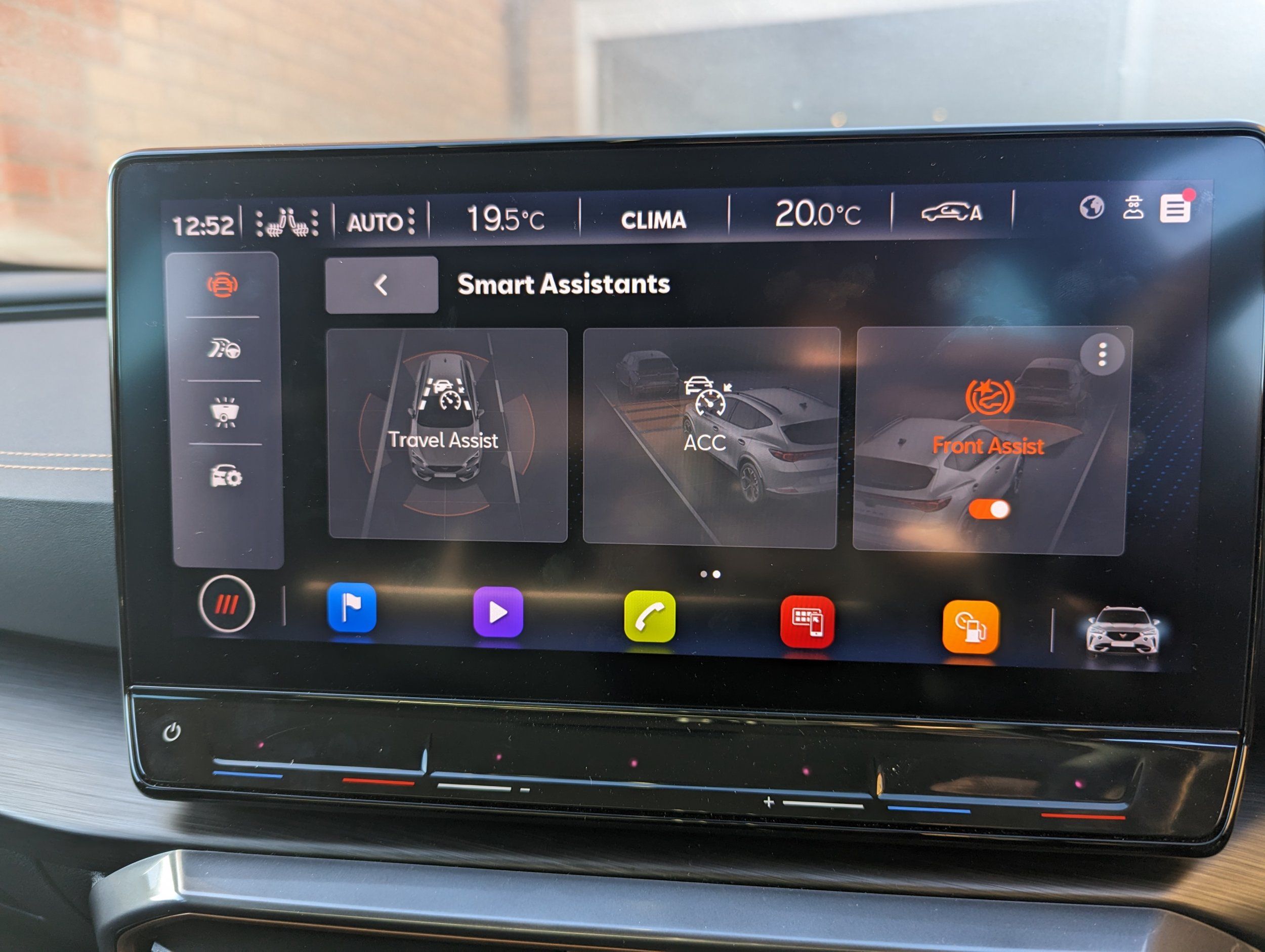

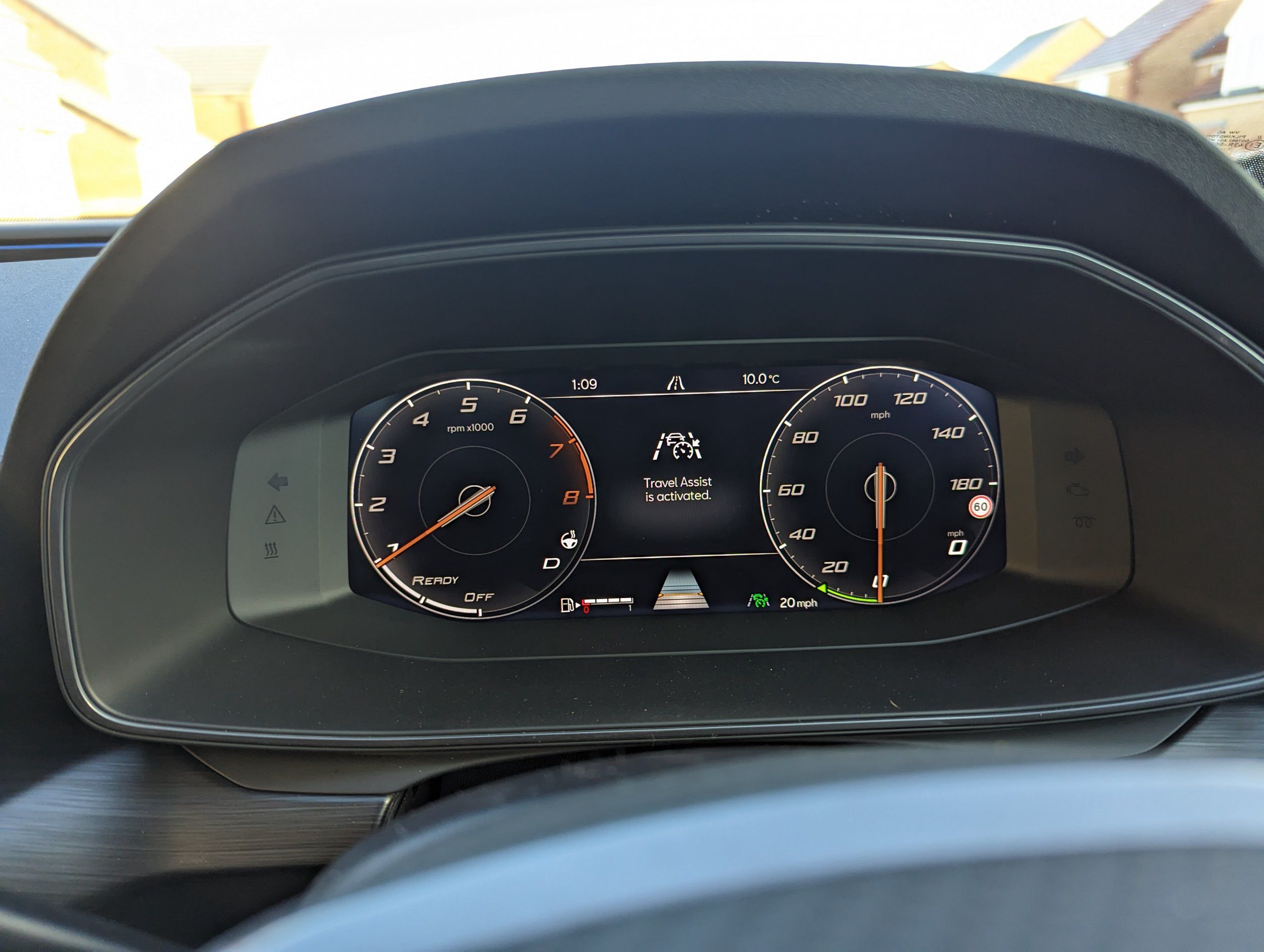

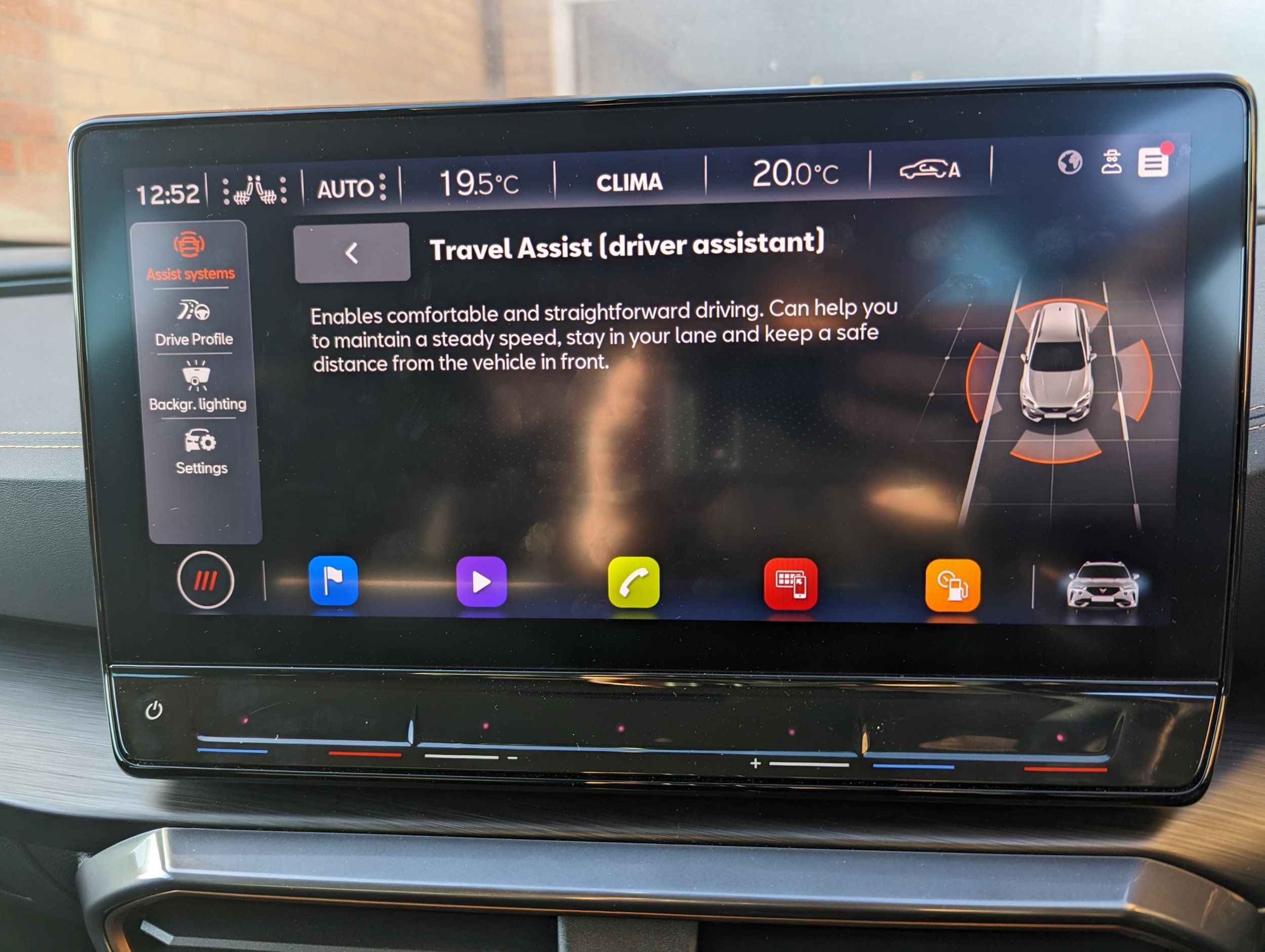

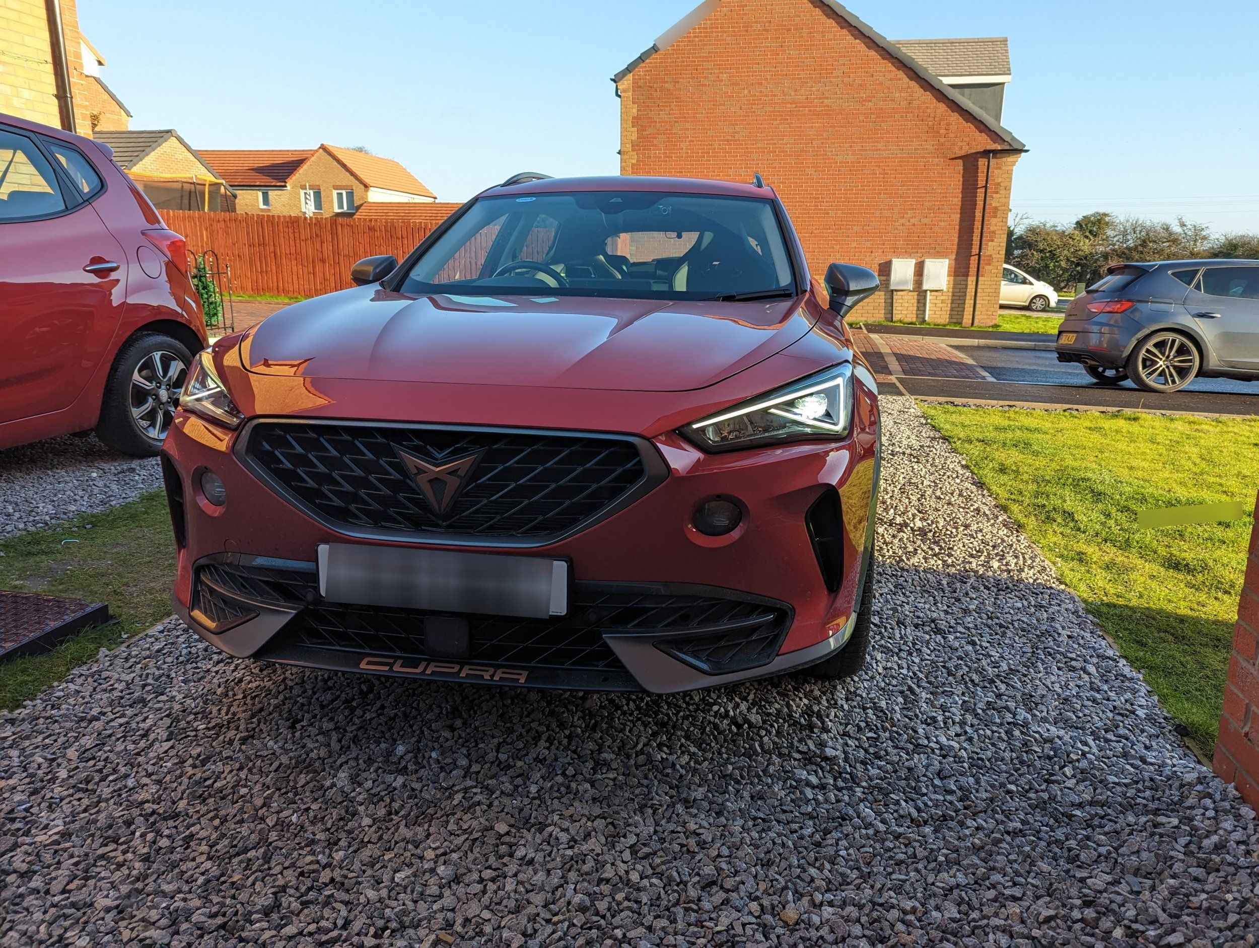

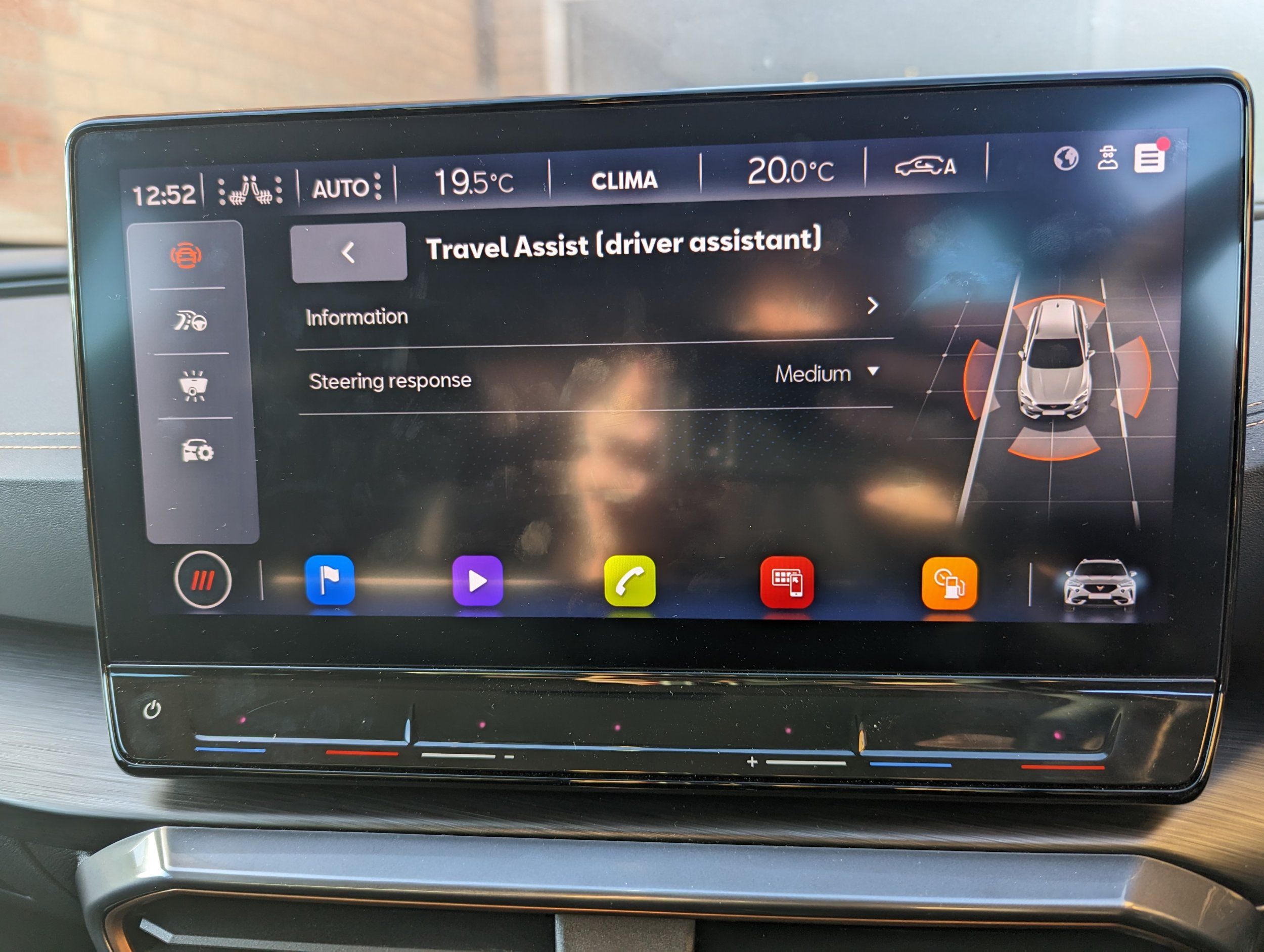

2022 Cupra Formentor fitted with Travel Assist
Completely error free, looking & operating as if factory fit. This is available for the Leon KL & Formentor KM
We also updated the infotainment system to the latest available version (Currently 1899) and recorded this against the vehicles build info.
We are offering this at two different prices, with the option of a used or new steering wheel

That's a nice job but can you help me figure it out why I don't have this "Travel Assist" menu in my factory fitted Travel Assist. I bought a car with XL navi system package and it have all this steering buttons and everything and travel assist work but no option to change the sensitivity or something. Kinda weird.
My Formentor VZ2 didn't show this from the factory either, however I've gone a little further coding wise than it would've from the factory
