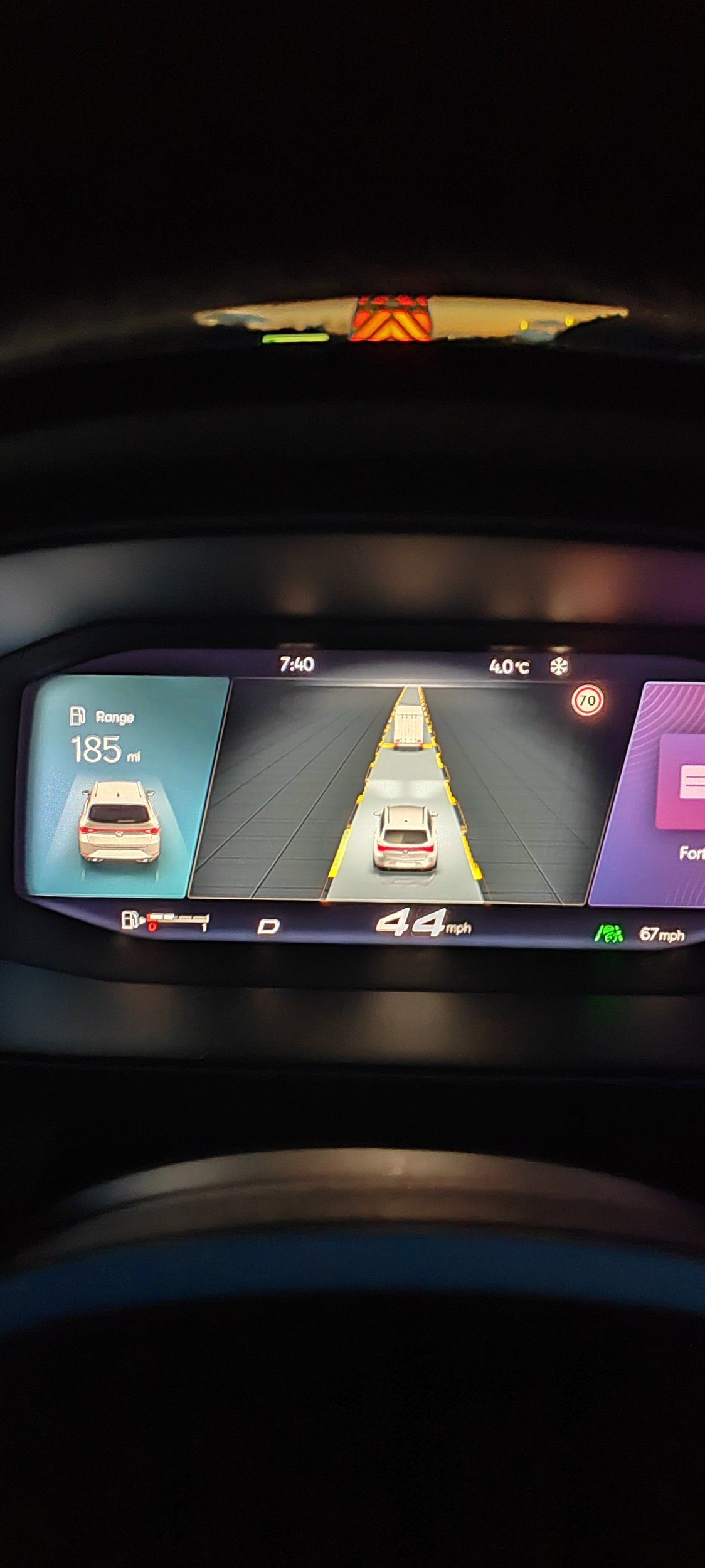

Updated vcds this morning and now 20103 is accepted, just waiting for faults to disappear and will test it later on 😁 for now all seems fine
So everything is fitted, coded and works perfectly thank you for help with security access, such a nice upgrade. Car is excellence lux and should have TA from factory, anyway brand new steering wheel is nice to have. And travel assist plus lane assist works perfect 😀👍

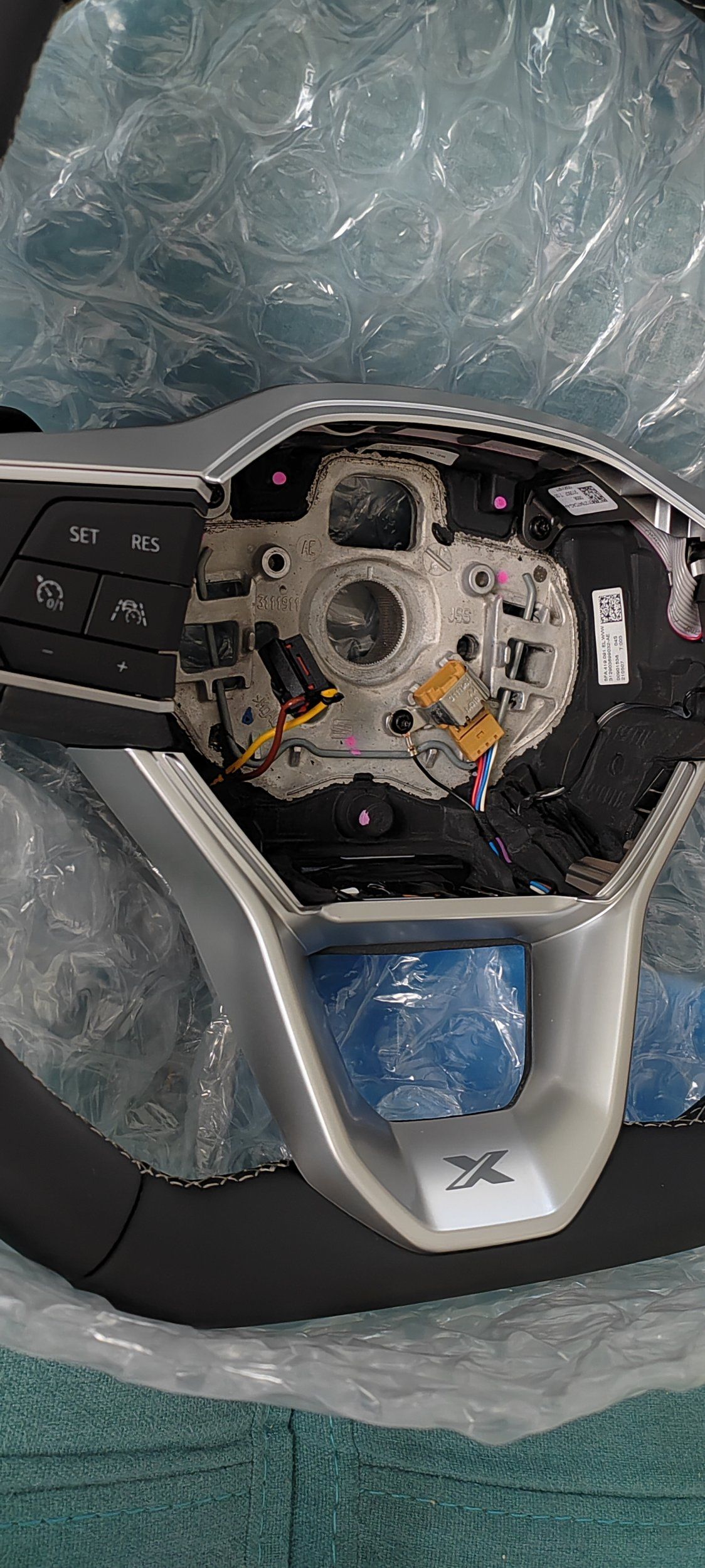

What are the prerequiresits for this retrofit? Like what equipment/model does the car need to have/be?
Leon xLux st etsi
Dec 22, 2021
26
Scotland
To be honest, I did research on here regarding this I'm sure car need to have ACC, heated steering wheel, and probably sign recognition camera. My car is xcellence lux with all of above options. (I think its safety pack M)
I this case all what I needed was the capasitive steering and coding. This won't work if there is no acc fitted.
radiocaf
Jan 16, 2024
13
I this case all is needed is the capasitive steering and coding. This won't work if there is no acc fitted.
I have all of that, although I can't say for sure if my steering wheel is also capacitive. I wouldn't even know how to check.
EDIT: It seems that a capacitive steering wheel will have one of the buttons different to non-capacitive steering wheels, namely the Travel Assist button (go figure, huh?). Now just gotta find out how to source one because @East Yorkshire Retrofits doesn't seem to list the work on their website anymore.
Hello,
We've never listed travel assist on the website, however we still offer it. We'd suggest you source your own steering wheel as this will likely save you some money. Alternatively we can supply a new one. If you send us a message with your VIN we can tell you what part number you need to look for
Thanks!
