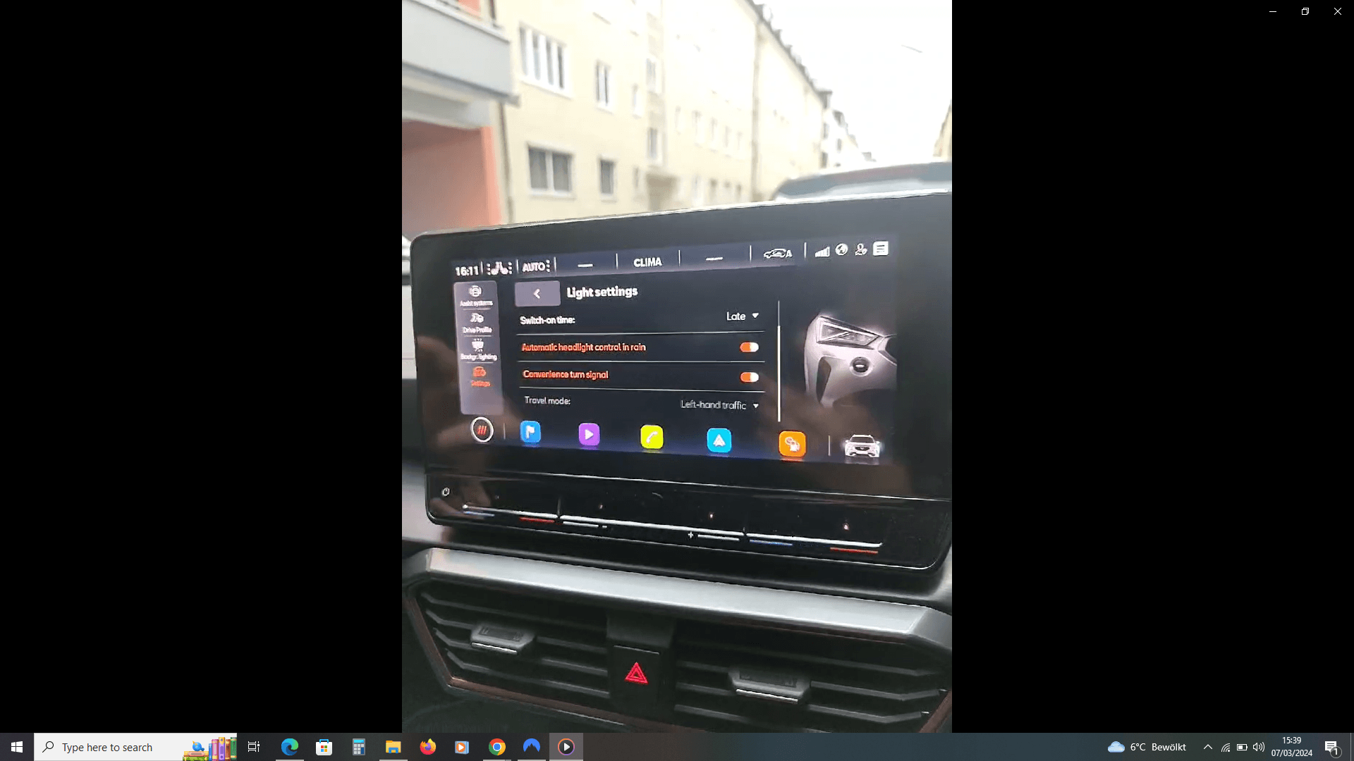

Hi dbbloke,
I'm Currently in a situation myself regarding getting these headlights adjusted/tourist mode on mine aswell. currently been to 1 cupra dealership who charged me 100 EUR and we haven't managed to resolve the issue... are you able to shed anymore light on how you got them to do the RHD and LHD options on tourist mode? my tourist mode seems to be Greyed out. the garage says they can try something but only 50% chance they might be able to sort it..... but still want me to pay 300 EUR feel like they're mugging me off out here! Currently in Munich Germany if that helps.
Hi
Hi dbbloke,
Long Story short I need a TUV to get the car registered on german plates as I'm here for more than 6 months... (Only 9) but can't get insurance on UK Plates I'm told also .... if anyone here can get me a passed "TUV" i'll take it as i know the lights aren't causing problems as nobody's flashed me and the beams quite straight naturally on these lights!
To my knowledge and according to the owners manual - you do not do anything for "Tourist Mode"
Tourist Mode is built in to the lights when they are designed - it means you can go to other countries without any changes to your lights.
Unfortunately doesn't seem to be the case and the TUV (MOT) Centre failed the car on the lights
Shame Facepalm GIF by MOODMAN
So you do not need "Tourist Mode" - you need the car to comply with left hand drive German spec.
I believe to do that - it needs the car to be told it is a German car rather than a UK car.
The problem with doing that is that the rear lights will be incompatible with German functions ( rear fog light changes side for lhd vehicles )
