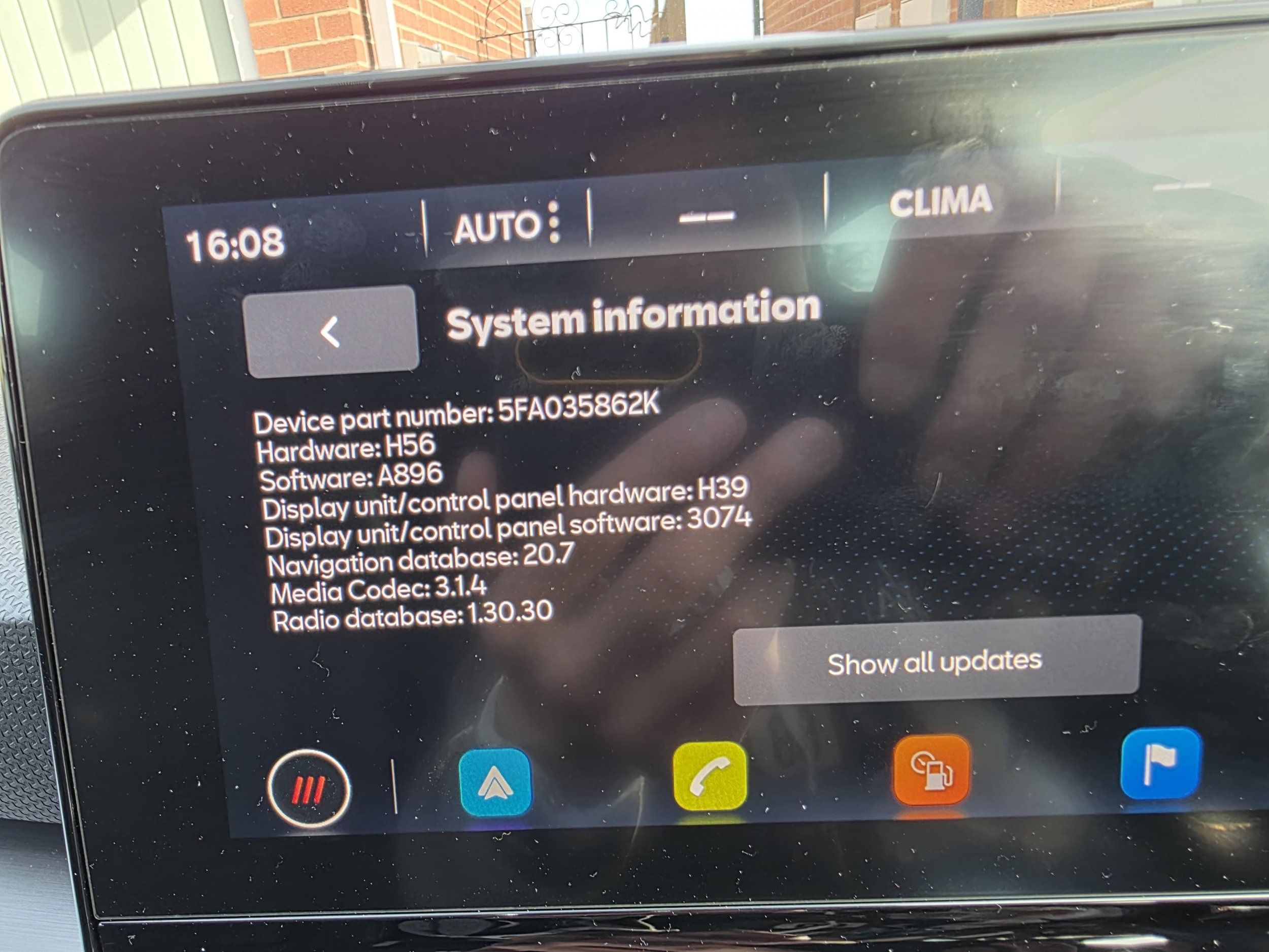

Hello, I just joined you. My name is Tolga and I am writing from Türkiye. I have a 2021 Seat Leon 1.0 TSI style package vehicle. I want to update this multimedia screen but I don't know how to find the files and how to do it. Is there anyone who can help me? Thank you in advance.

I think so. Im currently on A896 but will get around to working out how to get to 1969 and if its possible I do it myself via USB c but all ears if anyone knows. but for now will update my navigation database

Nice, ill look more into it soon as soon as I get my USB C key. Ive done it a few times on my old 2016 ibiza fr no hiccups too and hoping its the same too for the leon. My car seems to be stuck on A896. Have you managed to update to 1969 from A896 fine too mate? And are you able share the file and the process? If not if can point me in the right direction I would be greatful

Thanks for this Teo. I'll definitely take your wise advice and look for a A896/1896 to 1940 first and with a version that has a history of working for the UK versions of the car but this is a good primer of how to get started so thanks again.
