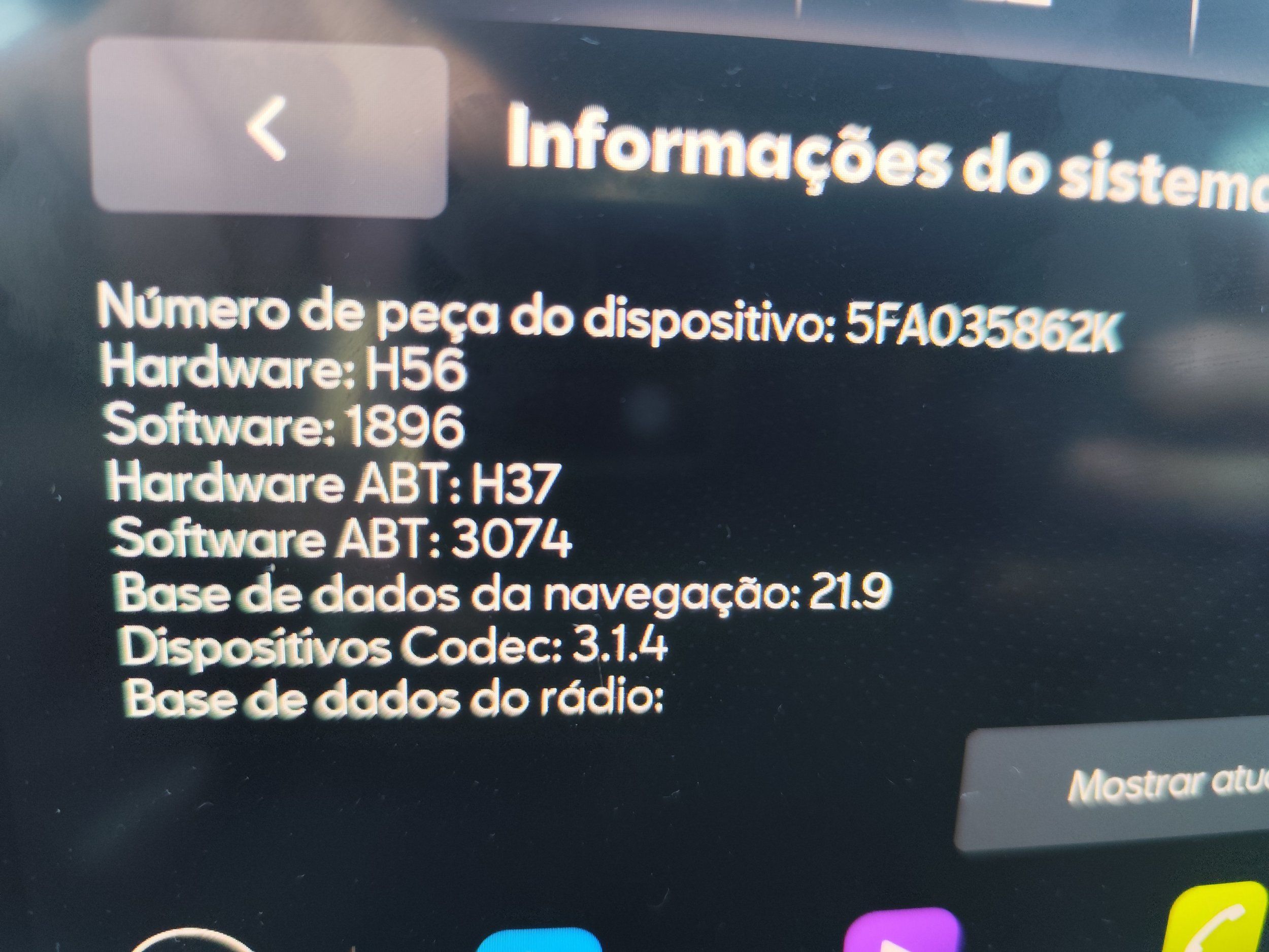

Which Software have the unit?
The only difference is that the maps version is showing now 24.6
And altought I don't have Seat connect app, under the system info I get the warning of an update that is pending (download OUI2 - 138MB) but it never starts do download. don't know if I use my phone as hotspot it will make it work
Is that because the current software gets corrupted which seems to be the case ?. Did the mib3 map update cause it or just unreliable firmware.

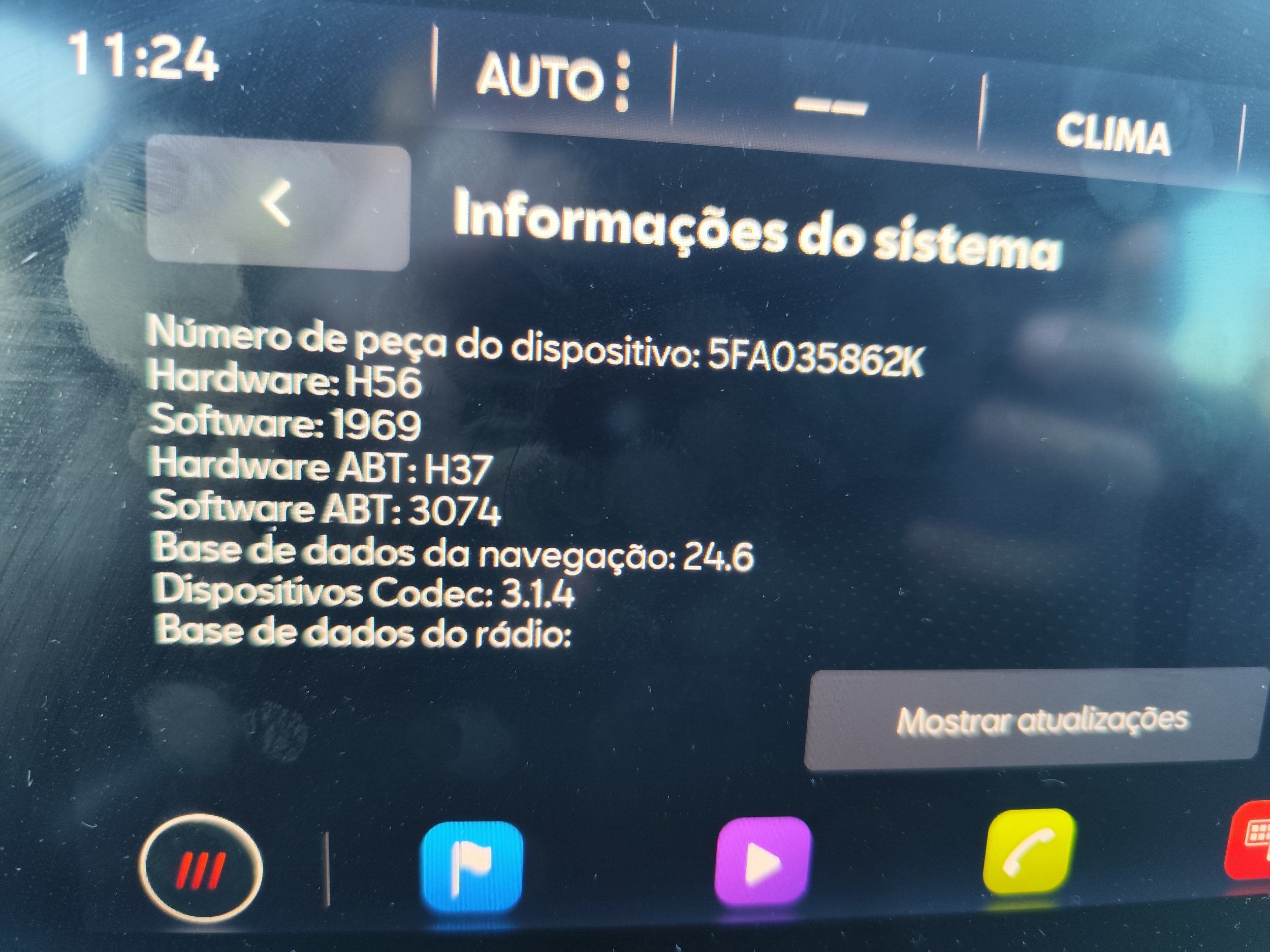

Anyway, going to make the version update to 1969 and see how it goes
Reactions: Tell
Did the update, all went ok. 1969.
Same issue regarding the strange sound coming from the parking sensors.
From the list of the updates 2 were not done, don't know if it has to do with my car version or if it's meant to be

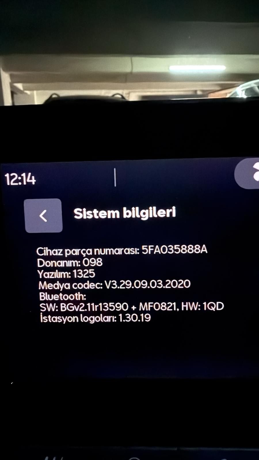

Hello, I just joined you. My name is Tolga and I am writing from Türkiye. I have a 2021 Seat Leon 1.0 TSI style package vehicle. I want to update this multimedia screen but I don't know how to find the files and how to do it. Is there anyone who can help me? Thank you in advance.
