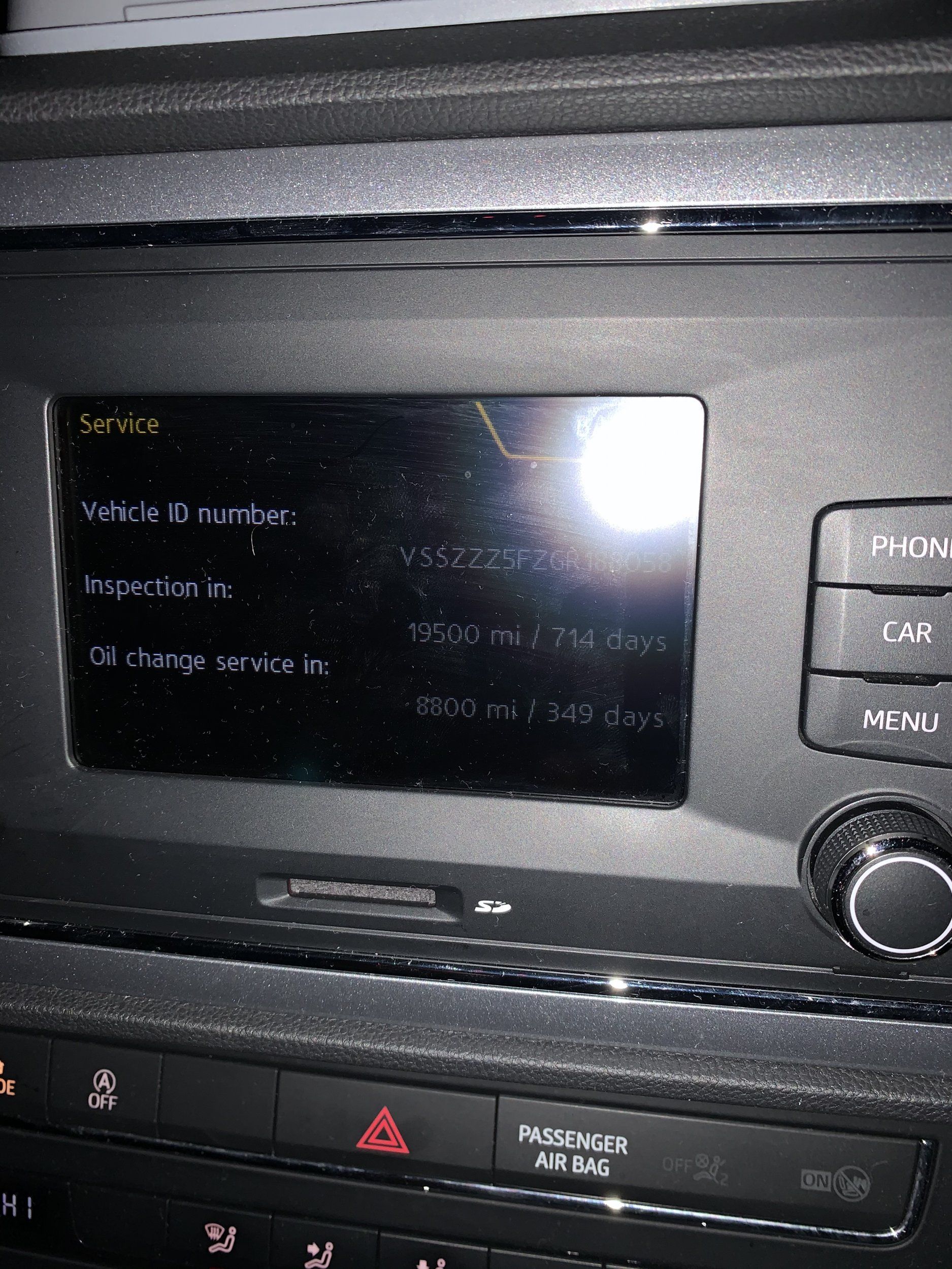

Newbie here. I currently got a Leon FR with a media system and I’ll like to upgrade to a media system plus with Navi plus. Can anyone guide on how to do that or recommend a place that I can get it done. Many thanks

It is long story :) It will cost too much. If you plan to spend such money I can tell you what you need to do. Otherwise it will just take time without any result. You will need a screen, a head unit, connection cables and activation service.

I helped so many users here for the same upgrade. Here is the list you need to buy:
  1. A head unit with navigation. Units with navigation easy to unlock and activate functions. If you buy a unit without navigation it will be so hard to activate functions. Possible part numbers: 5QA035846, 5QA035858
  2. Screen. It can be 6.5" or 8.0". Depends on your choice.
    8.0" screen part number: 5F0919606;
    6.5" screen part number 5F0919604
  3. LVDS video line cable for the connection between screen and unit. Can be purchased from aliexpress for cheapest price:
    Link: Buy from Aliexpress
  4. CAN data and electric transfer cables. It is not being sold. I can prepare it and send to you. Cable with socket costs €25 + shipping.
  5. You may move existing main socet into glovebox. No need extension cable.
  6. A new glovebox which has a compartment for MIB head unit or you may cut your existing one for cable entrance and place head unit on the plastic tray.
  7. When you run system it will drop into Component Protection. No sound will come out. No functions will be able to be used. So you must buy activation service for removing component protection and activating all functions. I do this job only via SD card.
    I prepare an SD card for your unit, you insert it into unit, run a system update and your system will be unlocked!
    You can use it forever and update your navigation maps for free, lifetime.
Any further questions feel free to contact me.
