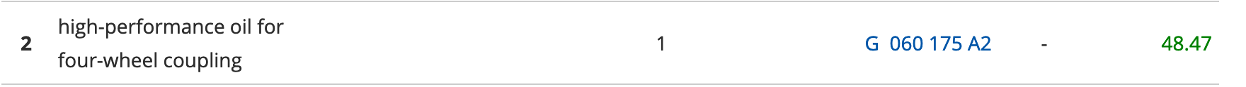

Can anyone please confirm the oil spec please I have ordered 850ml of G060175A2 is this correct as TPS were unsure as they do not have a workshop ,manual?

Erwin is the Electronic Repair and Workshop Information service from SEAT A.G. for independent garages, I presumed as you work for a VW Commercial garage you would have access to this sort of information along with ETKA.
anyway this link (for my car) https://nemigaparts.com/cat_spares/etka/SEAT/le/754/409370/ confirms

It is G060175A2 oil for the front VAQ. It can also be used on the rear haldex diff unit.
Febi 101172 is the same oil but under £20 per bottle.
Thanks bud yeh thats want we ordered then realised we could get it cheaper than TPS then having the part number found we had some already so not even paying for it lol. Occasional perk of the job!
