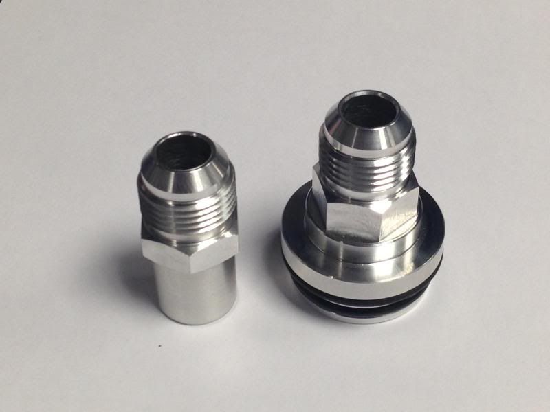

I bought it second hand (and have since sold it on) but it's an INA part to let u fit an r32 throttle body

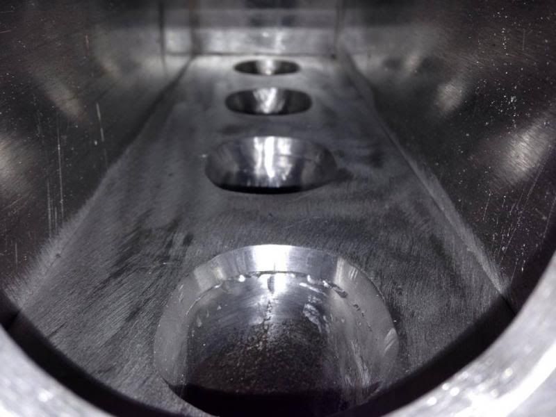

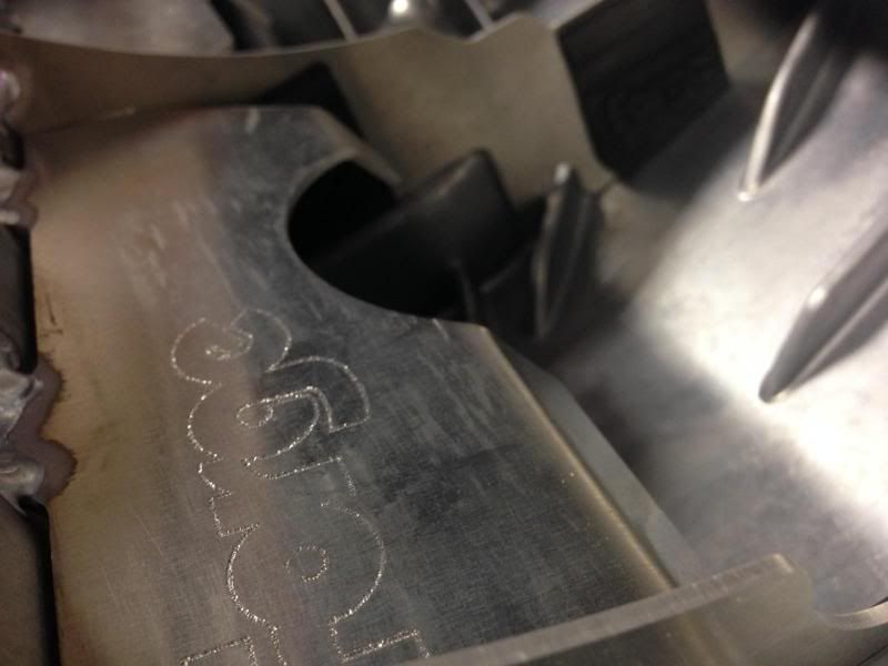

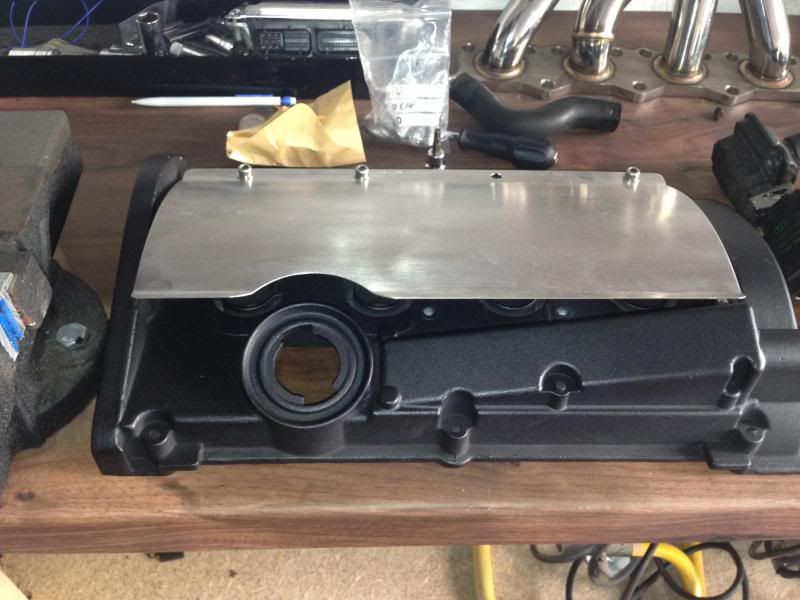

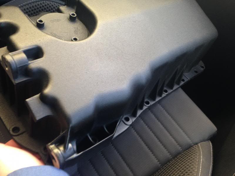

Got a new cam cover as part of the deal. The relentless needs a bit of porting work
And this would be as well going on the relentless :D

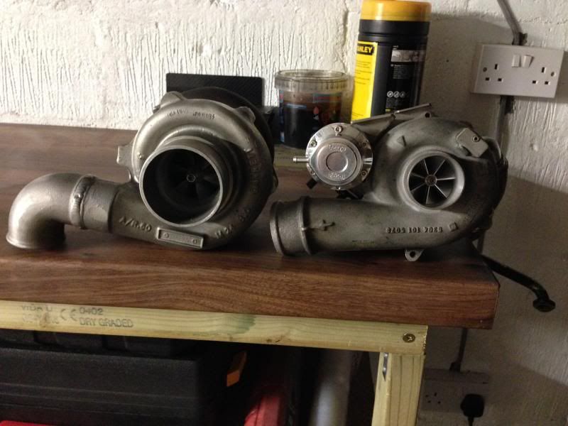

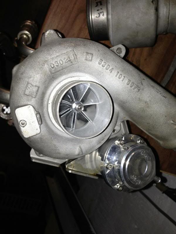

Beach Buggy Turbos '7+7' hybrid turbo

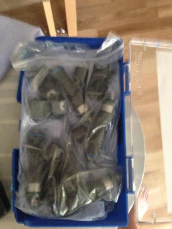

So we'll need some more fuel
Bosch 550's

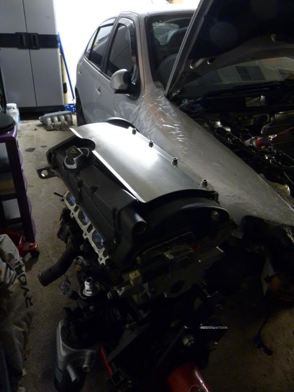

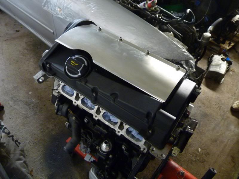

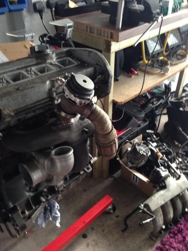

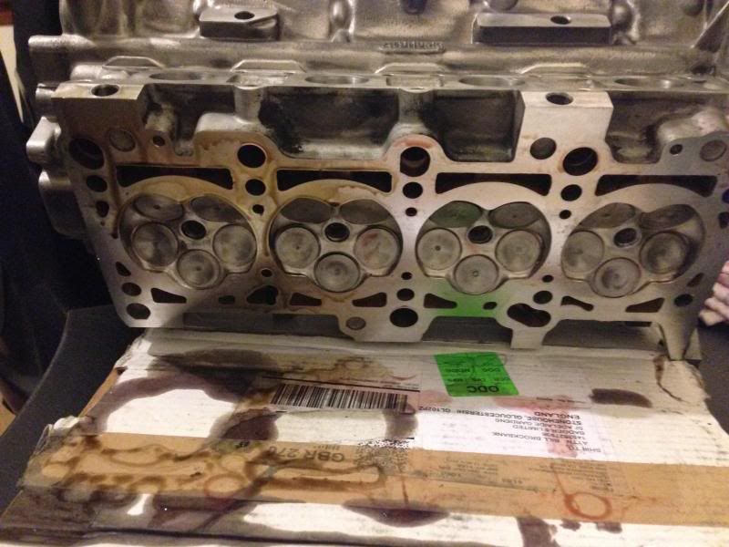

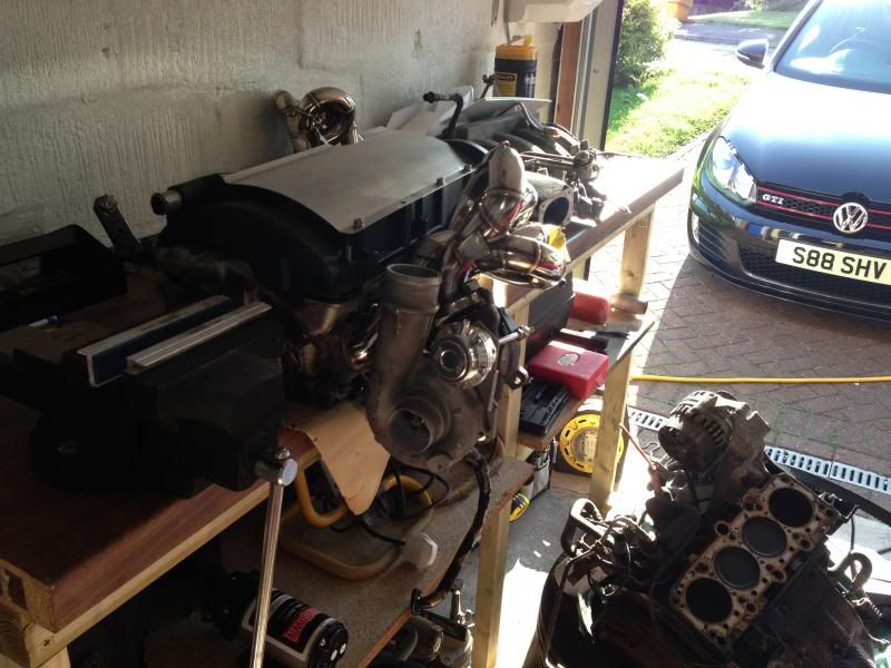

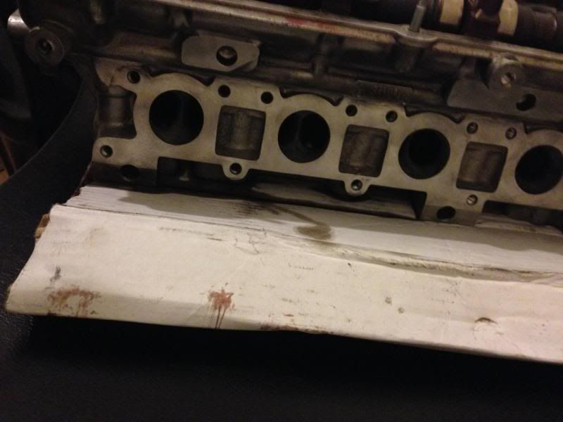

I bought an AEB largeport head, and thought I would mock it up to see how it looked

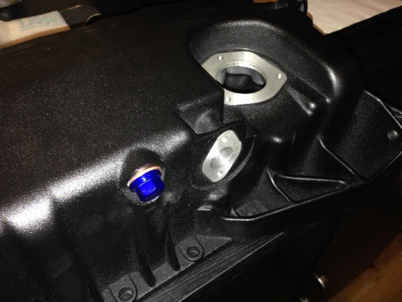

Then I bought a nice new block
Complete with a couple more shiny bits :D

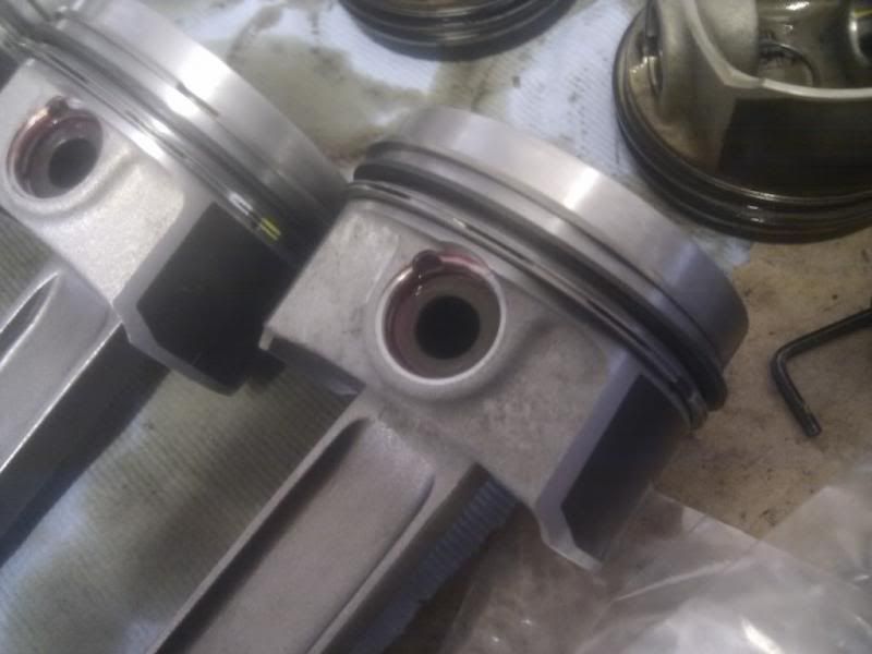

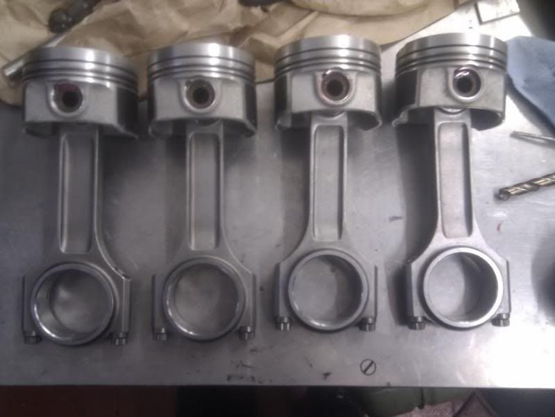

9.5:1 Pistons
Brute rods
New Rings
New oil pump and pickup
Then a fairy brought this to my house

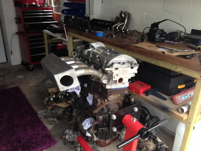

So a bit more mocking up
Some of you may notice the lovely purple garage rug :lol:

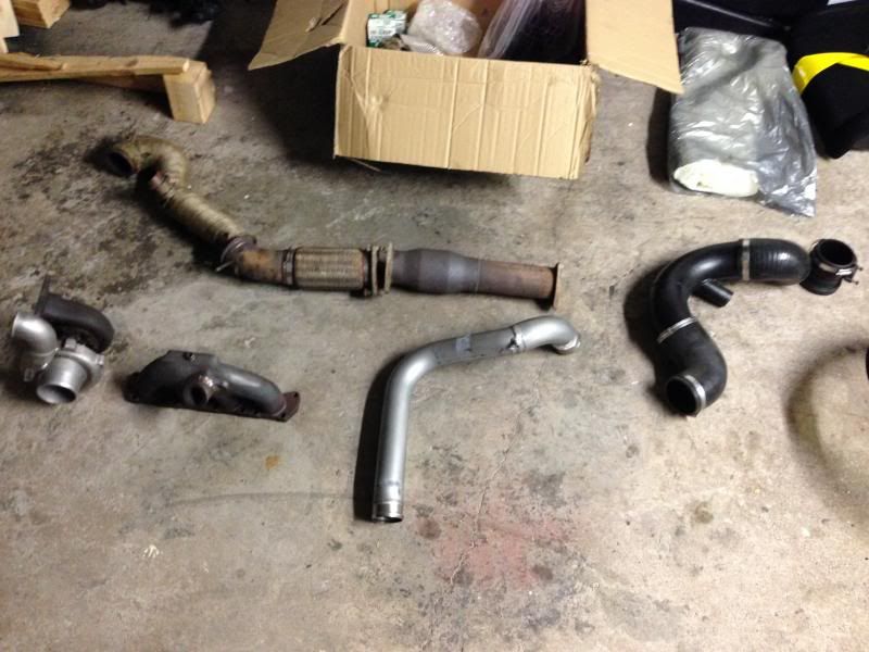

Now back to my own build - as unfortunately that GT30 is destined for another LCR :cry:

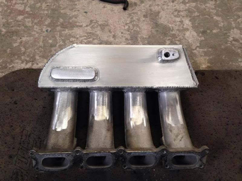

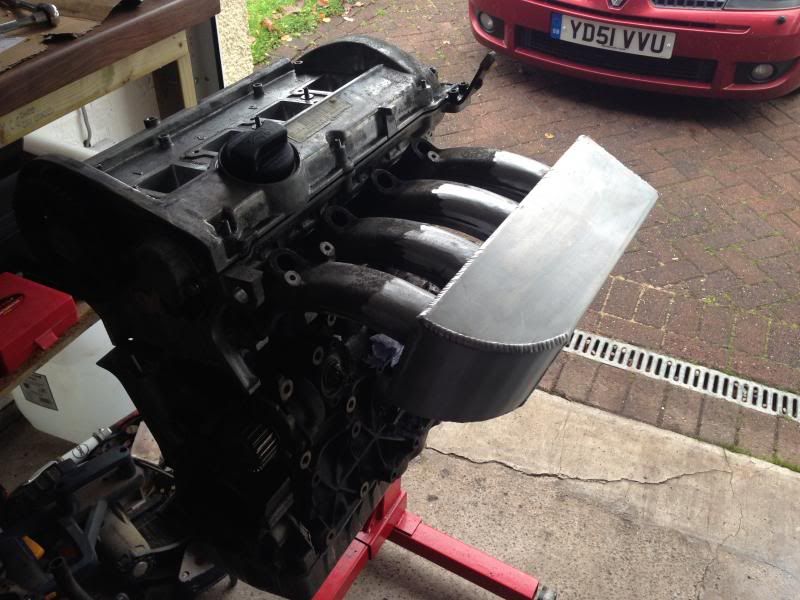

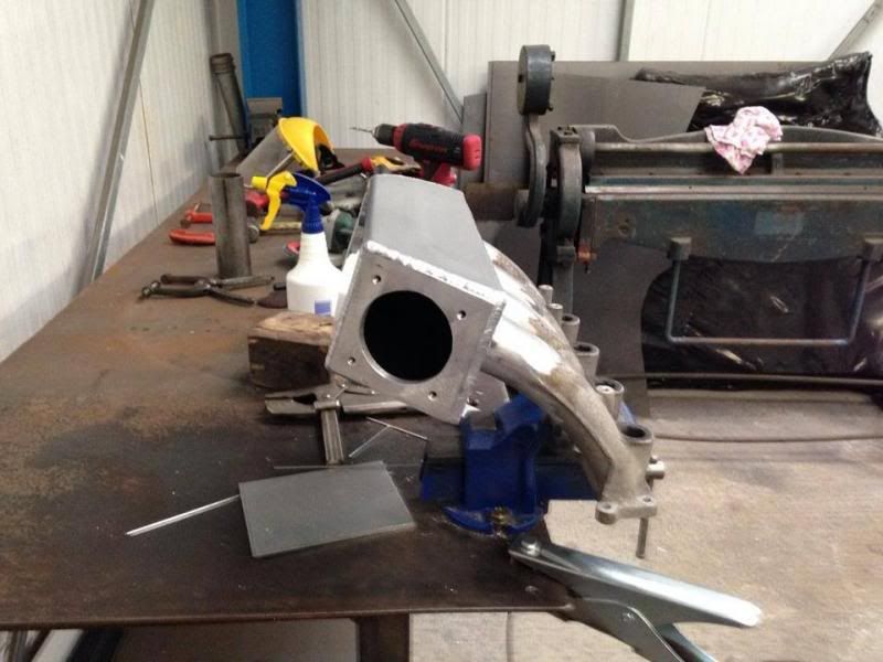

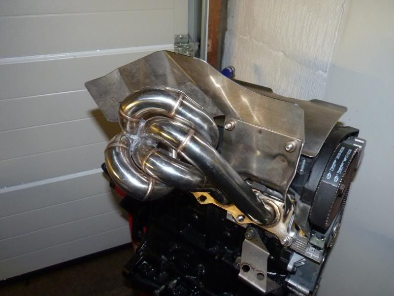

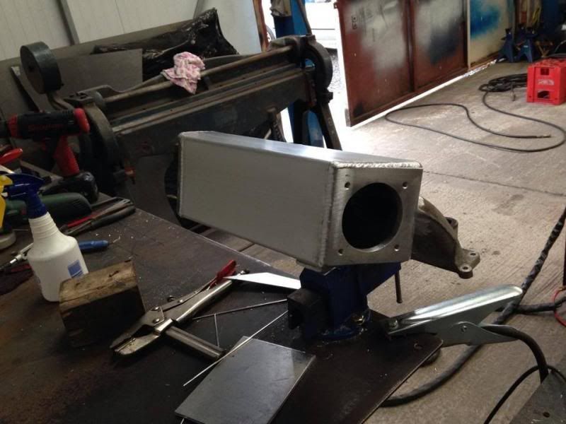

A largeport head won;t be much use with a small port manifold.

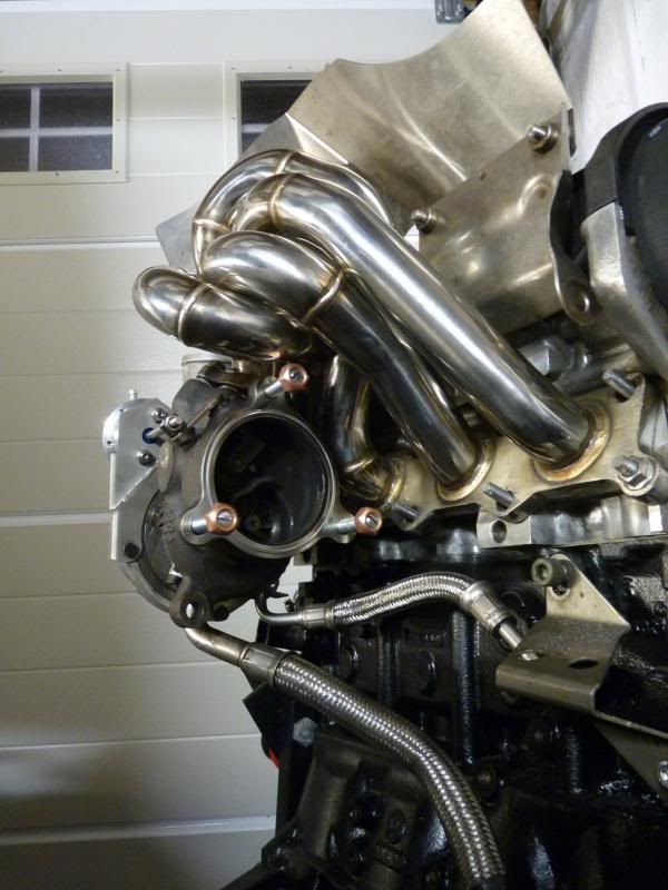

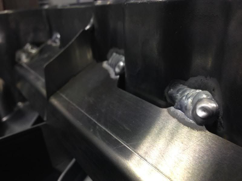

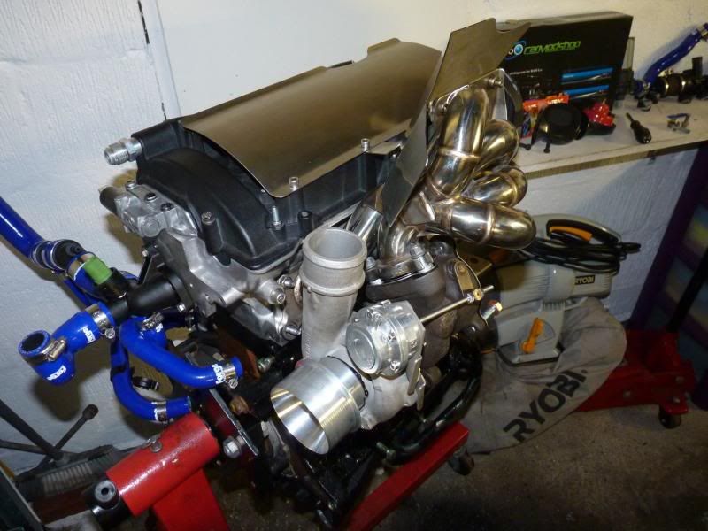

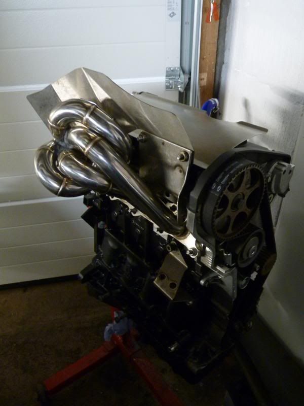

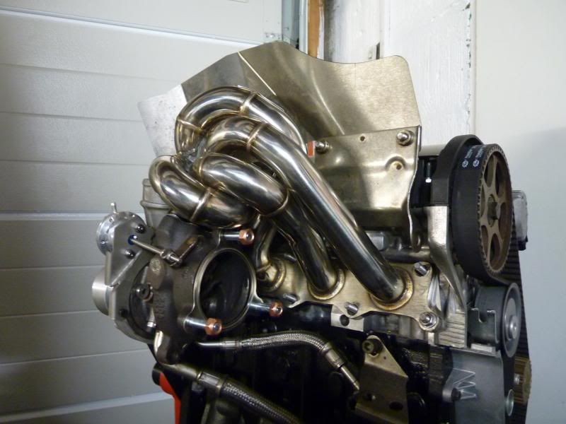

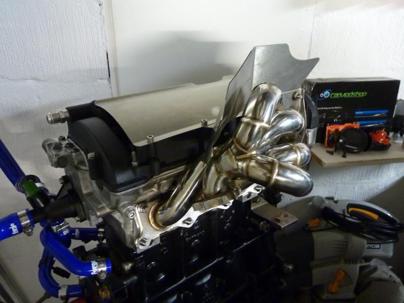

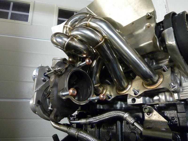

So a huge thanks to Scott McMinn motorsport for knocking up a manifold in under 24 hours :funk:
And test fitted
This will be off for powdercoating soon, I need to get a wee bracket added to it first. Its a shame to hide that awesome welding but raw alloy looks too wrong in that position

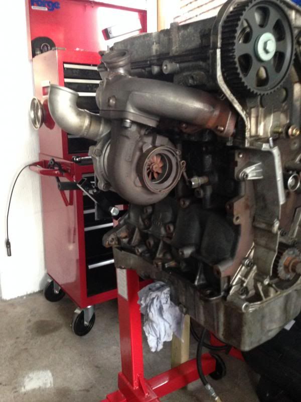

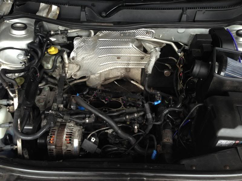

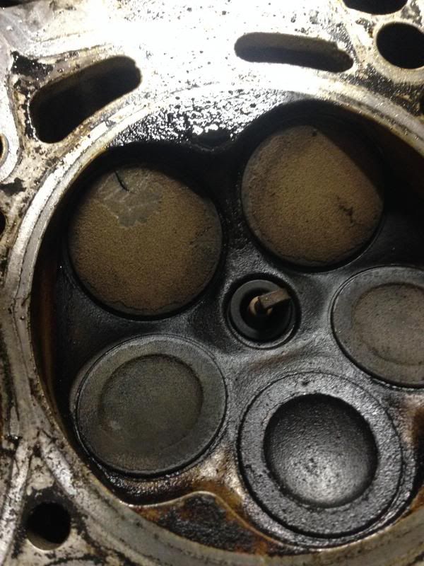

Started to strip out the old engine (need all the ancillaries off it, after they're painted, polished or powdercoated ;))

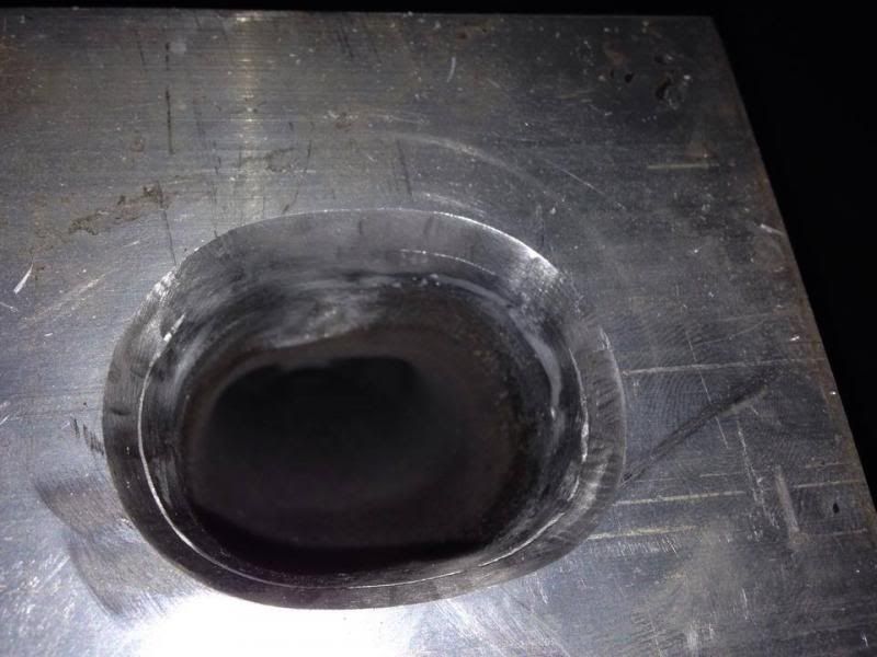

Looks like I was fairly lucky
All in all, 2 cracked valves, cracked mani and cracked mani to turbo gasket. None of that could have been helping power output. Thats the downside of tuning a high mileage engine I guess :lol:

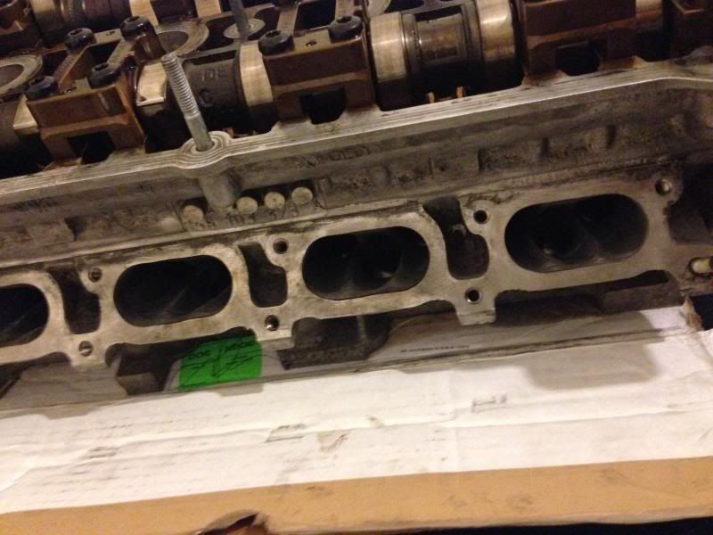

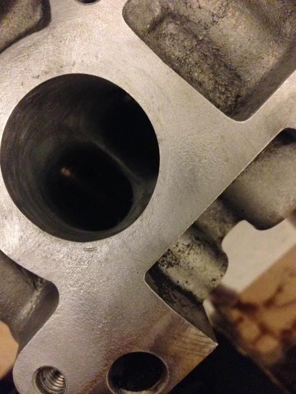

So I sent the AEB head off to ALD developments for a port and polish, plus fully rebuilt with new valve guides, seals etc

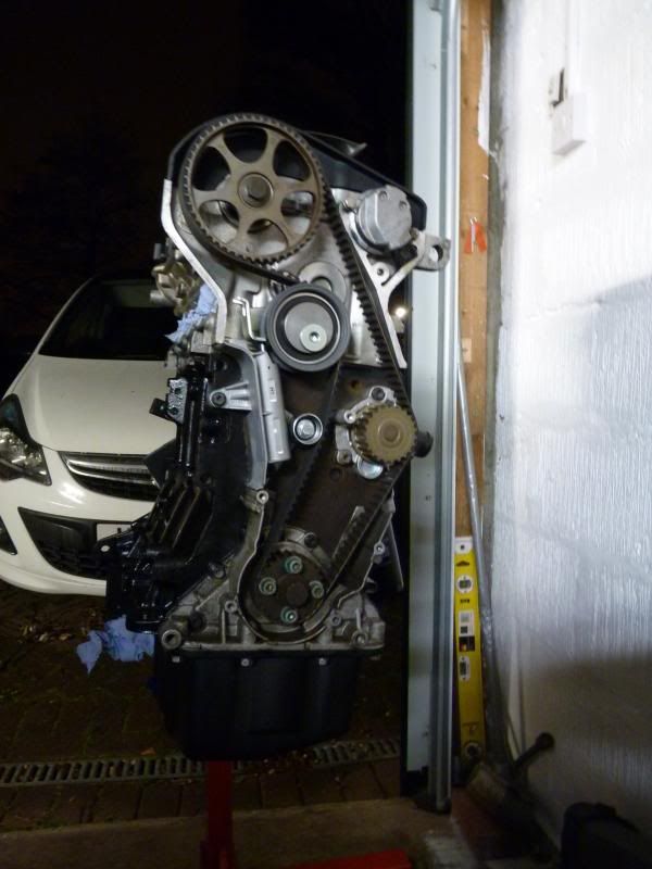

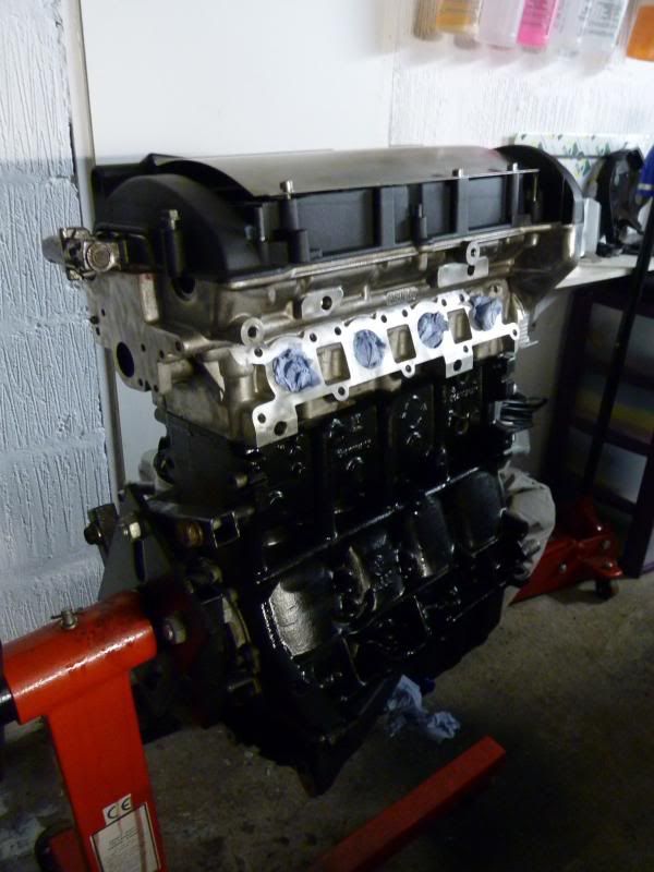

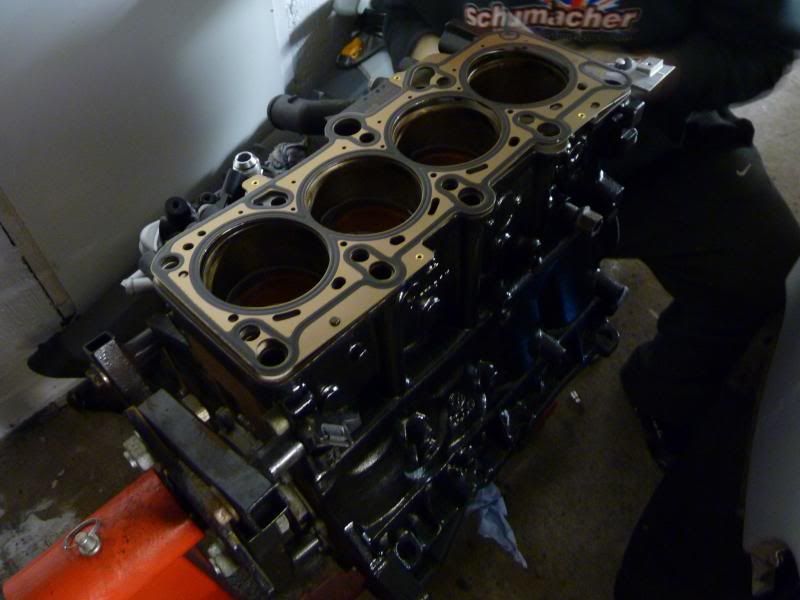

So now I have the majority of bits, It was time to get cracked on with building the engine

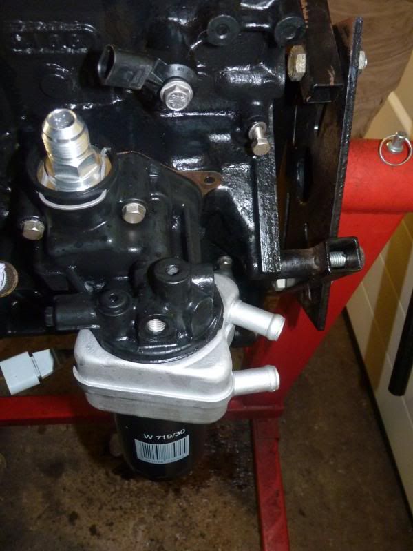

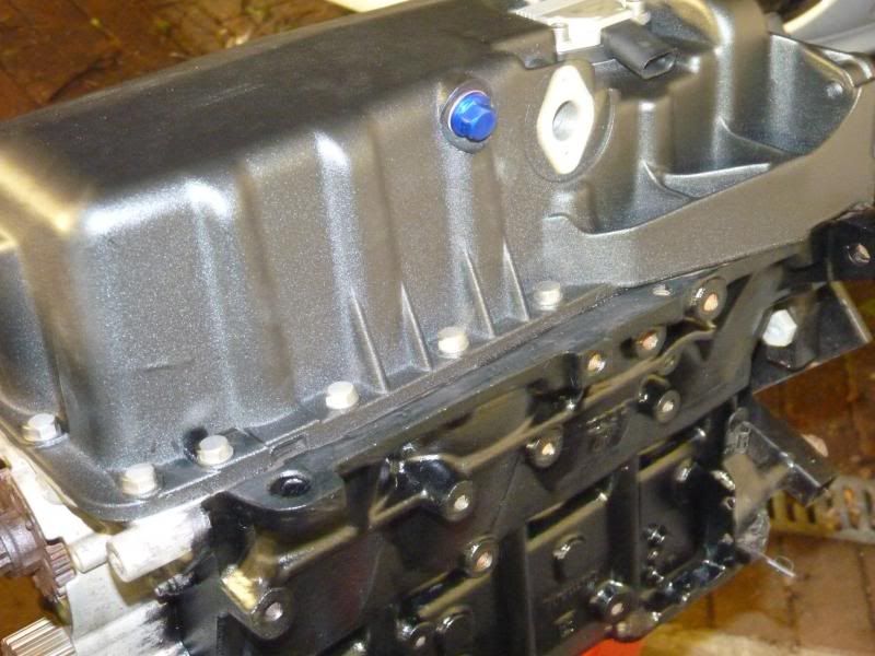

The observant will notice that I painted the block. What a horrible couple of days that was with a dremel to remove all the old paint and rust :(
The filter housing looks really bad in that photo. I assume its condensation. It was -3 or so that day

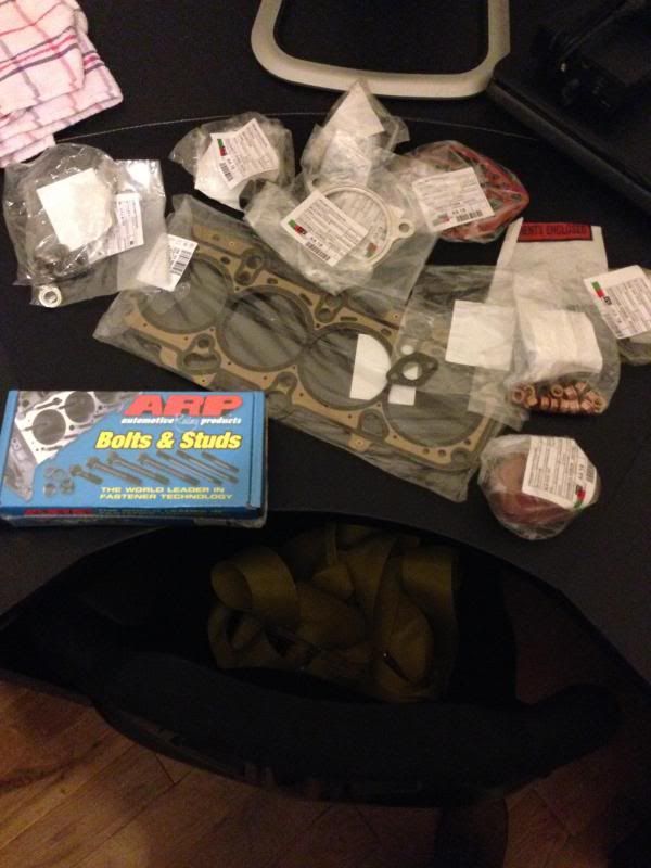

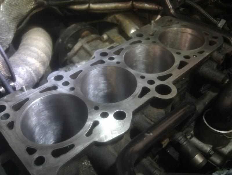

New Head gasket. Couldn't get phots of installing the head bolts as it took one person to tighten, and one to hold the engine from moving :lol:

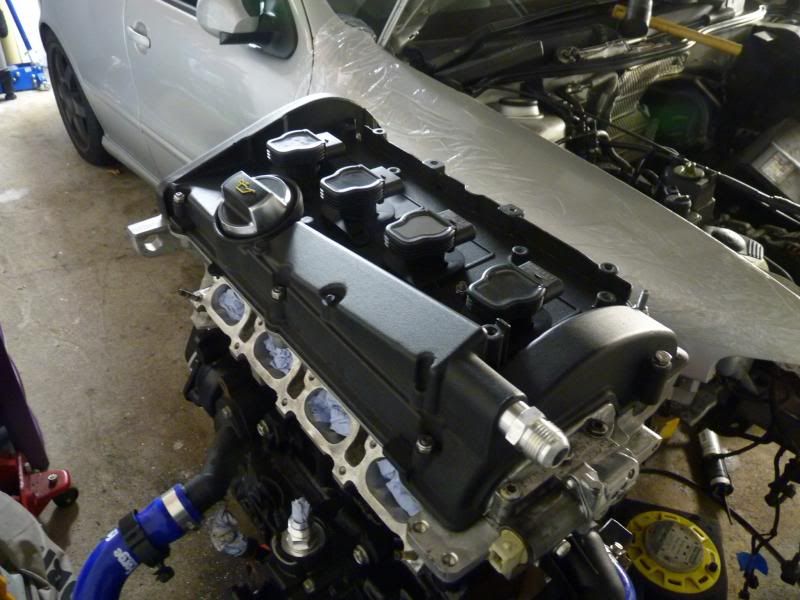

And timed up

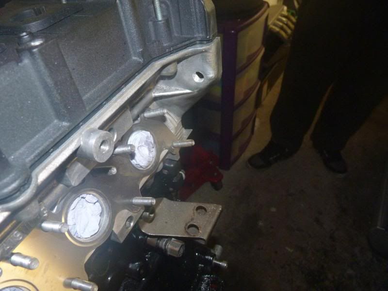

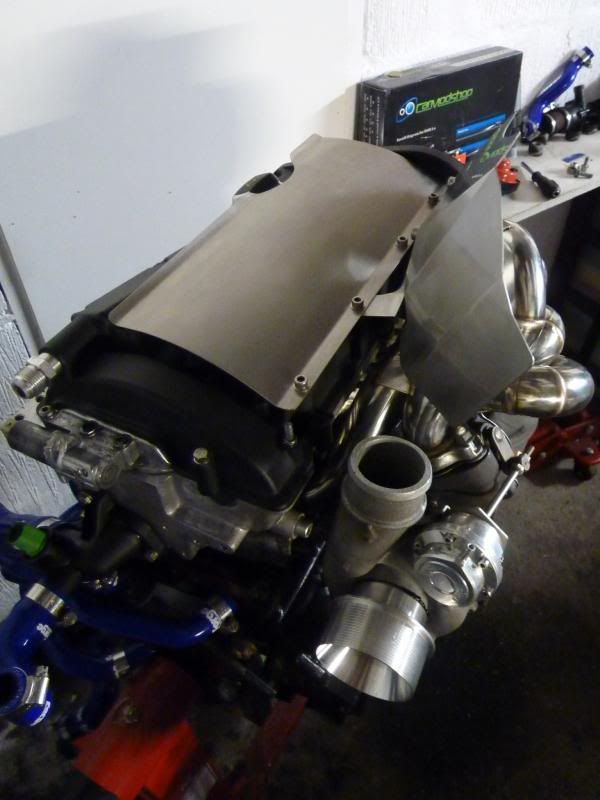

Head drilled out to take K04 heatshield
So thats where I'm up to.
I'm currently waiting on a batch of brackets back from powdercoating, and a few other bits and pieces arriving.
Plans are to have the engine fully built up over the next two weeks, and installed back into the car over the Xmas holidays. I'll hopefully keep it updated in future :lol:
WOW! Mega impressed. You not head wrapping or ceramic coating the manifold?
I haven't really decided yet. I'm told wrapping them isn;t a great idea, and depending who you believe, neither is ceramic coating. The coating compaines suggest its a great idea. A lot of tuners don;t as it holds the heat in the manifold rather than letting it escape.
If I could have it black ceramic coated, I'd probably think about it, just for the looks if nothing else :lol:

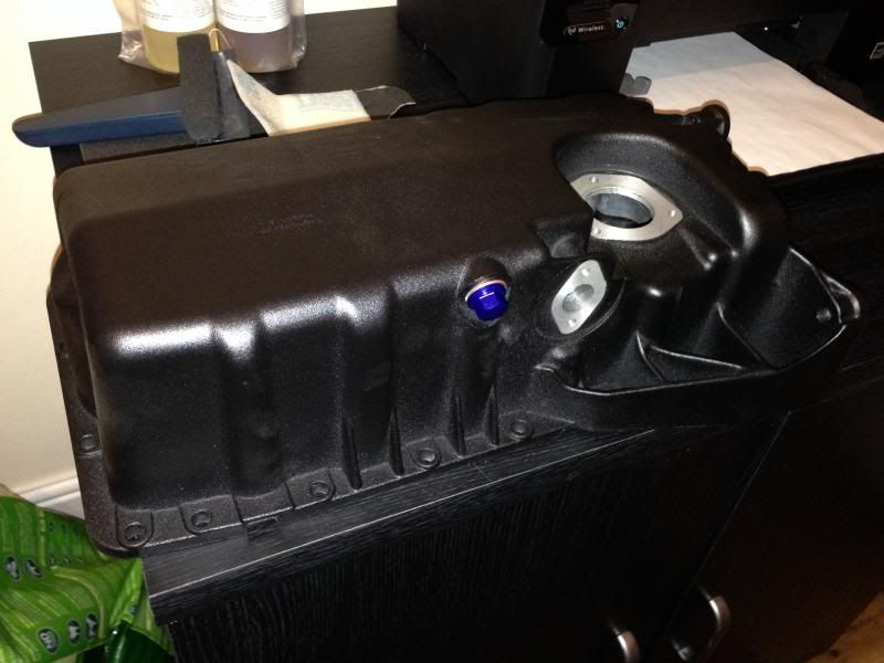

Small update for today.

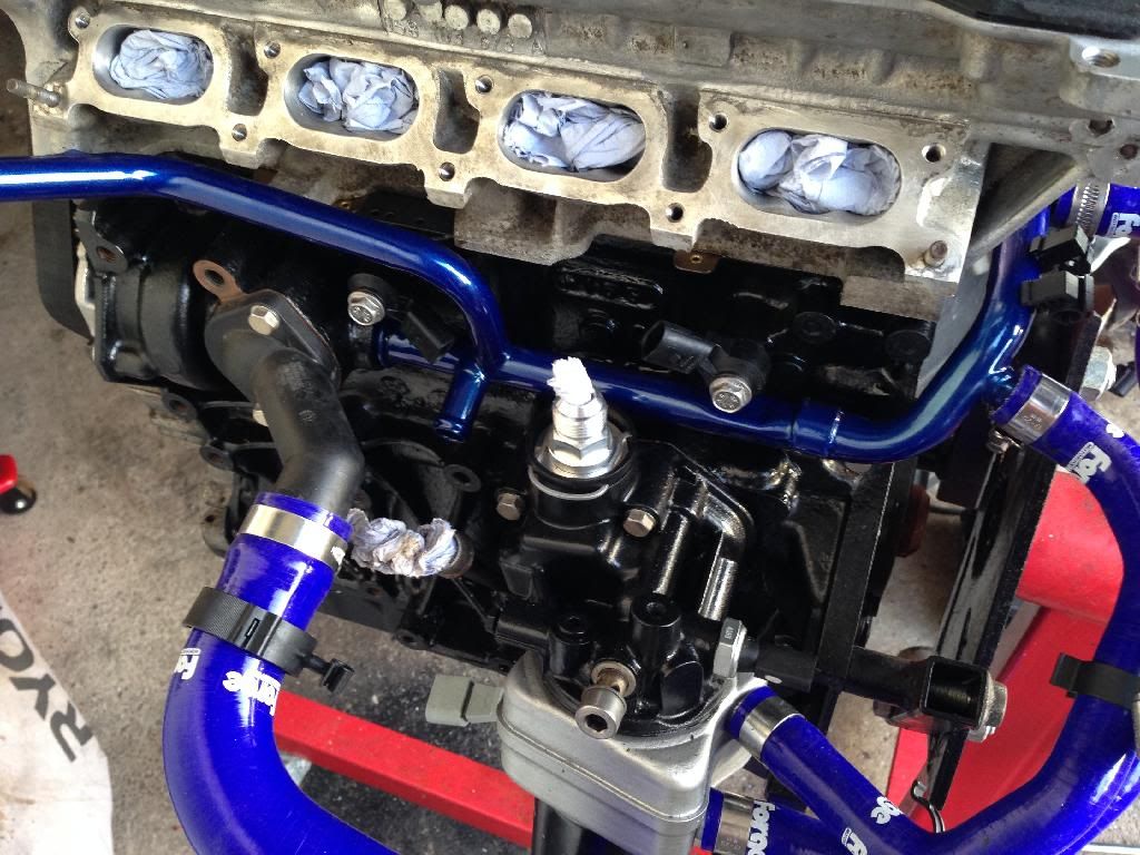

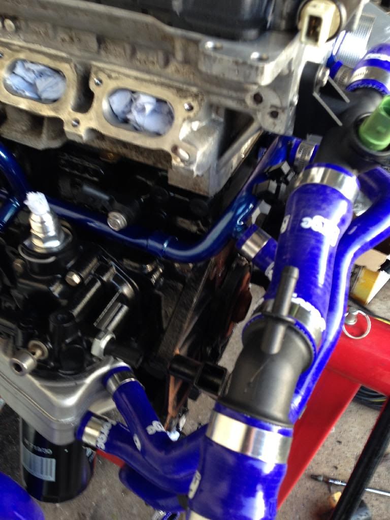

All my bits are back from powdercoating. So new coolant hard pipe on

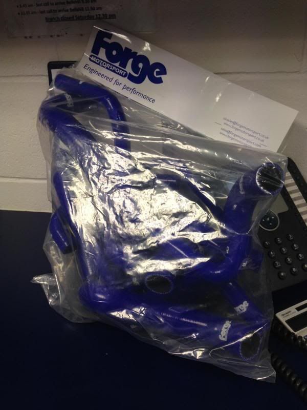

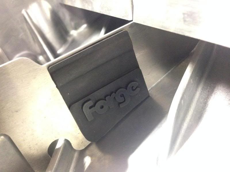

New s3 coolant temp housing (forge hoses won't work with the LCR one)
And all the coolant hoses connected.
Just waiting on a silicone blank for the hard pipe and I can start fitting the alternator etc back on
