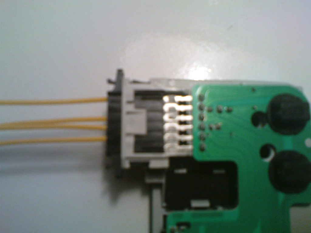

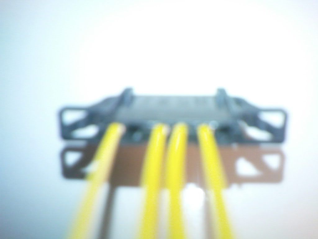

Hello again,
Just wanted to check to see if I have connected the 4 wires correctly?
jonnyboi_101
Ok, if we start with the first wire, right at the top, do I wire this to the new dimmer wire?
Can you give me which colour of the original wires I should solder the 3rd, 4th and the 5th yellow wires to?
Thank you
Jonny

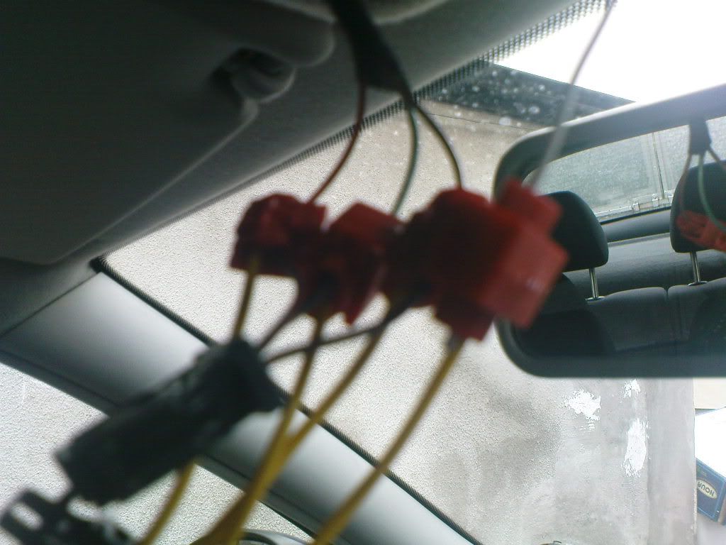

jonnyboi_101

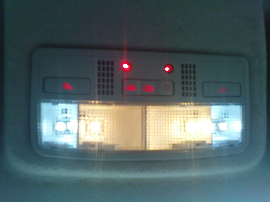

Finally got he light fitted today:funk:
I decided to connect the new plug to the existing wires with the scotch connectors, instead of soldering them on to each other, then if I wanted to put the original light unit back in, I can do so quickly:)
Here are some pictures,
thanks for all the help guys!
