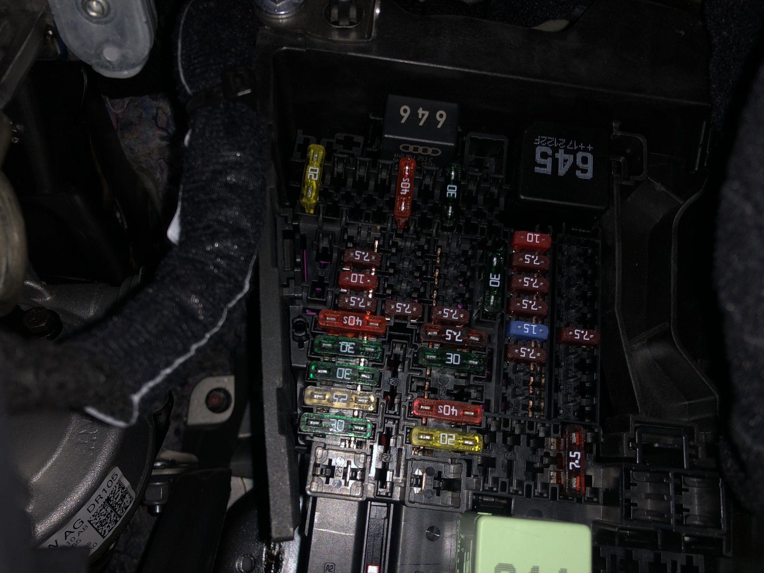

hi thanks for posting these threads it helped me fix my seat ibiza mk V 67 plate as previous suggestions the seat handbook is just a book of misleading information and the help here helped me fix a simple washer bottle pump after some cold weather during lockdown so id though it show you exactly where mine was just incase it helps someone before opting to change an awkward to get to simple washer pump. i only found it as it looked discouloured and sitting all alone away from other fuses (fuse58)
Thanks I have same problem mine are not working anymore can’t hear the pump either just been to Halfords who checked the fuses said there all ok so think I might change it just to see if not il take it garage mine is 67 plate Ibiza what type of fuse is that big 7.5a do you remember? Thanks ?
