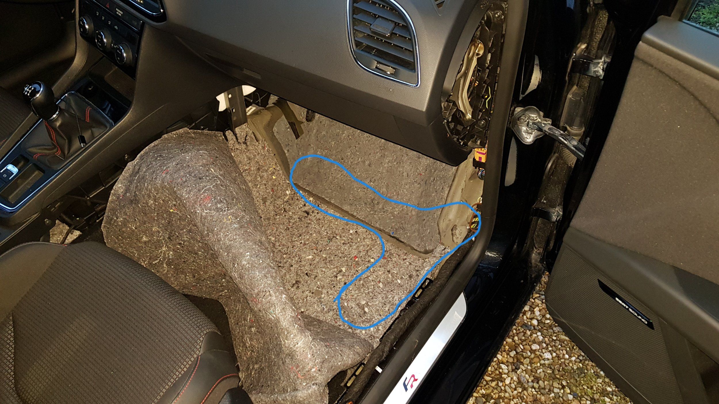

I have a problem with my 2018 Leon FR. About three weeks ago I've noticed, that carpet at the front passenger side is wet (LHD car). I have removed all the carpeting from that side and noticesz that the matherial under the carpet and lower part of the foam is soaking wet. I have dried it, and after 3 weeks it has come back.
I checked all places known to me where some water can go into the car (windscreen, door panel, a/c drain tube), but I haven't found anything.
I have marked the spot, where water gathers. Has someone had this kind of leak?

A/C drain is dry (after I dried the car for the first time, I haven't used my a/c) and I don't have a sunroof. The part of the foam that is above wet area is perfectly dry, so I don't think also that water comes from some higher point.

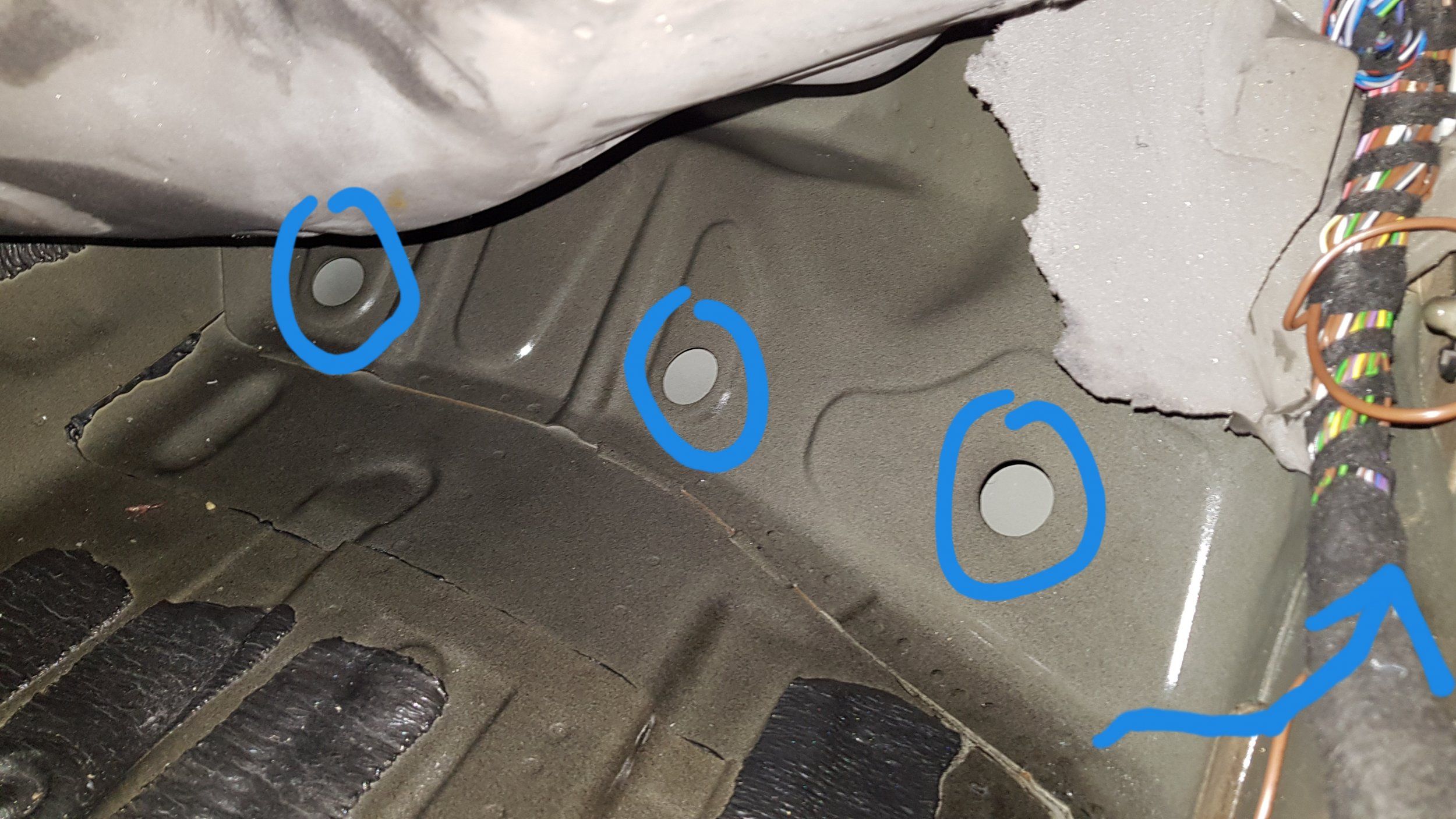

Is it possible for water to leak through one of these holes?

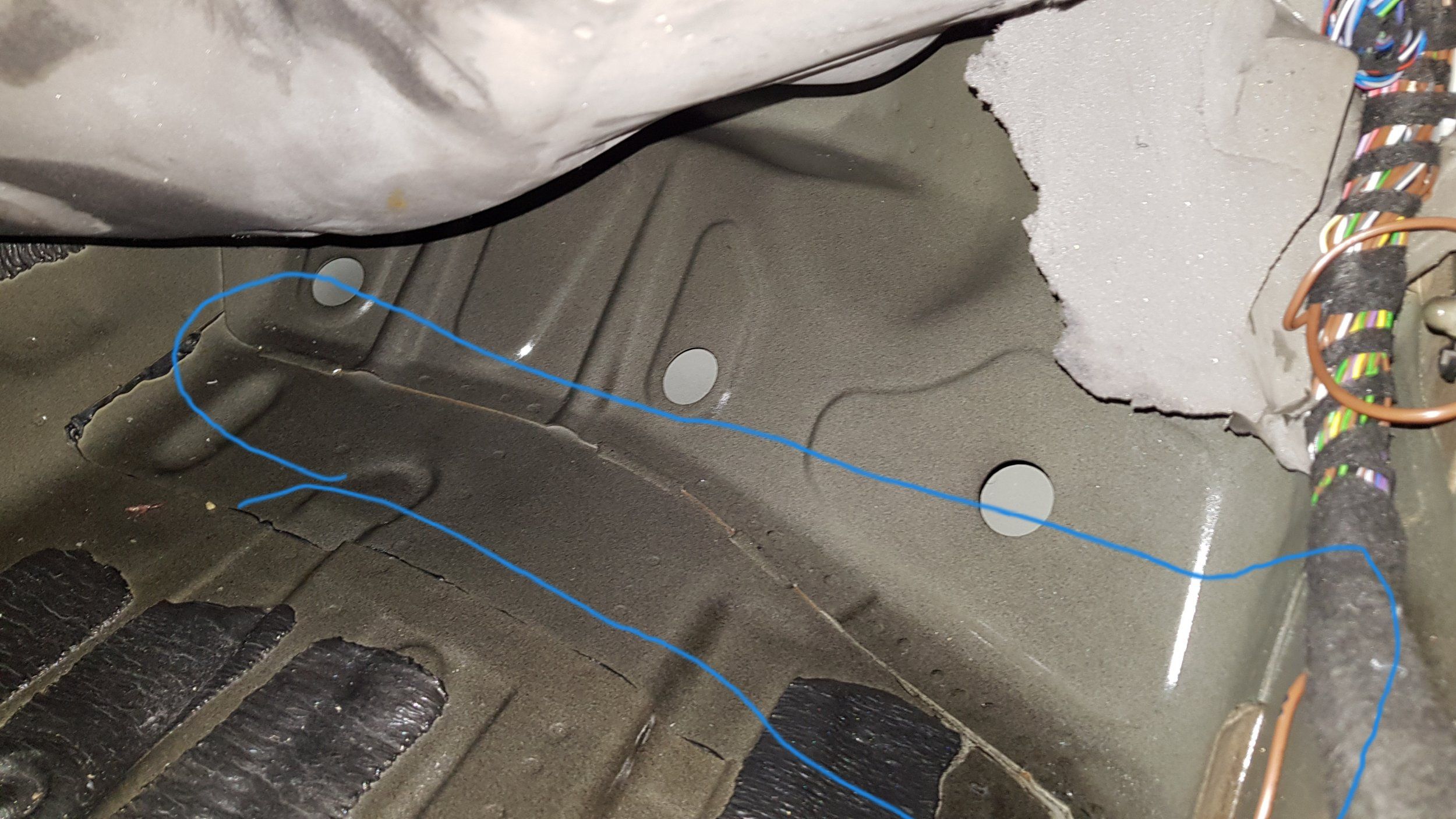

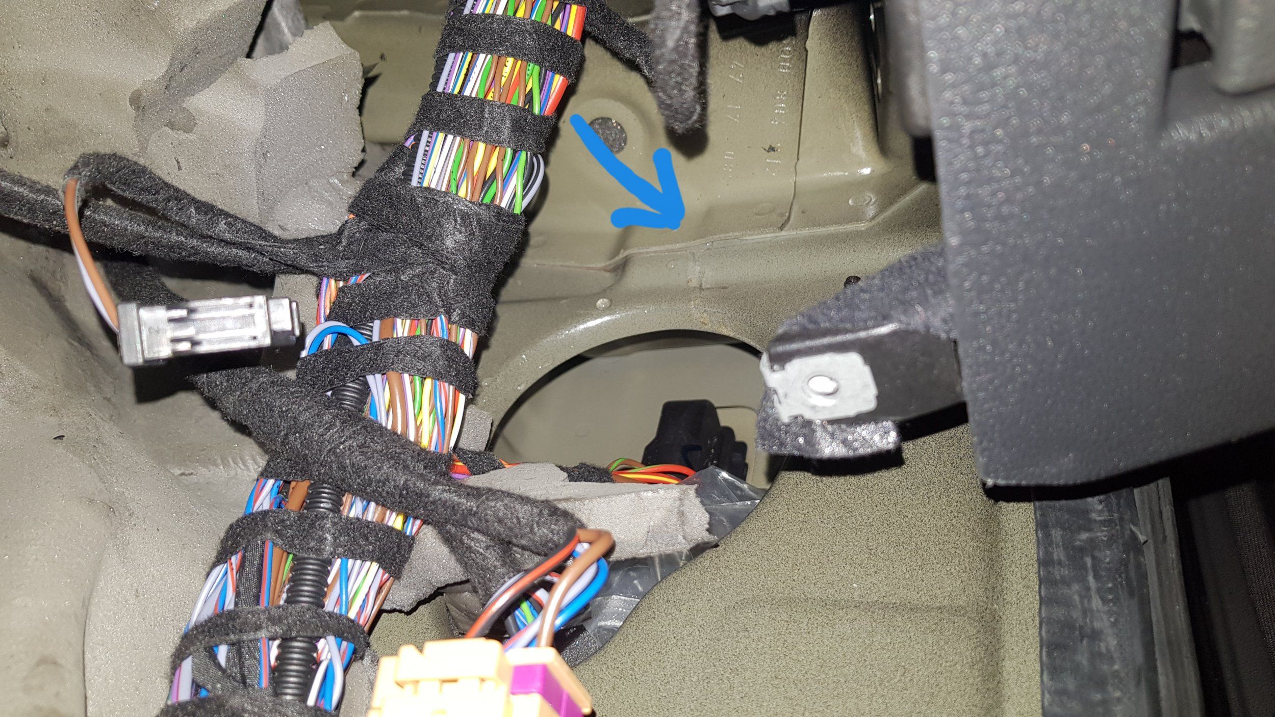

Since yesterday I drive with partially removed carpet to see where the water comes from. Today after heavy rain the floor was wet. Water gaddered mostly around the floor drain plug and alongside the bend, where floor changes direction from horizontal to vertical under the dashboard. Also I put a finger into one of the technical holes (marked on the photo below) and I felt that there was some water too.
I have sprayed my car with a water hose, and I found a leaking point. Water comes from a small hole between two sheets of metal. It is at the same height as an inner part of door wiring connector. It gets somewhere from plenum chamber draining pipe. When I put my garden hose there, I can see drops of water comming out from this joint of two metal plates. Do you know how to seal it?

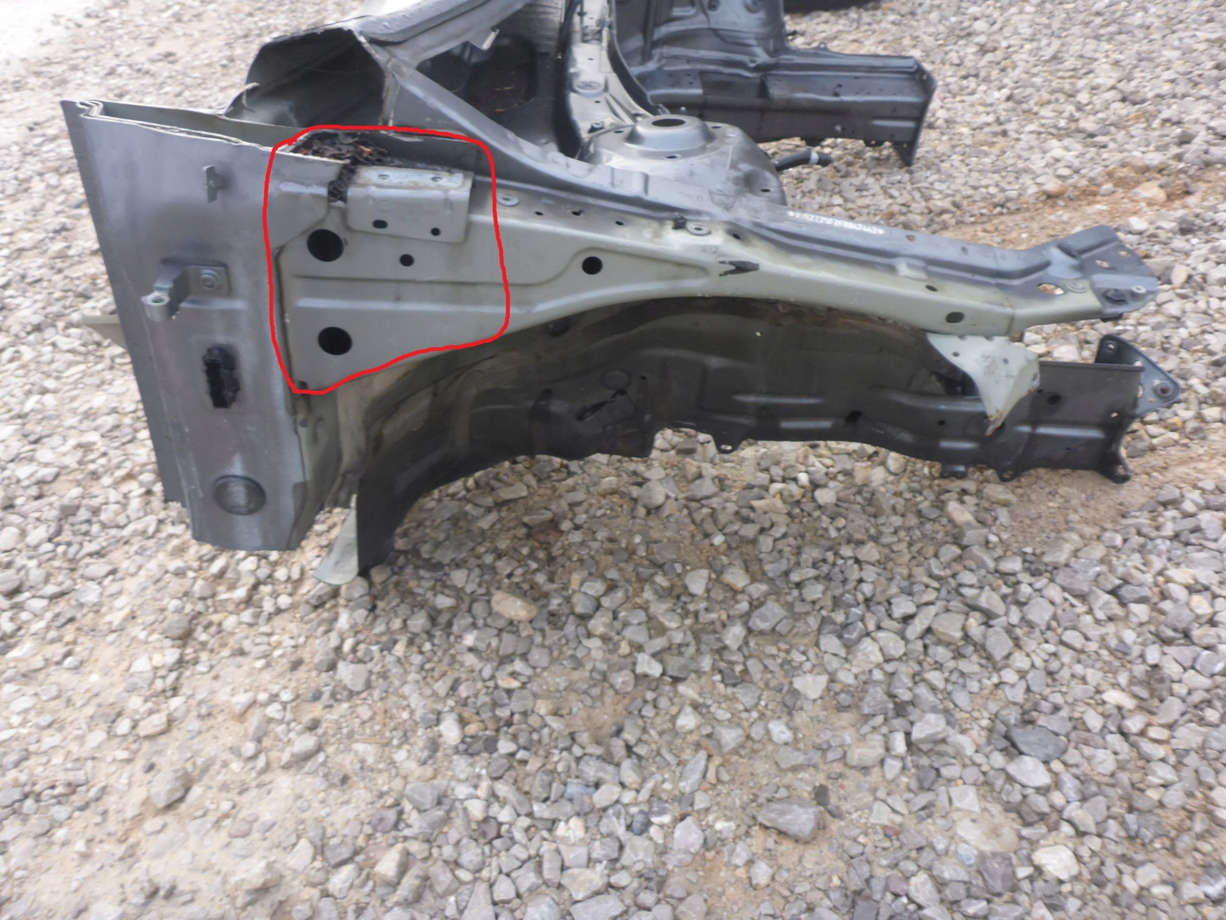

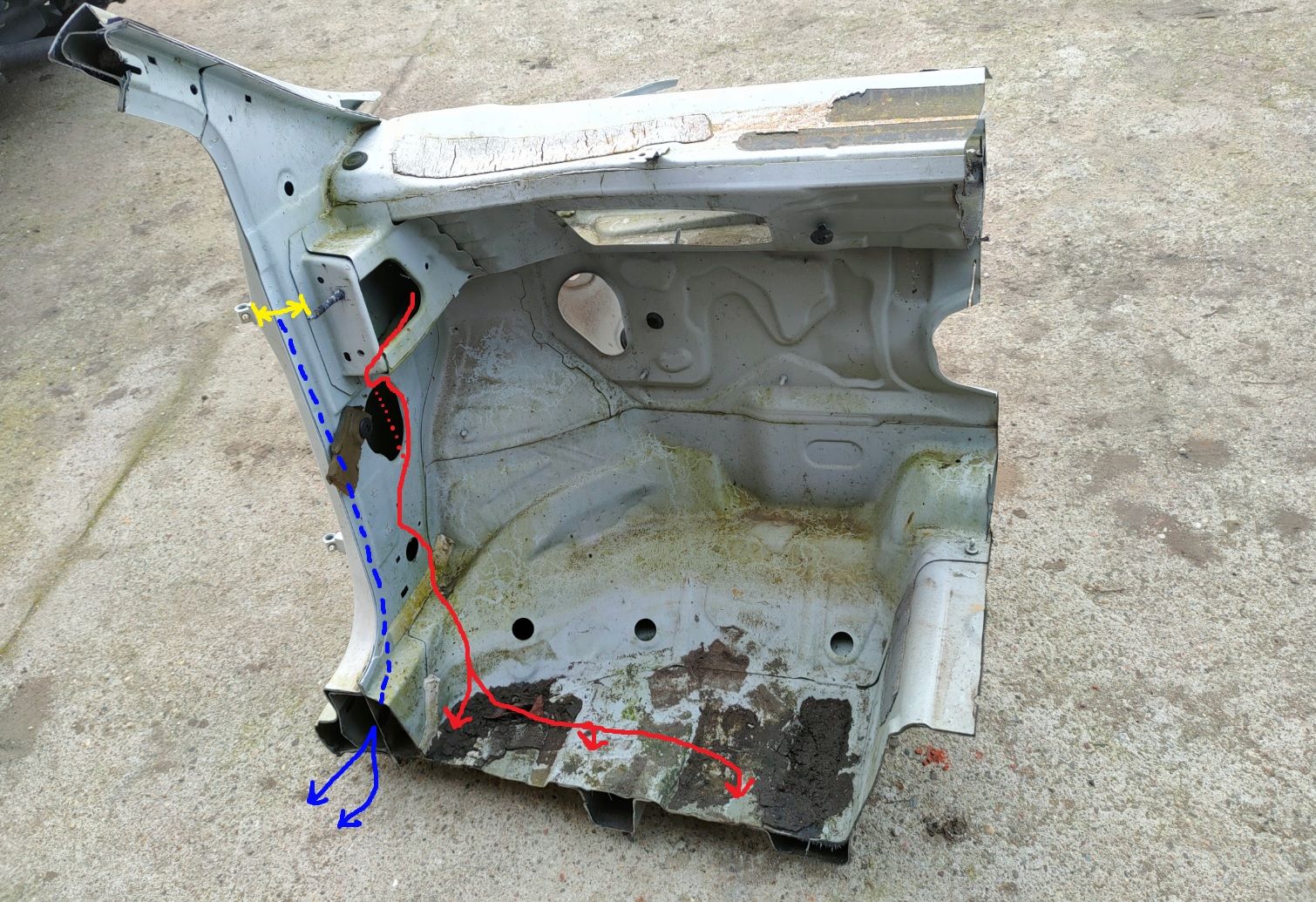

I haven't fix it yet (I wait for my vacation :) ), but I think I know where the water leaks in. I believe there is some small hole in the marked area on the picture below. I will have to remove right wing to reach there. I saw some dirt inside through those two holes. I have also bought an ultrasonic leak detector from aliexpress and it is very helpful (Allsun EM282).

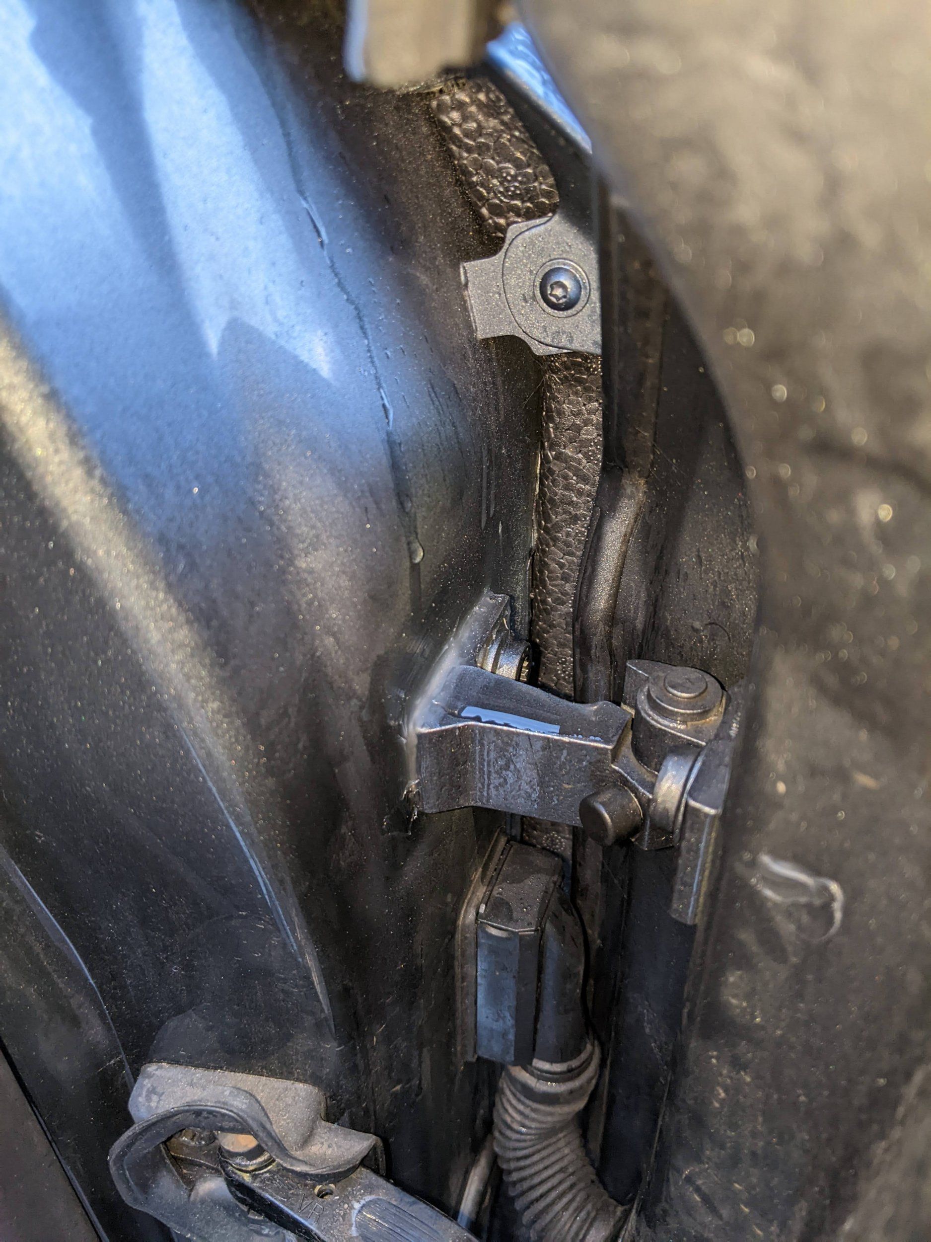

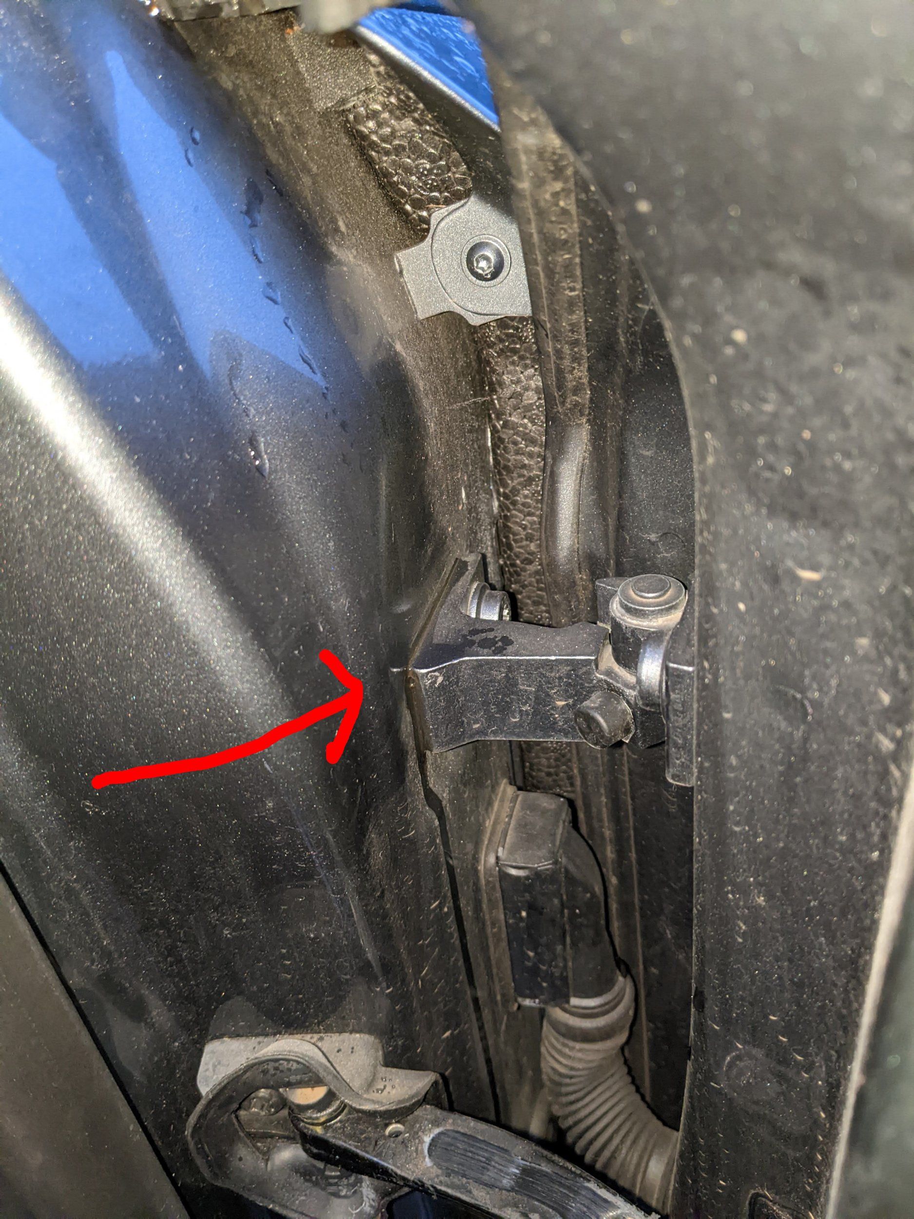

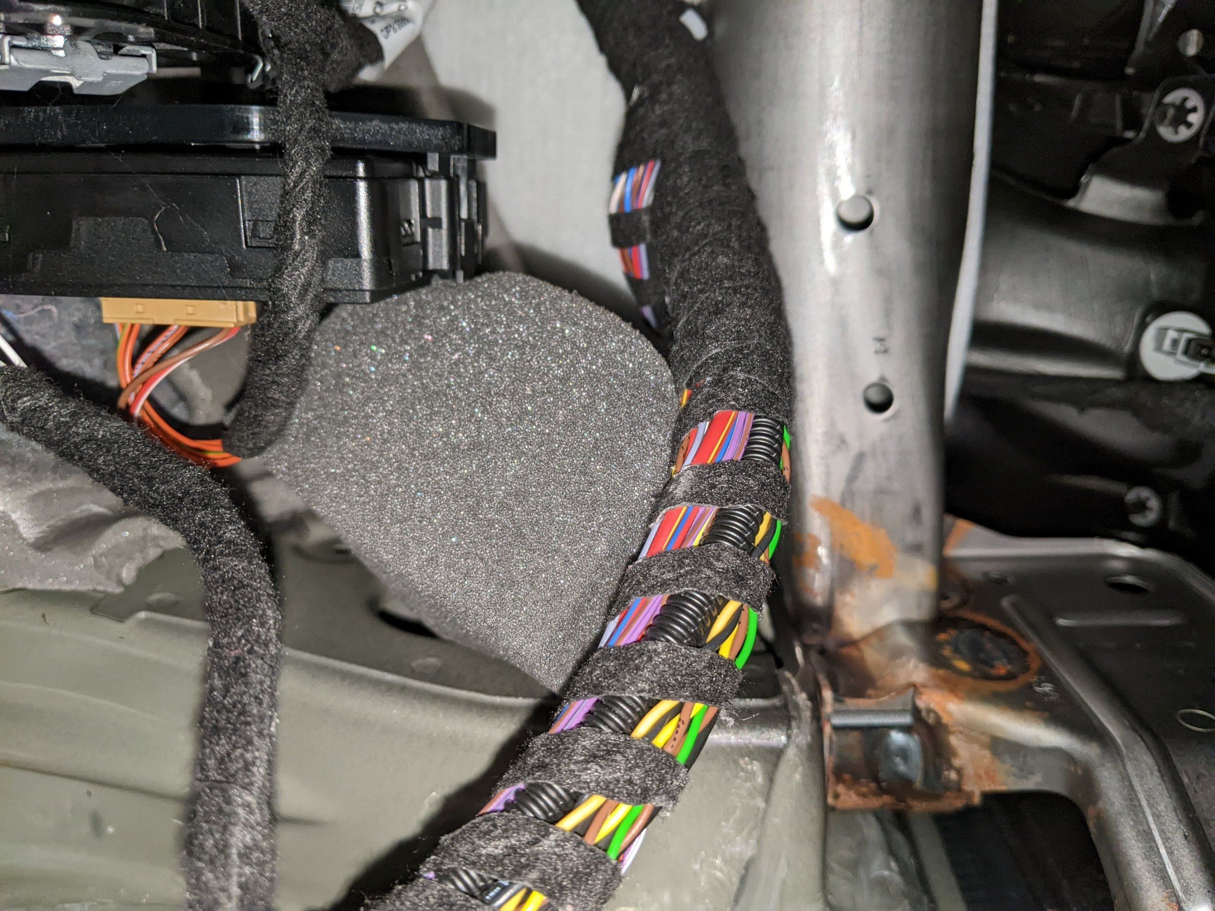

(remember to disconnect battery for airbag) and carpet out and spent most of the day water testing hose on the side scuttle drains and windscreen no water ingress, then it started to rain, came back ½ an hour later and water had come in at the same point as yours. Noticed that water channels down the outer door seal and down the pillar and on to the hinge bracket. Poured water on the bracket and I could feel the water coming through the acoustic sponge on the inside at the same place (near where the rust is).
I have smeared silicone around the bracket so hopefully should stop it getting through, probably should have a rubber seal/washer between the hinge and the panel, haven’t put my carpets back in yet as not 100% sure it is fixed, will let you know either way, fingers crossed.

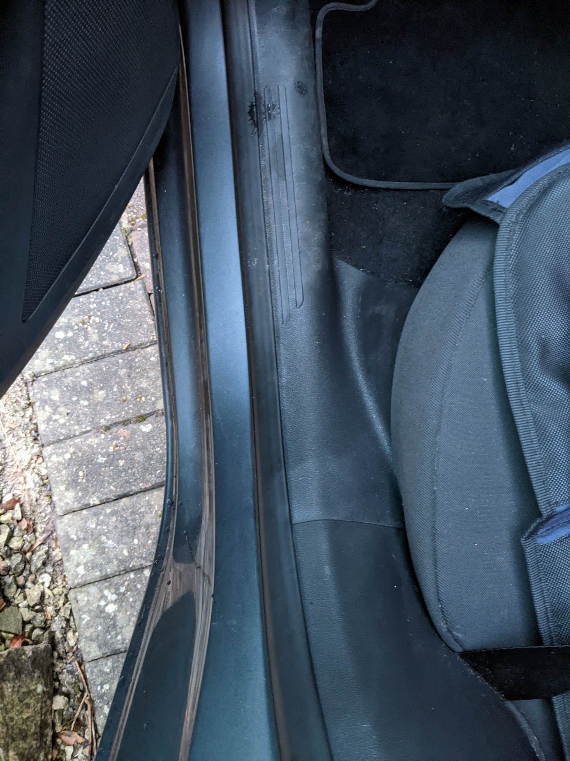

I have also noticed the plastic cover under the rear seat by the rear door is slightly damp after heavy rain, as if water is getting through under the door seal and over the plastic on to the rear footwell, another possible point of ingress, although not the main one for me, might be an issue for others.

It might be but I don't think that hinge is the ingres point. Between the hinge mounting place and the visible leaking spot there is a distance (marked as yellow) and if water would get inside through there it would pour as the blue arrow indicates (between two sheets of metal and into the threshold). My guess is that water goes along the red arrow.

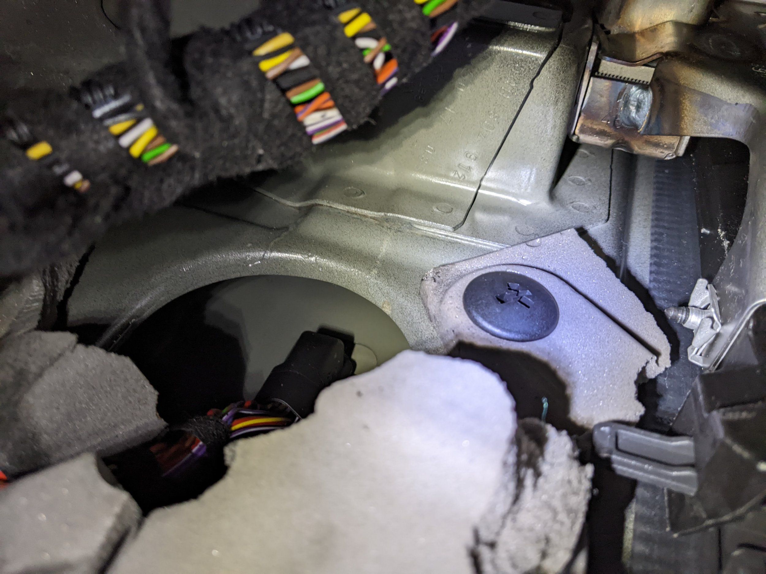

Initial results seem positive, it rained heavily overnight and couldn’t see any water ingress this morning. Water seems to pond outside on top of the door bracket now. Fingers still crossed.

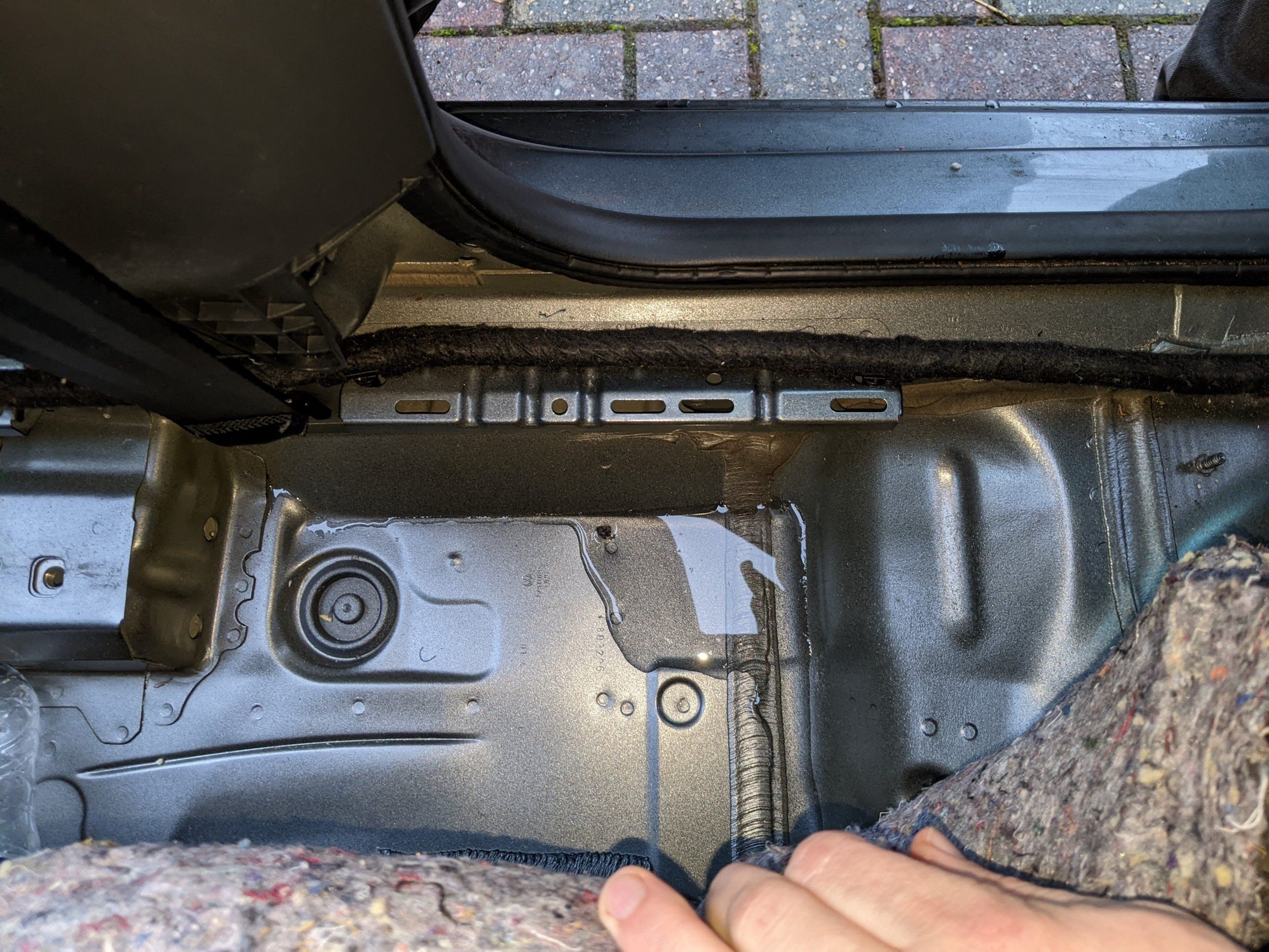

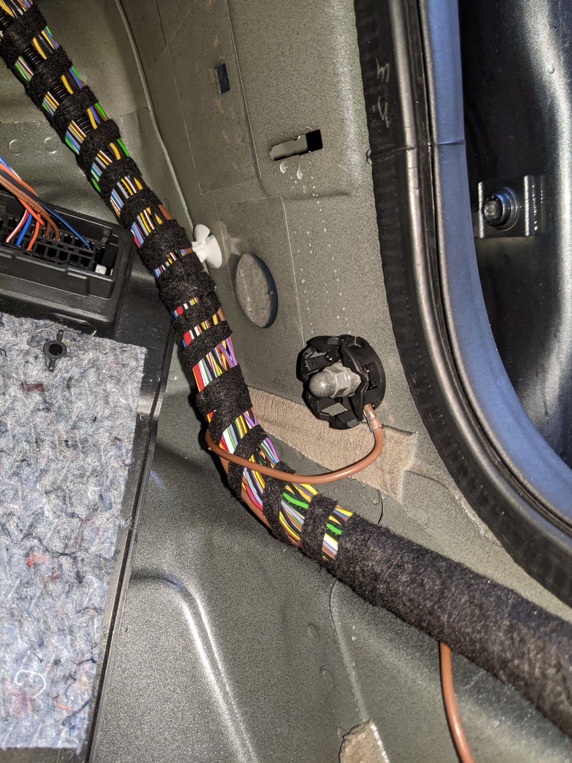

Where the hinge bracket is fixed to the chassis there is an angle/box shaped bit of metal that bridges to the inside, water seems to cross this and through the gap in the welding. When I blocked up the gap it then tracks down and comes in through the holes the cill trim is fixed to and at the bottom into the foot well (before pictures attached for reference).
