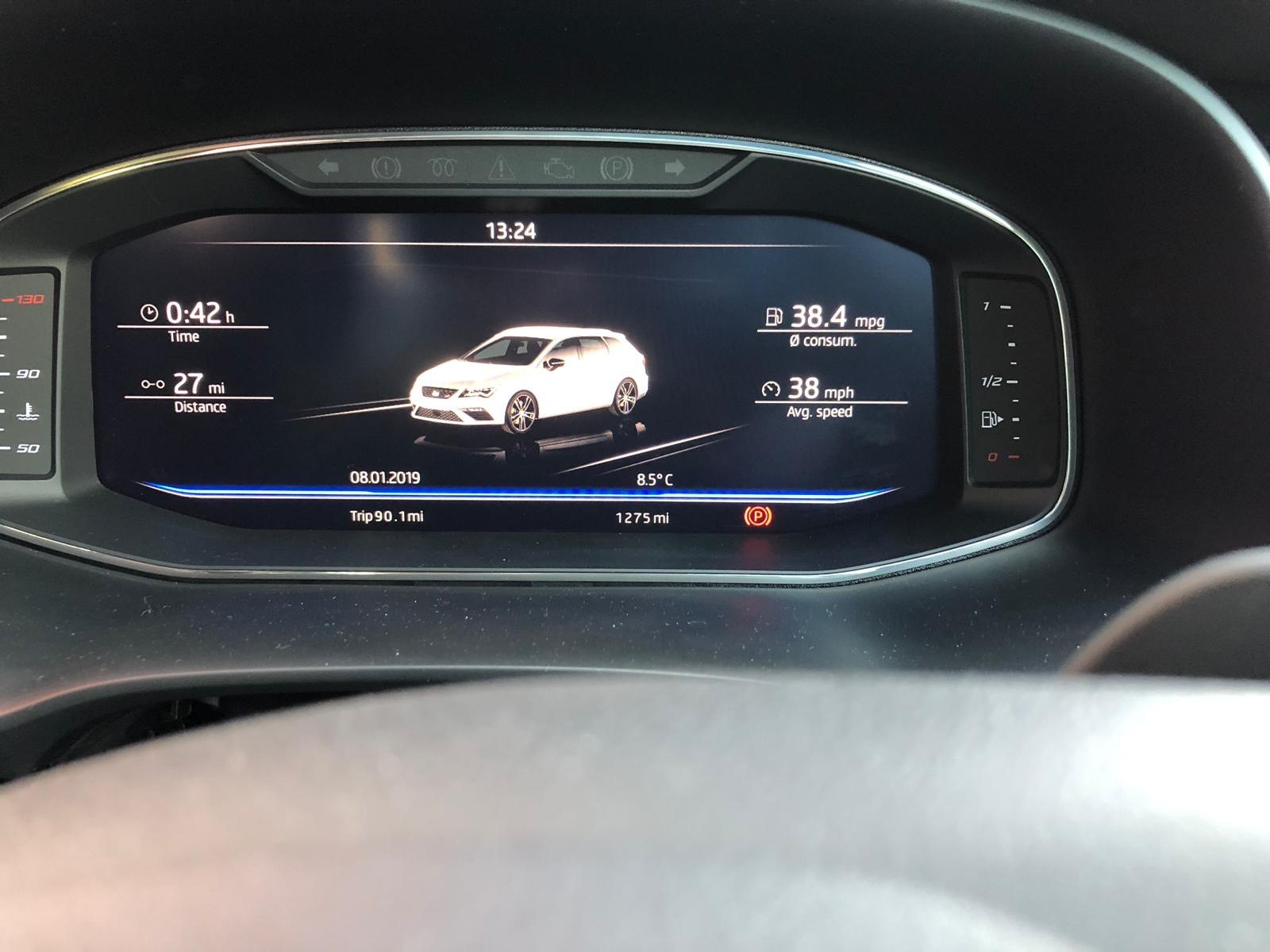

Mrs Wilson was particularly impressed with her fuel consumption yesterday, on a short trip through the roadworks on the M6 to Crewe. Personally I didn't think this mpg was possible in a 300 ST 4 Drive!

Impressive. My wife would probably be in the 20s. I really can't see how she can get mine so low when she drives or, if I let her

I certainly see that sort of figure on long distance motorway driving (when at a steady 70) to the last two meets, but in normal driving its a bit lower :)
