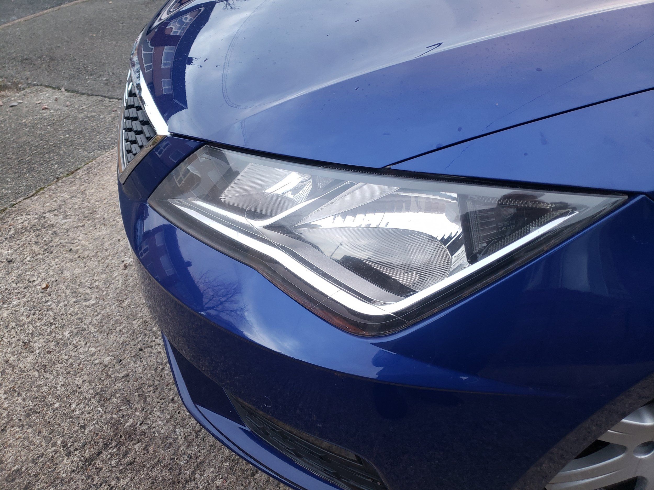

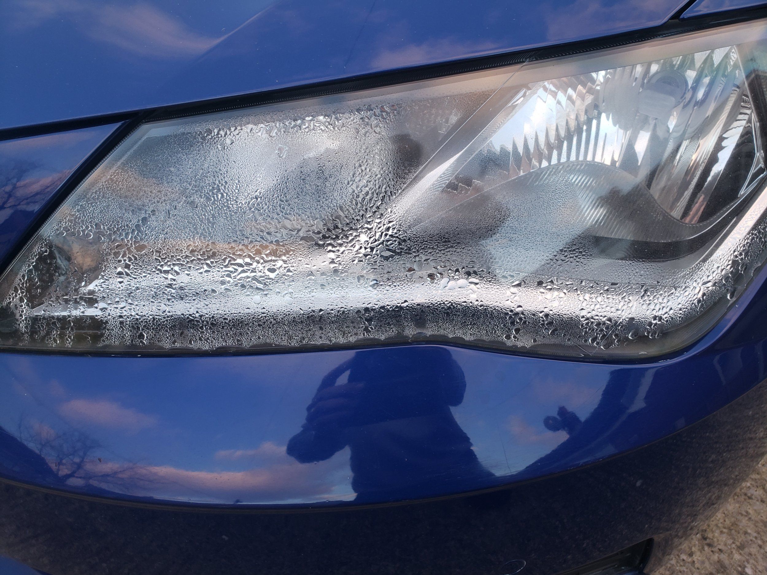

Finally got round to changing the leaking headlight on the Leon. Looks like its a stone chip that's cracked it. Anyone doing this job, follow the official ELSAWin instructions and NOT the many YouTube videos - the bumper does not need to be completely removed

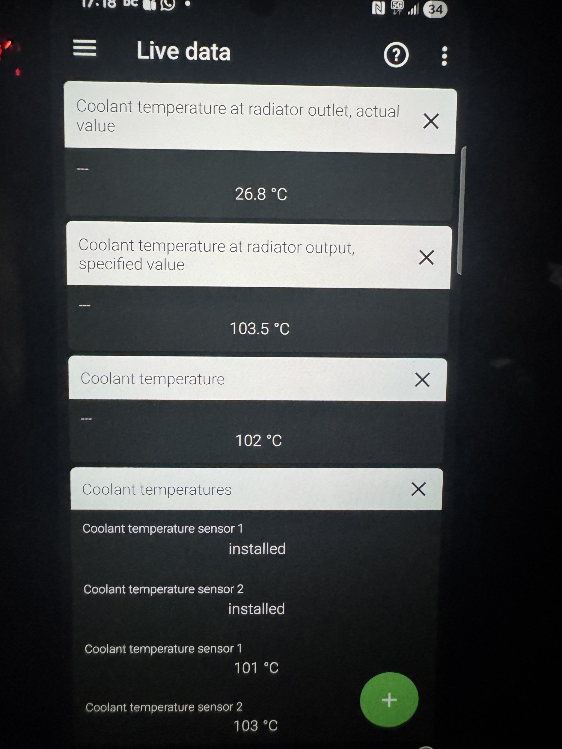

@Tester01 Hmmz, are you able to see coolant temperature? If so, what are the values with day to day driving?
Main Coolant seems to get up to temp okay?
Went on a short drive but been sat idle for some time with engine running.
However what’s concerning in obdeleven
The radiator temp seems low it never reaches specified value.
Something I’ve noted in the past even after a driver never gets closed to specified temp
Dont know if anyone has an obd to compare the reasons from their car
However also shouldn’t the radiator fans also kick in at this point seeing as coolant is above 100c?

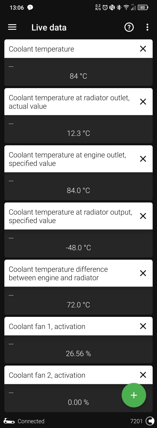

I am running a 2014 280 and here is a screen shot of my values after the car being defrosted
Interesting thanks
Judging by-49 doesn’t look like yours has a specified value.
Will see if anything changes after the charge air cooler replacement next week at dealer.
Coolant system will be bled so maybe that’s an airlock in the system, that’s causing issues.
Hopefully.
And I wonder if the charge air replacement will resolve the crappy fuel economy I’ve been moaning about for ages, due to not being able to figure out why.

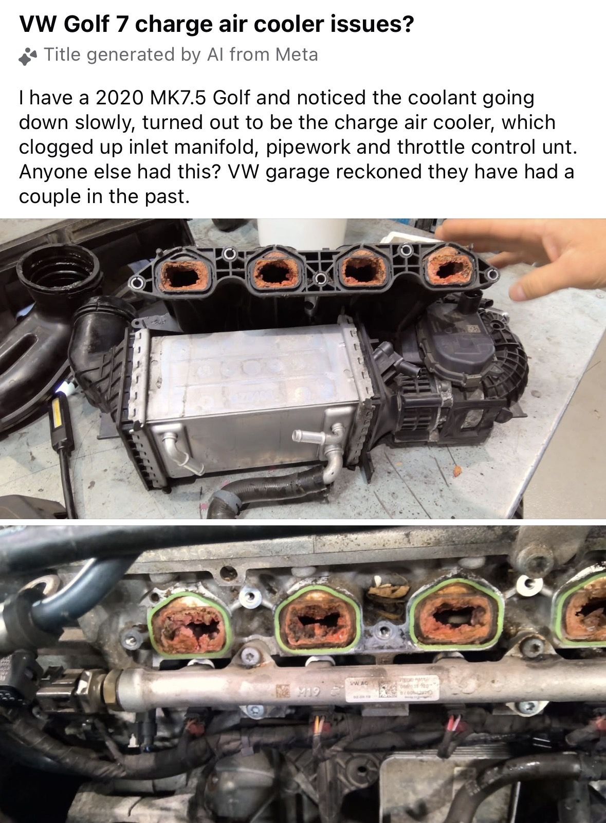

Although I saw this and I hope my intake doesn’t look like this…Especially as this leak issue has been going on for a while…

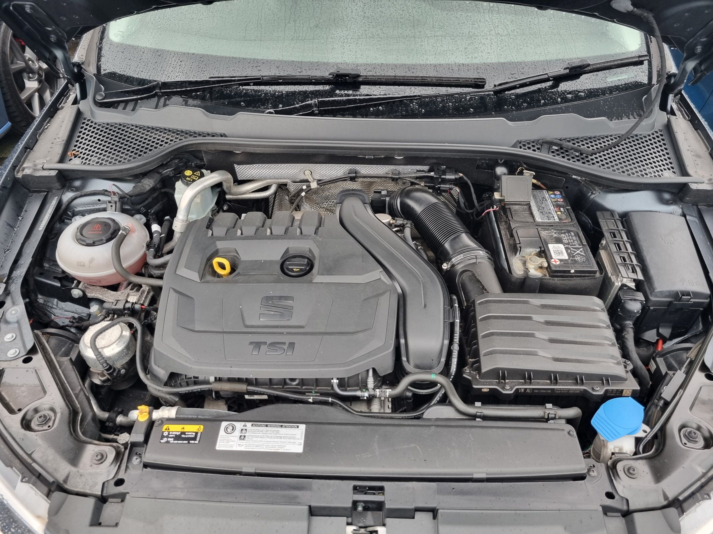

Collected my car after charge air cooler replacement.
Will see how I get on now with the loss of coolant.
Running live data, I still think there’s an issue with coolant flow into the radiator.
And can’t remember last time I’ve seen or heard the radiator fan.
Judging from searching Ross-Tech everything seems to suggest that the huge difference in temp at radiator and overall coolant is odd.
I guess a good check would to be see if the bottom radiator hose is still stone cold after cars warmed up?
