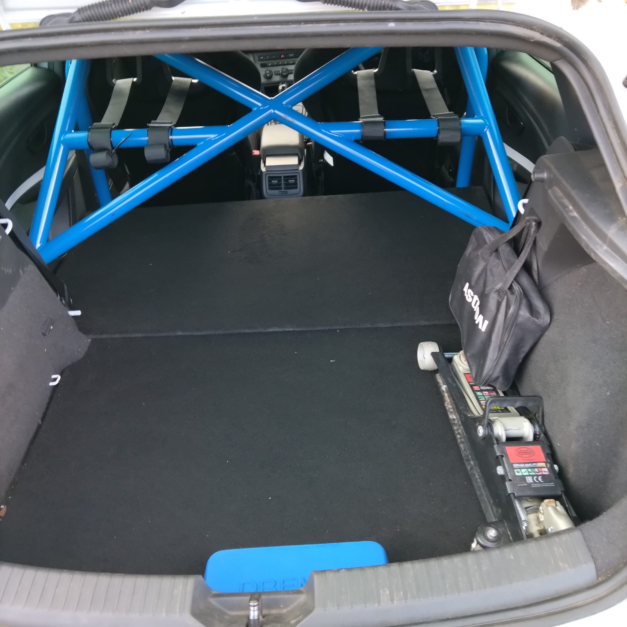

Finally got round to cutting out the back seat middle support bracket (circled in picture) so I can start the process of fitting the rear seat delete kit.
Test fitted today and so far just a little bit of trimming will be needed as this Kit is for a Golf MK7 and its very close but does need a little adjustment.

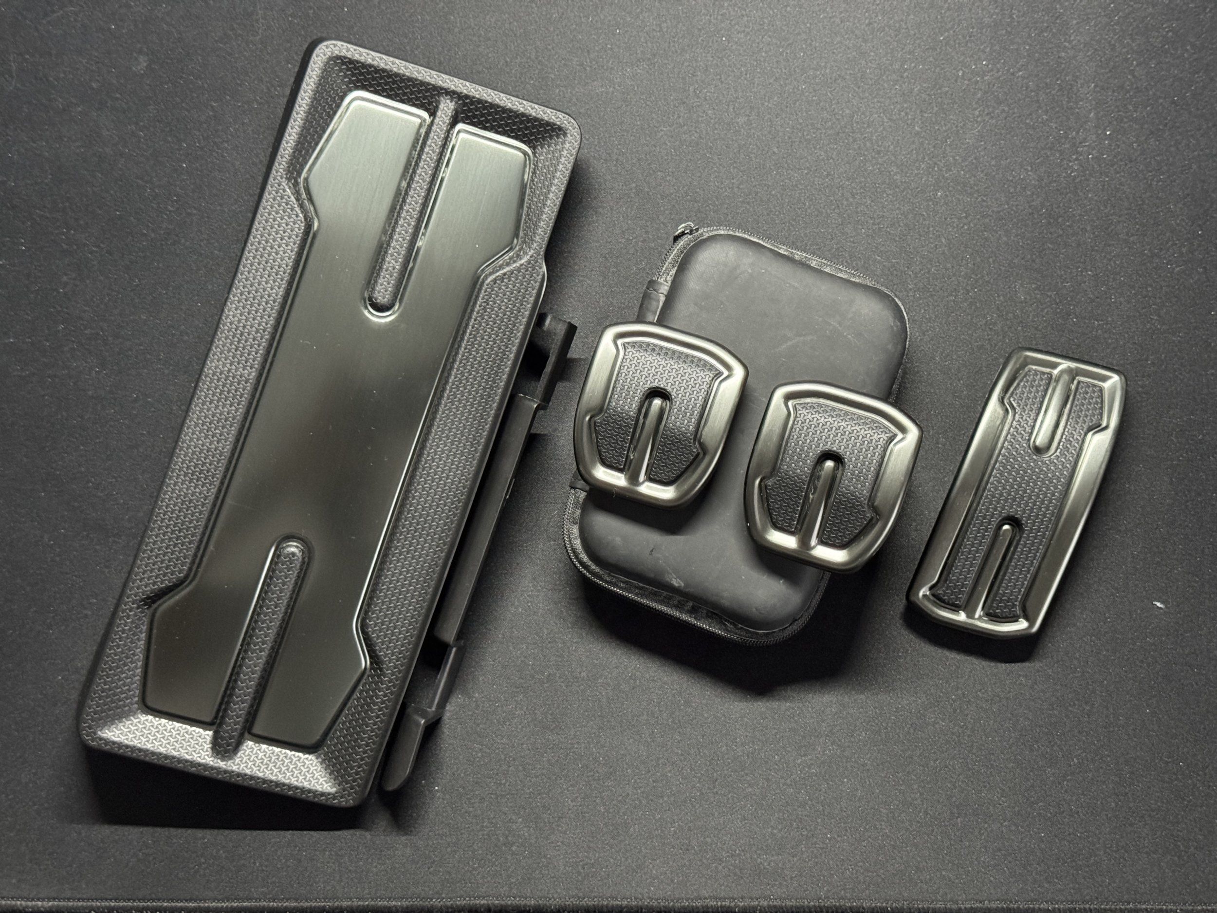

If anyone is interested in ordering them their PNs are 5FA064200 9DG and 5FA071750 9DG. These one are "Cupra" version, but there are also "Seat" version available which has lighter colors.
I’d love a decent dead pedal cover for DSG - but there doesn’t seem to be a RHD version. I tried a few from AliExpress but they were either too narrow (clearly not for DSG) or just naff quality.
Currently have the brushed VW/audi pedals but I do like the look of the Cupra dark chrome ones!
