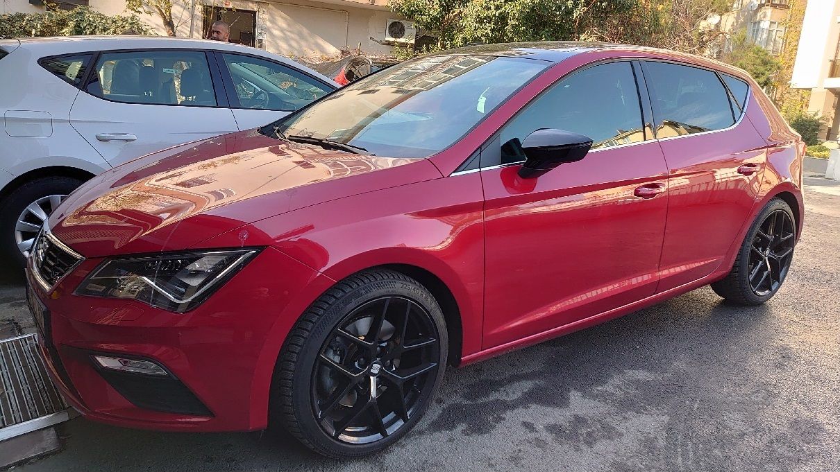

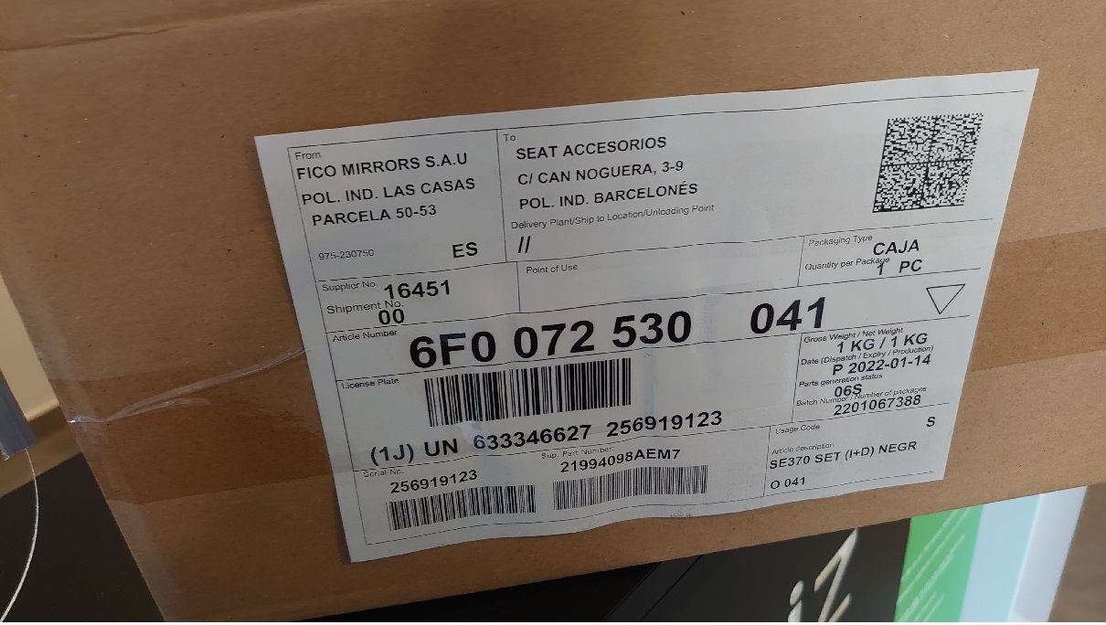

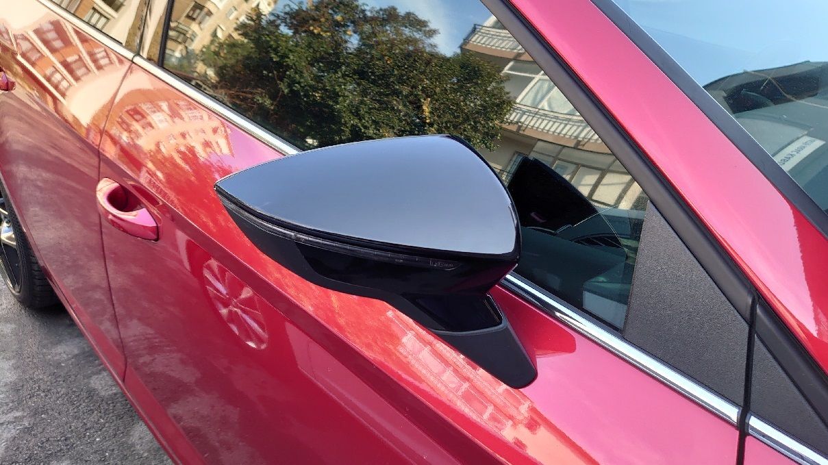

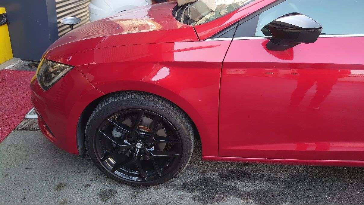

Today I went to the local SEAT dealer to ask about the gloss black covers for wing mirrors and surprisingly they had a pair in stock and gave me a good price. I bought and mounted them right away, replacing the existing Desire Red covers. I think they are a good match for the gloss black alloys that I use in winters.

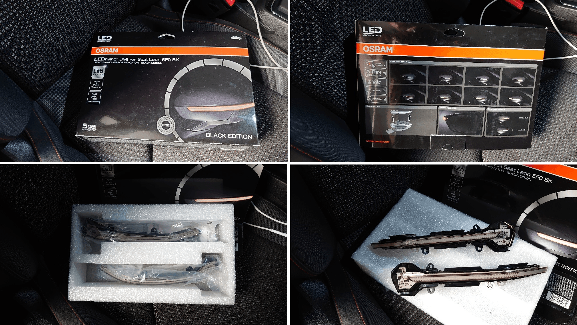

Today my order of Osram LEDriving DMI "Dynamic Mirror Indicators" have arrived and I installed them myself. Along with gloss black mirror covers, this was in my mind for a long time and I'm happy with the result. Installation was fairly easy: remove the covers by pulling back strongly but carefully, remove the three Allen screws, pull the connector off with the help of a flat screwdriver and install the new indicators repeating the procedure backwards. There are two variants of this product; White Edition and Black Edition. Mine is the dark tinted Black Edition.
I attached photos below and also adding links for the short videos I recorded.
The original indicators:
After connecting the first one:
After installation:

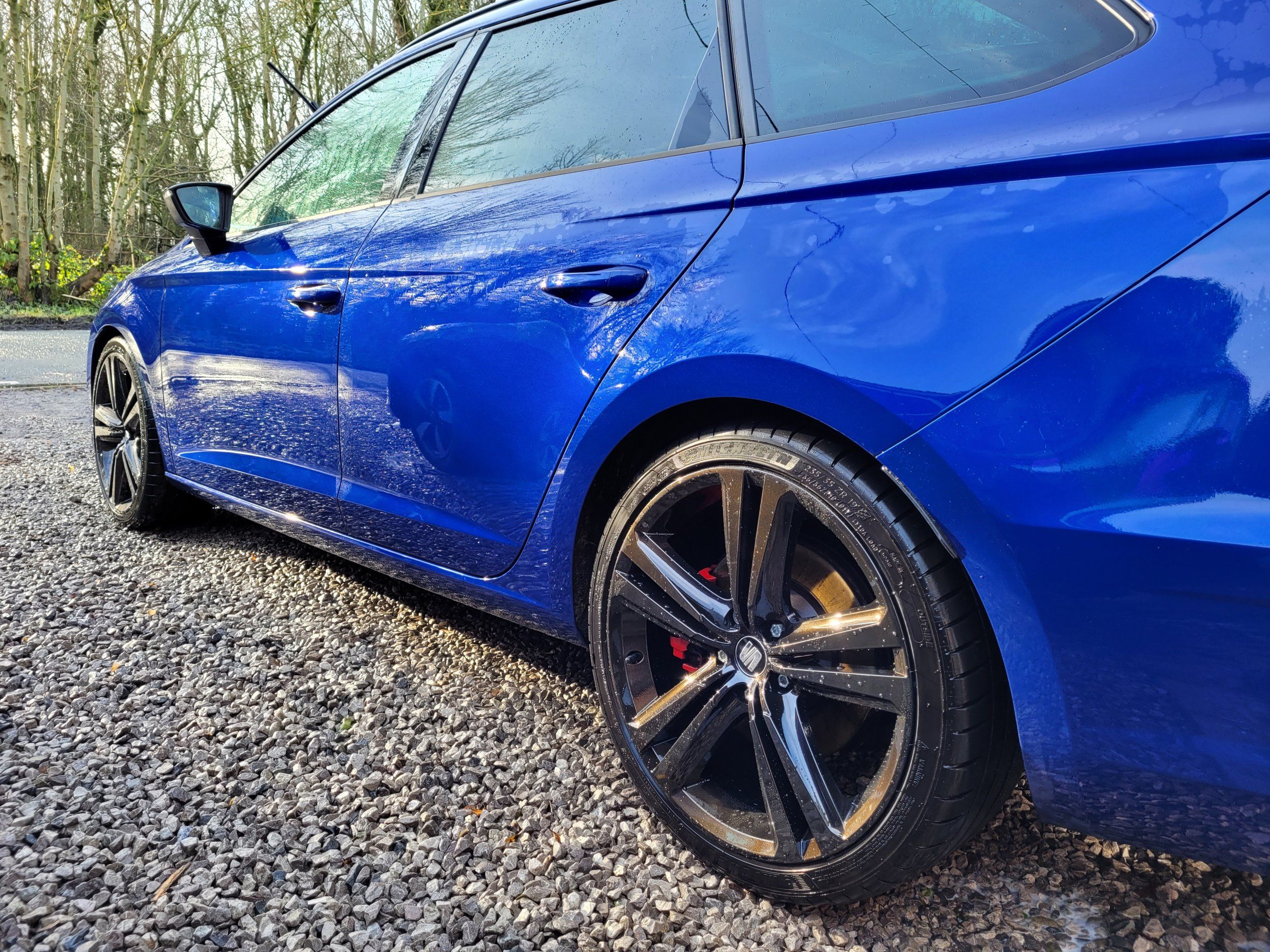

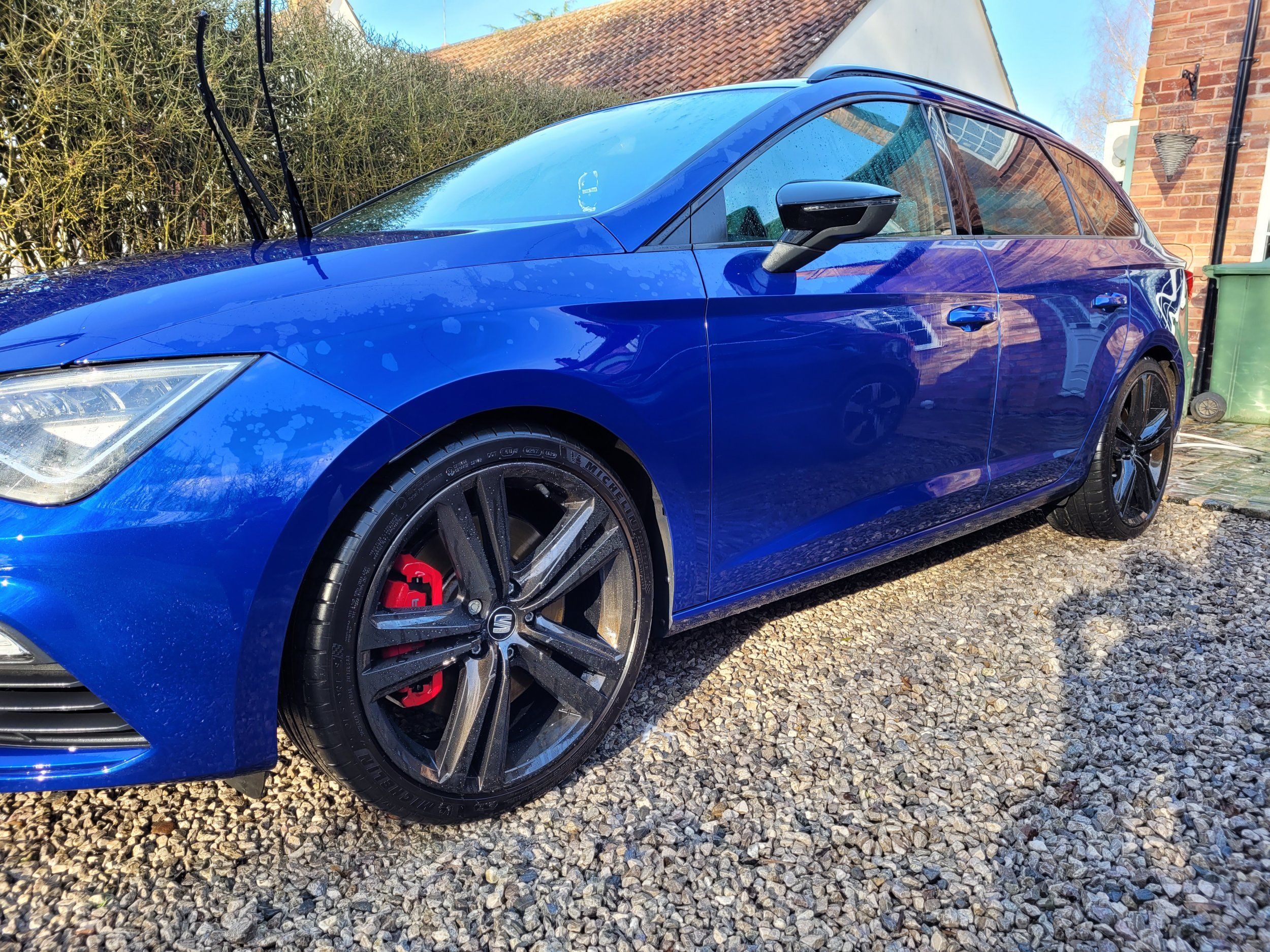

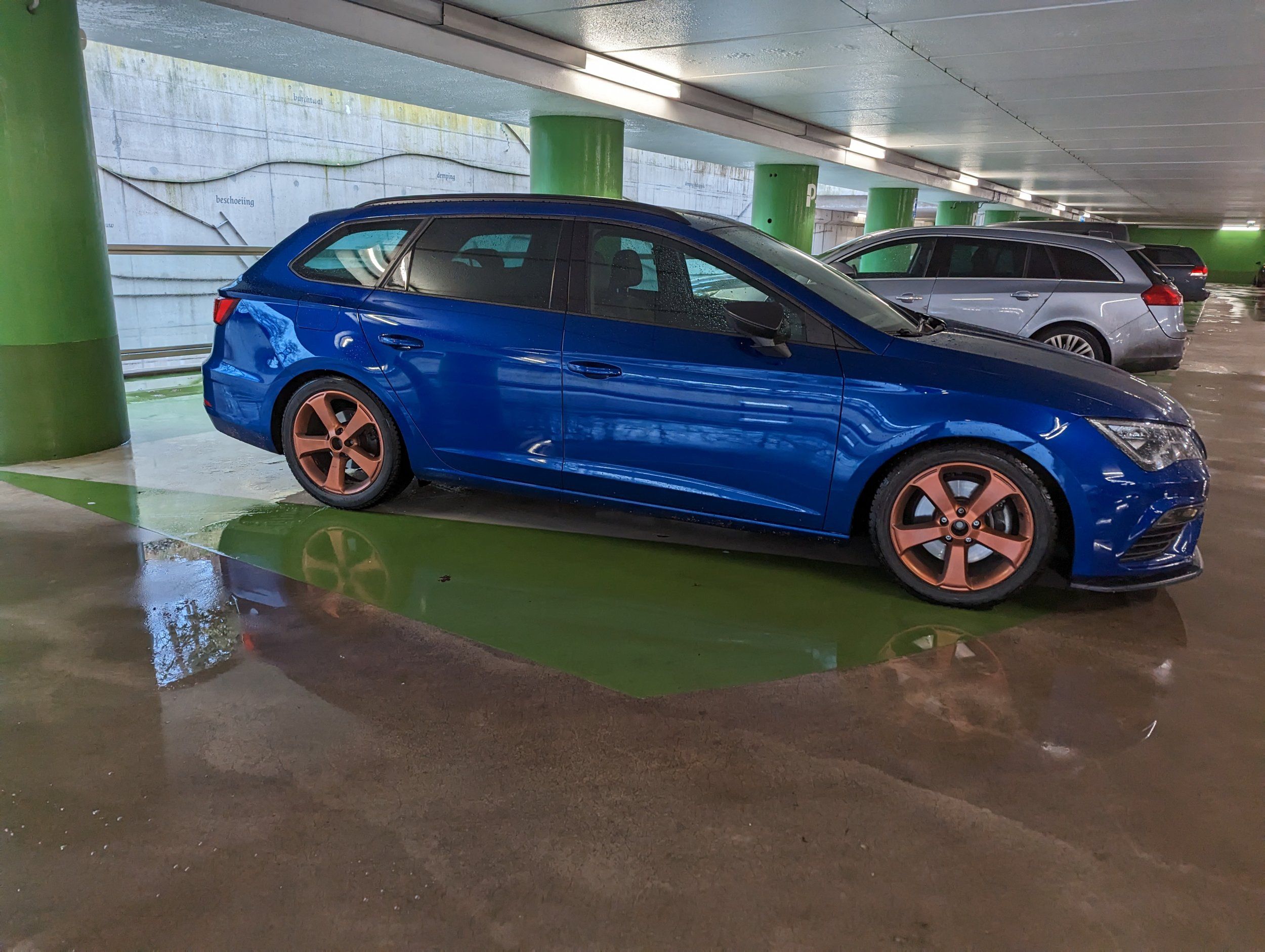

Fitted my new wheels. Difficult to capture on camera but there's a nice copper tint to them. Now just need to decide what to do about the center caps.
Looks cool ?
Would these original center caps with copper logo be a good match?
Looks cool ?
I think that's what I'm going to try, although I suspect they'll be a bit too light. I'm also in contact with a couple of companies about possibly getting some custom ones made instead.
