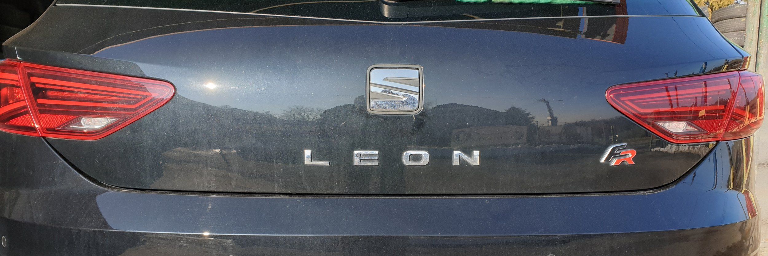

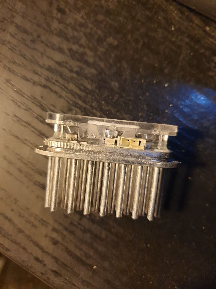

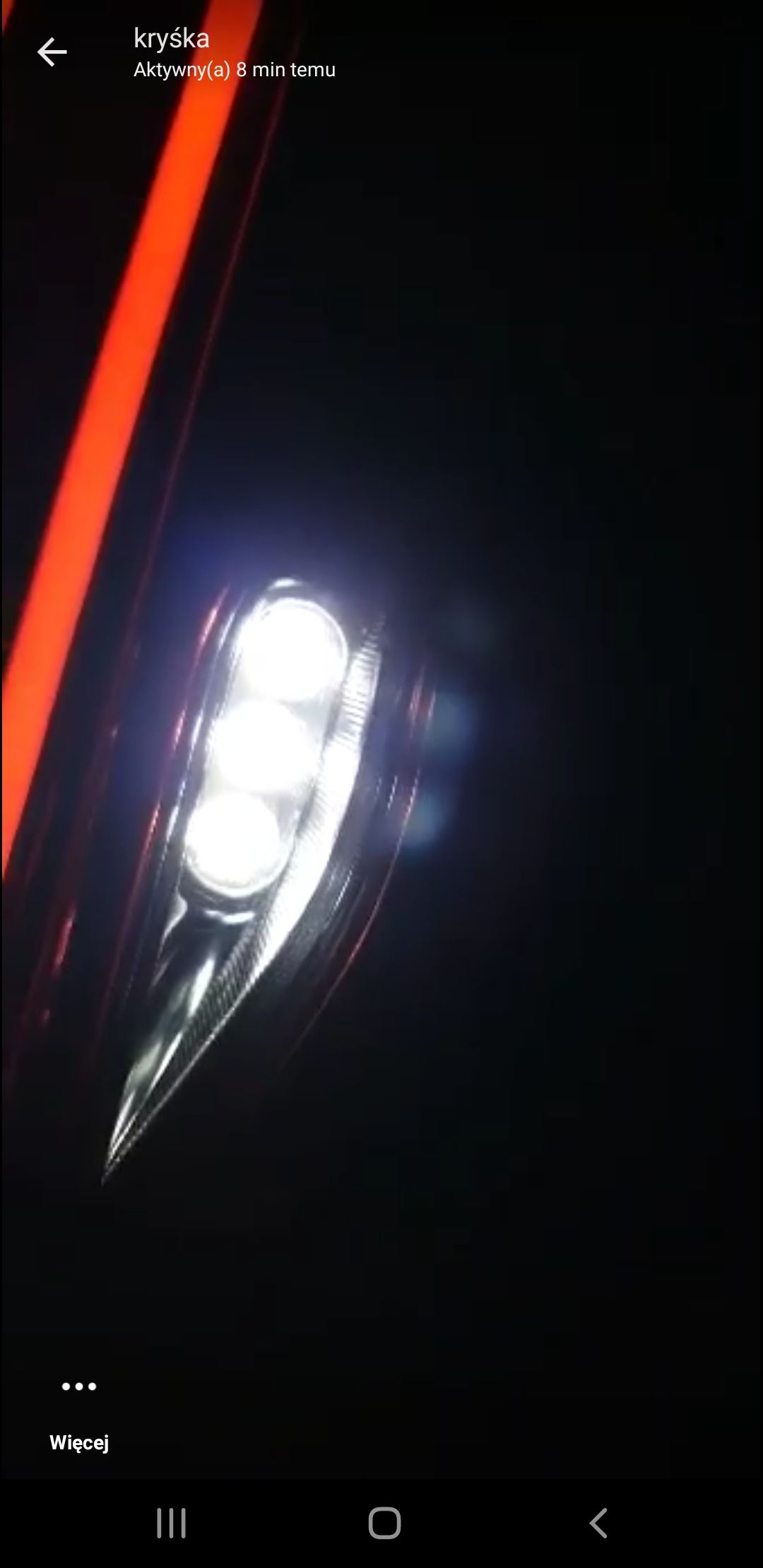

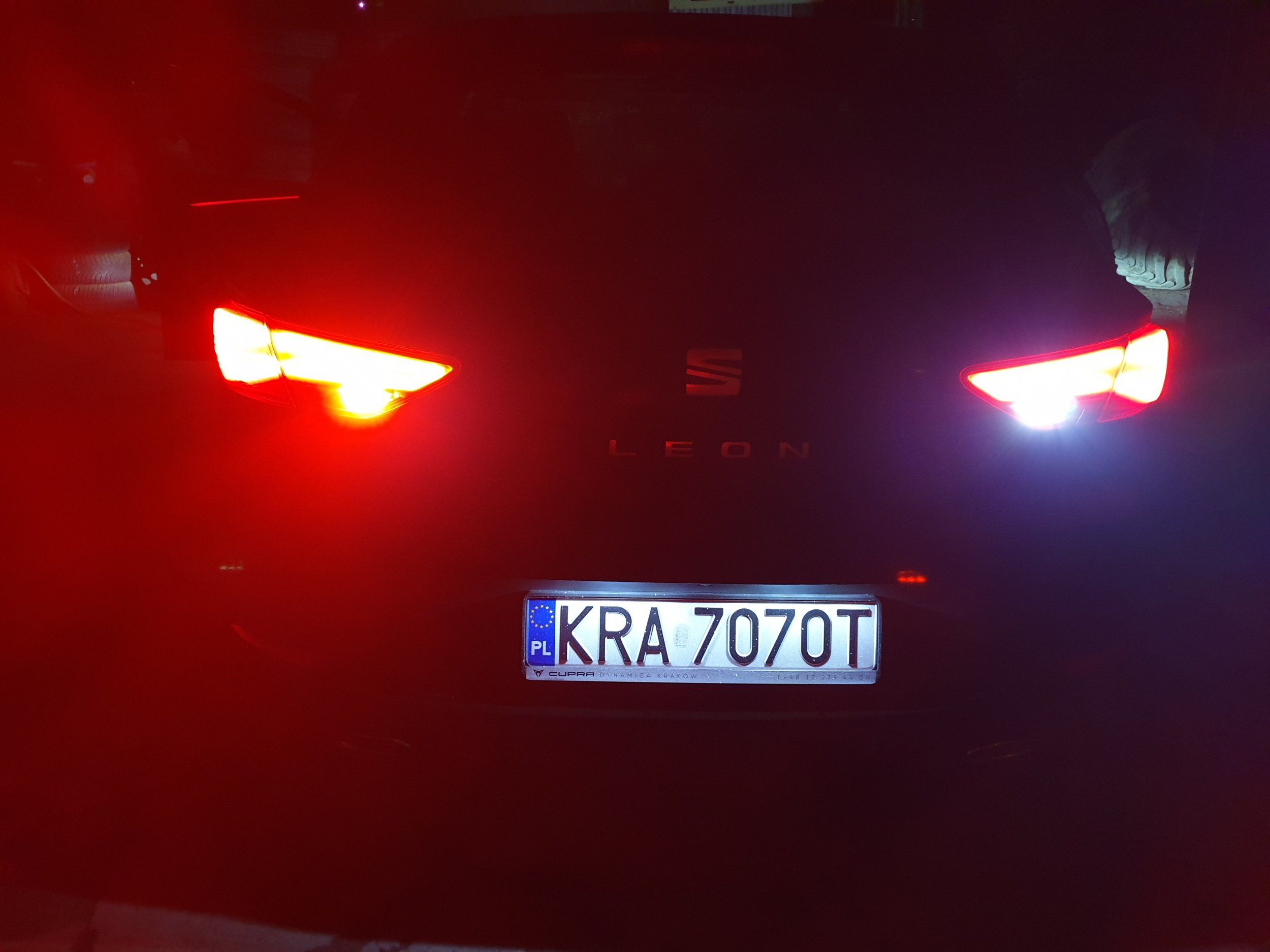

I went further than just replacing the reversing bulb from a regular w16w to a LED one.
I bought a lamp from the UK with a red fog light module (in my case, a European left-hand drive car and reverse is on the right) and soldered white diodes instead of red ones :)
now it is finally full led and looks like it was OEM :D

Does this mean that you don't have a rear red fog light? :)

I have. My fog light is originally on the left side and the reversing light is on the right side. I changed the lamp on the right side from the EU version to the UK so that it was with the LED fog module and it was in it that I changed the LEDs from red to white.
the fog stays where it was and works as it should 😁

That's excellent, I might have to do that on my RHD car, thank you! :)

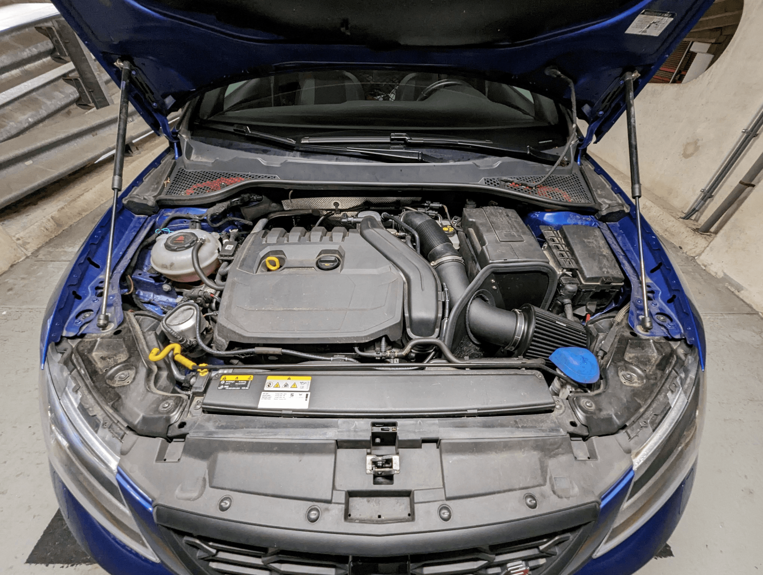

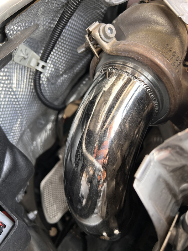

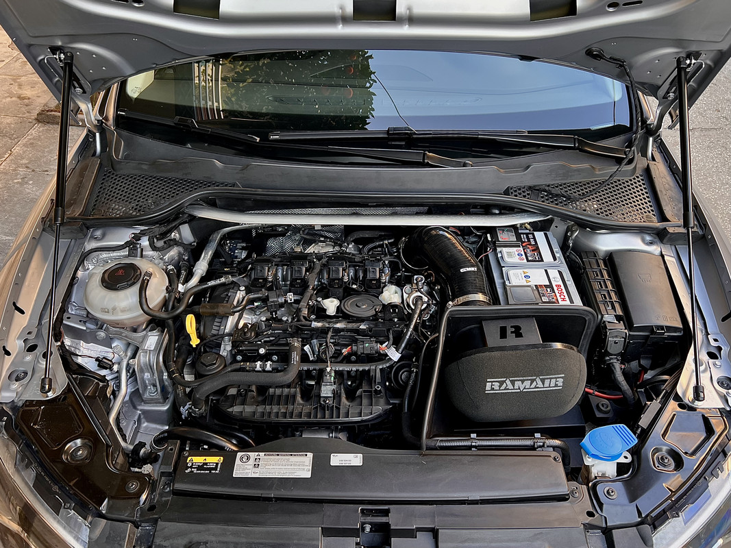

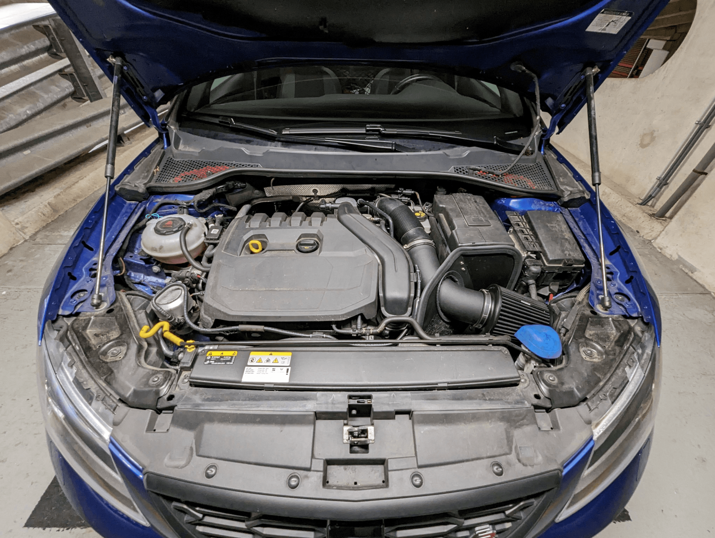

Very nice. Have you thought about upgrading the intake hoses too?
Thanks! I got the intake hose in the mail today, so I'll install that one as well. The chargepipe itself... not sure. There's no version without a blowoff valve, as far as I know, and I find those sound a bit too ricer :ROFLMAO:

It's noticeable, but not too loud. I'll make a recording as soon as the turbo inlet and silicone tube are connected too.

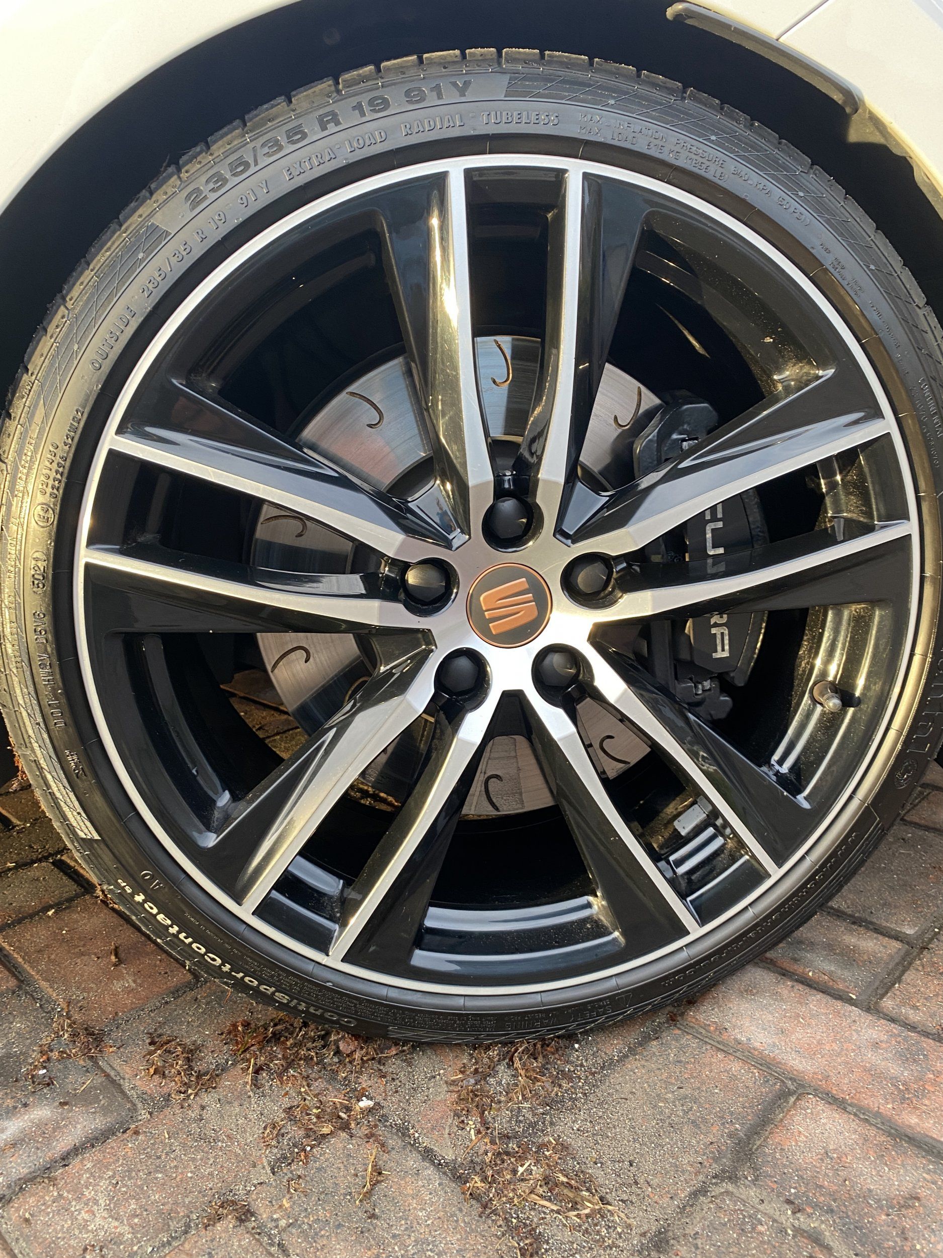

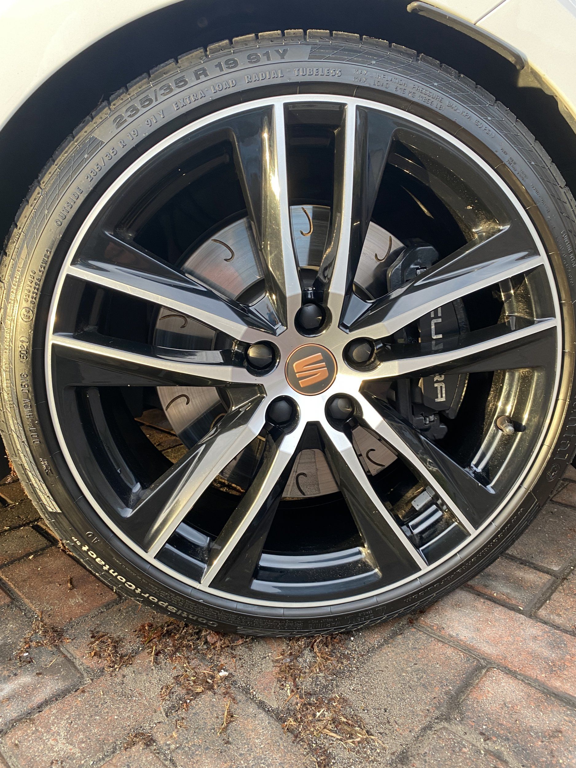

Can I ask who you used for your Remap, and how have you found it. I’ve just recently got my Cupra 300 and wonder how it is in the dry and Warm as struggling in standard power for traction
The dealer put some Falken Azenzis FK520’s on before I picked it up. Found them decent tyres in the past but maybe not upto a car with more power

Not sure how good they are. I’ve got PS4s on mine at the moment. They got rid of a lot of the wheel hop. Plus, you have to know how hard/when to push the throttle. Took me a while! 😂
