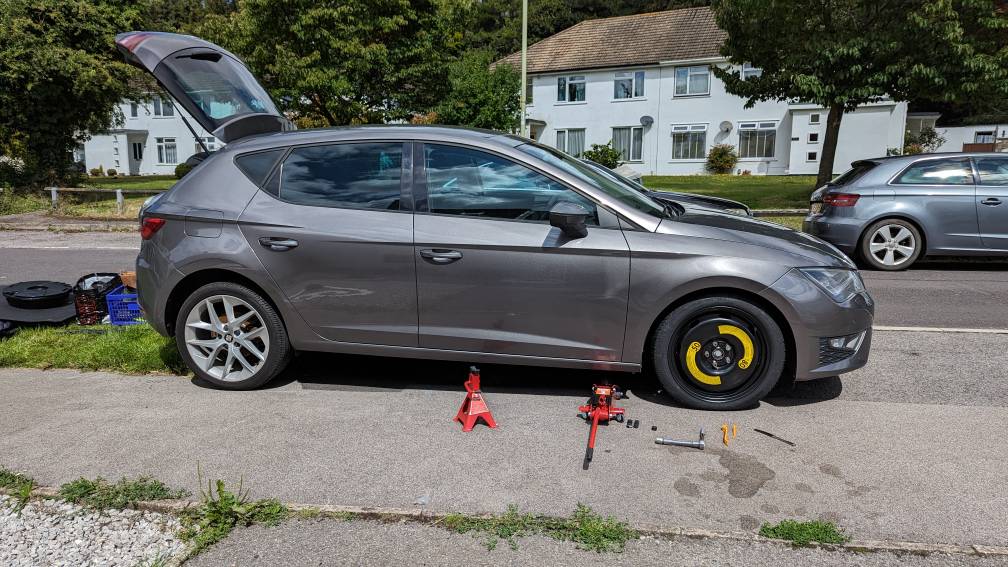

Pumped up the tyre again! Getting bored of this. New tyre isn't the cure so on the hunt for a new alloy

The garage visibly looked at it, but it's 2 tyres that have lost air since being fitted
Sent from my Pixel 7 Pro using Tapatalk
I've found in the past that if the area where the tyre beads sit is dirty or a bit pitted this can cause slow leaks, also had problems of leaking tyre valves where the core has not been tightened enough. Depending how fast the leak is I would suggest putting them in one those baths that some tyre fitters have.
I have been meaning to put it in water. Downside to a sloping drive. Maybe I'll do that before spending out more money
Looks like the seal on the inside of the rim. Took off the wheel and found 3 areas that bubbled when I sprayed on fairy liquid
Now sporting the space saver look which I quite like
