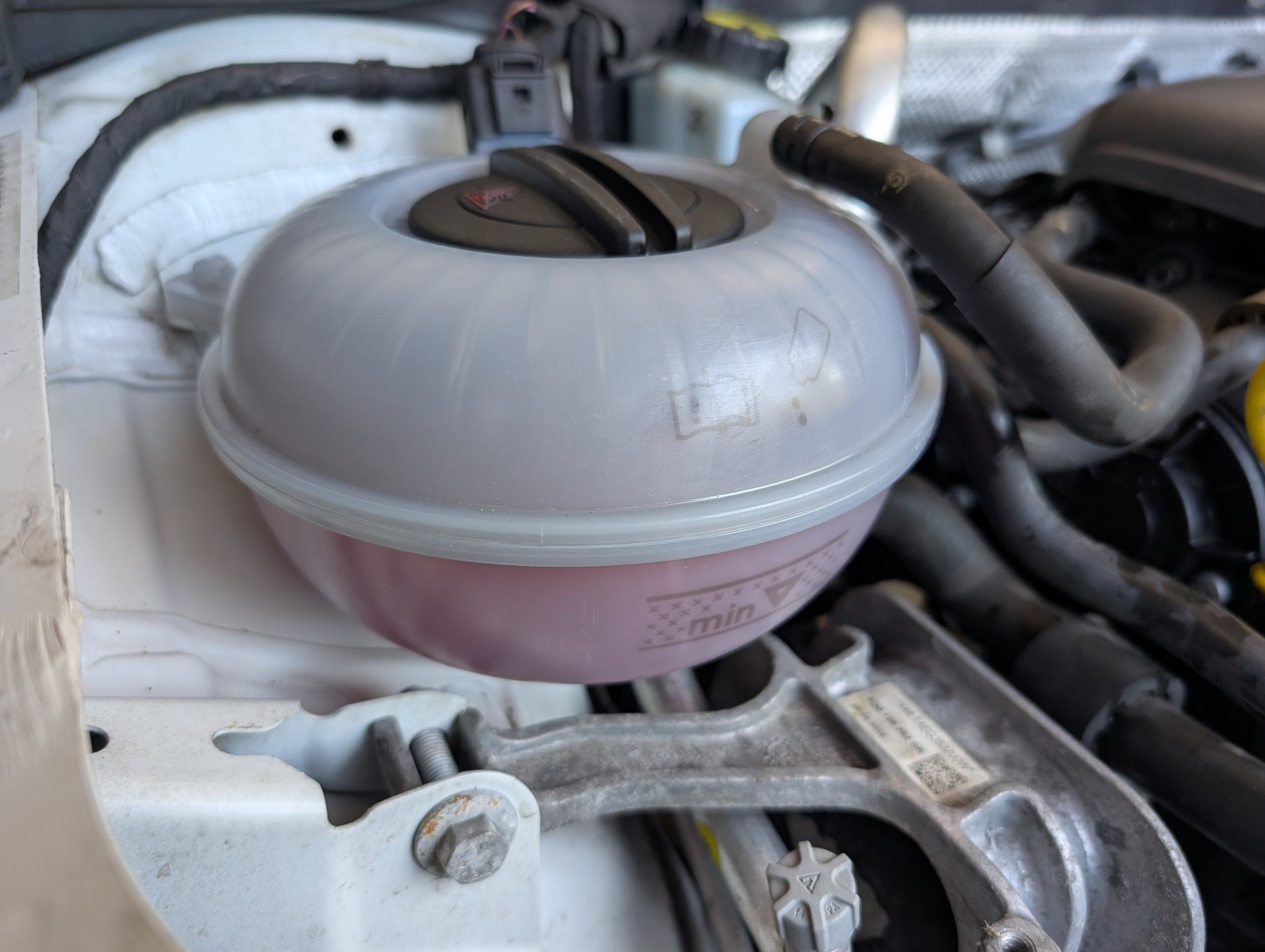

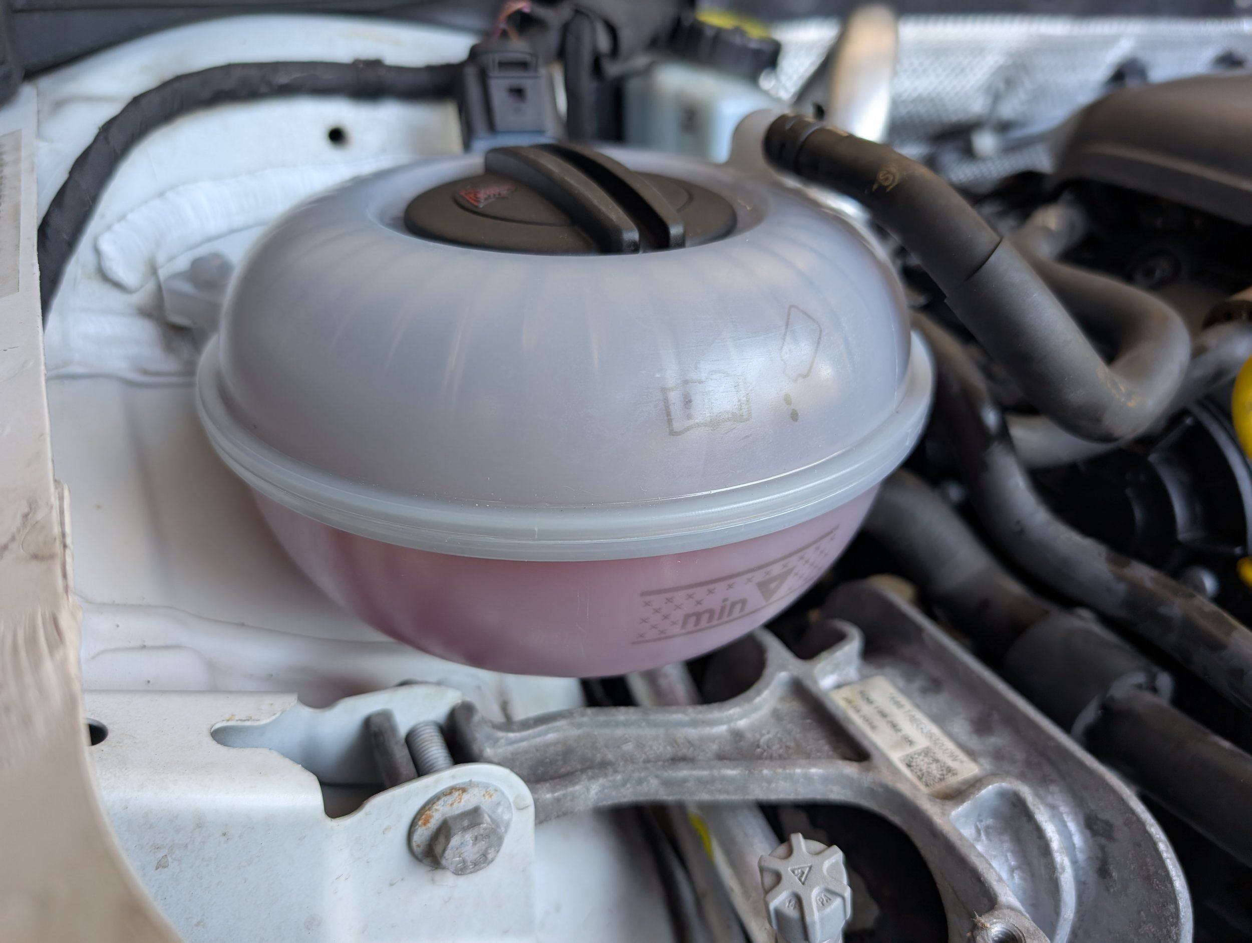

Found some more spare time today so swapped out the grubby coolant reservoir for a new one without the bag of misery LOL

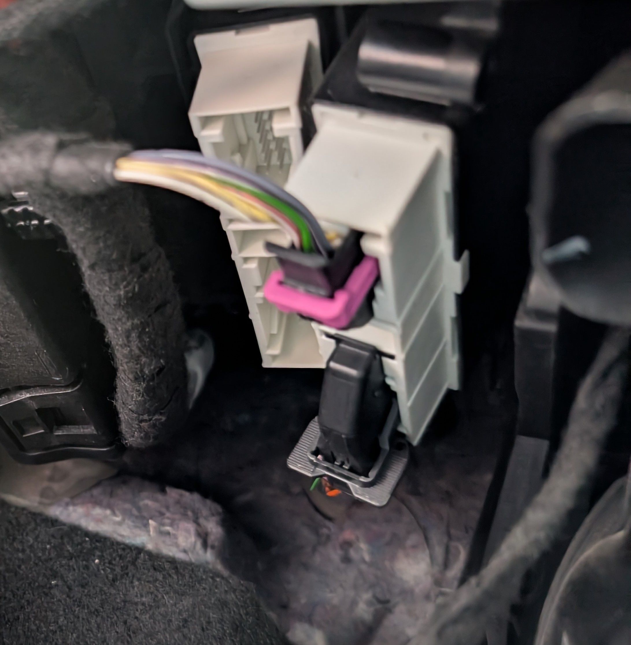

That wasn't what I was talking about. You connected the taillight in the tailgate to the taillight in the body, right?
That doesn't mean anything. If you change the load medium, a different part of the circuit becomes active. There might be too much load in that part. But just have fun. ?
You have a different measuring bridge compared to a halogen one. As correctly stated, because different currents flow. Or how do you think it detects whether an LED is functioning correctly or incorrectly?
Probably you are right. But as long as it will be coded close to the current state (there are tons of Lasttyp values) it should not be a problem.
I'm just pointing it out. That's all I was concerned about.
Side note, my brother is a chip developer and layouter in the automotive sector
So, coding completed, sensors in the vehicle, check to see if everything is working. The module is installed in the trunk.
