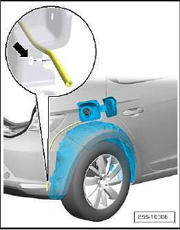

Yes that's the one I mean, when I took the old unit out the pipe came out and I fed it back in again and it sits fine, just want to make sure its not supposed to clip onto something at the bottom. Could not see anything obvious and it will drain to ground I am sure
Update: Checked the workshop manual and yes it does have a place to lock in.
Did you manage to get it back in place? If so, could you explain a bit how to do it. I replaced mine a few weeks back and just put the tube back in somewhere.

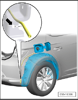

Sorry been away for a couple days, Not yet done it but hope to do a how to on the whole process this week if I get some time.

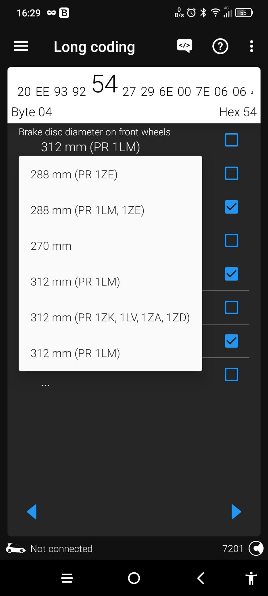

Have you adjusted the ABS control unit?
No I have not, apparently there is a setting to firm up the brake pedal?
  • Love
Reactions: nd-photo.nl
For example on my 2014 280 you get although not sure what you are supposed to use when you disks are even bigger (mine are 380)
