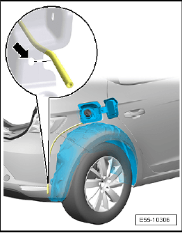

Yes that's the one I mean, when I took the old unit out the pipe came out and I fed it back in again and it sits fine, just want to make sure its not supposed to clip onto something at the bottom. Could not see anything obvious and it will drain to ground I am sureIf you mean the drain pipe that sits outside the fuel filler cap but inside the fuel flap then it's a water/moisture drain and should drain to the ground

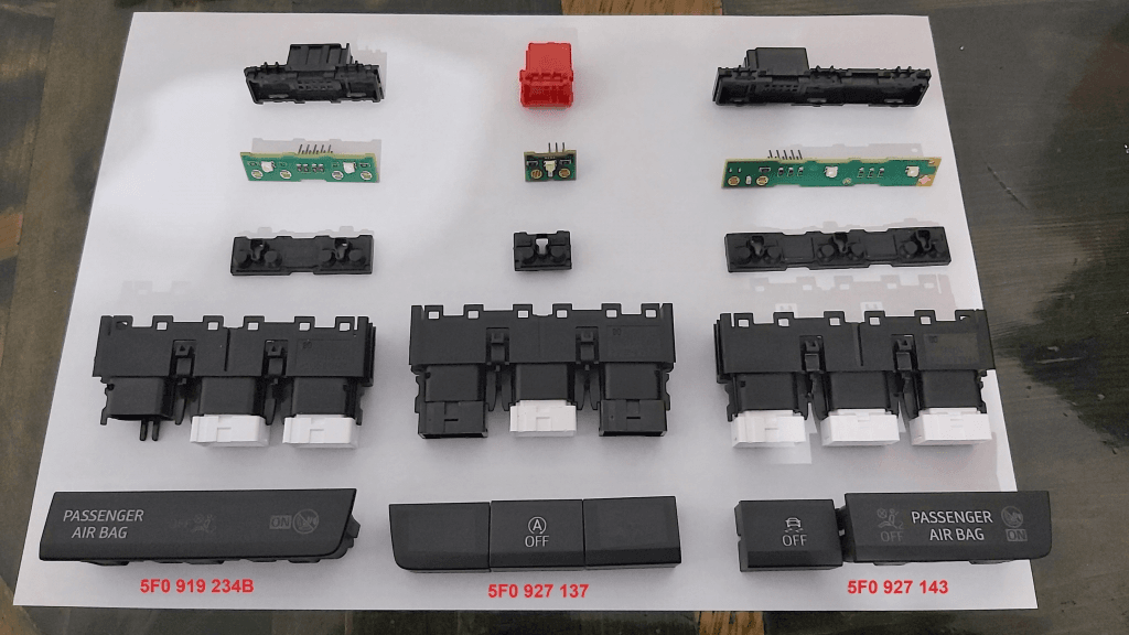

Depending where you want to add button to activate Park Assist. I've got Mode, Start/Stop and Parking Aid buttons so it was not possible to add it on the left side of hazard lights button. You could use ESP Off button from Cupra, but Park Assist need two color button in order to work properly. However you can merge three different panels into one to make this work. You have to use PCBs from 5F0919234B and 5F0927137 with housing from 5F0927143 panel.You Drive Ateca Button?
So ideally I would also use this one, but as I said I've got Mode button. If only there were possibility to cheaply add Kessy then I would definitely install Cupra VZ steering wheel with Start Engine and Mode buttonsI have PLA/Start Stop/PDC-Air View

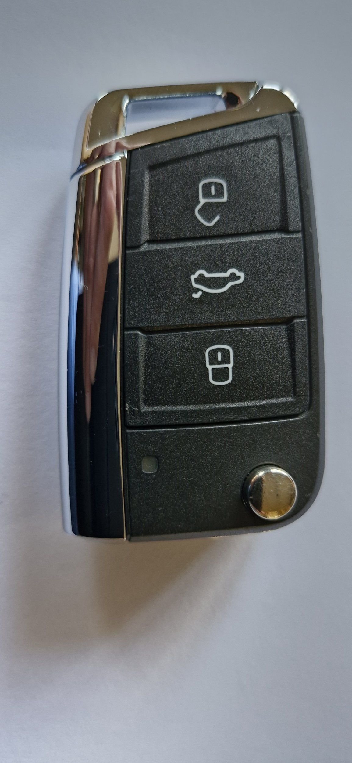

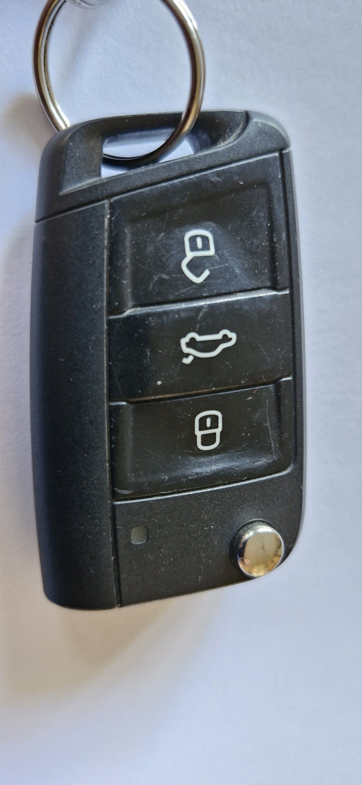

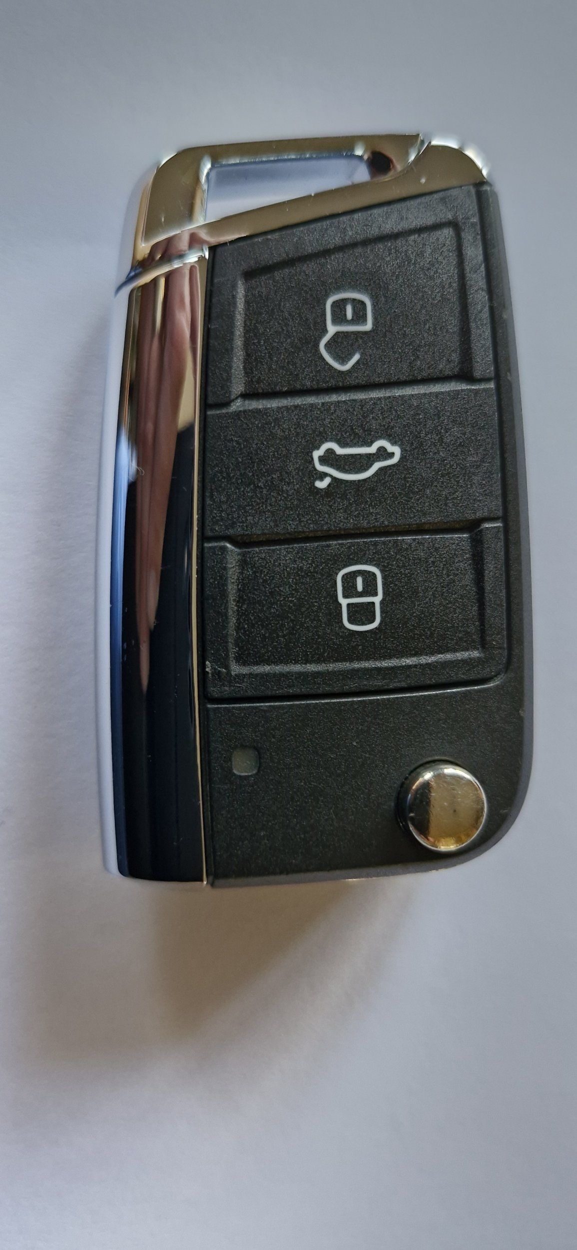

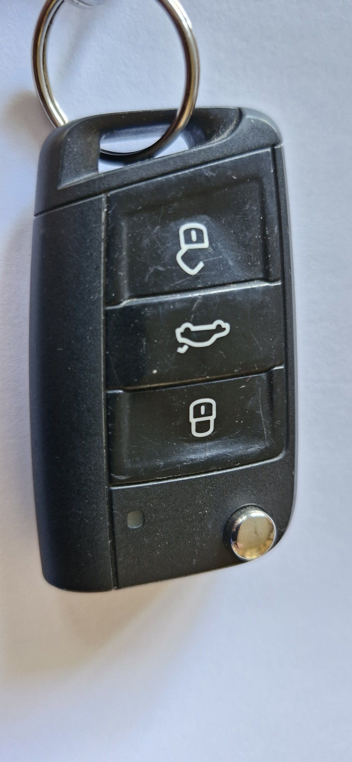

AliExpress Set?Der am häufigsten verwendete Schlüssel unseres Leon sah ein wenig abgenutzt aus (und, um ehrlich zu sein, ein bisschen langweilig), also bekam er mit einem neuen Tastenfeld und etwas Chrom-Bling ein kleines Makeover.
Vor:
Nach:
I bought an unused spare genuine key to strip down and freshen up my aged key, didn't go for the metal parts though, not for any particular reason.eBay from 2 different sellers. I guess AliExpress would have something similar.
To be fair, the chrome top gave me a bit of trouble; I had to adjust the locating lugs with a needle file to get it to clip into the key fob body.
