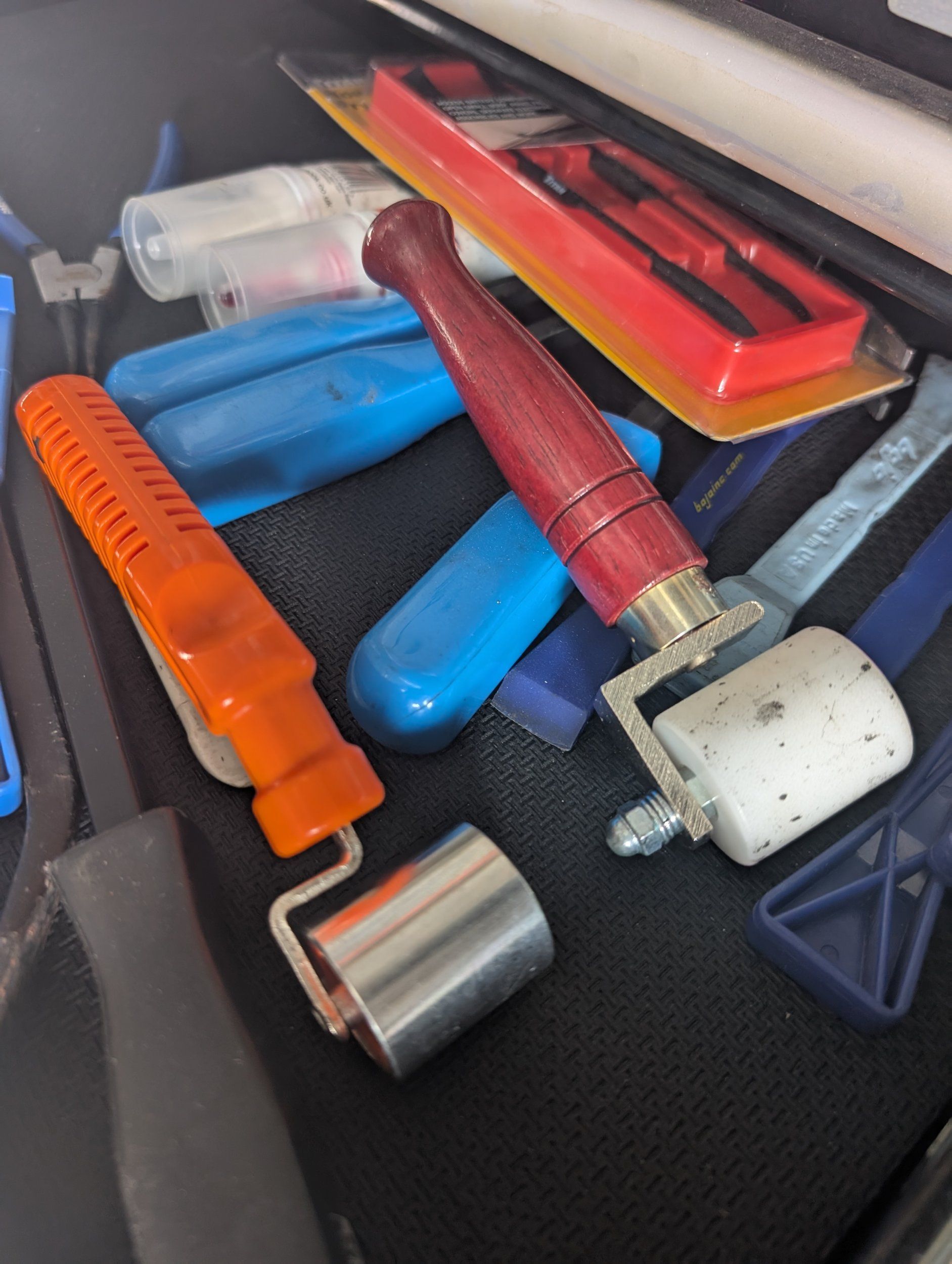

Pro tip, buy one that is bolted on one side and nylon if you can, it's means you can tuck it in to corners/edges nicer and reduces the chance of scratching the paint with the sticking out bits

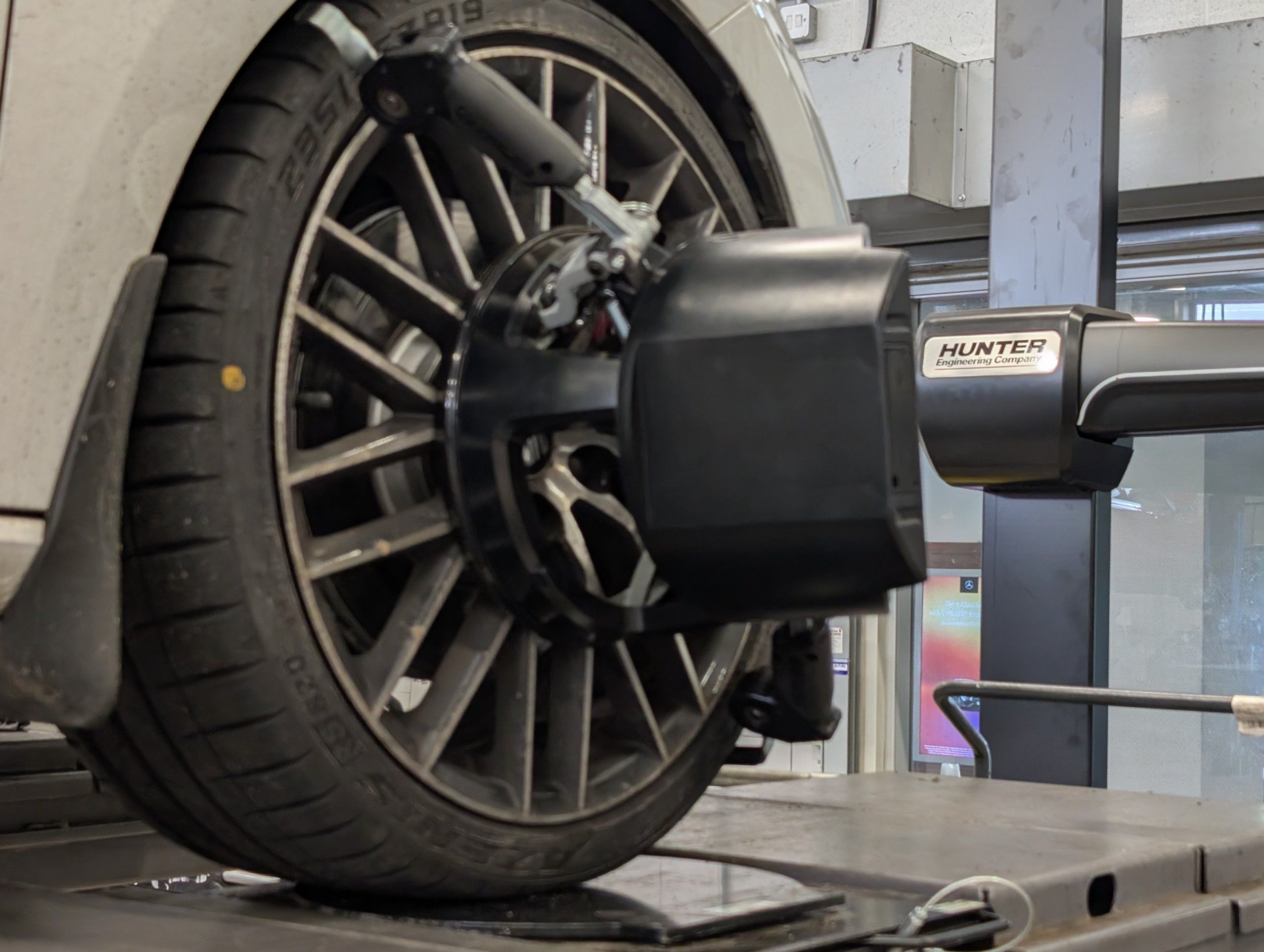

I really wasn't happy with how the car drove and it occurred to me that Seat would have had the subframe and other suspension related parts off the car for the engine replacement so took the car for an alignment. It wasn't out by huge amounts but it was most definitely out so after adjustments were made, the car drove great again!
No specs kept as that information is of no use to me and I use the same person for my alignments so would be pointless me having a print out. Save the trees and all that :ROFLMAO:

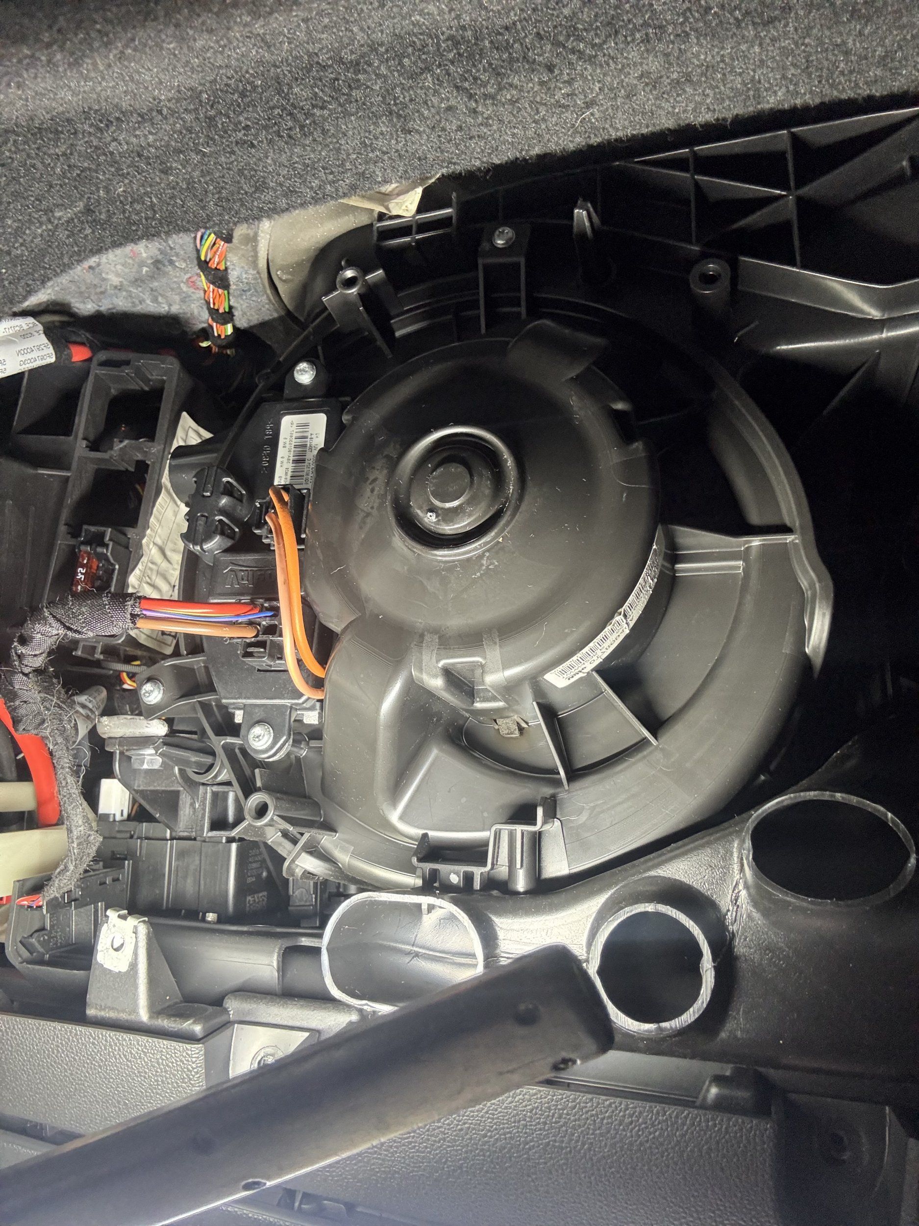

Well unsuccessfully tried to inspect my blower motor. Someone said either needs replacing but also could be have debris or need lubricating.
Had this annoying squeeling nose when I’m driving coming from the blower motor for last year or 2.
Given up on trying to get seat to look at it…Everytime I go in for service or other work I mention it but nobody ever looks at it.

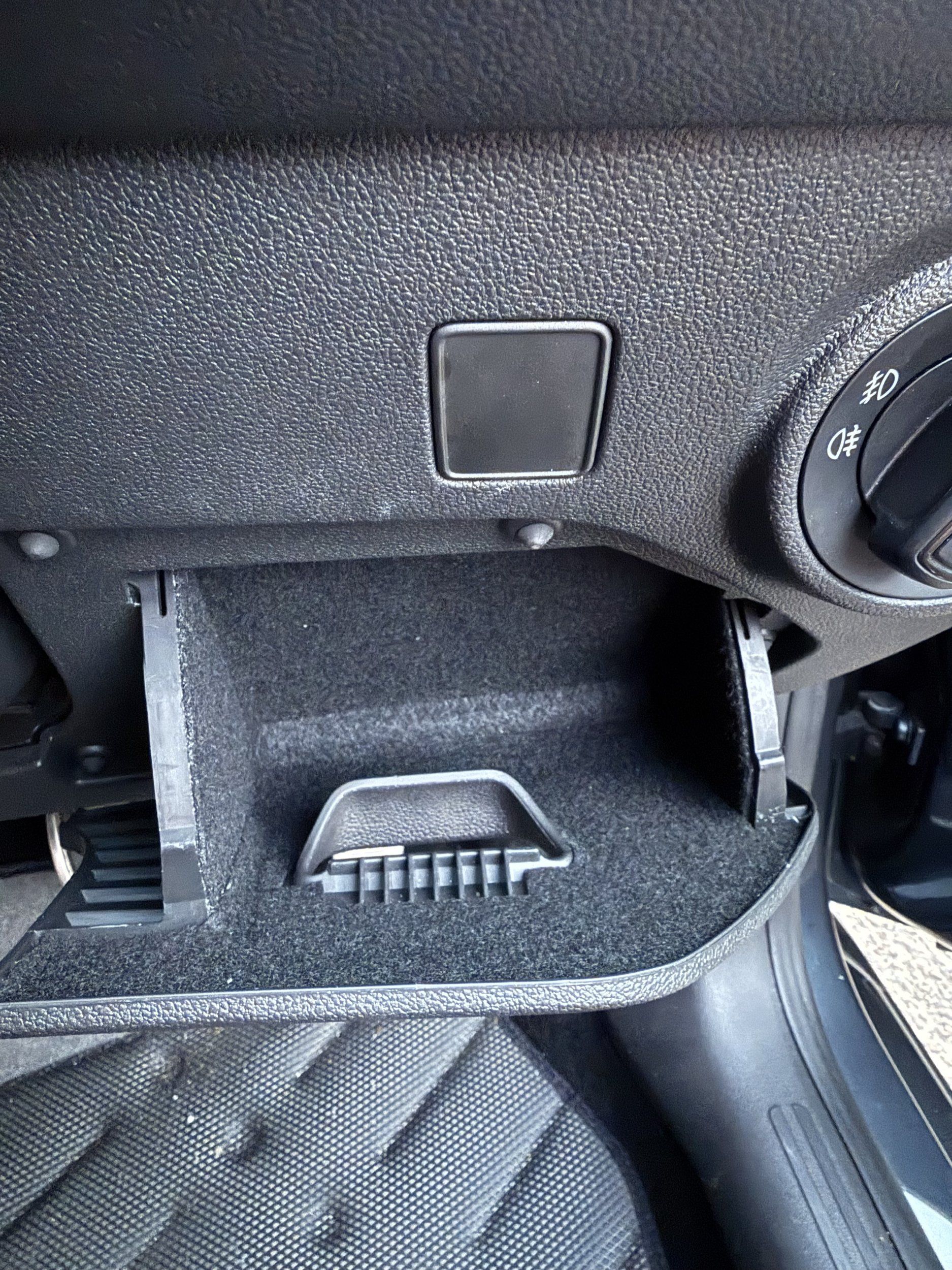

Started unscrewing glove box and realised I may not need to do this and removing the bottom panel may be sufficient enough.
5:00
I just can’t seem to find this locking tab to remove it. Not matter how much I feel around can’t feel or see anything that resembles that tab
Unless I’m just blind?

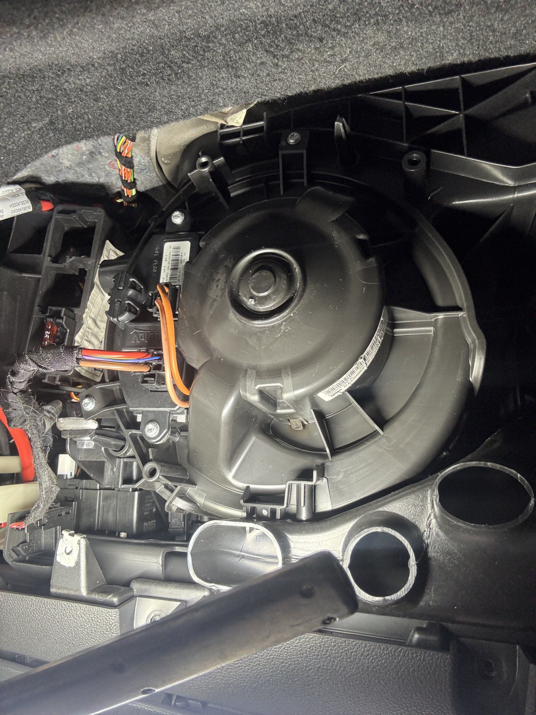

5:00
Yours is held in by the torx screws on the tab looking parts. 2 seen in the pic but may be a third.

Yep, also looks like it slots into place in the air channel (look at the bottom of the picture)
Thanks guys
Will give it another shot this evening if the rain holds up.
Abandoned everything yesterday evening and threw the all screws I removed, in a pot 🤣
The bottom panel is on my car floor as we speak

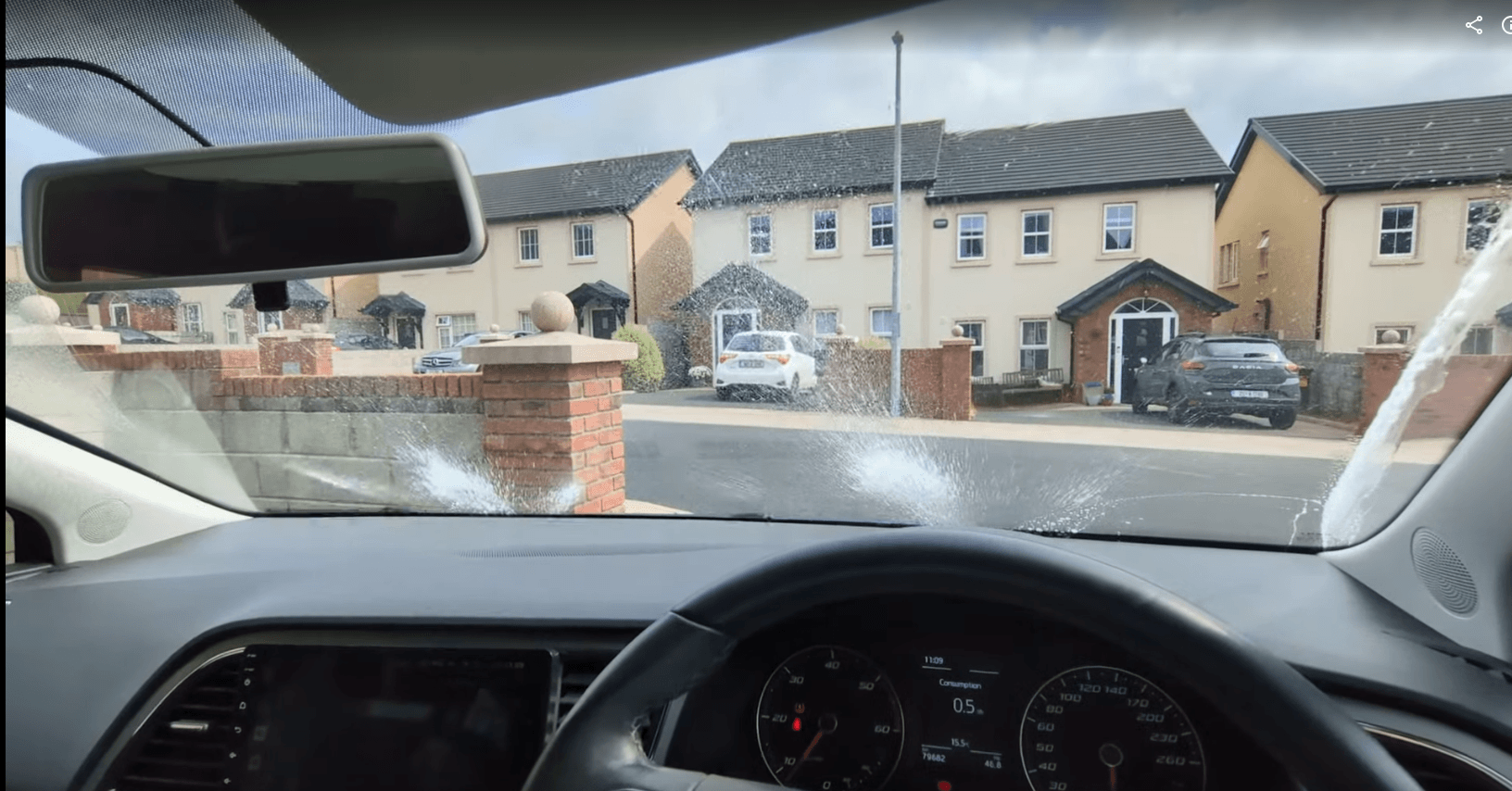

Super easy and cheap upgrade. Fan style windscreen washers. Gives a much better pattern with more foaming than the 3 lances style
They are also heated but I don't have heated from factory, so not wired it up. No problem really in Ireland's climate, just use -5 degrees fluid.
Unfortunately the tiny clip that holds the hose on to the washer broke on me. Luckily I 3D printed a replacement for a BMW and it's the exact same.
Link to aliexpress item: Windscreen washers
Link to 3D printed clip: BMW washer pump clip 3D print

Can anyone confirm if Frostybears spray spread is good as OEM ones? Looks to me as if it is weak, but it might be because of angle of photo.
