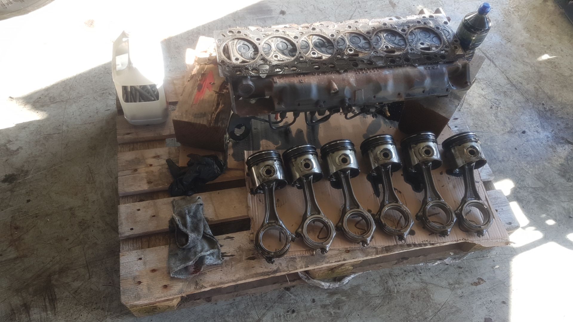

300,000km and they recon it's smoking. I can't see any when it's running or even when the exhaust was stripped off. But the dpf kept blocking up and I have changed nearly every thing... so the last resort was piston rings... so today was stripping the head of a 17 plate 18 ton daf. And the the sump...
The ring gaps where massive lol... so new rings ordered along with big end shells and head set.....
