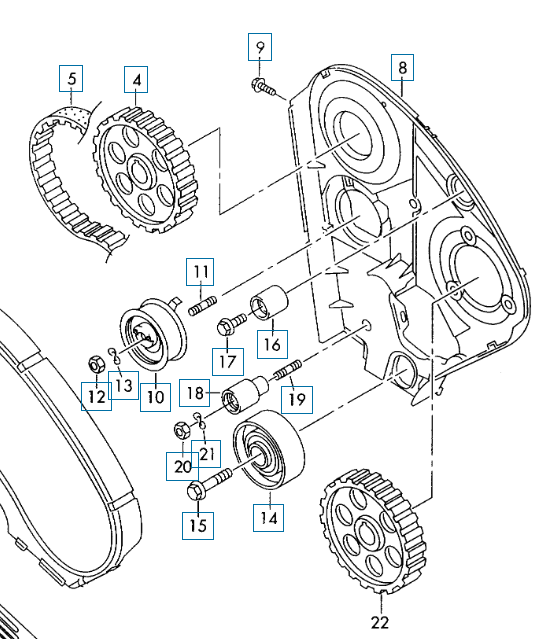

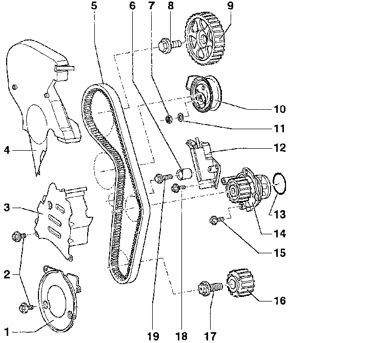

Doesn't your engine have 2 idler pulleys?
no thats a different setup to mine, mines the 1.8t 20v AUQ engine, it has the cam pulley, hydraulic tensioner with idler pulley attached, then it has a concentric pulley that helps keep belt tensioned with the hydraulic pulley, waterpump and the crank pulley, nothing else. Ive made a thread for this issue to save cluttering up this one, appreciative of any help.
