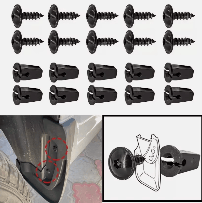

Today I had to fix the side skirts that had flexed out under the jack, so took them off, cleaned them up and replaced all the screws with new. All straight and neat again!
Some where on ebay you can get stainless steel version of the screws. They are a posi drive but won't rust and easier to remove than stupid torn cr4p
Nam-uk
May 11, 2011
1,297
434
lancashire.
I had one trashed screw but managed to jam a torx bit a size bigger into it and managed to turn it a mm at a time after a spray of GT85.
They will go always go back straight, but you have to remove them completely and refit. Just trying to do the flexed end doesn't work so some reason.
I got them replacement screws and the inserts off AliExpress there not expensive, i needed them for side skirt and inner wheel arch covers as i used bigger screws but the plugs will break in the end, if you go bundle deal and pick 3 items is free postage
