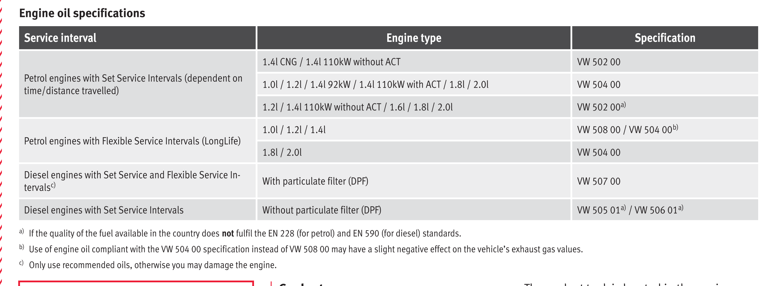

Hello all. I own a 2016 Leon 1.2t. I realise Castrol Edge 5w 30 oil is recommended. If I use an alternative spec OEM oil, which VW spec oil do I need to look for? As I may change it myself on my next service.
Cheers.

Page 60 in the manual
