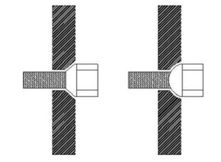

Edit; if you go for a set aftermarket alloys you may need new wheel bolts. Seat OEM alloys use bolts with a radius seat and most aftermarket alloys use bolts with a tapered seat (there are a few aftermarket alloys where your existing OEM bolts can be re-used - e.g. some designs of Mak alloys). It’s really important that bolts with the correct seat type are used - the seat type must match the profile of the contact surface in the bolt hole of the wheel to ensure there’s maximum contact between the mating surfaces. Using the incorrect bolts could result in them working loose - or worse still - a wheel coming off the car. You can see the difference in the two different bolt types on the picture below - the bolt on the left has a tapered seat and the one on the right has a radius seat. Also, really important bolts are the correct length and thread size.
