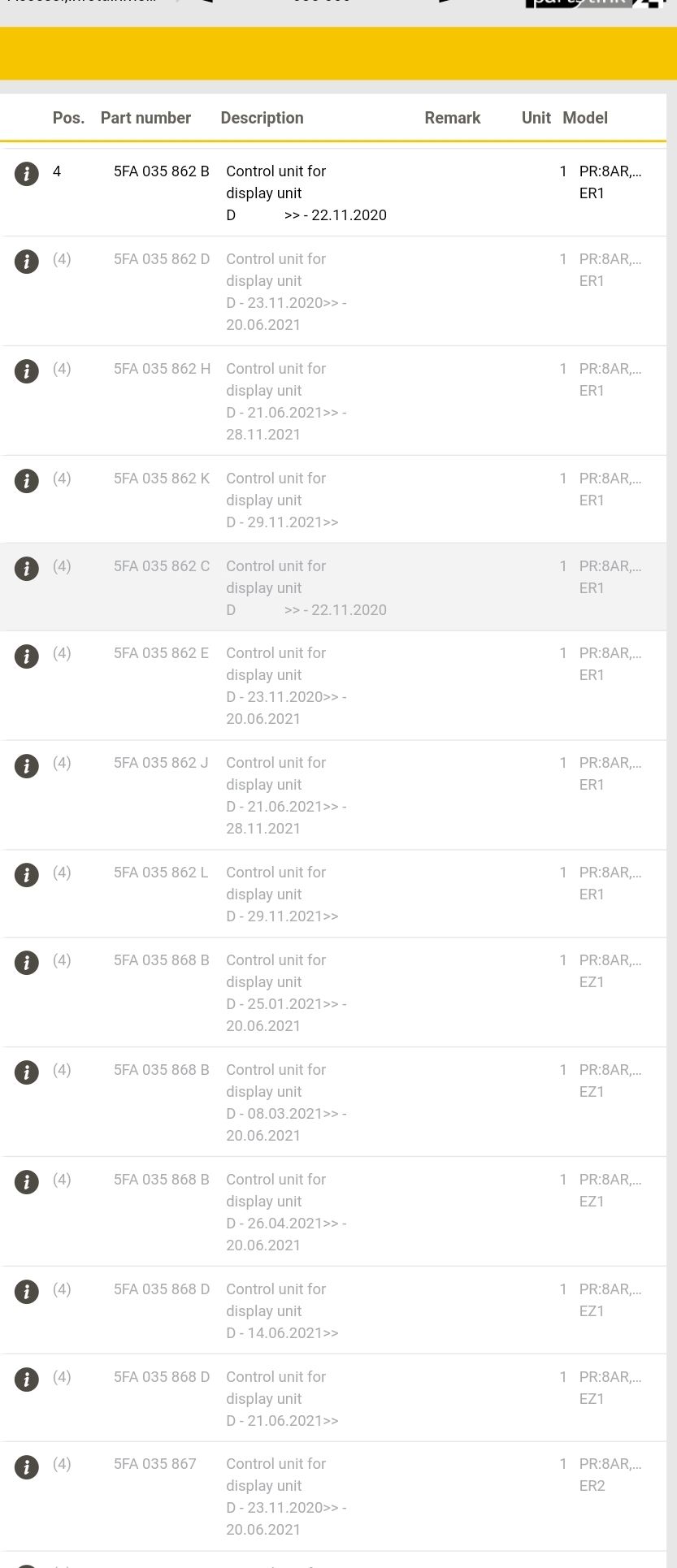

16xx only supports wireless Carplay. Doesn't show heated seat settings while using full link. Part number ends B
17xx & 18xx support wireless carplay & wireless AA. Shows heated seat settings while using full link. Part number ends D or later.
16xx cannot currently be updated to 17xx/18xx, update to 1810 is coming soon
17xx can be updated to 18xx

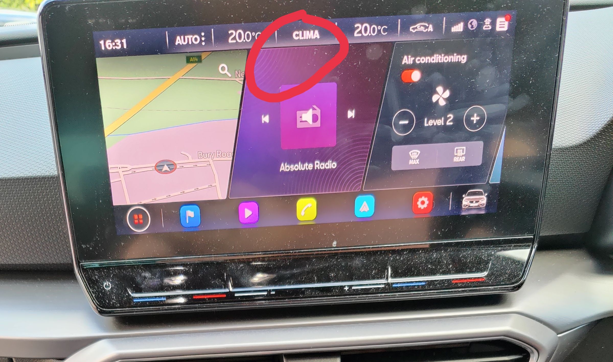

Quickest way to tell is if the top bar says Clima in the middle instead of just a fan icon with a number
