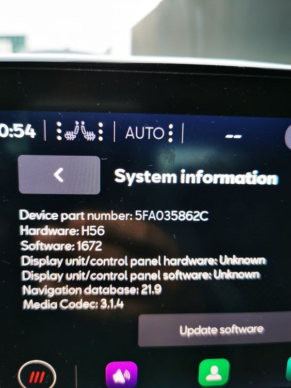

I reckon it would be done at the dealer that's how the update was applied from 1664 to 1672

No it'll be done at your local dealer, FOC whilst your warranty is valid

It works on 2021 mib3 with bonnet up. I've done the same process on a few different Seats and have spoken to the dealership here about it.
It only works on vehicles on the correct software. Many of the ones lacking the feature aren't. Seat/Cupra haven't yet released the update to bring all of the older units upto date
This isn't current doable on most vehicles. Only vehicles built from mid November 2020 have the correct software for wireless android auto. Anything built 2021 will be fine
