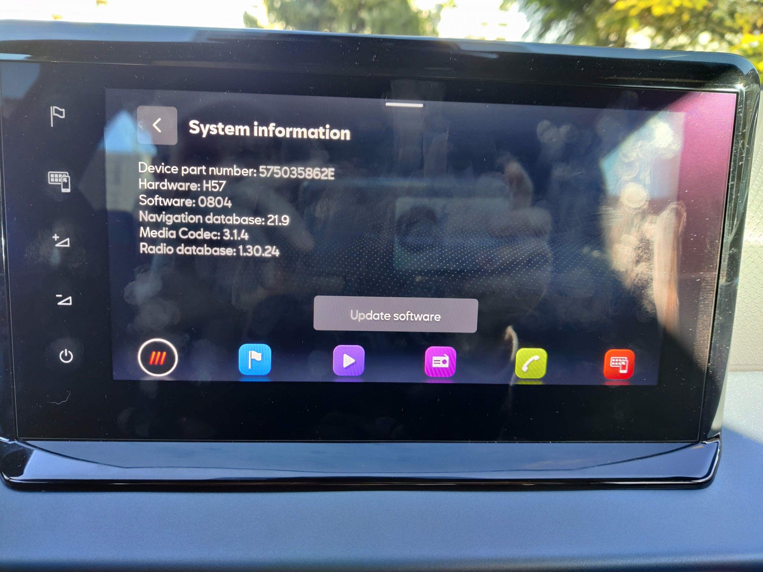

how can we check if we have zn1 or zn2 unit?
They are the build codes. It depends whether in Portugal they used them to specify the units. In the UK they didn't. Germany they did etc. But it's the last character of the part number that's all important D and above is Android Auto Wireless enabled. The part number is really generated by the firmware rather than the hardware. One of the boards sponsor above pointed out it was all the same hardware but different firmware:
At some future point it's conceivable that the firmware can be updated as described above. Online updates do not appear to change the train so you will not get a B to D update over the air.
i have a D one and cant connect wireless!

I also can't connect wirelessly to my Seat Arona 2021 model. There is no option for wireless AA in the infotainment. I have Onelplus Nord, Android 11.
