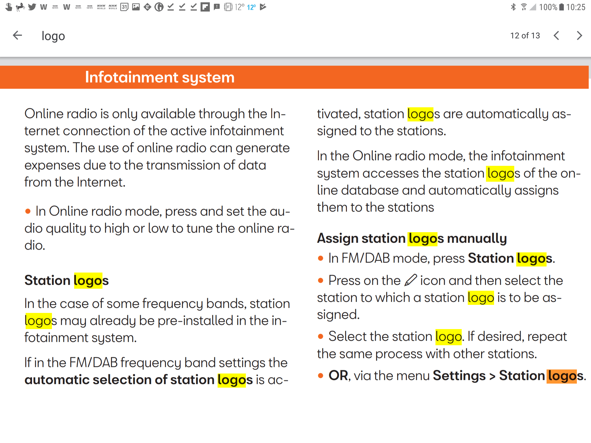

Ditto radio logo graphics import menu also missing but in the manual. Attached on that. It's the "pen" that nobody has found. They delete the radio logo by accident or have a station with none or incorrect but can't import it.
Might be these have appeared in newer firmware.

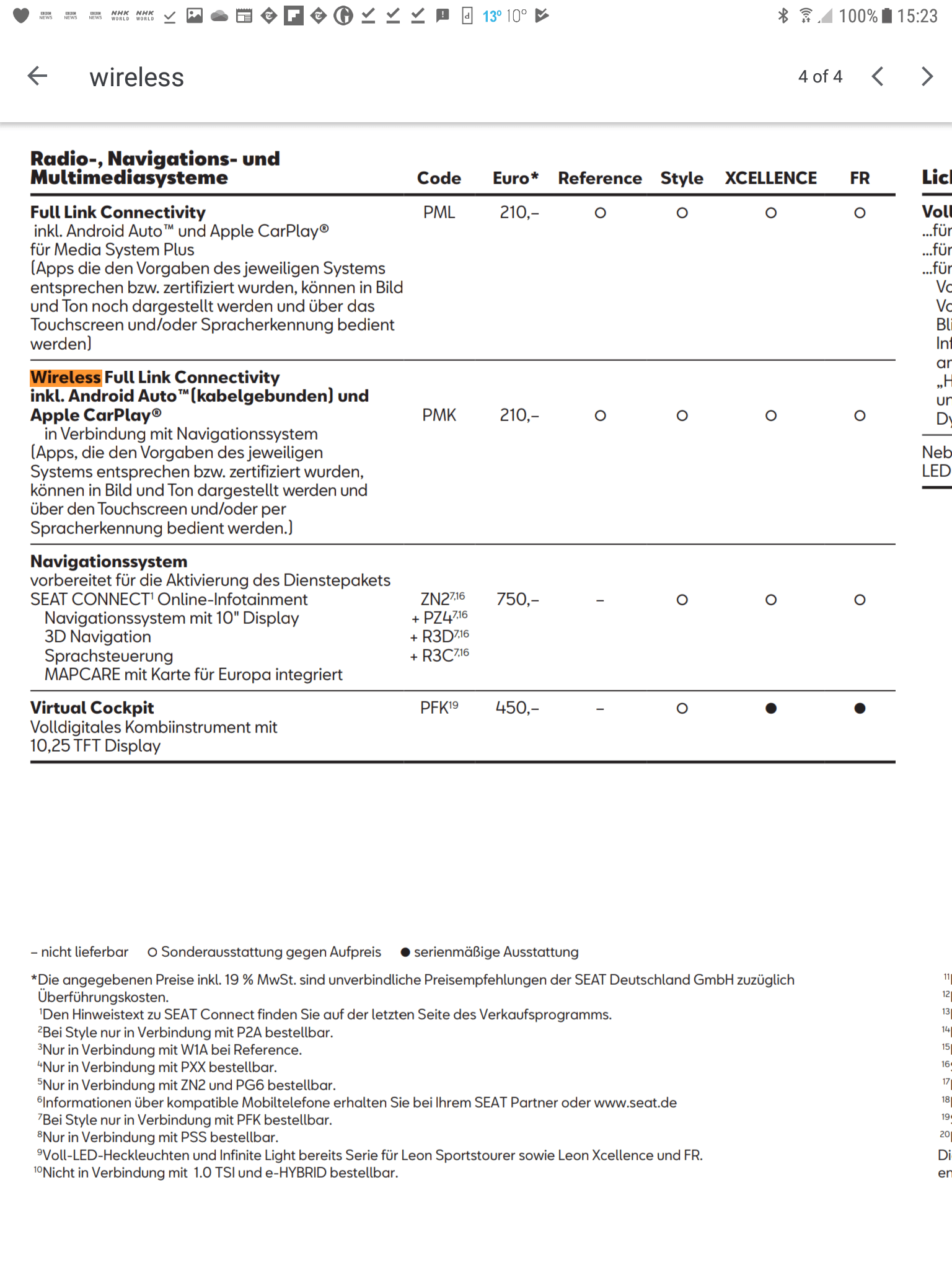

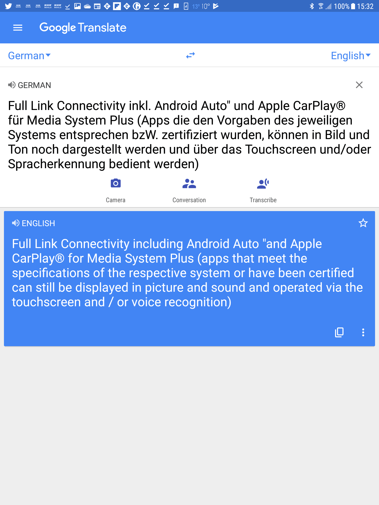

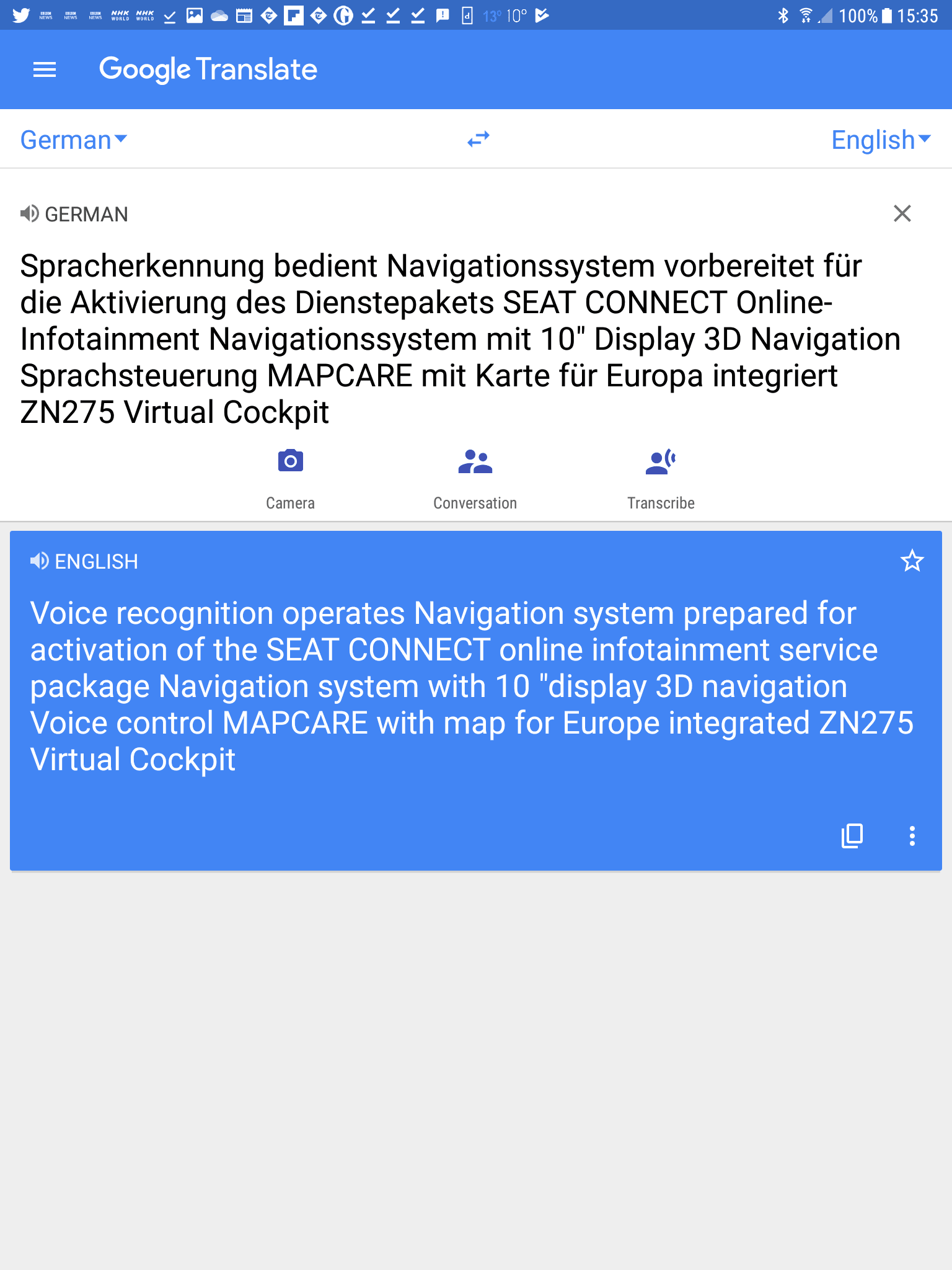

Ok back on topic found the Zn2 build code on the German Seat website. On the business sale models. Zn1 isn't featured but PML is full link without wireless, PMK with. Then the RR system Zn2 with optional 3D mapping.
Reckon where the two systems come from. Last one being the RR system that nobody has in the UK. Reckon the part numbers map to those build codes

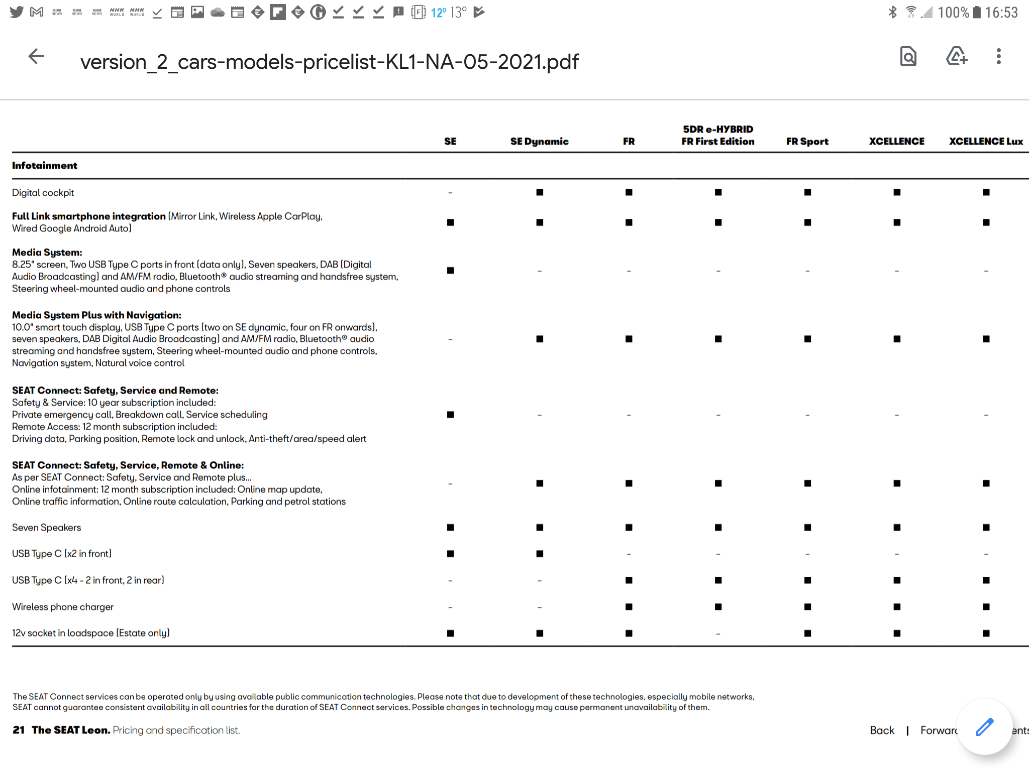

& the May 2021 Price list says this.

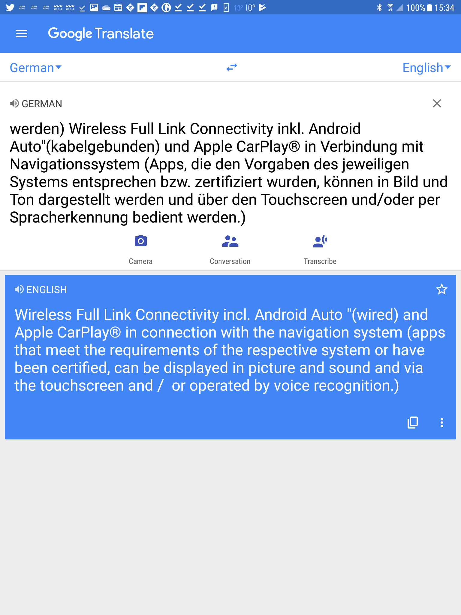

Reckon wireless was optional on price list pre to this or they slapped in the incorrect unit or did what they pleased. People need to check pricelists they ordered against to determine. May 2020 version 2 brochure didn't mention wireless or Android and Infotainment system once. I didn't save a copy of pricelists so pass on that.
On face value it's now sold with Wireless Android Auto connectivity, if they were like the business German range there were options.

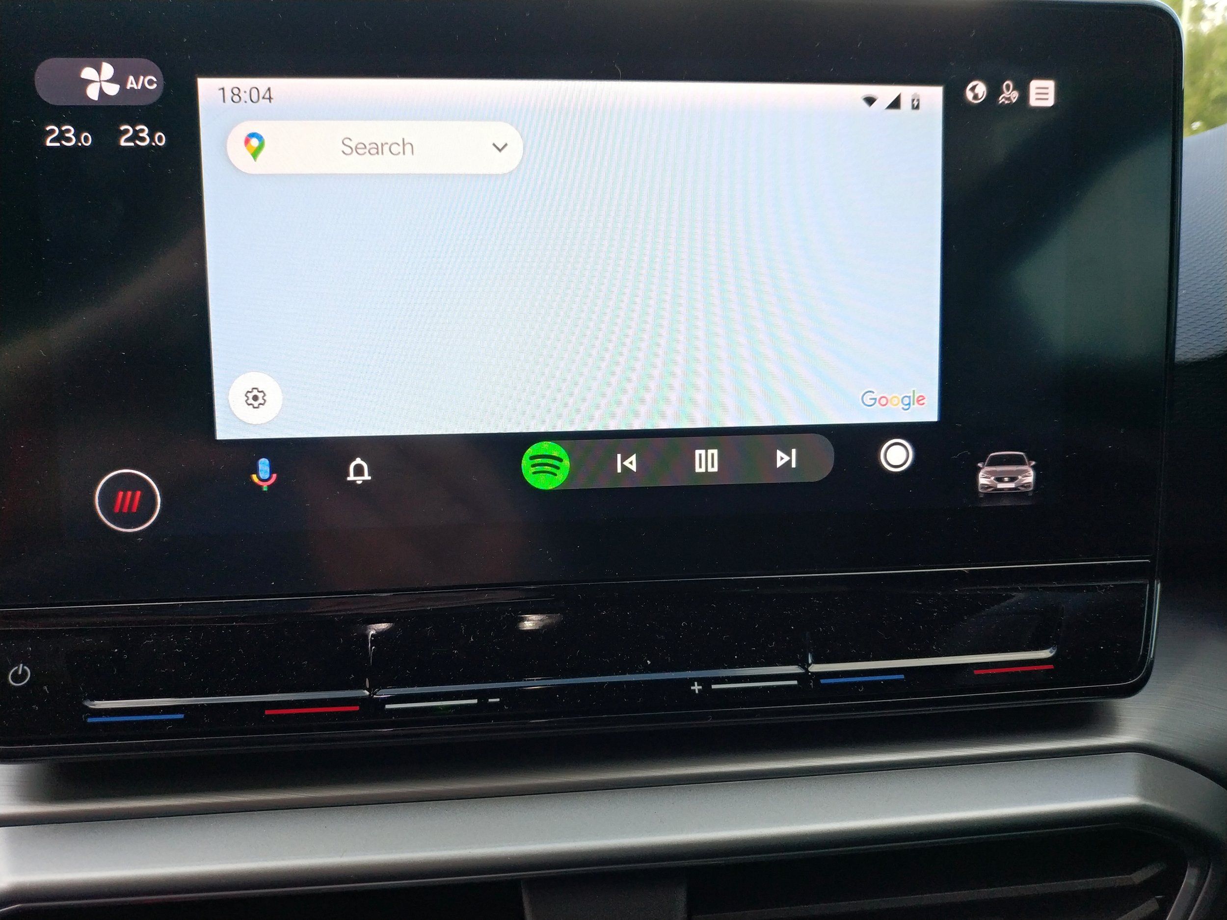

This is how mine looked on both the MK4's we had in for review (FR First Edition and 1.5 eTSI), looked awful!
Apologies for bumping this to reply to a post from a few months ago, but the fix for a terrible looking Android Auto experience lies in the phone's settings.
Disconnect your phone from the car and open AA. Depending on your version of Android, you may have to go into the phone's settings and search for Android Auto as it has been removed as a standalone app. Once open, tap on the heading; Android Auto, until you see a popup telling you developer mode has been enabled.
Now tap the three dots menu, open Developer Settings and scroll down to Video resolution to set it to allow up to whatever your max resolution is, in my case it was 1080p.

Just tried setting mine to 1080p, and it made no change
What's your part number and software version for the infotainment

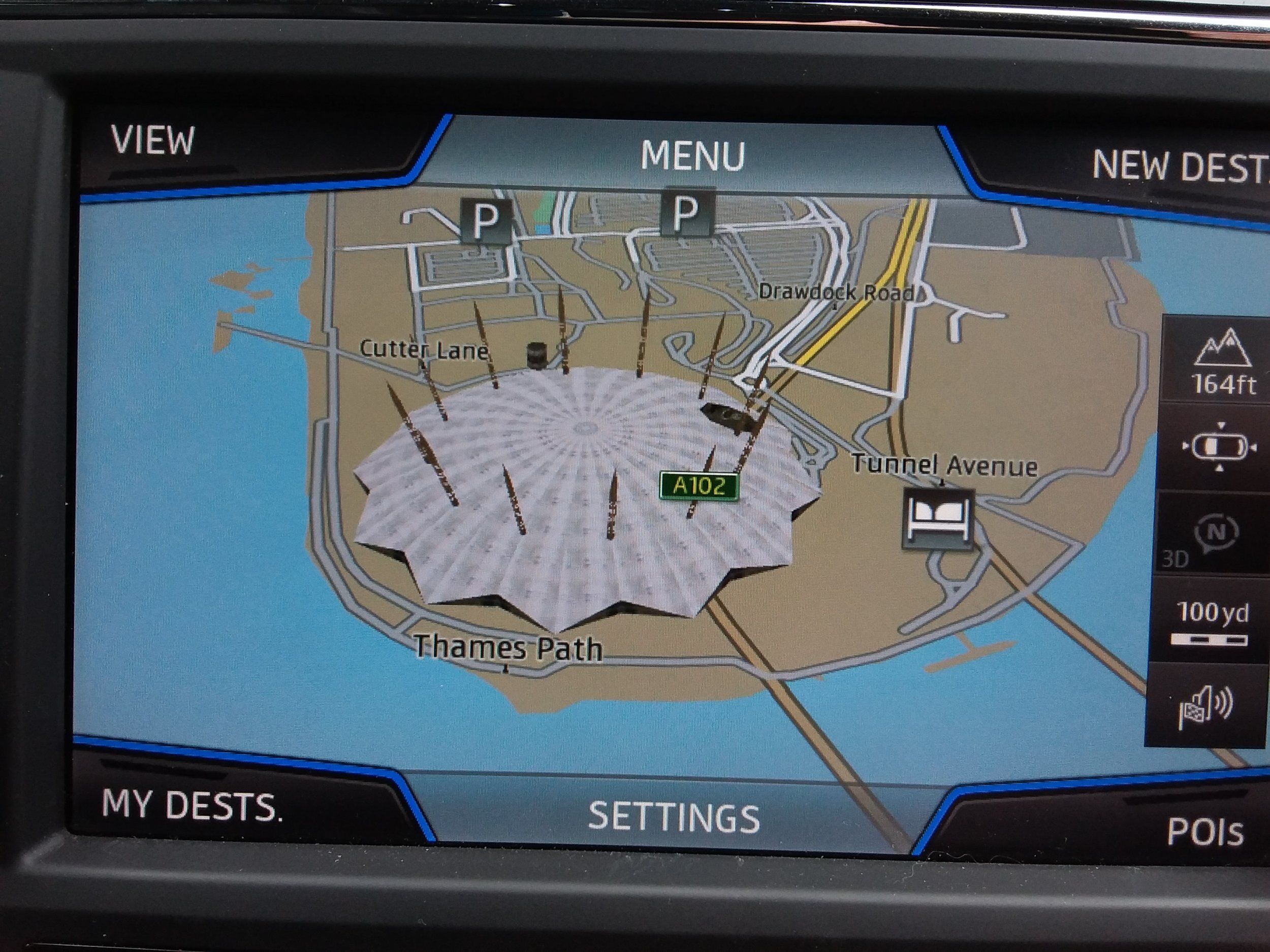

Yes I think it suffers from a marketing history. Same hardware, but Seat decided to differentiate two products from the hardware the same as the mib2 standard and high but that was different hardware, zn1 and zn2, they even carried the build codes over. Those build codes never hit the UK but can be found in Europe. I did a VIN lookup up on European cars being sold and a UK demonstrator. Zn2 was the bells and whistles one and that option for 3D emblematic maps of buildings same as the mib2 high but was a higher offer in Zn2 on mib3. I'm not sure where we are on that one. Whether it's a FeC to get them out to show. That could be seen on the business brochure as a further option. So there are three offerings. Without AA, with AA and with AA + 3D emblematic graphics of landmarks.
It appears marketing wireless AA as a separate thing fizzled out and was ambiguous in the UK why some had it and others didn't. They didn't know whether they were selling zn1 or zn2. That leaves those 3D emblematic icons which rotate as you drive past to be bottomed out (zn2+ ?).
This bit:
I've tried to encourage people to look for these who have Wireless AA..... I'm sure it will all become clear in the fullness of time probably from those business cars sold in Europe with the full works. The hardware uses Here Maps unlike TomTom of the standard so it's pedigree is a mib2 high with bolt on connected services. Some more bolted on than others with x,y coordinates saved as last destinations rather than names so I understand.
I'm sure it will go through generation of software updates but being connected you do worry about whether map updates could be pulled at a future point, what updates you can do without connected services and how resilient it is to connected services being withdrawn. Normal form is a new Mib every fives years so that puts mib4 at 2025, mib5 at 2030... just in time for electric cars (I'm marking time).

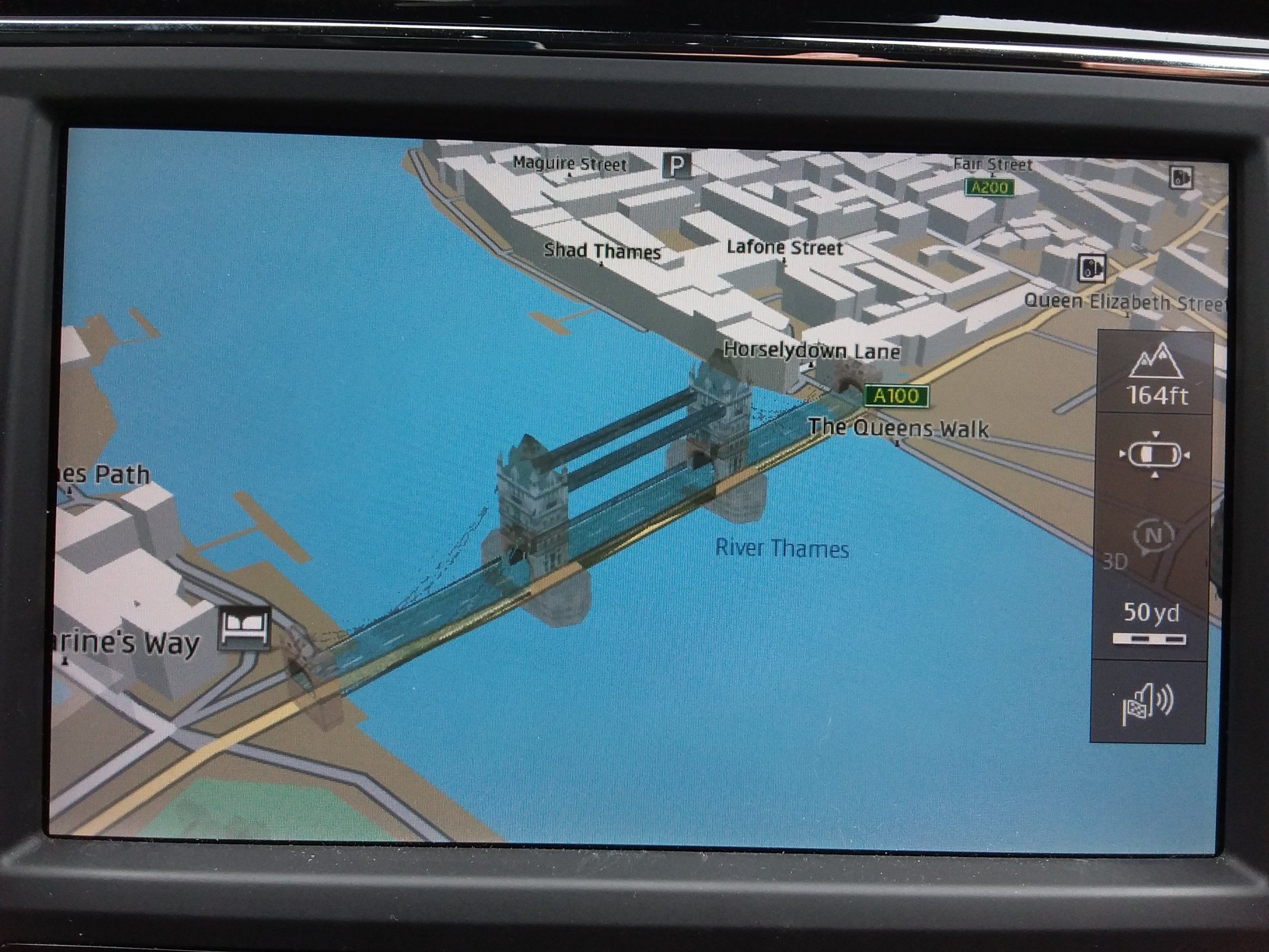

What the 3D emblematic maps look like on a mib2 high, which I believe is the R3D build code, total deluxe (examples The Dome and Tower Bridge, they spin and rotate as you approach... mib2 high trick from Here Maps cartography) (suspect a FeC enables it to show those in a Mib3 rather than a specific software version):
