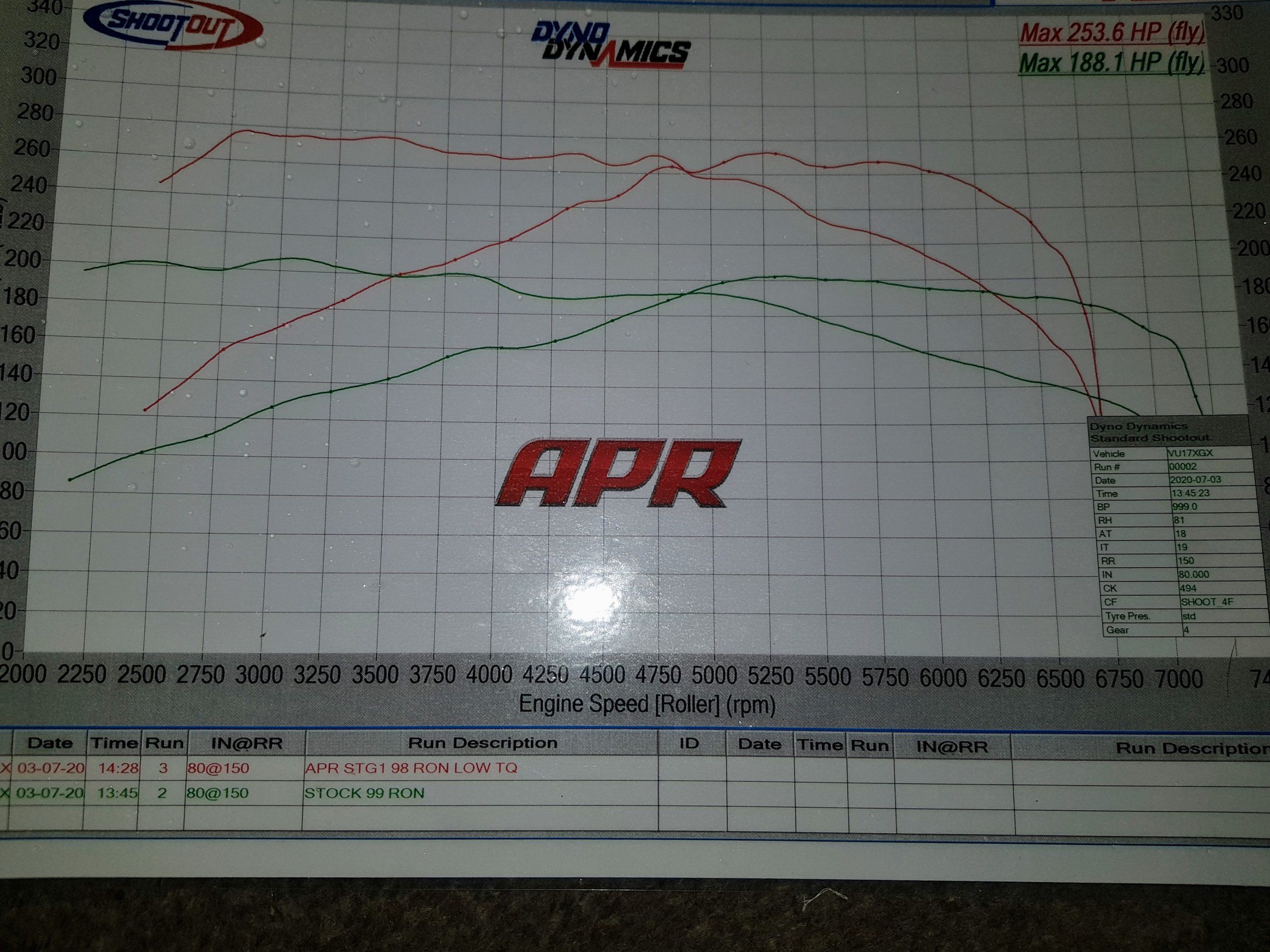

Ive got 1.8tsi manual. Owned for a year and half.
I have had mine remapped by apr stock it run 190hp after tune 253hp and 376nm.
Car is amazing now, prior to the map it was pretty slugish.
Map has been on almost a year great fun. Any questions just ask

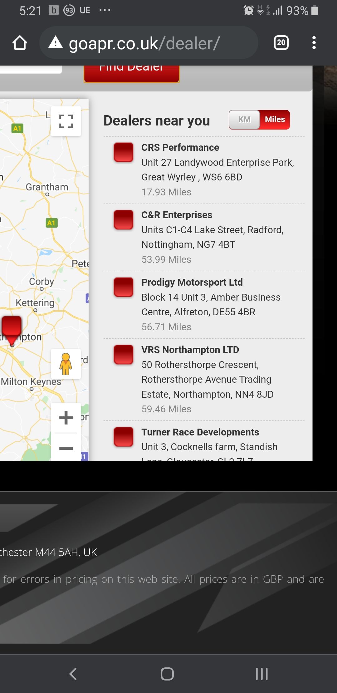

Do you have a link as to where I can get it done? I’ve tried googling it but no luck, I live in the UK, Birmingham/Worcester area
How much did they charge you for the APR remap?

190 is a bit more then stock was wondering what figures would I realistically get on a dsg
