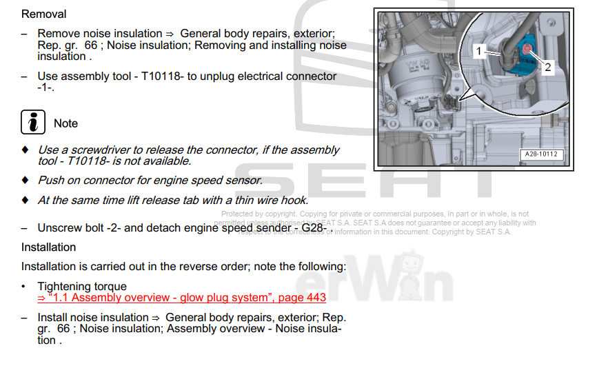

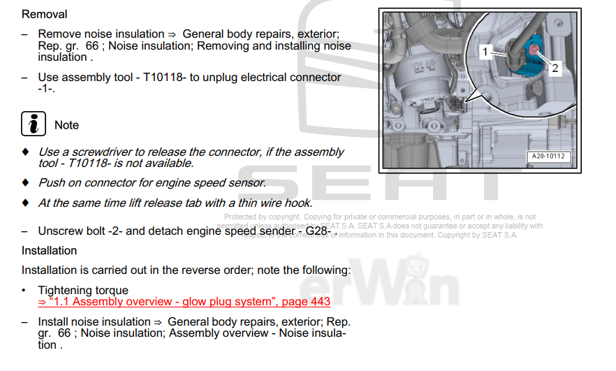

Doesn't look too bad to remove. SEAT call it an 'Engine speed sender' G28.
Did my oil/filter service yesterday - and while 'in-there' I had a look at removing this crank sensor for a clean! Well very difficult access - that drawing doesn't do it justice!
A comment on the youtube video linked say's its a 4mm allen key - and they had to remove oil filter housing for better access and even then was very difficult needing a mirror. I could barley feel it with 1 finger tip - it is really deep in there.
# just to add - I wasn't able to take it out - but I was a little tight for time.

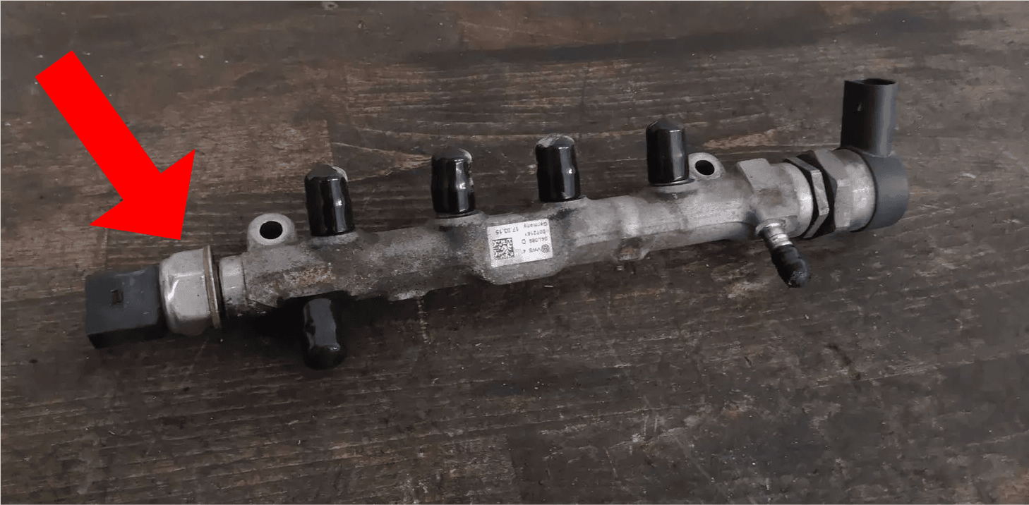

My son had this sort of issue on his 184TDi
We found the issue by chance.
He had the engine running and went around wiggling the wires going in to all the connectors.
As soon as I wiggled the wires going in to the pressure sensor - the engine stuttered slightly.
The final fix was to slightly bend the three pins in the fuel rail pressure sensor connector so they made stronger contact with the connector pins.

Give the fuel pressure sensor pins a tweek first before you buy a sensor.
That is what fixed my sons car.
If it is the pins - a new sensor will act the same.
Reactions: SuperV8 and Faggy31

Thanks for the advice. Got any pics where the sensor is located? Im a fairly new to this haha
BillyCool
Jan 16, 2020
737
302
Leicestershire, UK
Following 👆🏻
Left side of the fuel rail. Quite easy to get to.
