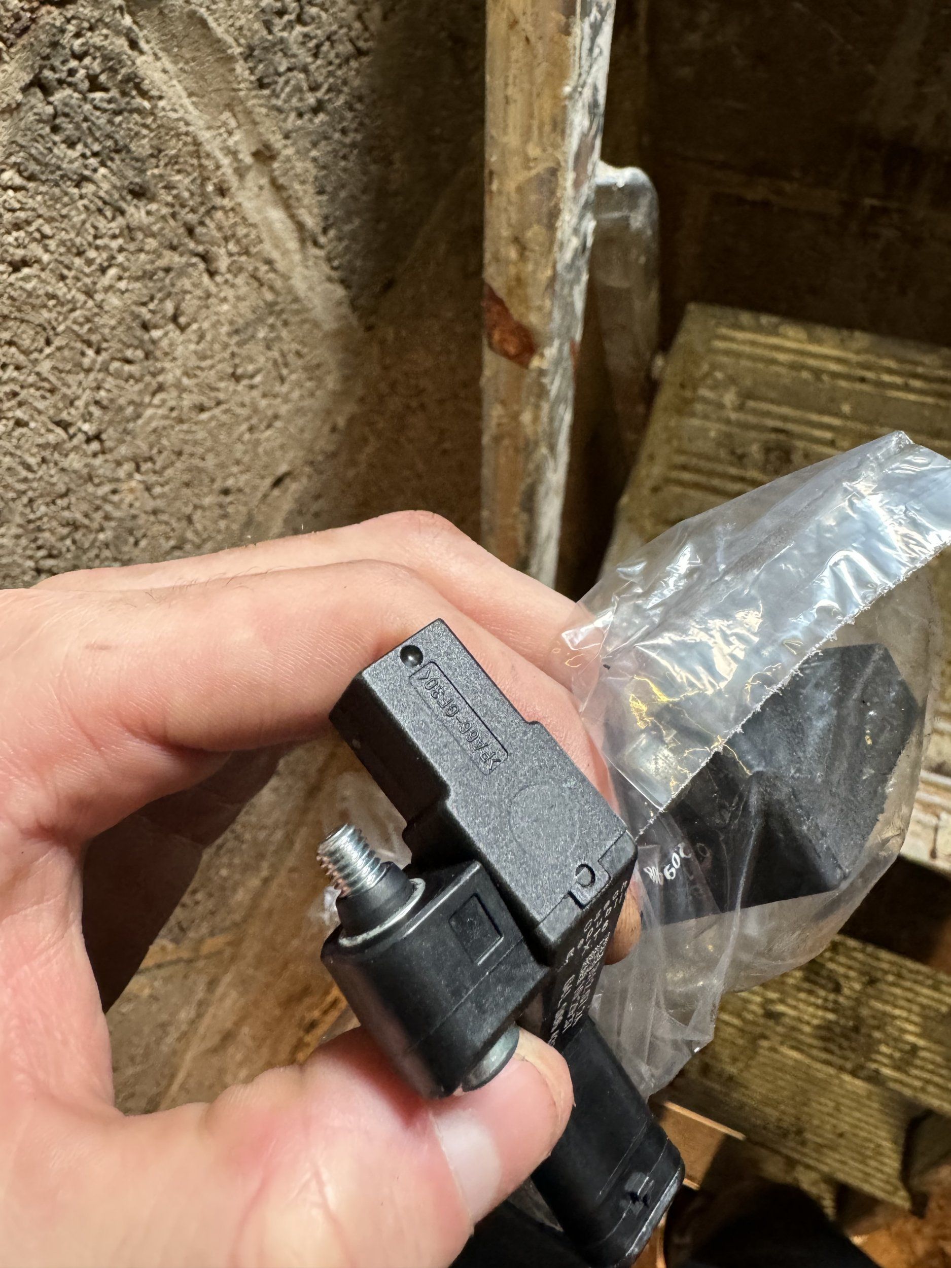

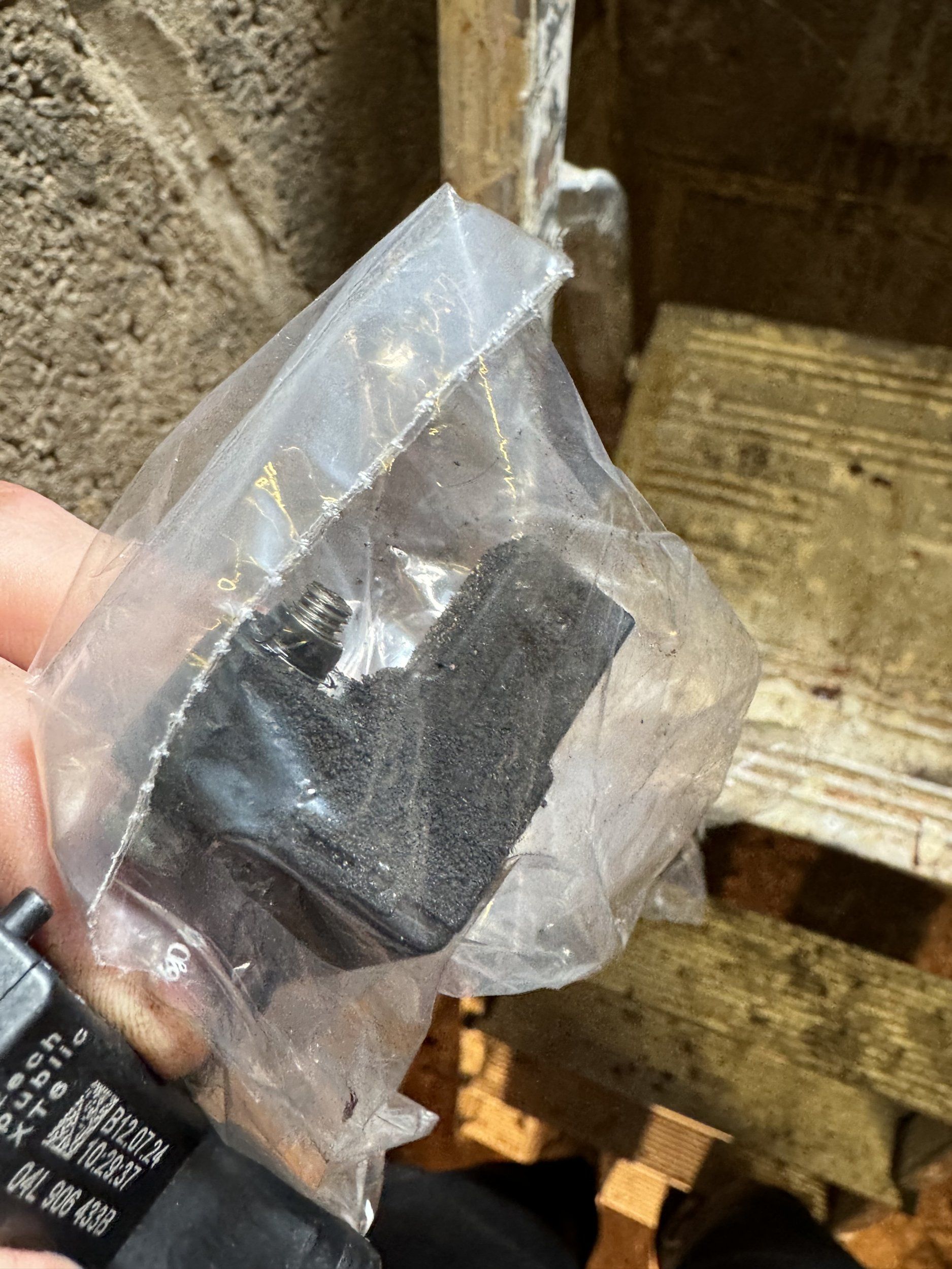

An update on this from my situation I have replaced my old crankshaft sensor today. It a bit of a pain to get it out and back in securely and I had to remove the oil filter housing to get to it so did an oil change too. The old and new sensor side by side in pictures. I took the car out for a drive and seems slightly better to pick up on acceleration and didn’t encounter the power cut at all. Hoping that this has solved it but if it hasn’t at least I know the other sensors are easier to get too ! ?

Can confirm all fixed and was crank sensor ??

There are a few different parts numbers depending on your engine/year.
My impulse crank sensor for example, on my 2015 184 CUPA engine is 04L906433B
