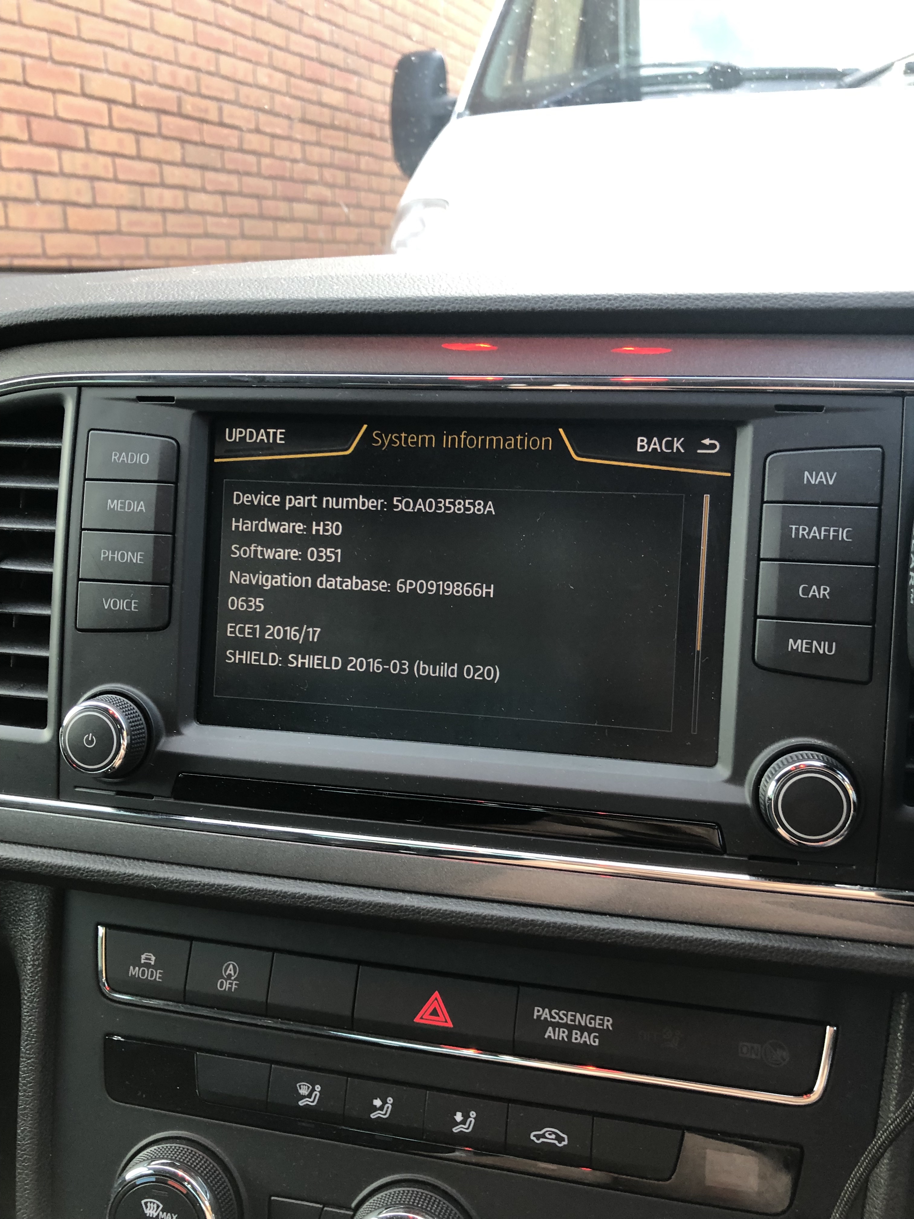

Do you know what MIB unit you have ?
Take a pic and post it. Clicking settings and going to system info as you'll need an MIB 2 fitted

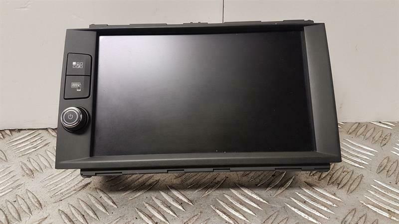

So I have this screen and wanted to see if this screen (5F0 919 606) would fit basically!

Yes it will, yours is MIB2 Std unit, you will of course have to modify the aperture where the screen fits, doesn't show when the screen is in situ. Not sure if your software will need updating, maybe wolverine_uk knows?
So in what way do I need to modify the aperture? will I need new trim or something, wish it was as easy as taking it out and putting the new one in. I just don't want to ruin my car haha :p

So it's just the software, so if I'm on software 0351, what do I need for this screen to work and how do I find/download that software?
I have apple car play so I'm not worried about having the latest maps as I use google, just need to know what I need for it to work! :D
