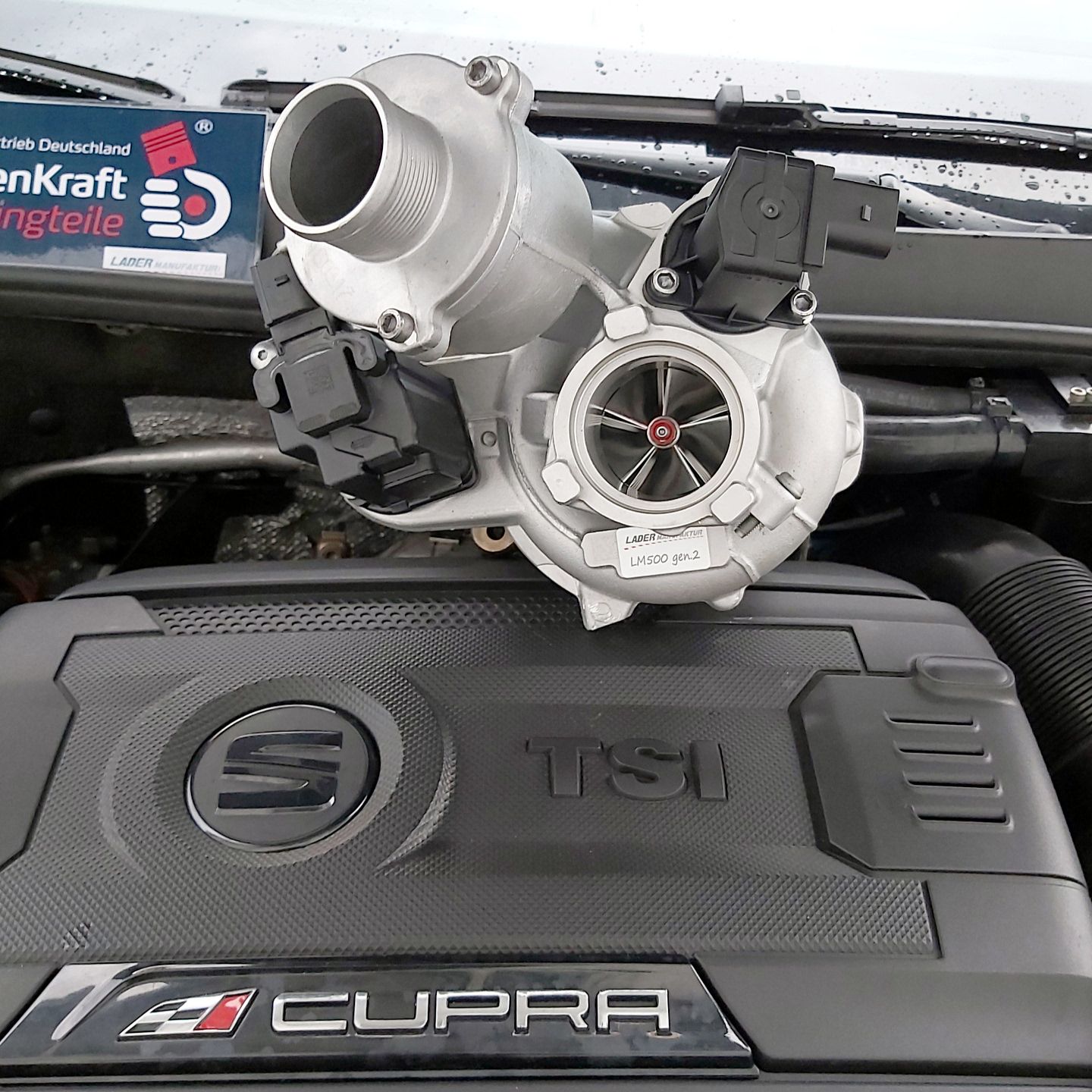

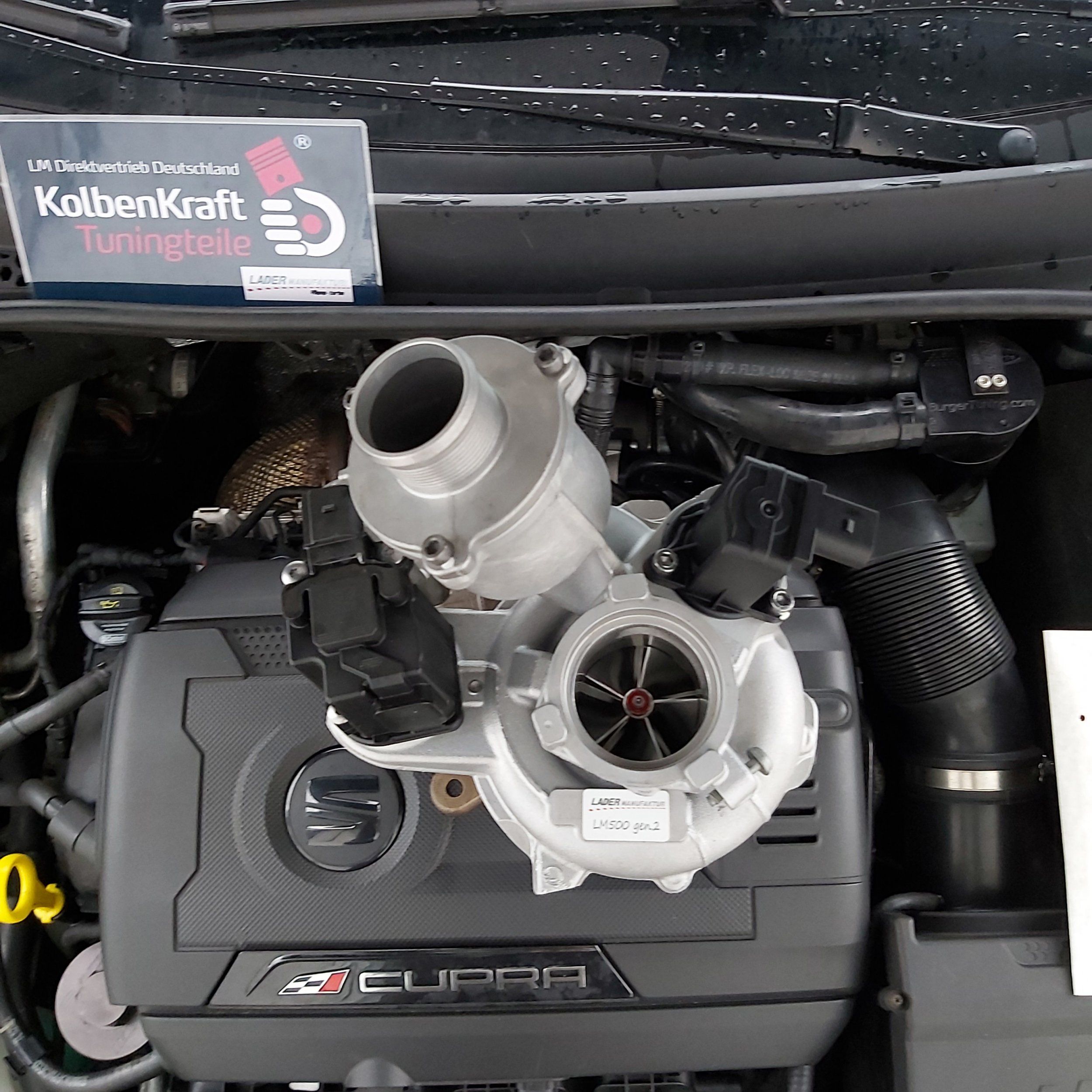

LM500 V2 Gen2 Turbolader Upgrade Turbocharger Upgradelader Stage 3 Seat Leon Cupra 5F MK3.jpg 20200522_205642.jpg LM IS38 Upgrade Turbolader Golf 7R Audi S3 8V 8V.jpg 20200522_204742.jpg LM500V2_Upgrade Turbo.jpg LM500 V2 2018.jpg

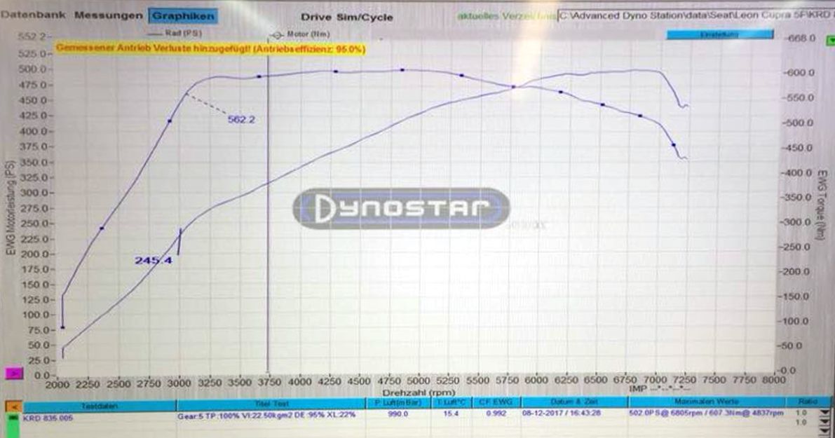

Here the new LM440 world record - received yesterday. For tunes ask Stertman, MR, MRC, Revo or the local tuner you trust. I do not provide any software because it is not my job:
