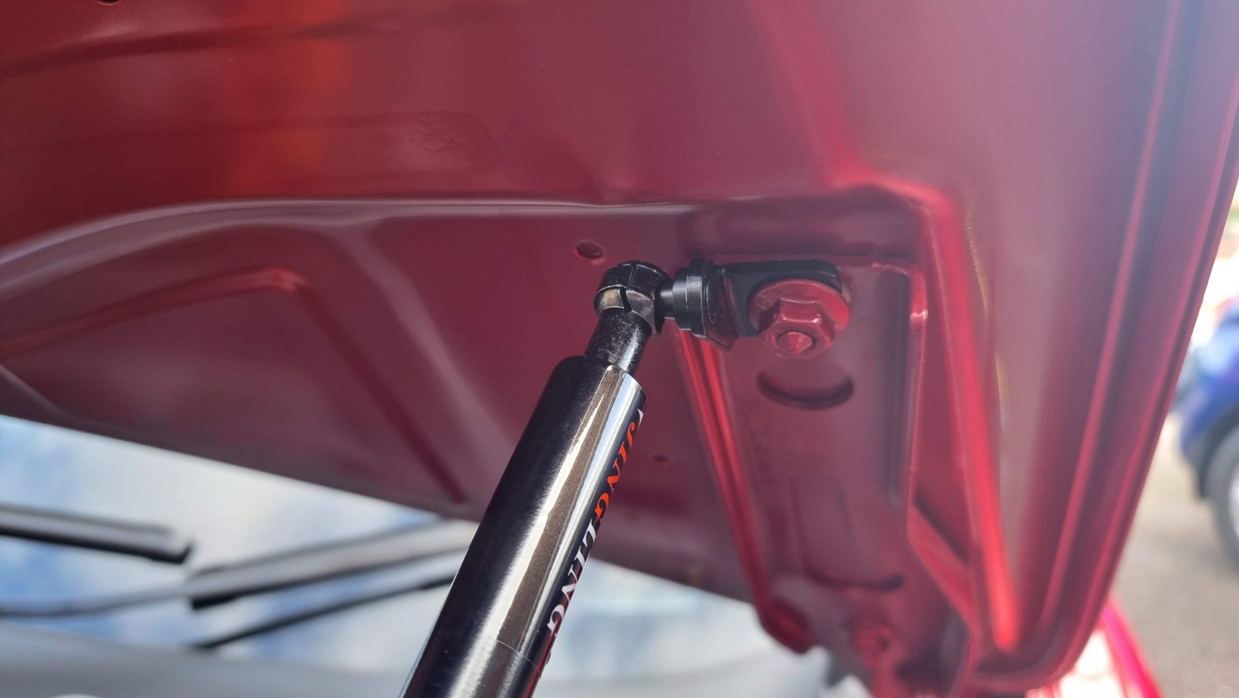

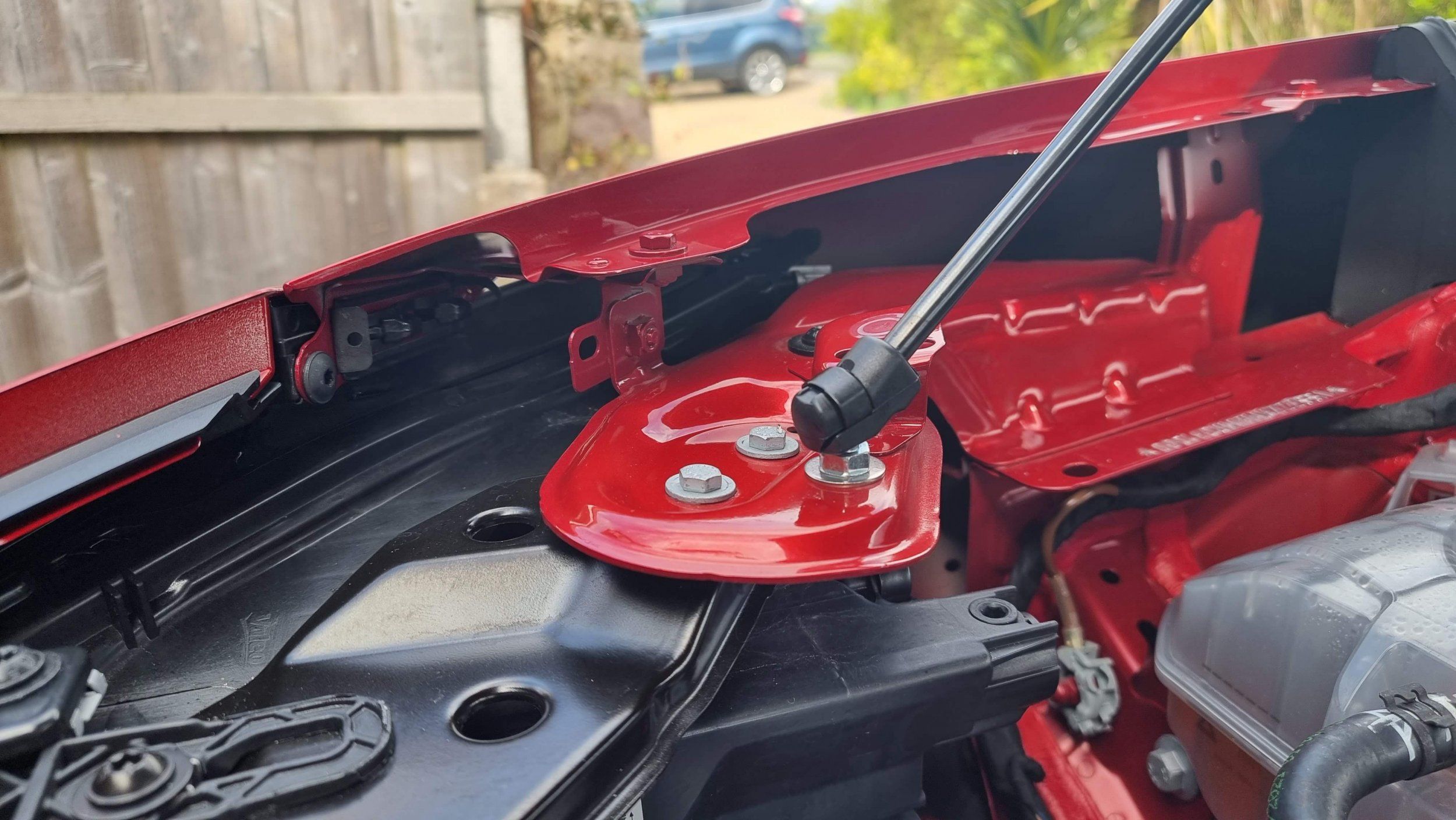

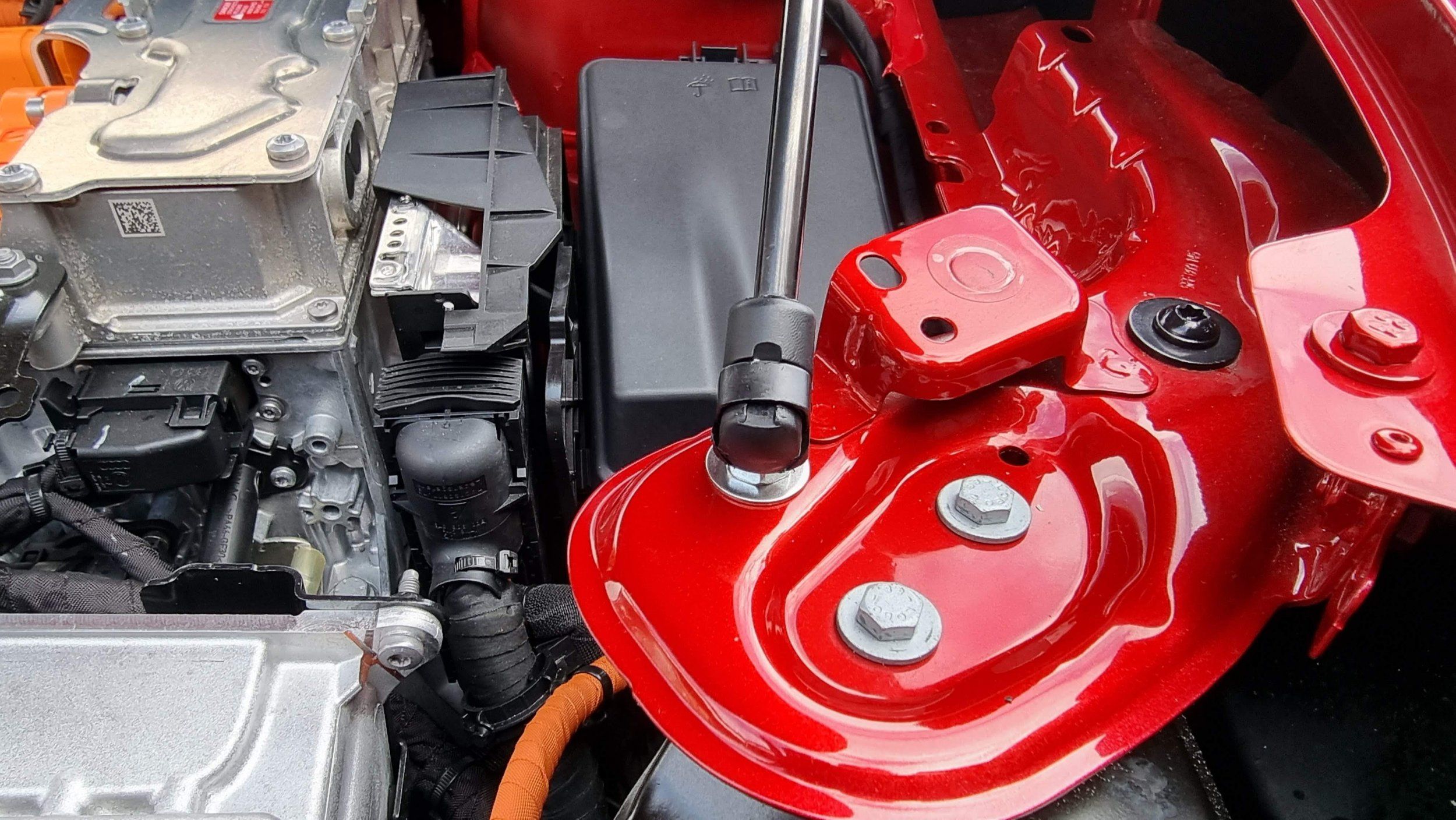

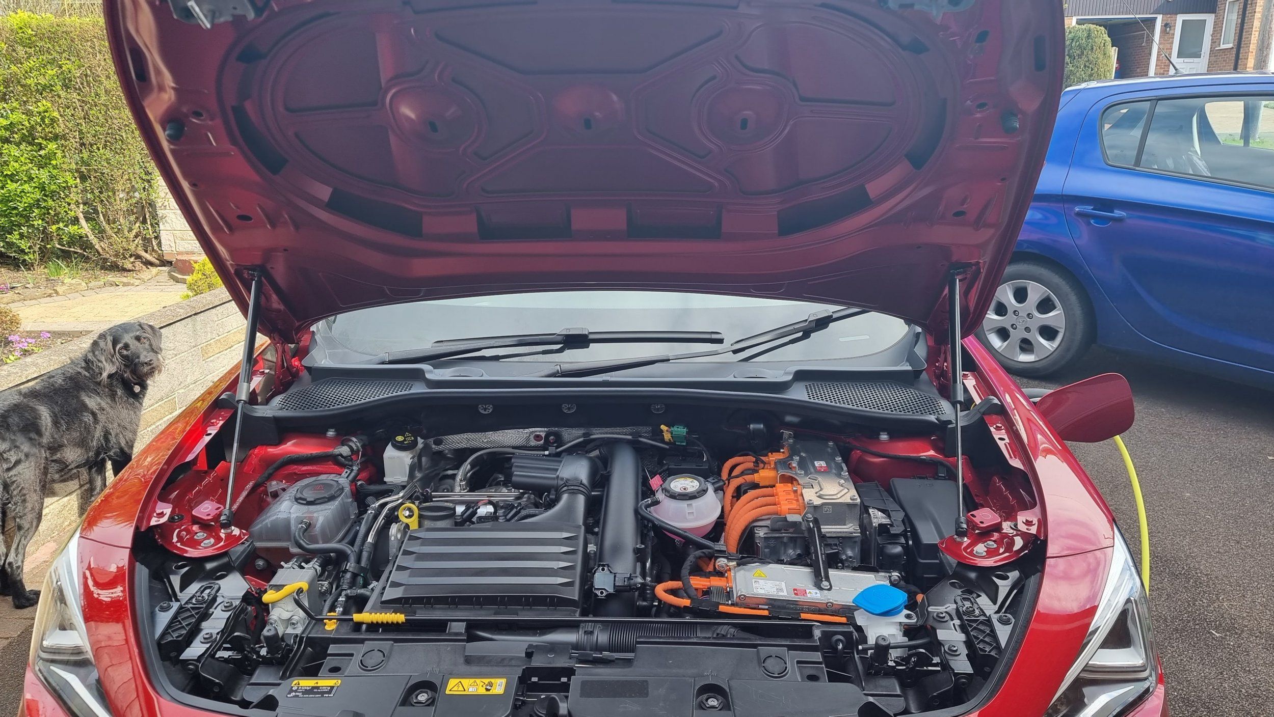

After finding this thread I bought a set yesterday on Amazon and they were delivered today. Now fitted, 10 minute job, really happy with them after being used to them on my previous car. Find it hard to believe they're not fitted as standard for the small extra cost!

Yes they're a good bit cheaper. I didn't fancy any of the carbon fibre look ones so stuck with the standard black ones. I noticed someone saying the LFOTTP ones were a bit 'enthusiastic', well obviously I can't compare directly but these seem OK to me. Yes you have to lift the bonnet 10 to 12" before the struts take over to open the bonnet fully but they do dampen the final bit of opening though. When closing you can feel resistance until the bonnet is back down to about the 12" mark and then it will slam shut. I keep hold of it until about 6" away an drop it down from there.

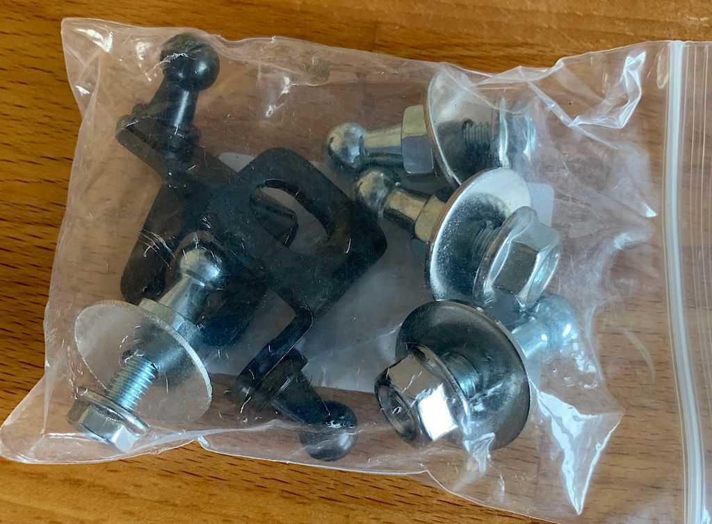

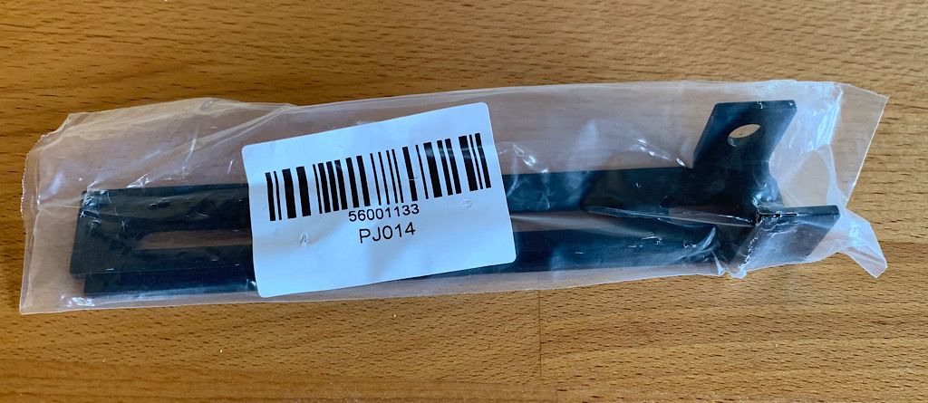

Did you get the below brackets? Not sure what they are for as they're not shown in the instructions.

That's the strange bit, they did come with the ones I was expecting it's just those were in there as well.

Yep, mine came with all those parts too. Didn't use the long brackets or the 2 larger threaded ball thingys. I'm guessing they're there for same reason as Deano said.

Thanks both, I stupidly posted before going and looking at the car. I just did and it literally took me 10 minutes and it was obvious when you were actually looking at it. :clown:
