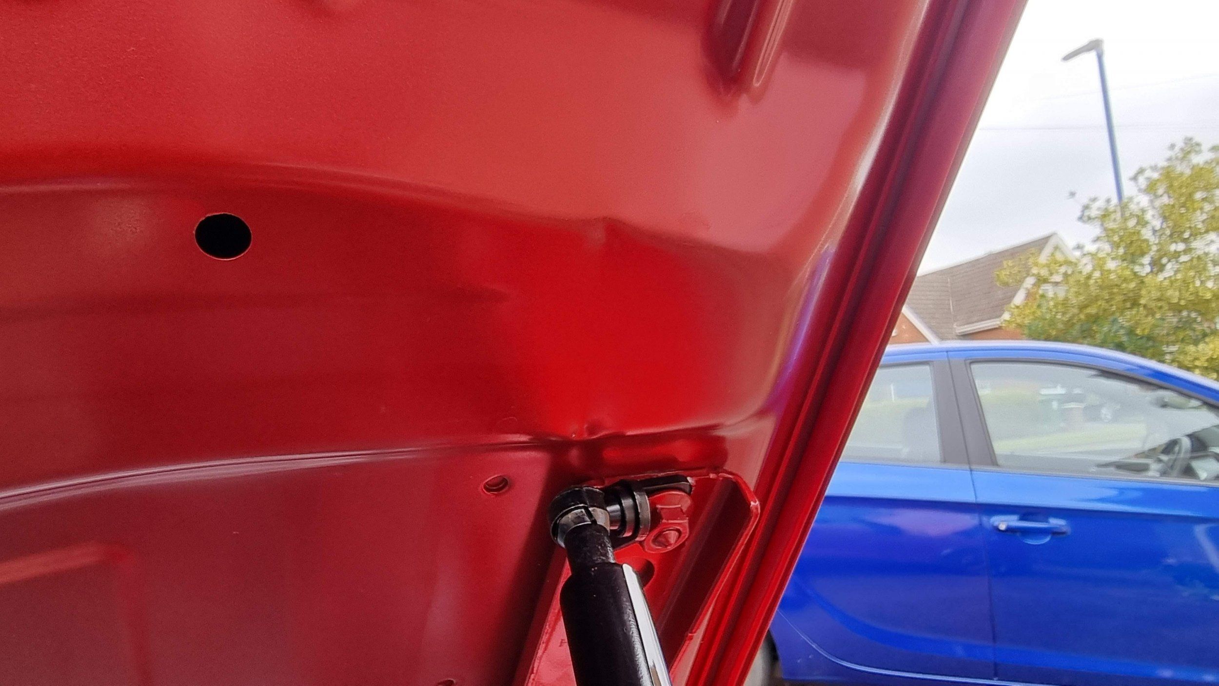

I am bloody annoyed to say the least :mad: :banghead2. Definite damage to the brace bar across my bonnet as you can see in the pics!
Thanks a lot to Ninjakebab and Supa Koopa for sharing. These Jingling ones are on there way back to Amazon as of right now! I'm going to order the LFOTPP ones that are advertised for the T-Roc, not Formentor and see how they are. I don't suppose anyone knows if the cylinder diameter on these are any different to the Jingling ones? Jingling cylinder diameter is 18mm.

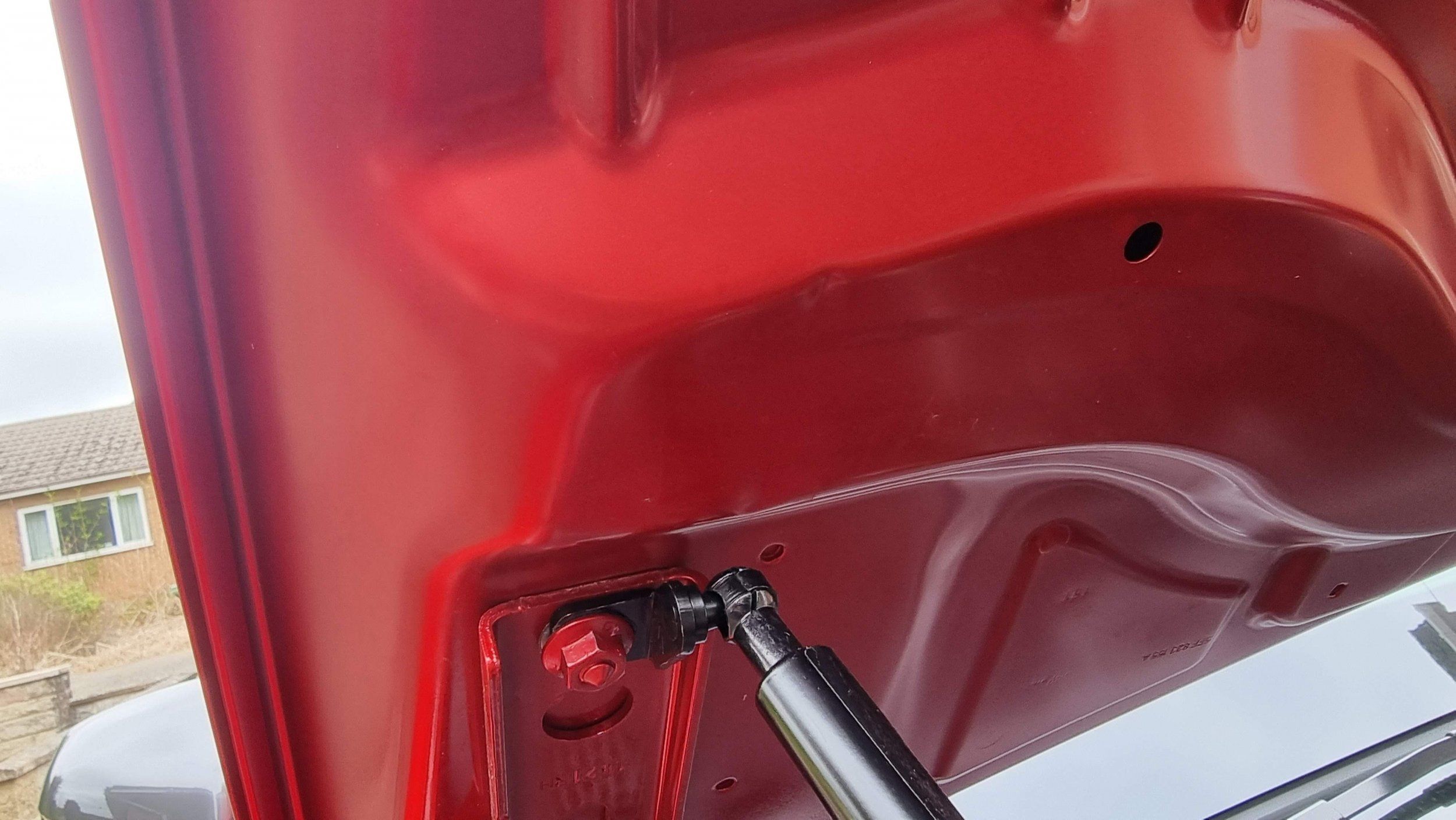

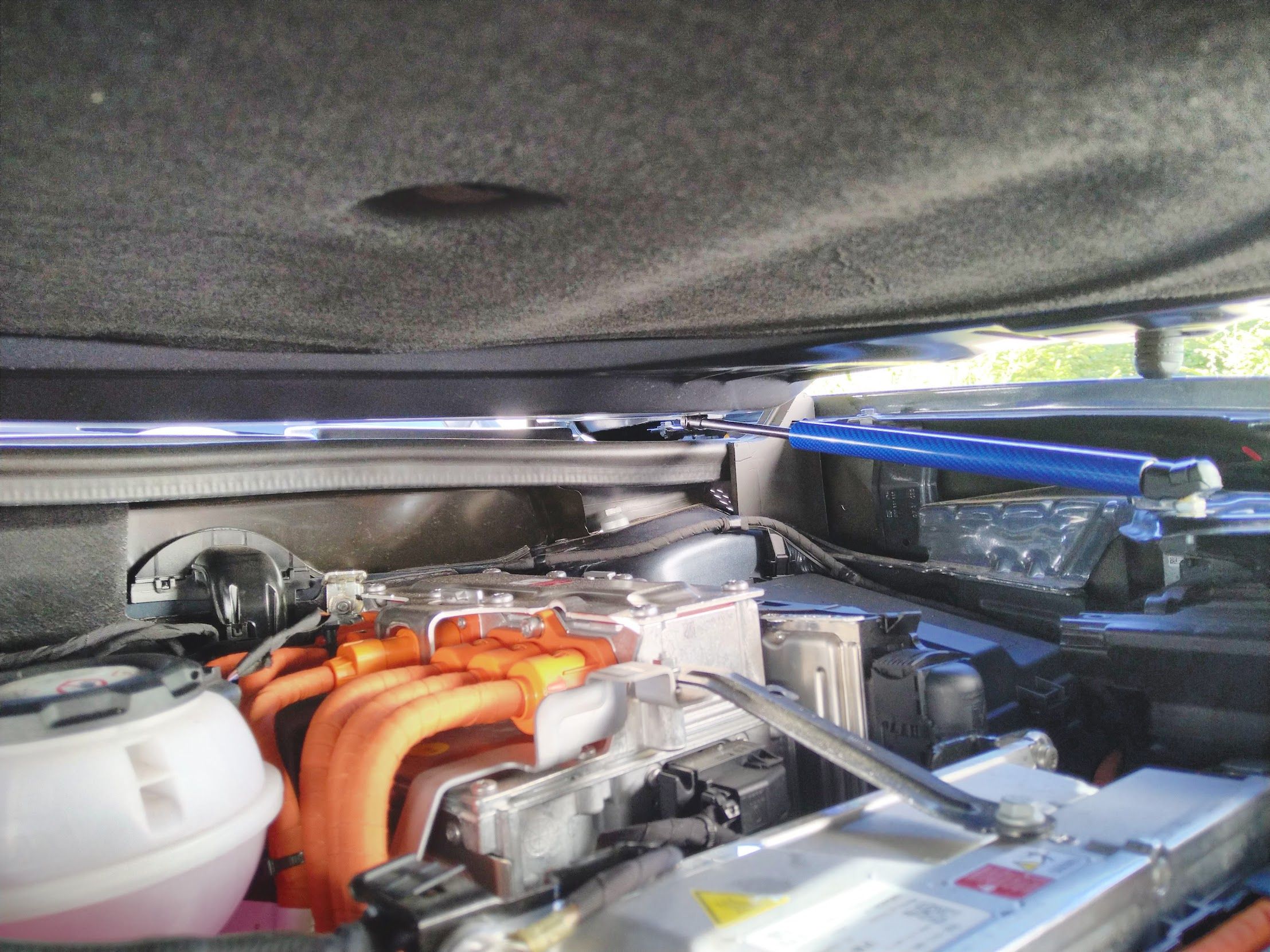

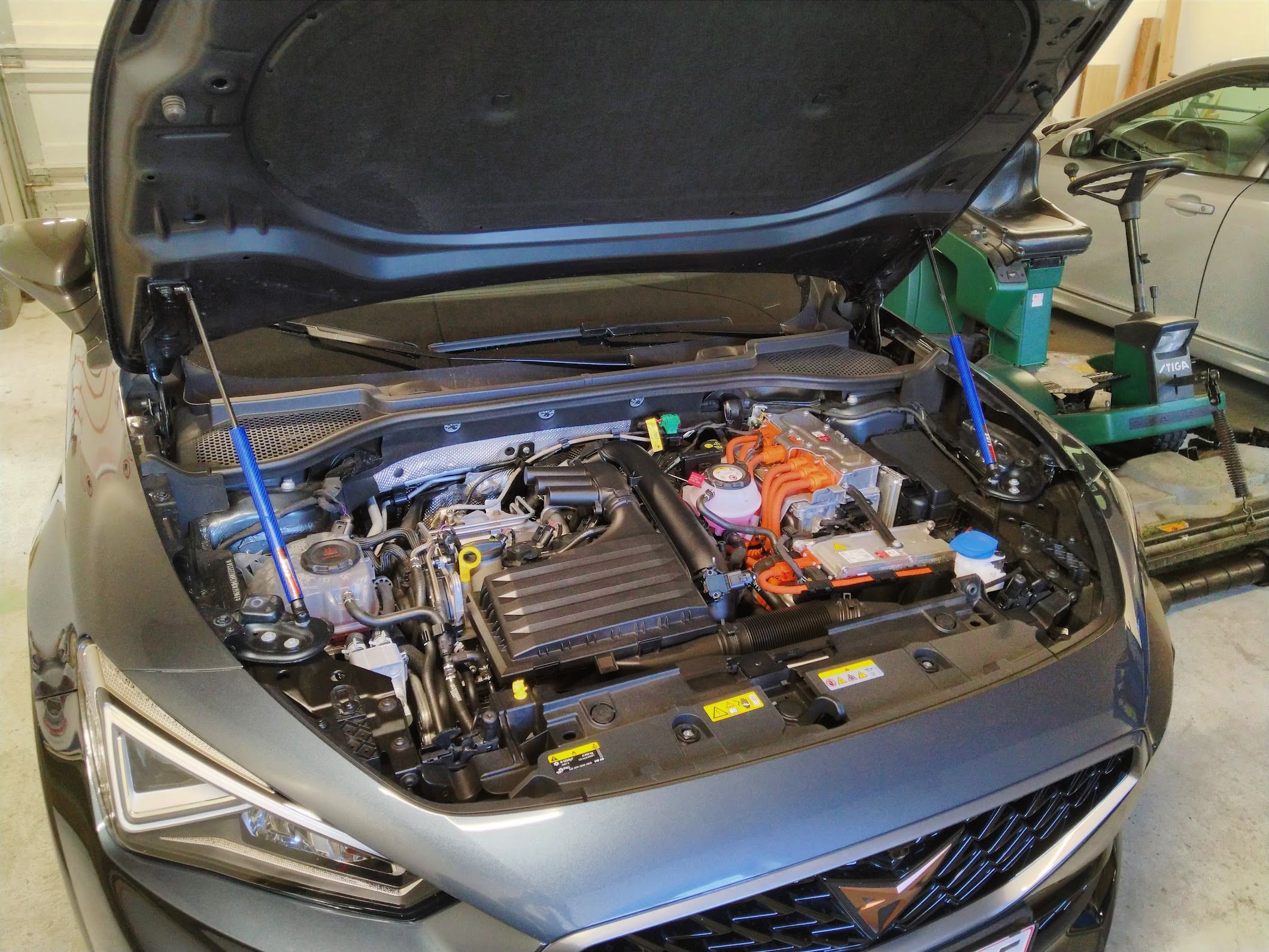

Alright lads, here is my analysis for this Formentor mod - and fix for the Jingling struts:
I believe all hydraulic struts will conflict with either the bulge on the underside of the bonnet AND/OR the rubber gasket - especially if the cylinder end is attached to the bonnet
Take a look at this picture of Jingling struts, with the piston end attached to the bonnet (with bonnet still about 6cm from fully closed):
Even a slimmer strut will most likely make contact if the cylinder end is attached to bonnet. The LFOTPP has different brackets, and might have bigger clearance with the bonnet - but that will just bring it lower and squeeze the rubber instead. Even with the piston on the bonnet, the Jingling still makes contact with the rubber.
I advise everyone to have a look at theirs (LFOTPP too), and check for damages/clearance.

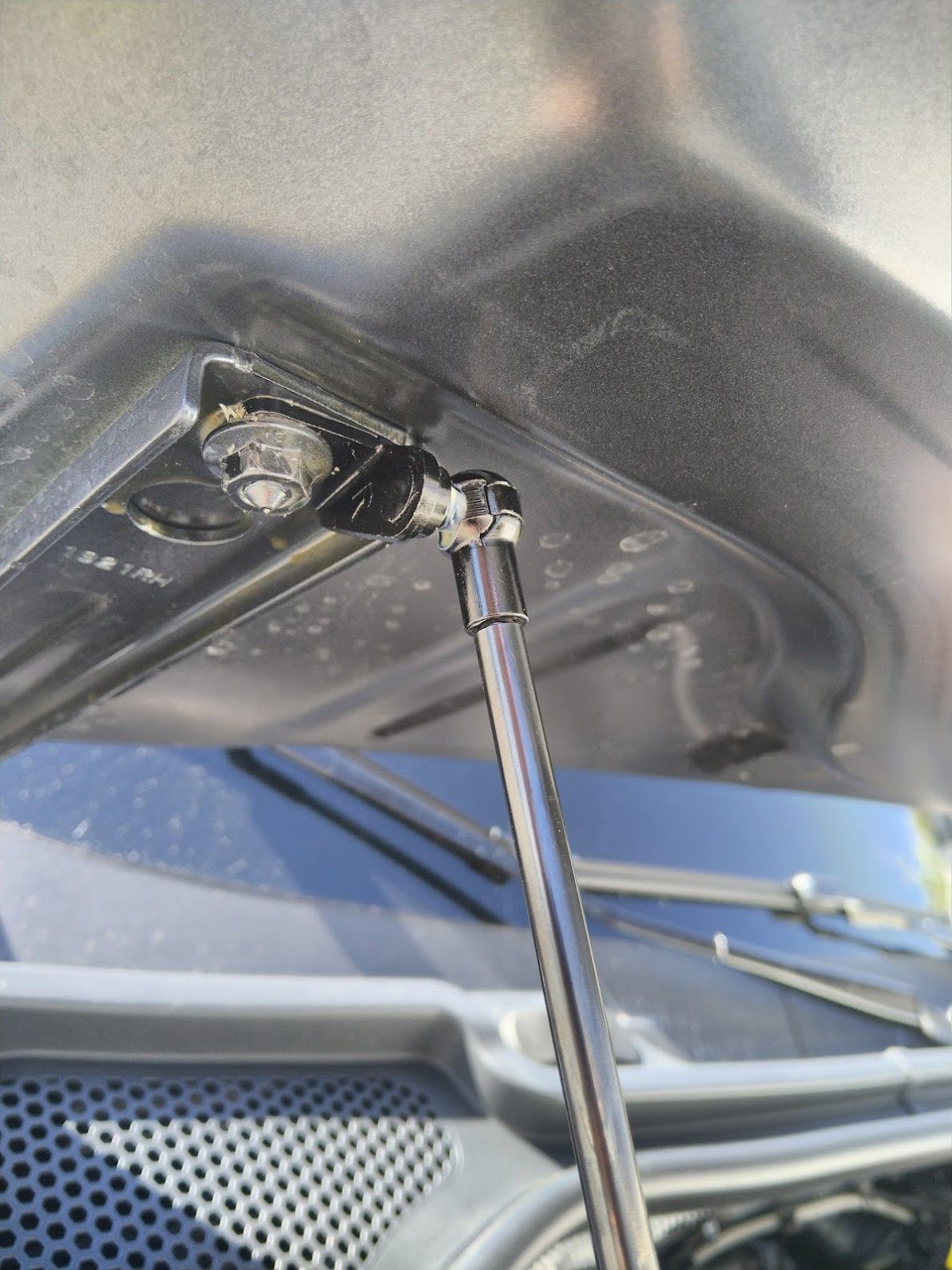

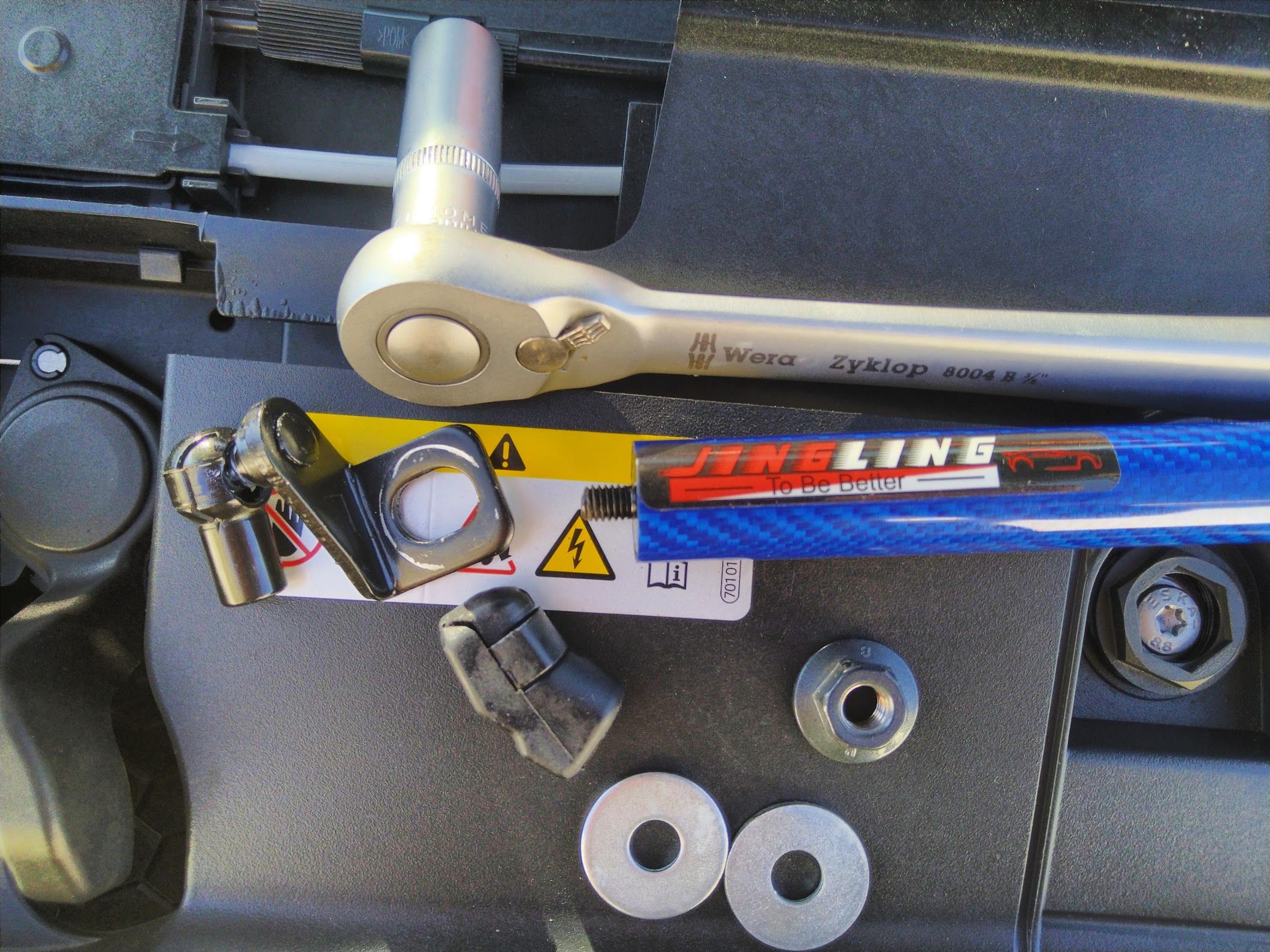

Now, for the Jingling ones you can't just flip them to get the piston on the bonnet side of things, you gotta swap the brackets on the struts themselves too, since they swivel in different directions:
They're threaded so no biggie doing the 180.
It should end up looking like this on the bonnet:
As you might be able to tell I had to rotate the bracket ever so slightly, since the knuckle of the piston will otherwise scrape against the bonnet bracket.
Took a bit of creative thinking, but the Jinglings can work.
Final result:

These are the struts I fitted. When fitted with the piston at the bonnet side, the bonnet still did not touch but the piston pressed on the insulation foam underneath. No big deal, but now I turned them 180° and maybe at the worst it is just touching with the foam.
