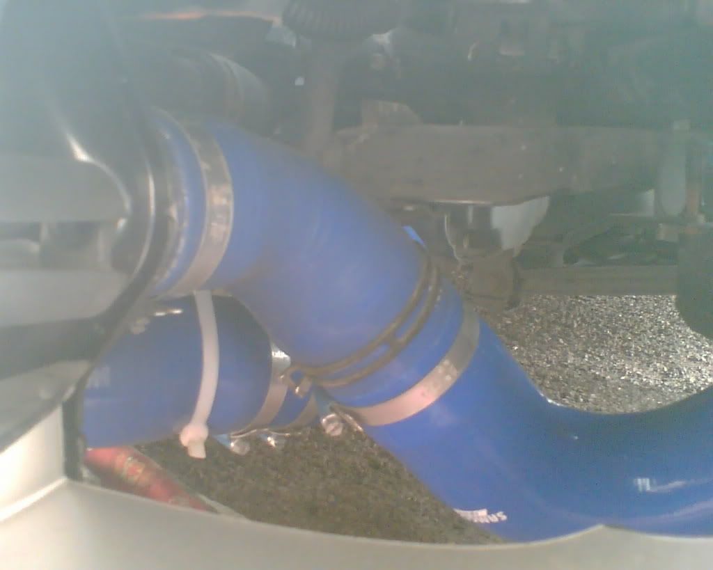

Hey guys just need some ones oppinion on this changed one of the pipes on my intercooler as wasent sealing properly but not not sure if its right.
This is the pipe as it sits normally :
But iv had to bend it abit more to join up like this:
Do you think the pipe will be okay bent up abit it isent bent to much that its squashed or anything though.
Also it seems really low to ground come just below the bumper but think i might be okay but not sure.
looks ok to me... but could you not trim the pipe lengths to get a better fit (can't really tell from the photos).
was thinking could cut abit off the part that joins the black plastic just dident know if it would cause it to have more of a bend in it.
Cut the pipe off the hard pipe shorter. On the hard pipe side. It will made the bend less harsh as its not as low as it is.
Pipe fits much better now seems tighter on and the pipe on the intercooler doesent rub it was doing before so cut it down abit more.
You reckon few cm off it then phil? wasent suer when doing it so put it together as it was can allwasy cut it cant stick it back together i though.
Looks like you could cut off at least an inch from the hard pipe connection. Do it a little and see how it looks, then keeping trimming.
okay will give it ago.
