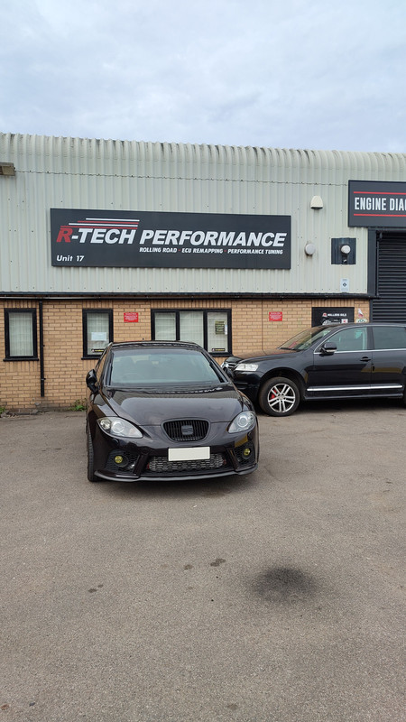

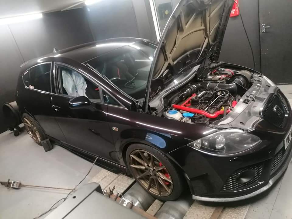

Anyway in June I was booked in to Rtech for 2+ mapping, went there dropped car off and got a phonecall saying that my fuel pump internals were standard, could of cried 🤣 also the RS4 FPRV I thought was in the car wasn't either so no idea what had happened. It was an expensive day as I got them to Chuck some VIS internals in and a new RS4 FPRV and a cam follower for good measure and I did end up getting a refund for the loba. Car then went on to make 371bhp and 414lbft torque not bad on a 20 degree day!

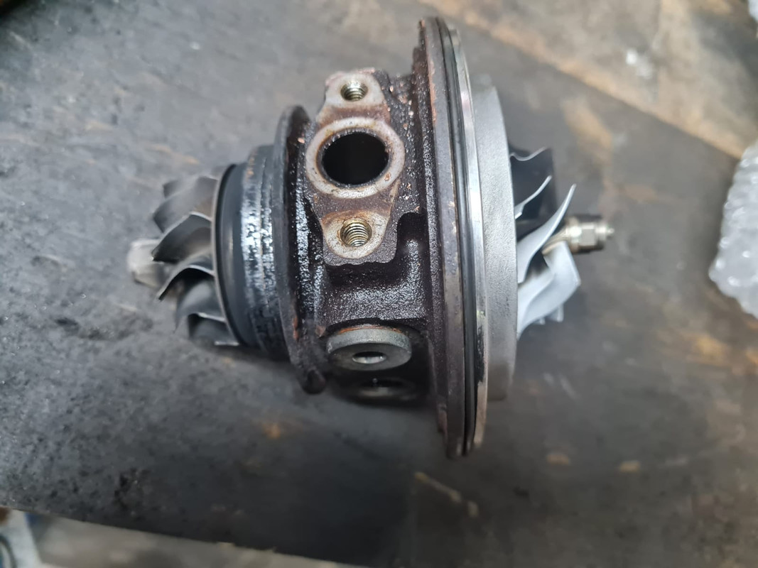

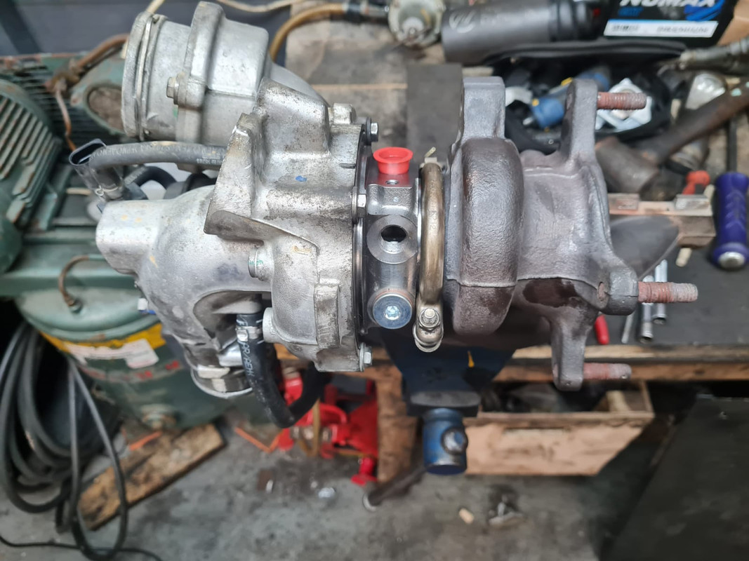

Since then car has been sweet! Just had the turbo core replaced as my turbo had a little play and was a little smokey every now and again after idling, that's all sorted now thankfully.
Old core
New core
All back together

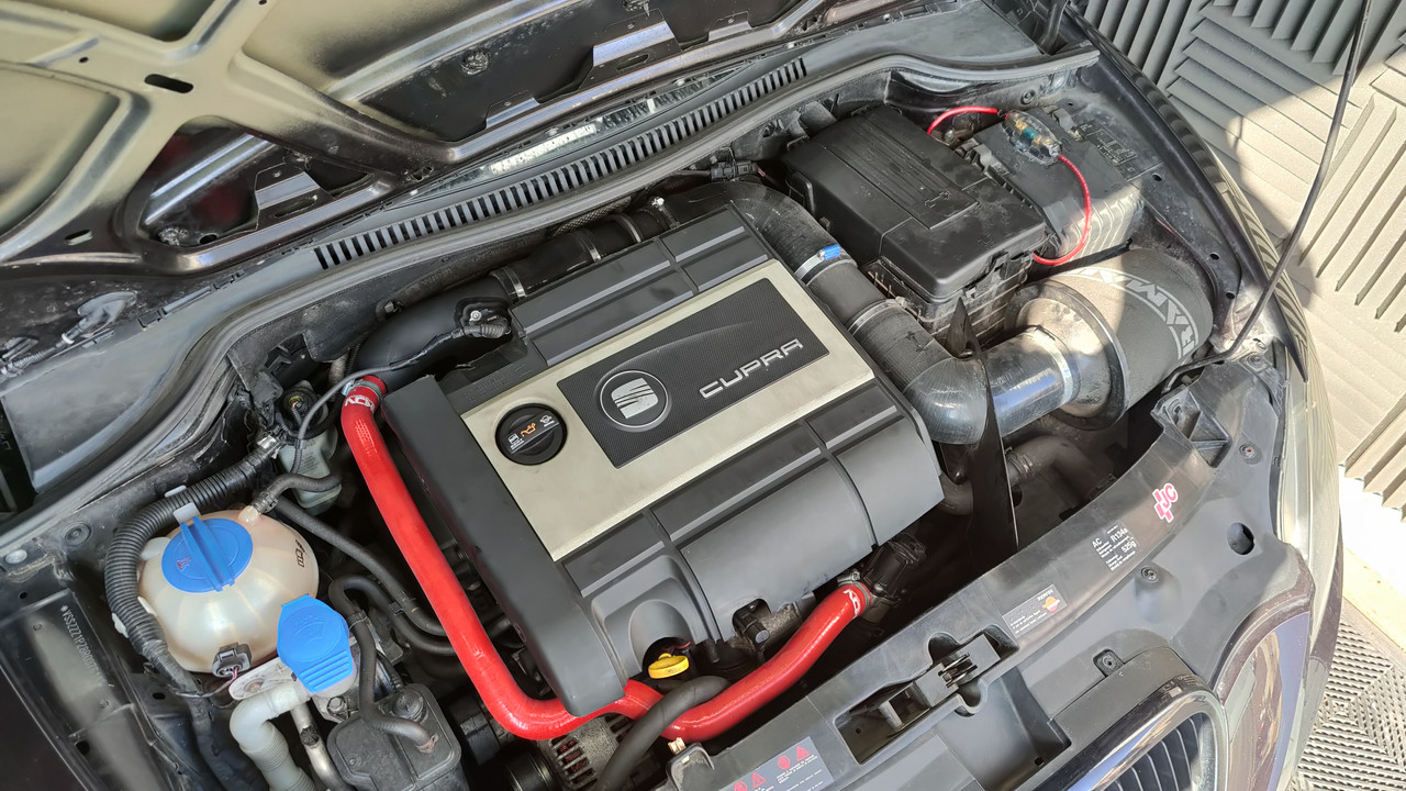

After getting water in my coils I decided to hack up my engine cover to fit, no water gets in there now thankfully and looks decent too, did toy with the idea of painting but I think I'll just leave it as is

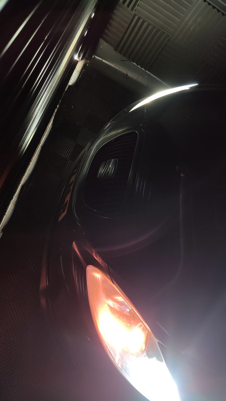

Headlight bulb given up the ghost and went all purple on me so ordered a set of nice looking 6000k bulbs from little Moore lighting, nice light output and nice colour temp

Anyway in June I was booked in to Rtech for 2+ mapping, went there dropped car off and got a phonecall saying that my fuel pump internals were standard, could of cried also the RS4 FPRV I thought was in the car wasn't either so no idea what had happened. It was an expensive day as I got them to Chuck some VIS internals in and a new RS4 FPRV and a cam follower for good measure and I did end up getting a refund for the loba. Car then went on to make 371bhp and 414lbft torque not bad on a 20 degree day!
Old core
New core
All back together
