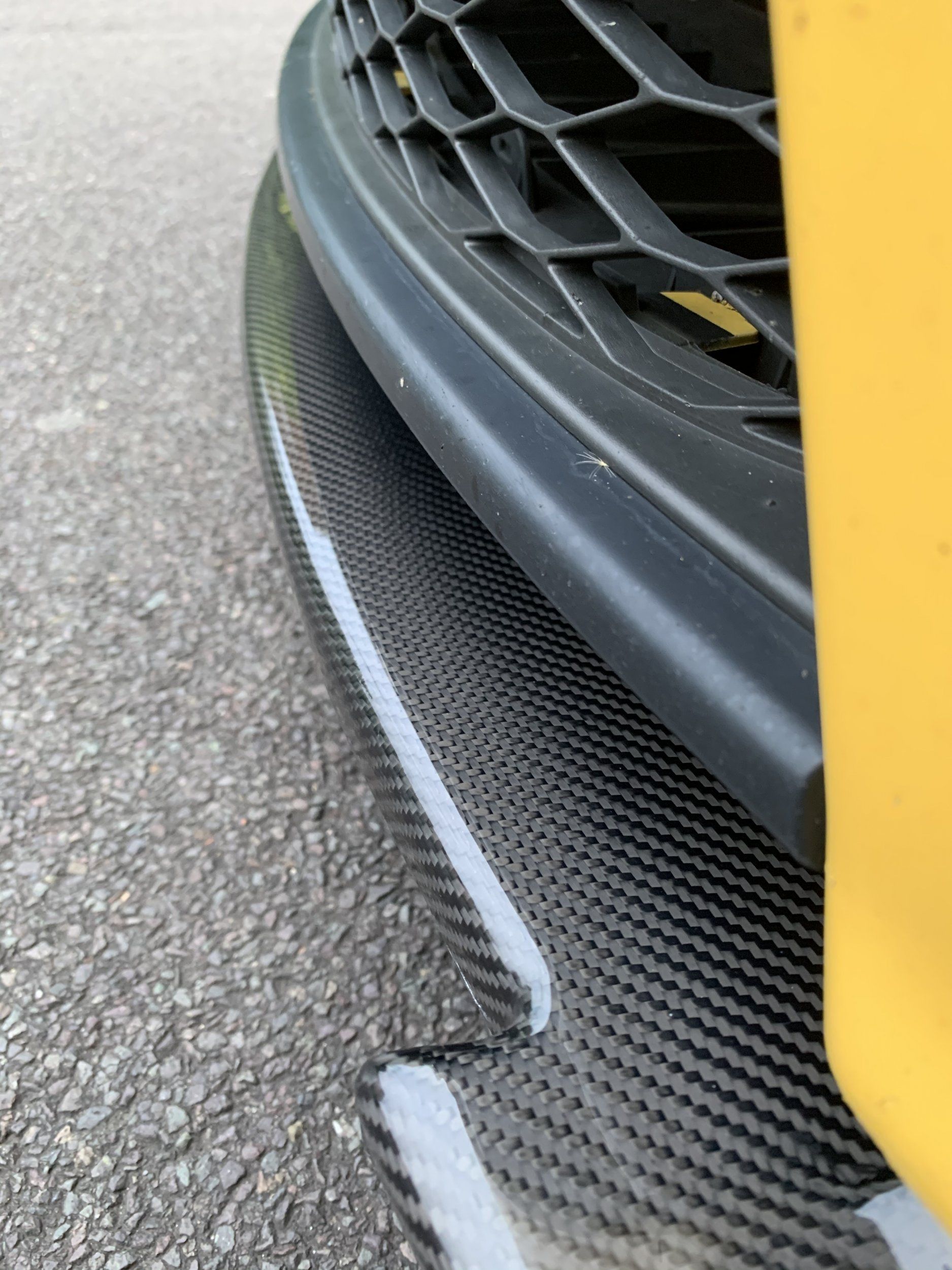

The splitter is a sore subject mate ? it’s no longer on the car it came off. I’m trying to import another one from lativa but it is hard at the moment. When you fit your splitter do it properly nuts and bolts with big washers not self tapping screws if your gonna drive your car fast...
Reactions: Aidanr97
Excuse me now while I cry myself to sleep ... lol that was a bad day when that came off however did get my car to 160mph on the dial and 155 on gps
